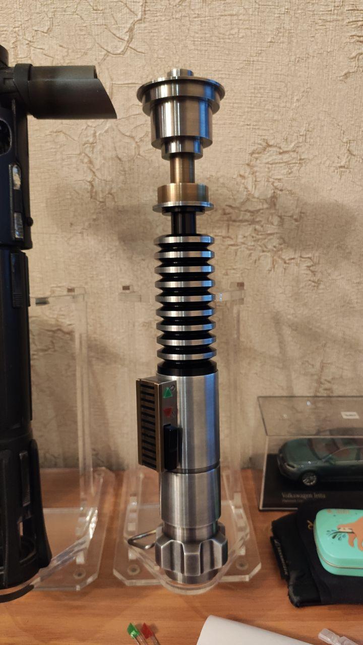

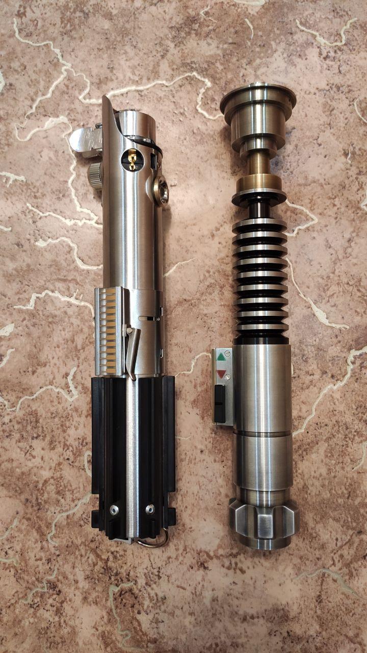

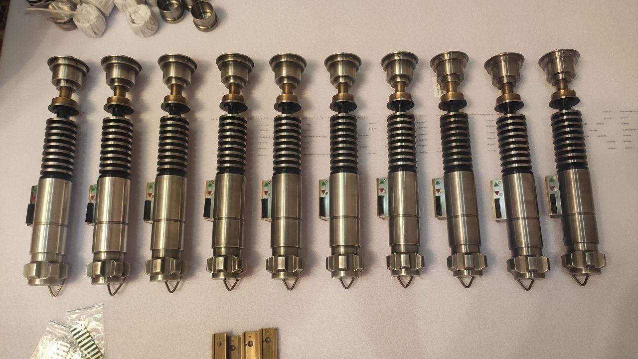

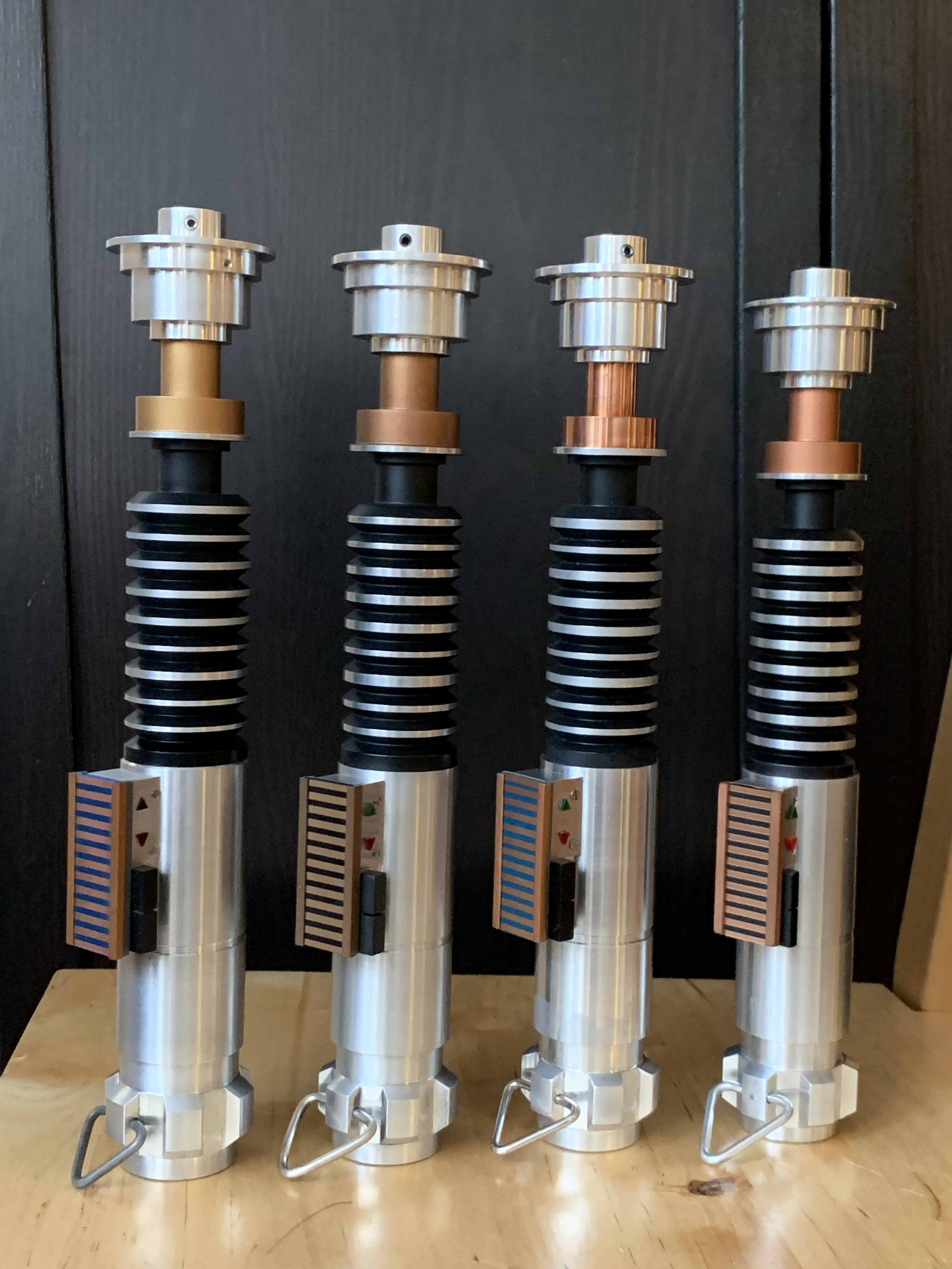

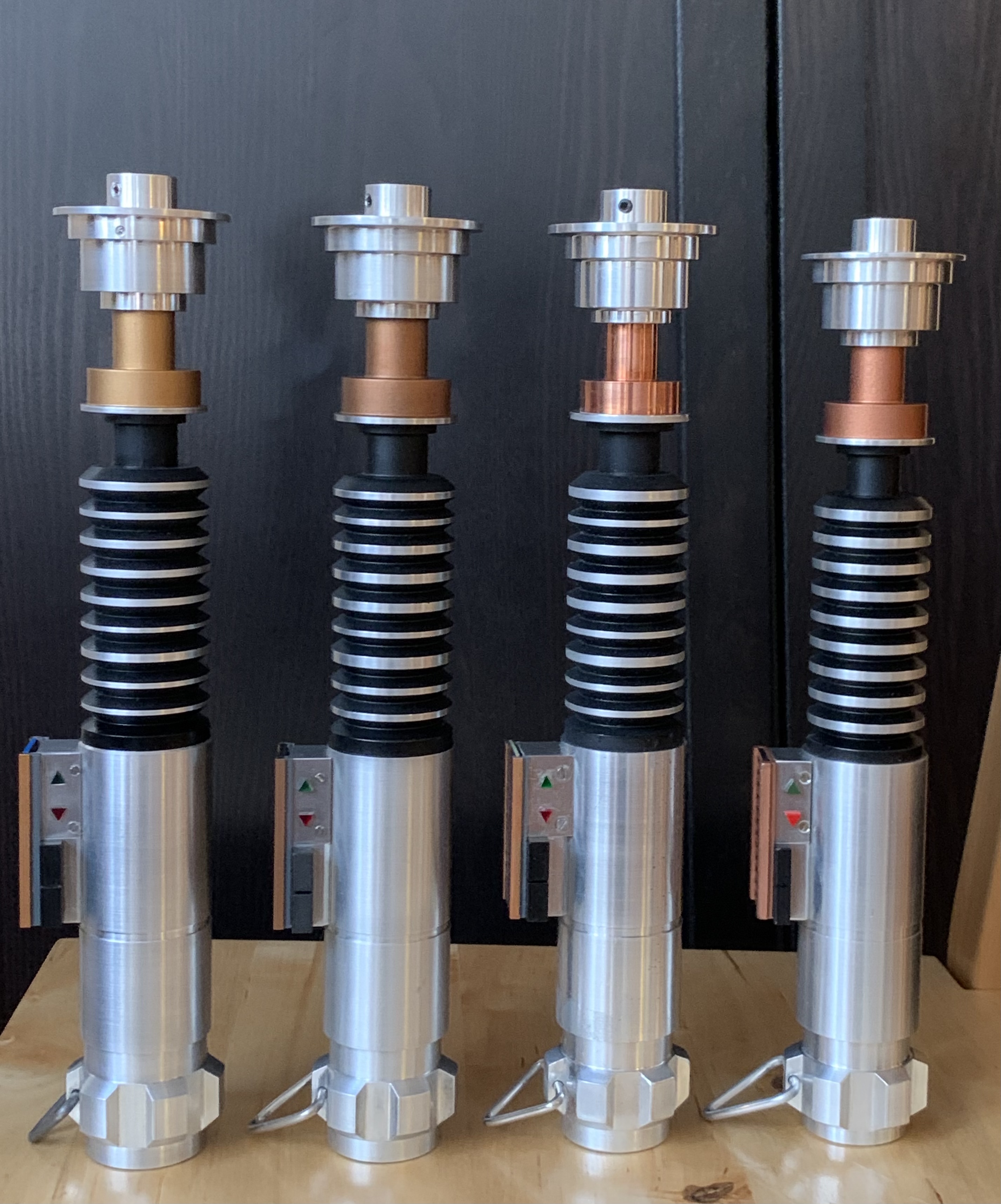

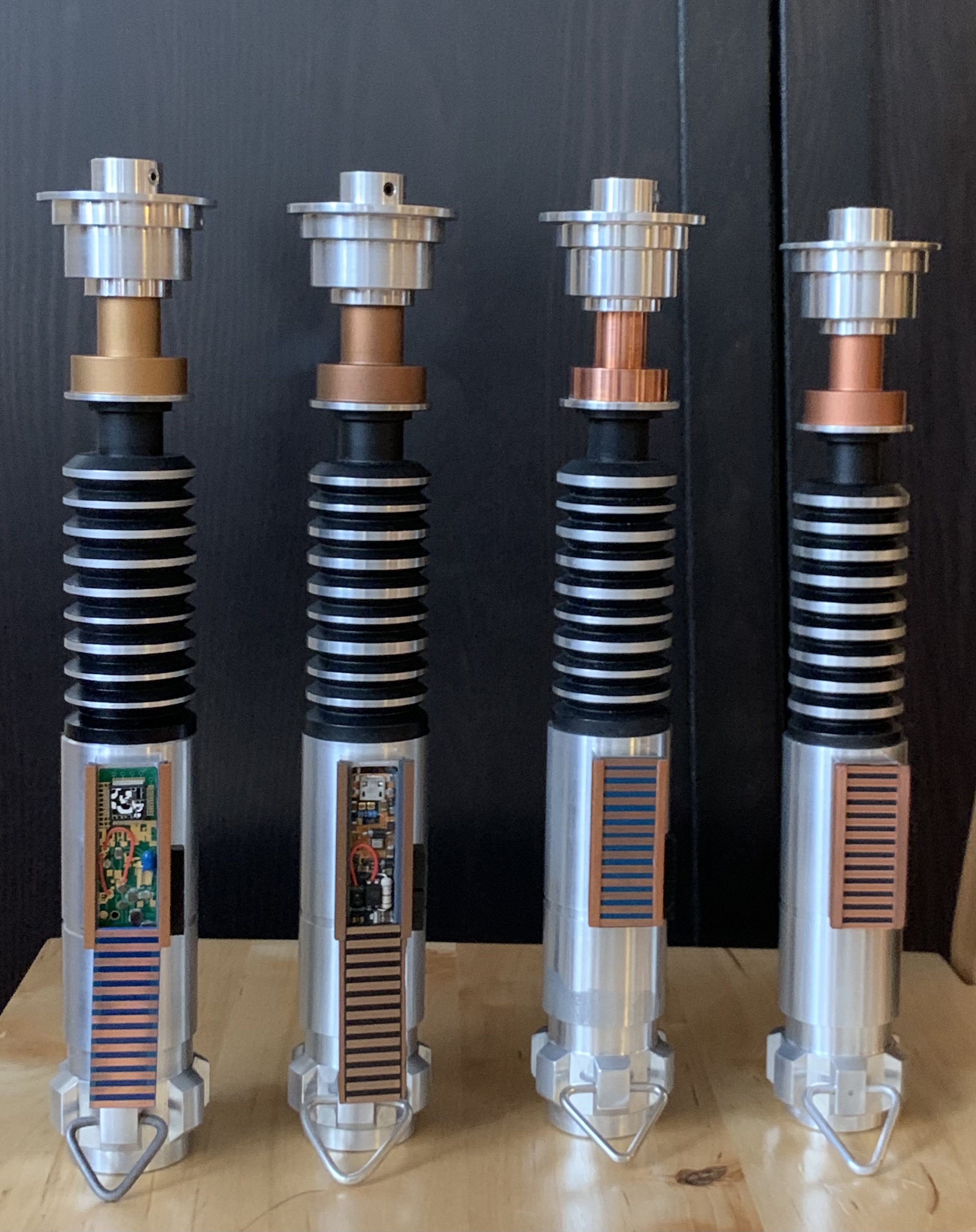

Some weathered guys for customers

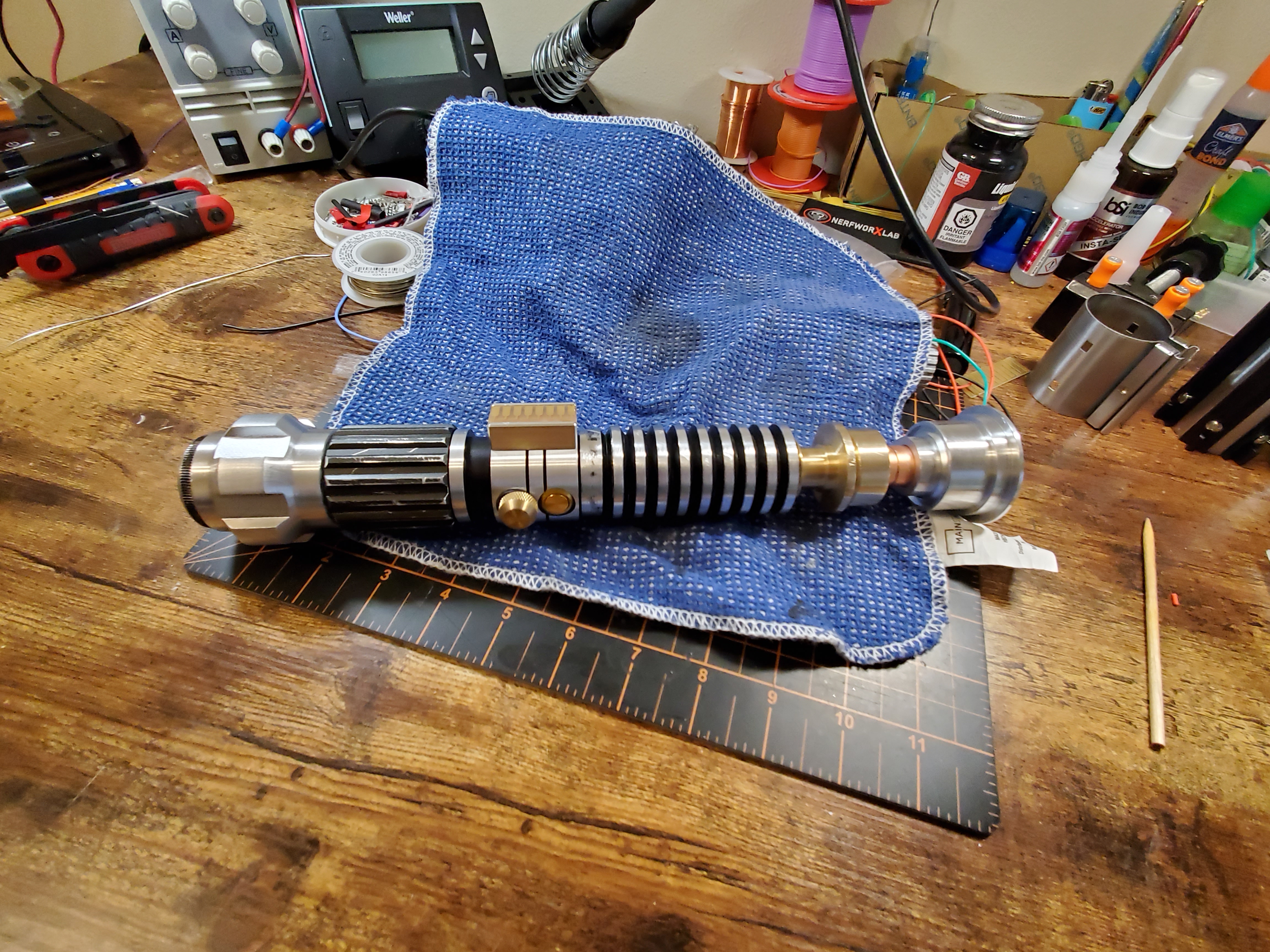

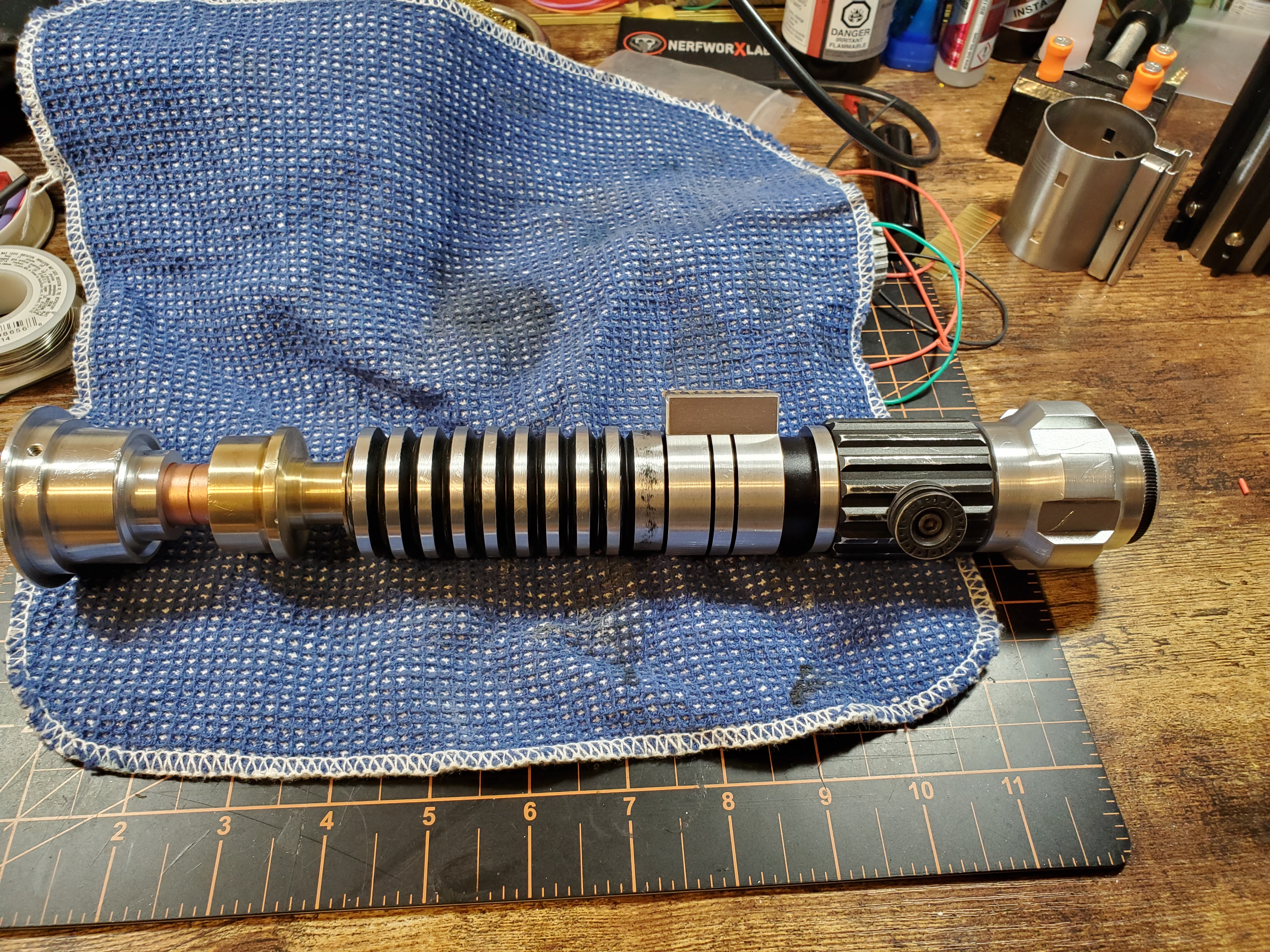

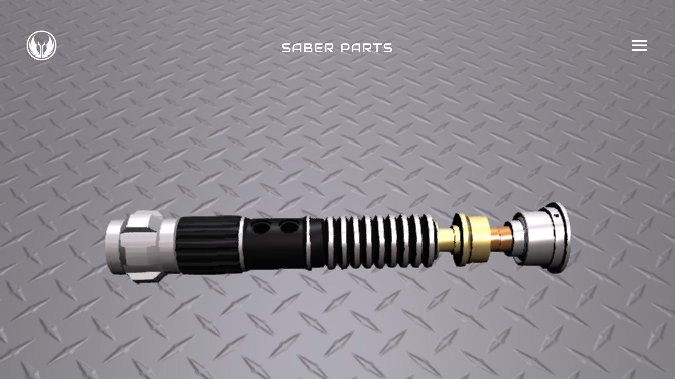

With the exception of the ‘switch section’:
That setup of parts is EXACTLY how I modded together my first saber (V2)...
If I knew then what I know now; you could mod and hit almost every necessary dimension with the exception of the overall grenade length.
with a lathe setup:
redeemer ‘Body’ (booster and pommel separate
Redeemer pommel cap
“Resilient” switch
Prodigal son grenade,
Redeemer emitter/neck
they all have enough meat in the body and threading to be resized to nearly the correct dimensions

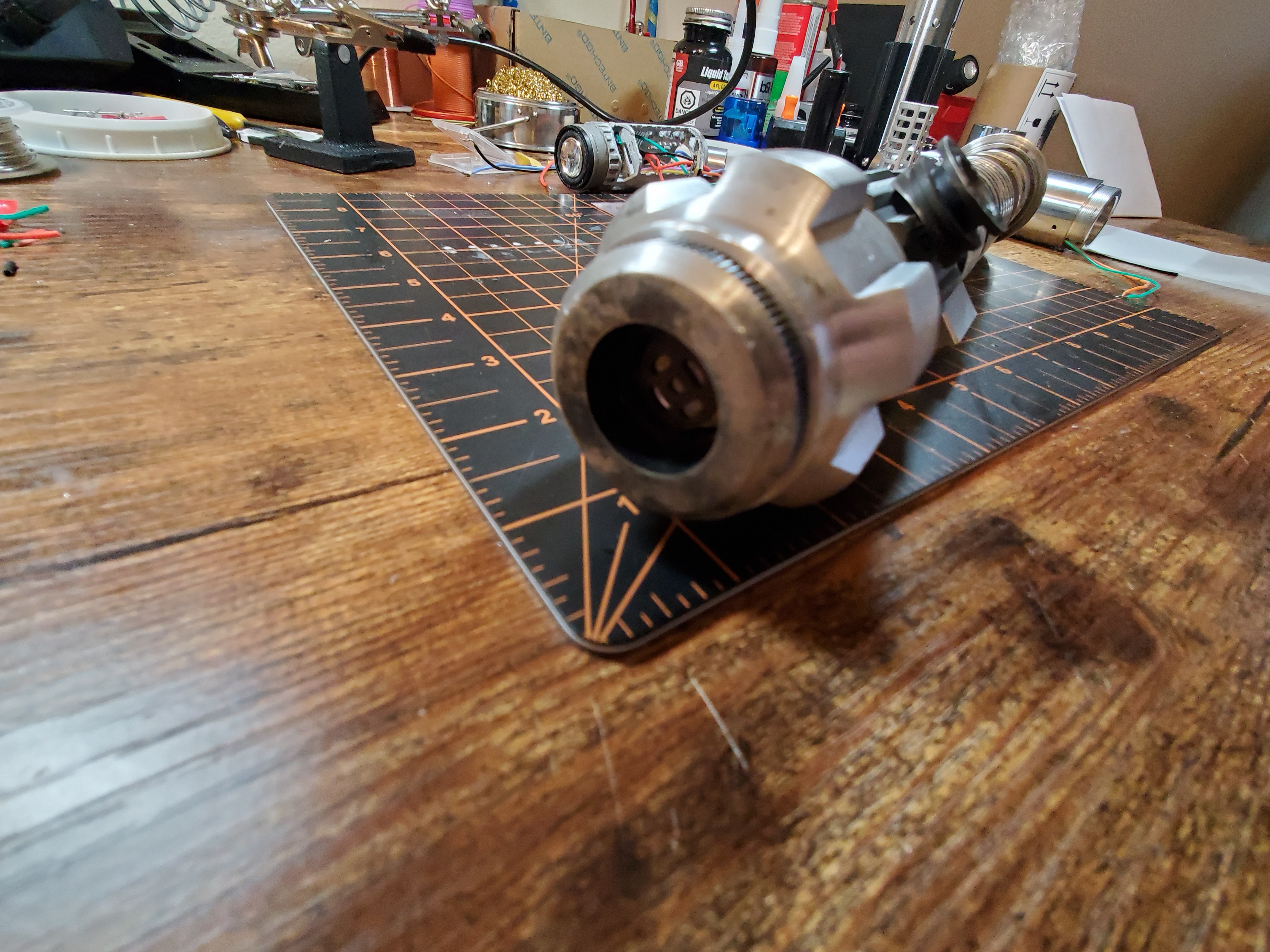

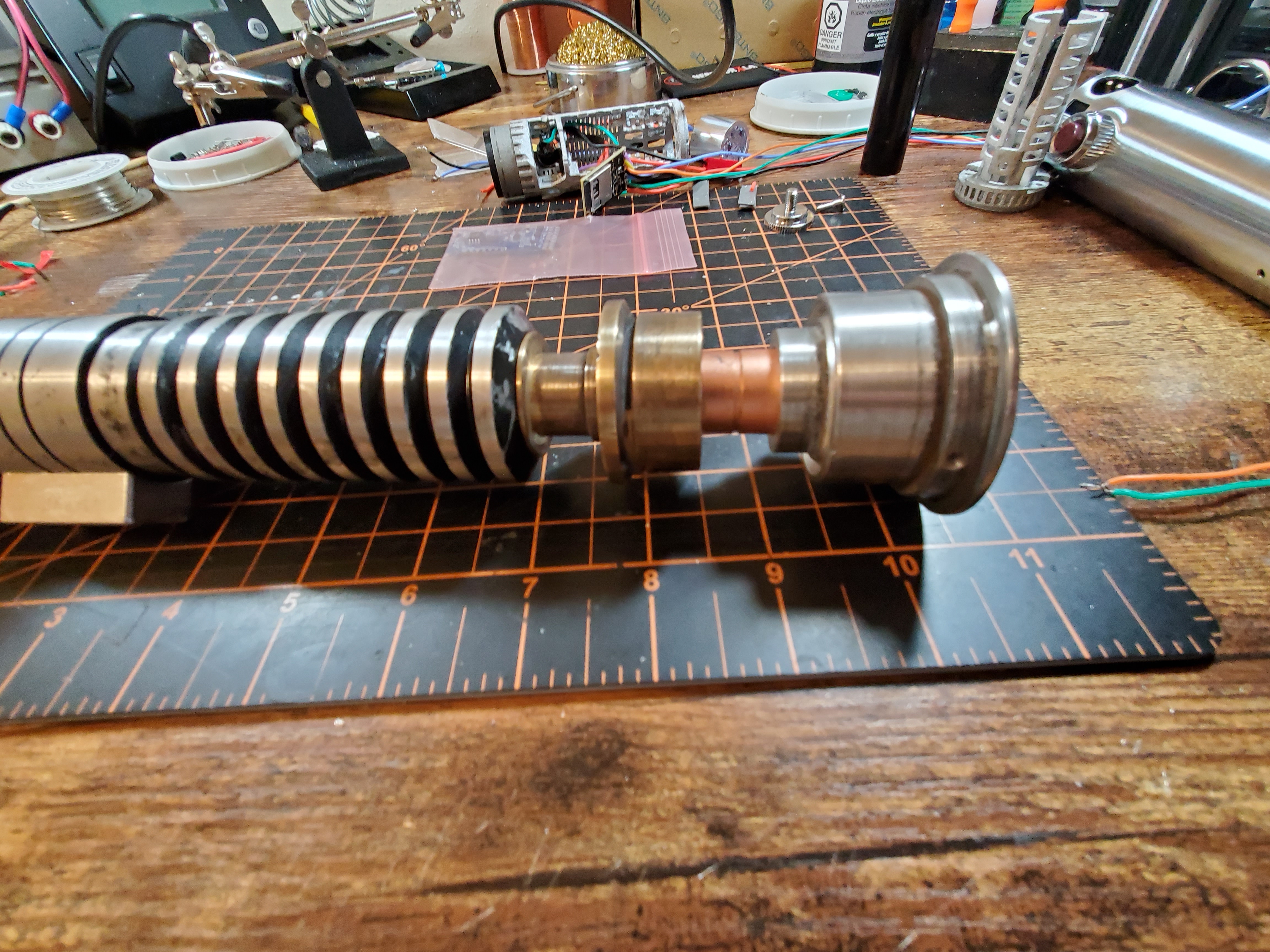

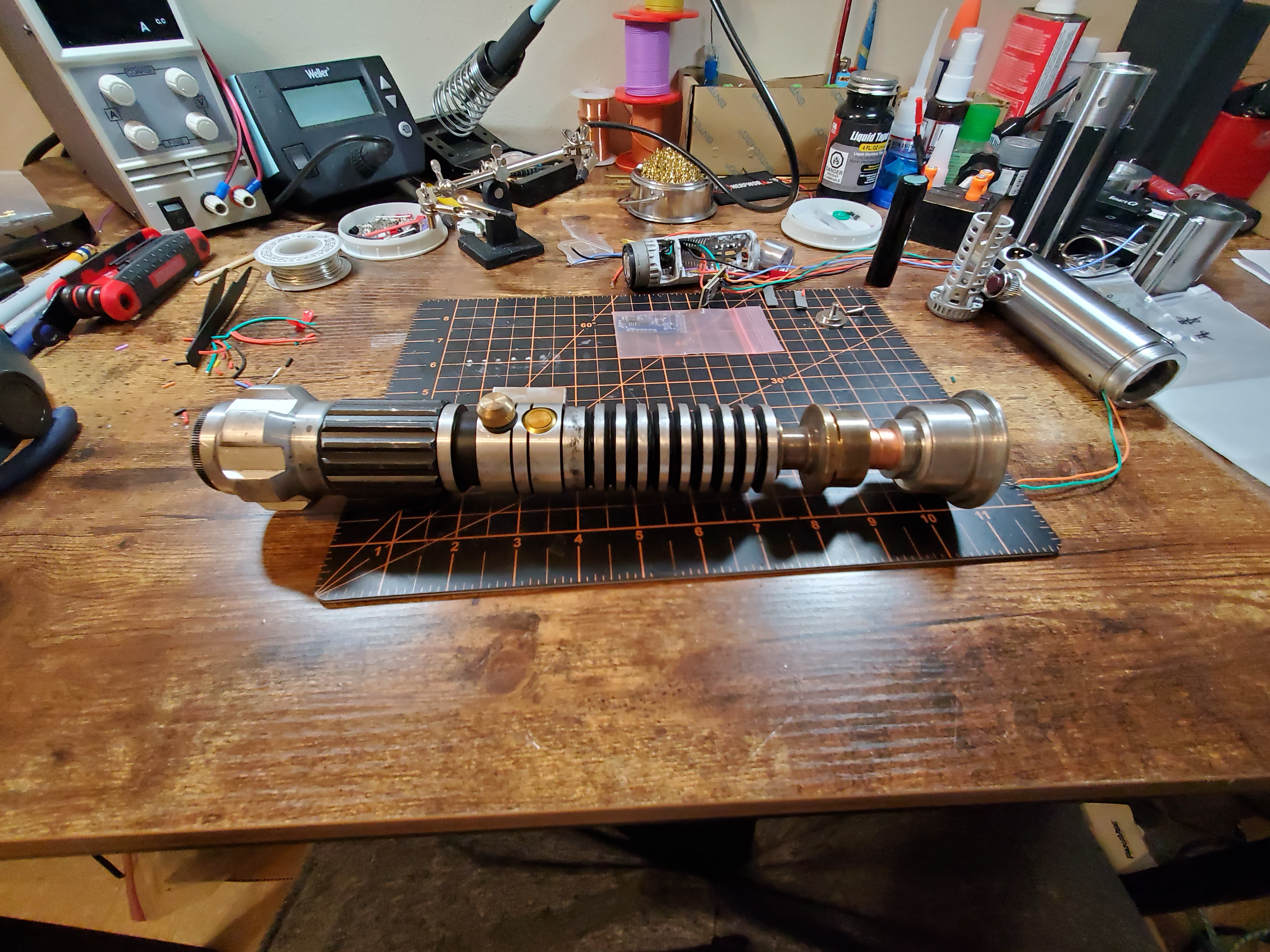

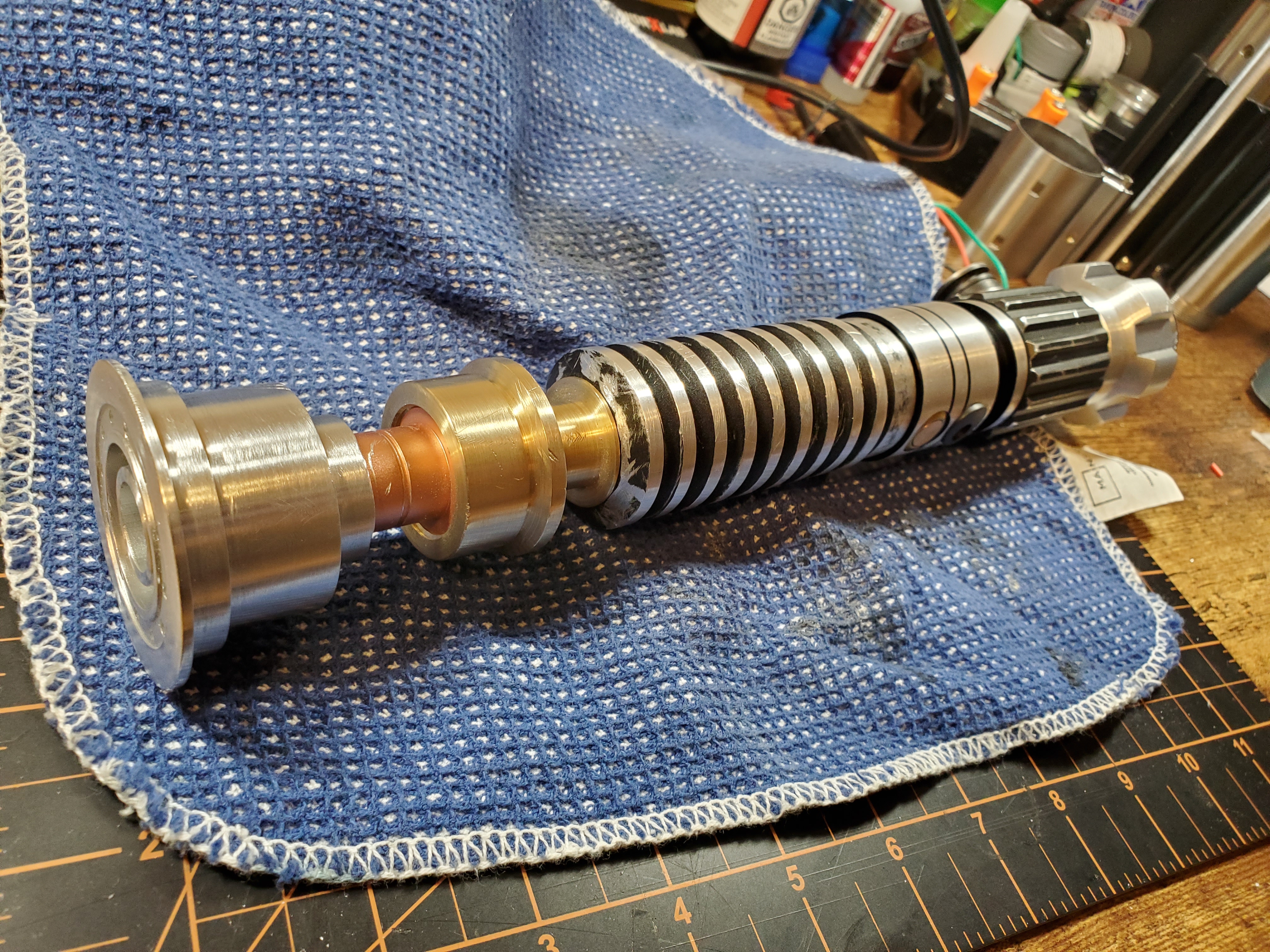

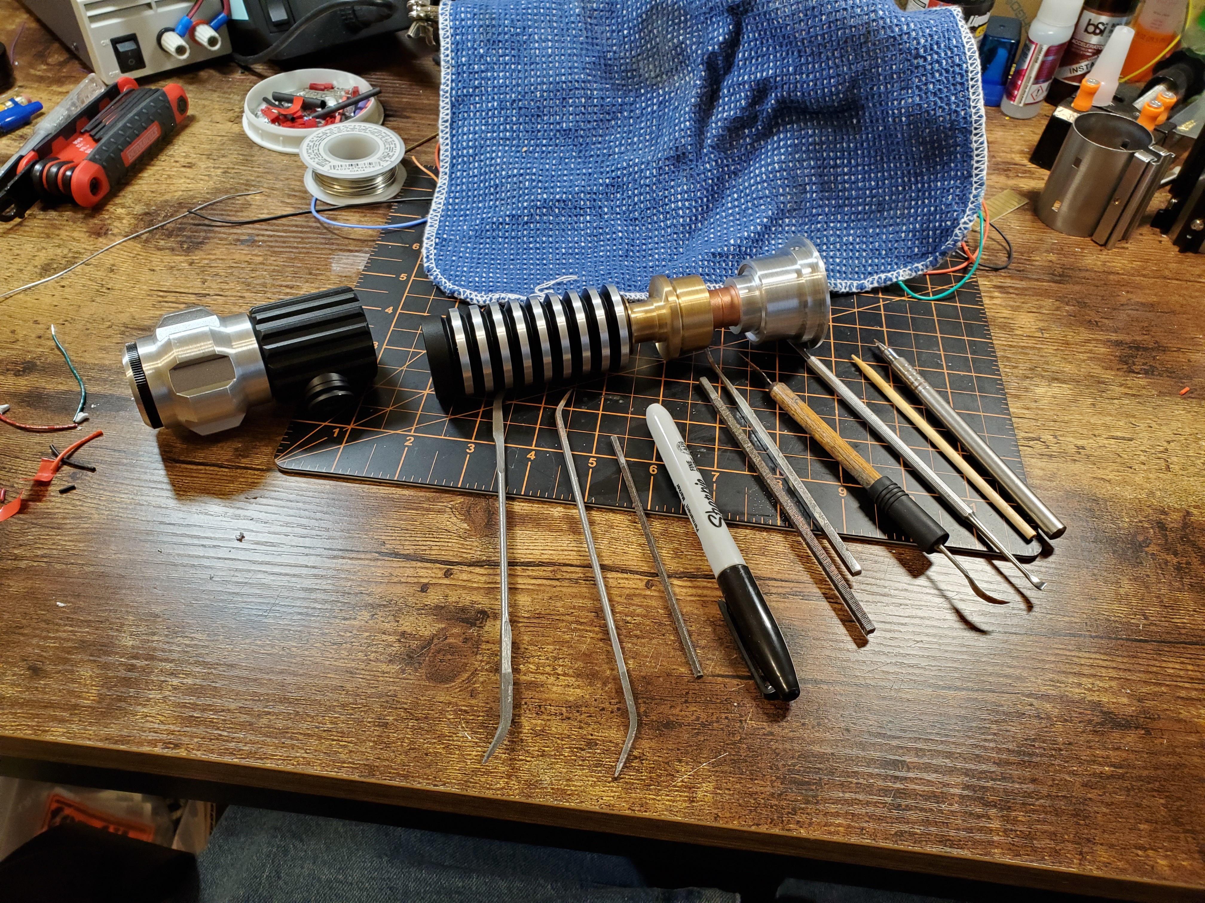

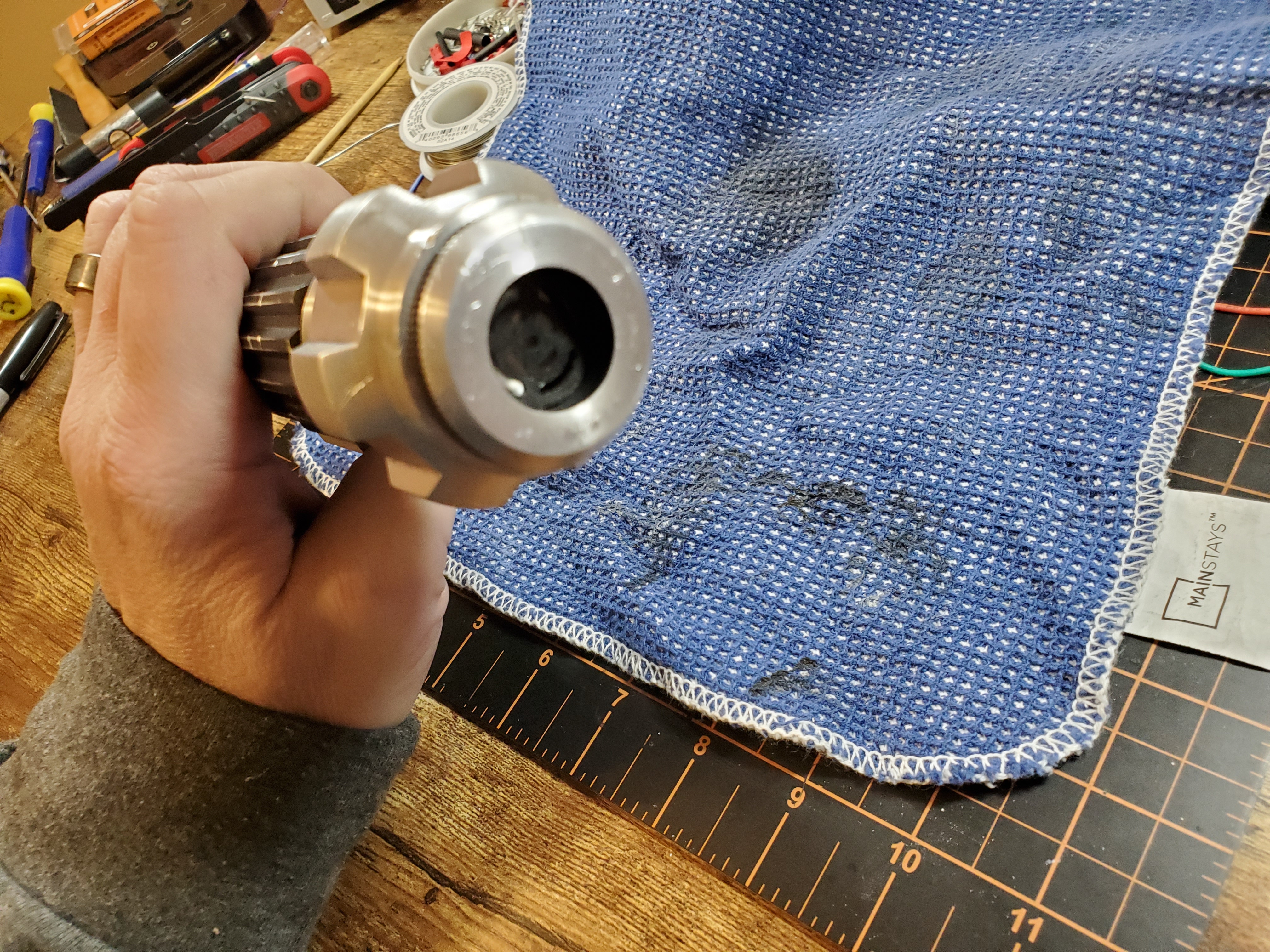

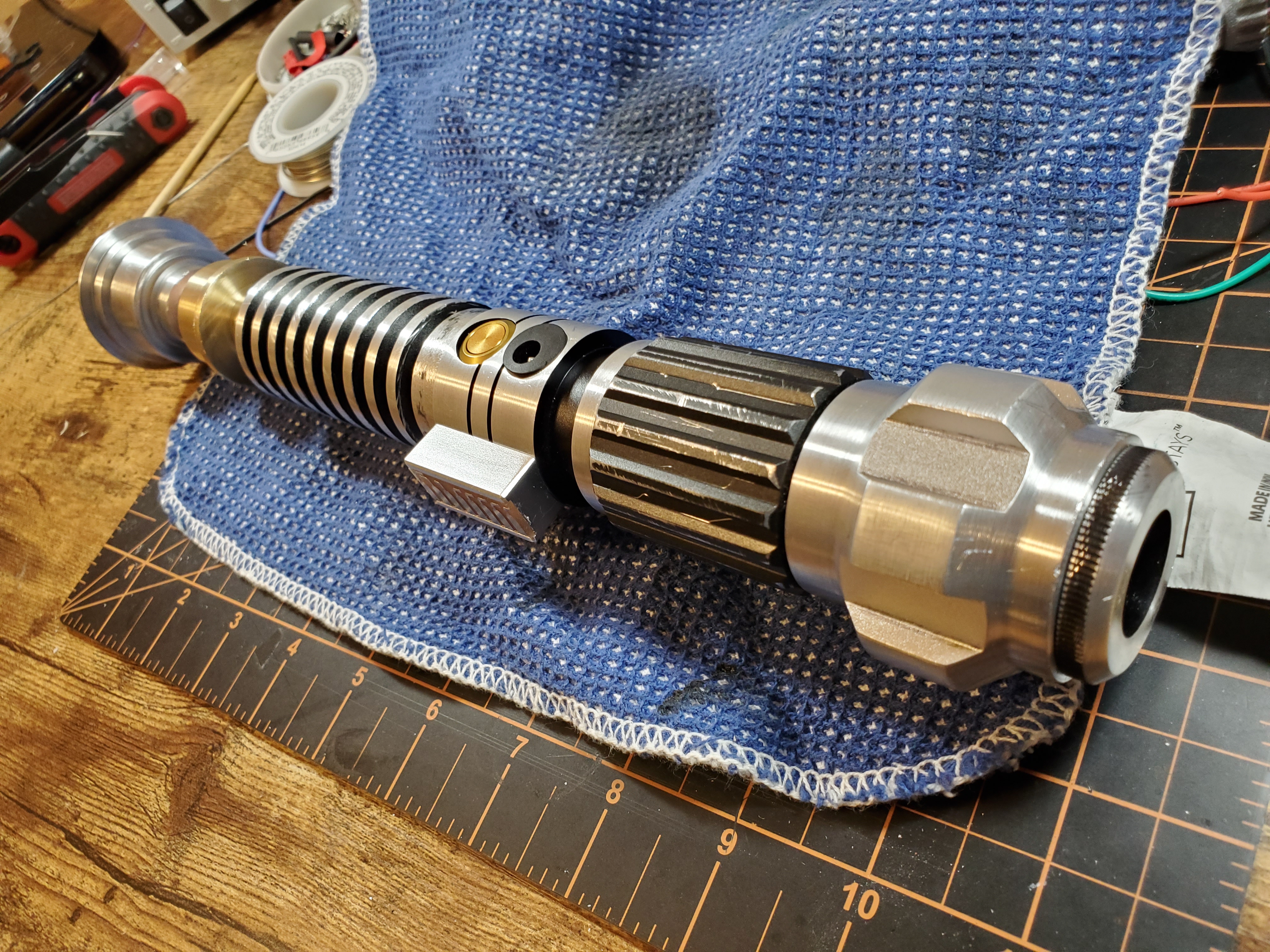

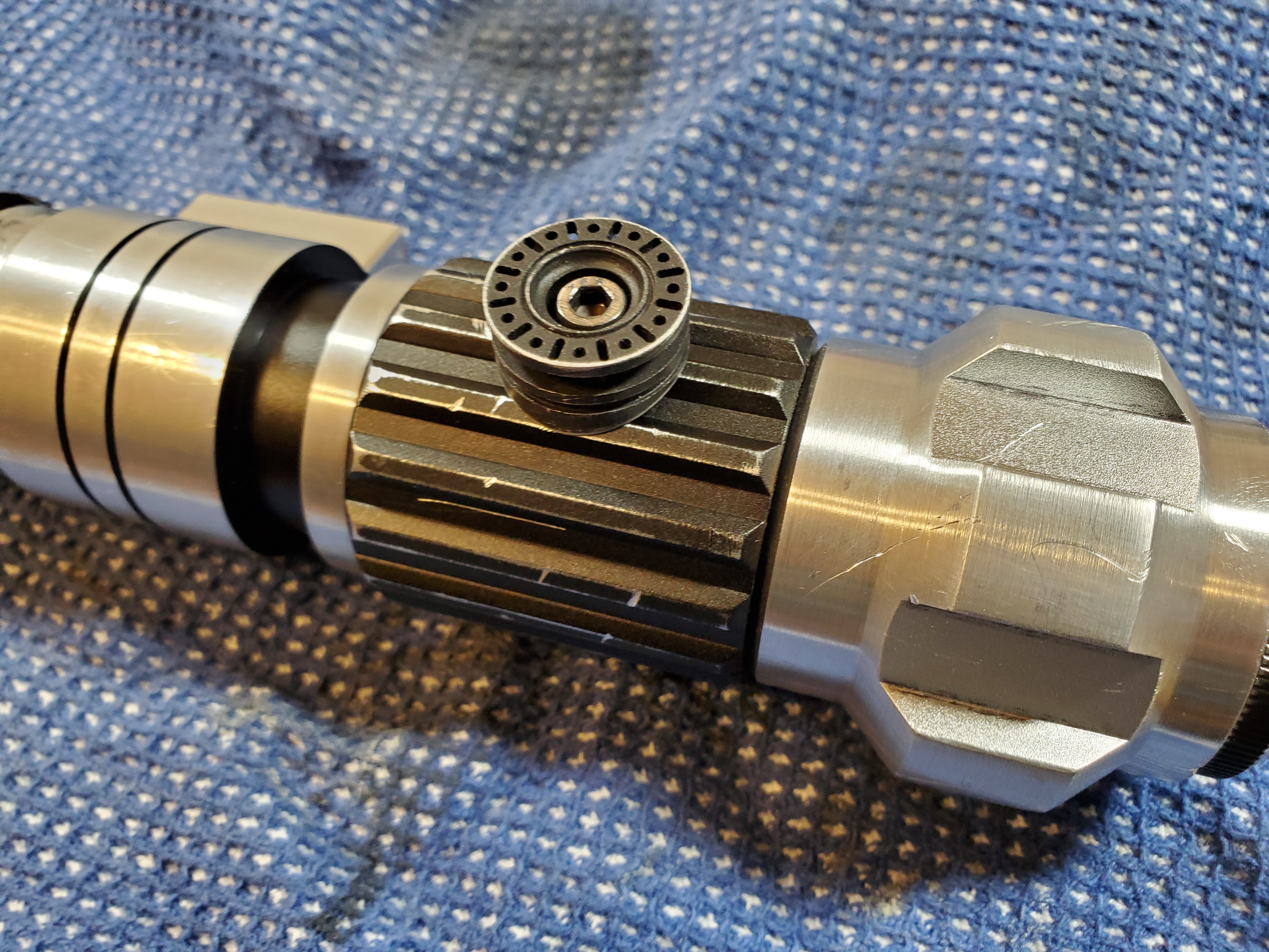

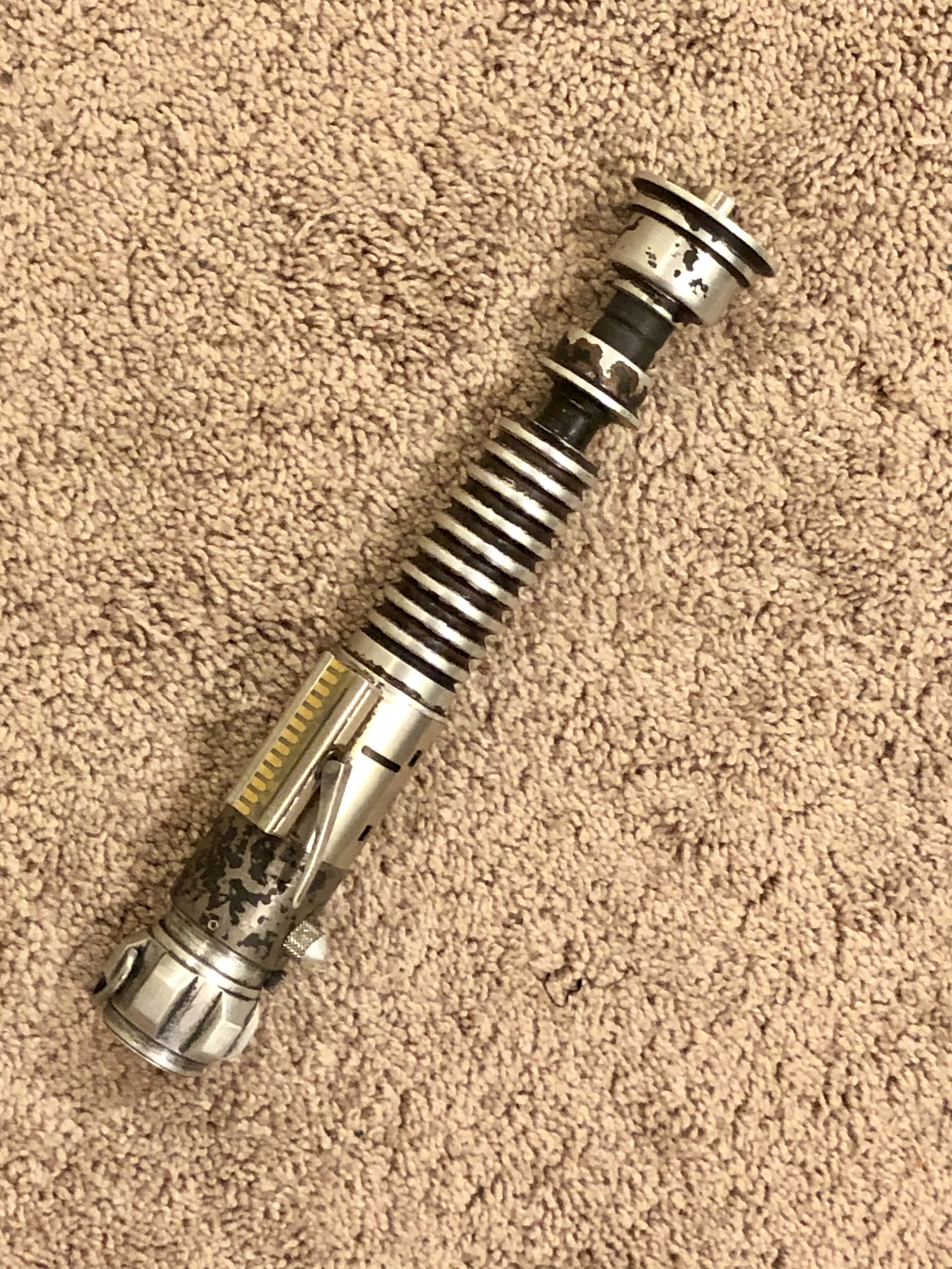

This is my mashup after scratch and dent and weathering treatment. I used files, dental picks and sand paper followed by steel wool, then treated with aluminum black, and another rub down with steel wool.

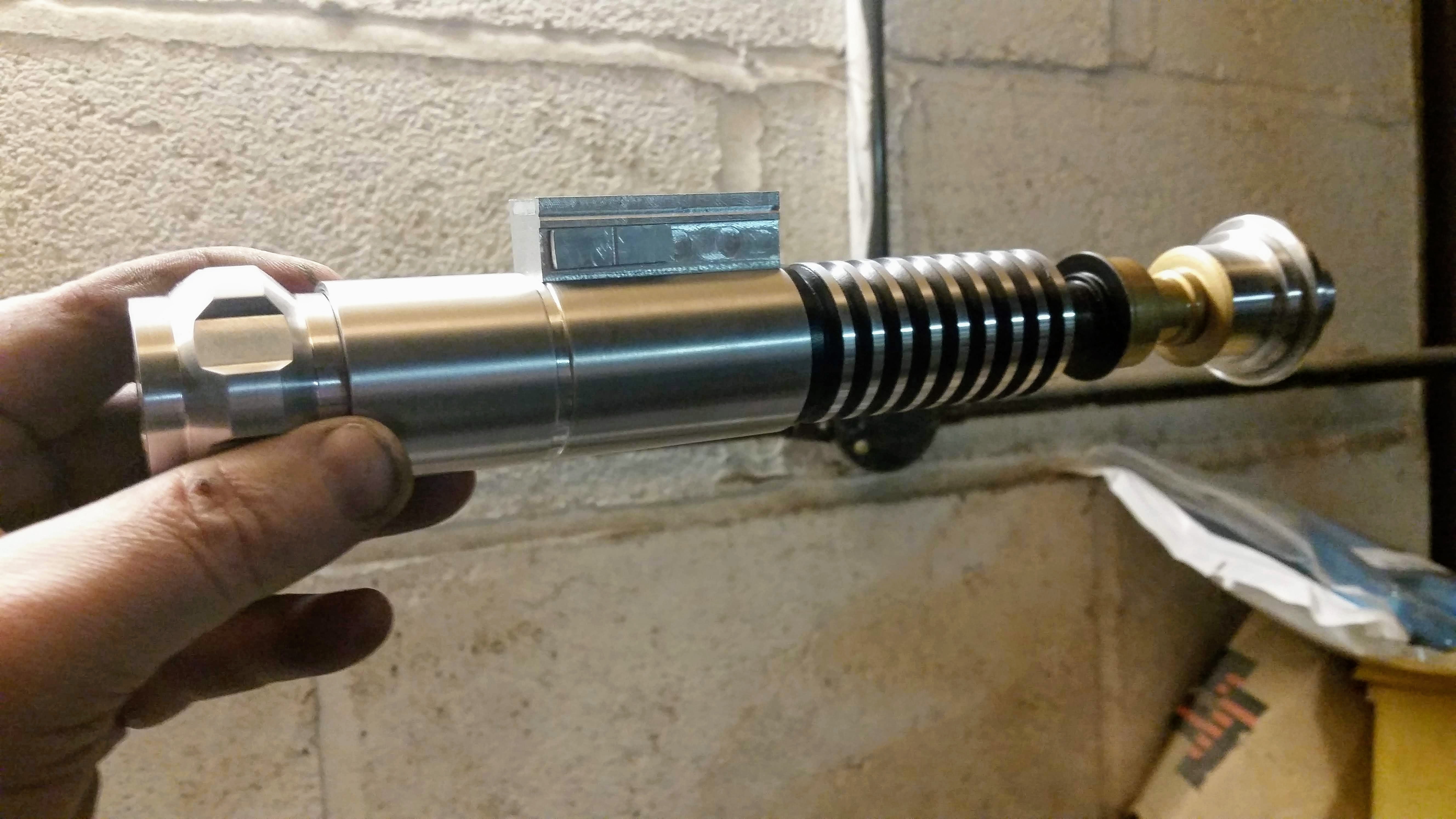

I have a DaveP/BRRogers Hero sitting around waiting for more electronics parts for the control box.... and my Yuma stunt was just saved by another member from a horrible injury and is awaiting new paint and a blade. in the meantime, I just finished this baby
