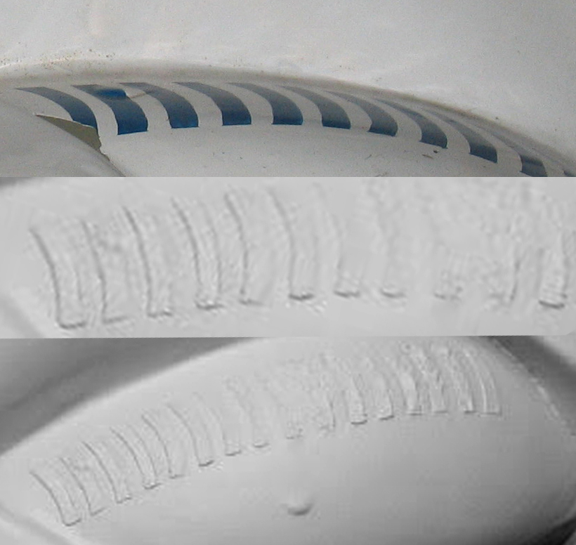

Thanks for the comments guys. I didn't do the laserscan, that was done long ago by Gentle Giant studios and is the same scan that was the basis for the original SFS fiberglass helmets and likely also the one used for their trooper bust (they changed it to a inaccurate symmetrical one for the new releases). The difference is in the way of fabrication - getting the 3D scan transferred into physical form. The original was milled/carved out of foam, whereas this is printed - built up from scratch, which is why it's possible to retain all the surface details as sharp as they appear in the scan.
Of course scanned from the outside, but that's pretty much the best option when you want to make a fiberglass helmet with all the details intact. Let's please not pull that type of discussion into this one, as I'd rather stay out of all that mess.

Yes, the mini helmet is pretty damn sweet as well. There are talks of pairing it up with a similarly scaled TM-G Vader helmet from my laser scan project.
It is my opinion that people put way more faith in laser scanning technology than they should.
It is by far not a perfect medium for replicating and will never be better than actual silicone touching the part.
Also, there is inevitable human error that comes into play as well when correcting flaws in the actual scan.
People's perceptions are that laser scanning can produce perfect duplicates in the real world.
But it can't.
It's not the same thing as a 'replicator' in Star Trek.
The more you understand this particular technology, the more you understand the advantages/disadvantages.
For example, observe some of the painted details.
It appears that the tubestripes and trap details are actually significantly raised off the surface on the scan modeling and subsequent print.
On that original helmet, they are not nearly as raised (if at all).
The cool part is that you don't have to guess where the paint flaking is... it's part of the cast.
You can see that on the original, there is a paint flake on the front tube stripe, whereas on the scan, the front tube stripe is intact.
Something is amiss.
Here's a hi-res pic of the original SFS helmet at almost eye level showing what I mean.
Laser scanning and printing is great and can be used very effectively in certain applications.
But to say that it can create perfect tangible replicas is not quite accurate.
It will never be able to accurately print surface nuances. That is one of the greatest limitations of this technology.

Never? Really?
I've seen LASER scanning technology make leaps and bounds over the recent years. In a few more years the resolution and accuracy will have increased exponentially even more than what's available today.
Never say never dude!
