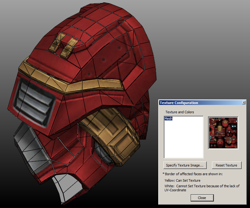

Alright so I'm working on a Red Ranger helmet for my husband using Pepakura and the first time I printed this thing out the number placement and such was a nightmare. I can handle a bunch of finicky parts when I can see why they're so finicky but around the mouth, I feel like there's a bunch of unnecessary spots where it really doesn't need to be that complicated. I'm using the Eye of Sauron red ranger helmet file (Of course I am. I legit can't find any others)
This is what I'm talking about
How would I go about simplifying some of the shapes around the mouth?

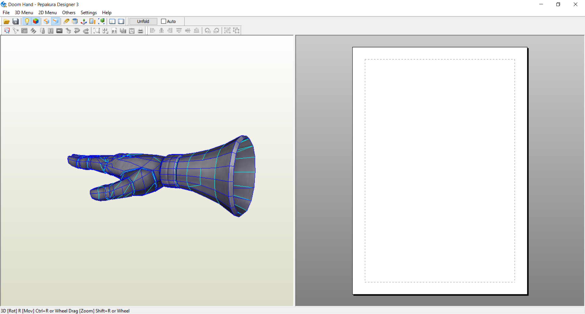

Is there a tutorial that will help me take an existing 3d model made by someone else and making a pdo of it to print easily. I've gotten this doom gauntlet before but idk where to go from here. Not sure if I needed to scale it prior to opening it in pepakura or what. I also know you need to use the open edge tool but Im not sure what parts you use it on.
JSGestalt
I am also super interested in how to start unfolding 3D objects.

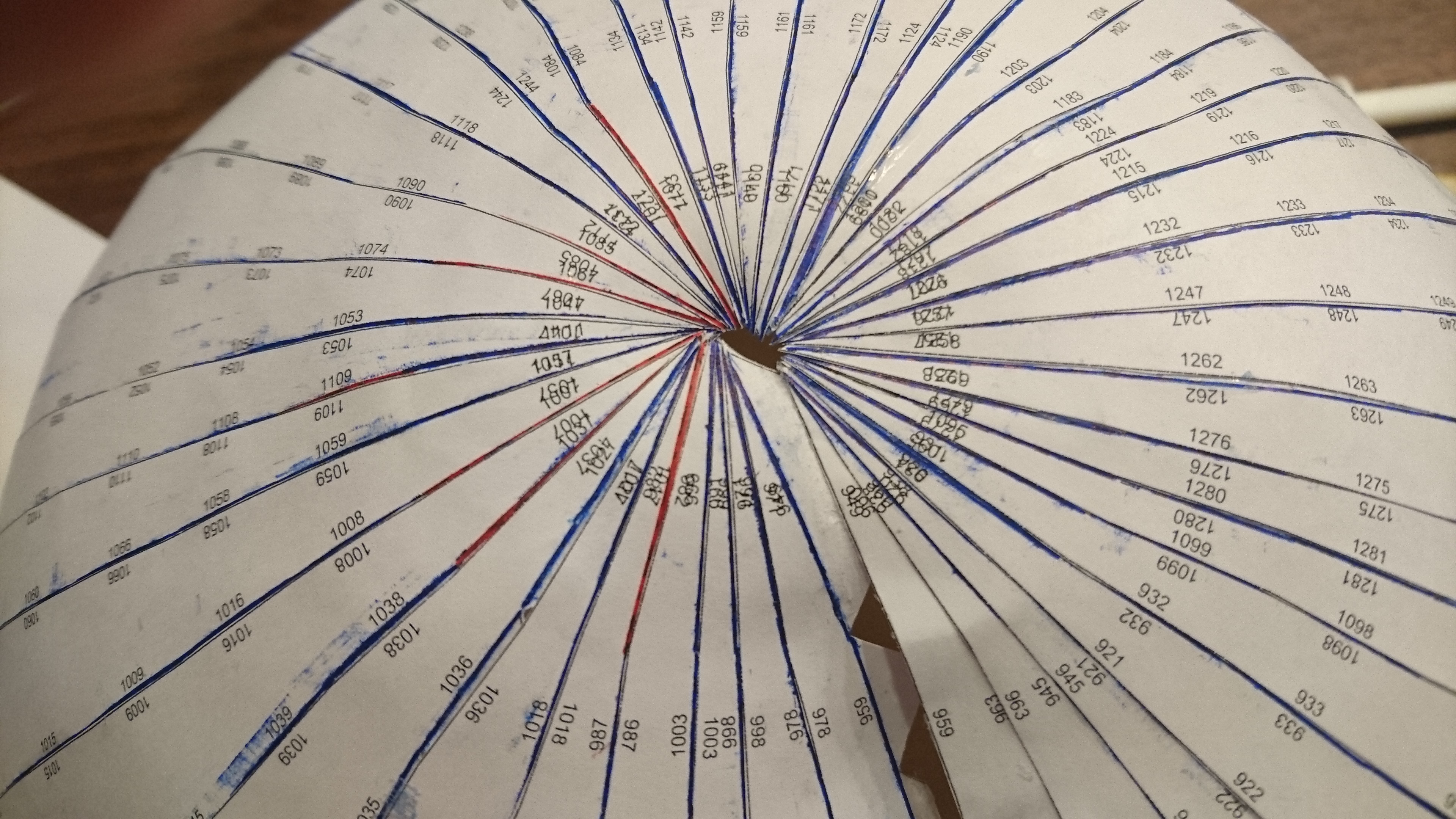

Im new to pepakura and im trying to make a stormtrooper helmet. I finished the top of the helmet last night, but realized that the edges dont properly meet and match as i havent glued the pieces perfectly (see picture below).
What would be the best way of fixing the displacement issue? Or do I need to start over?
