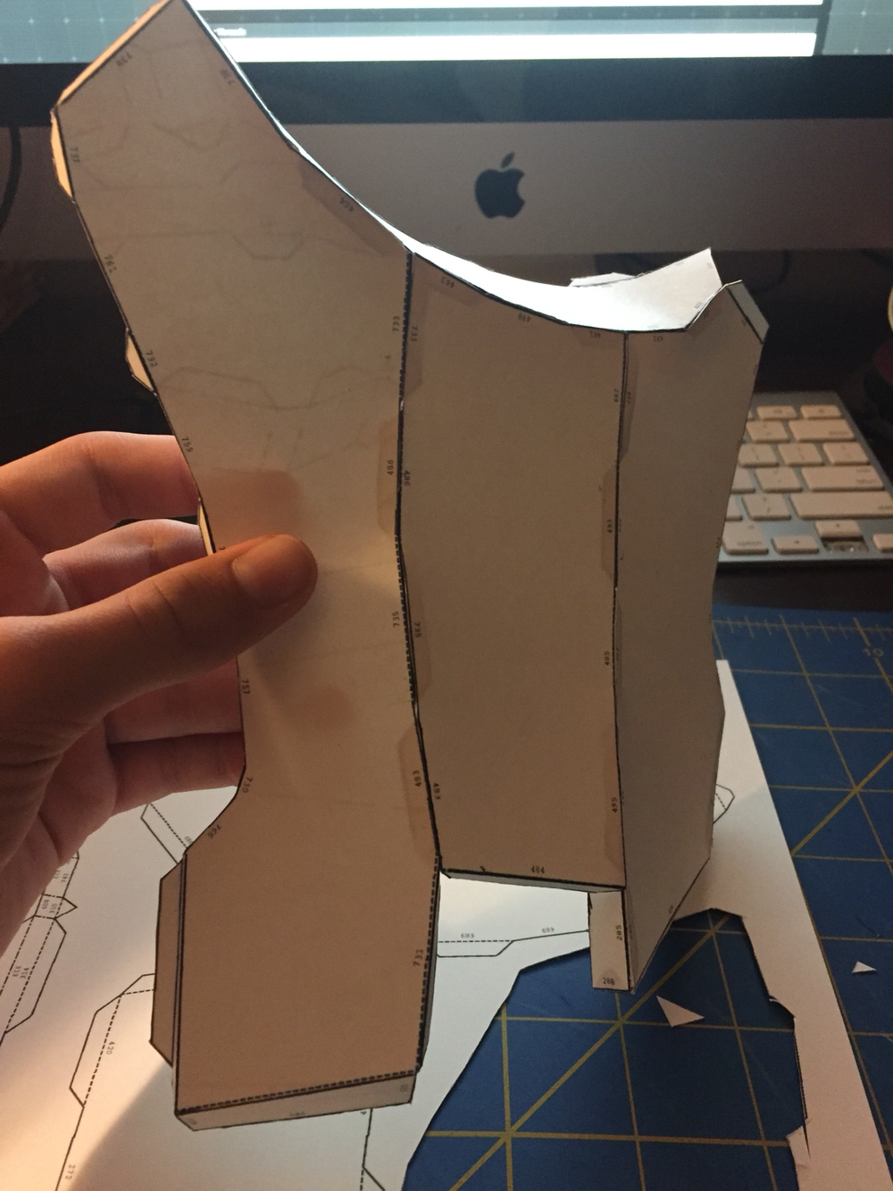

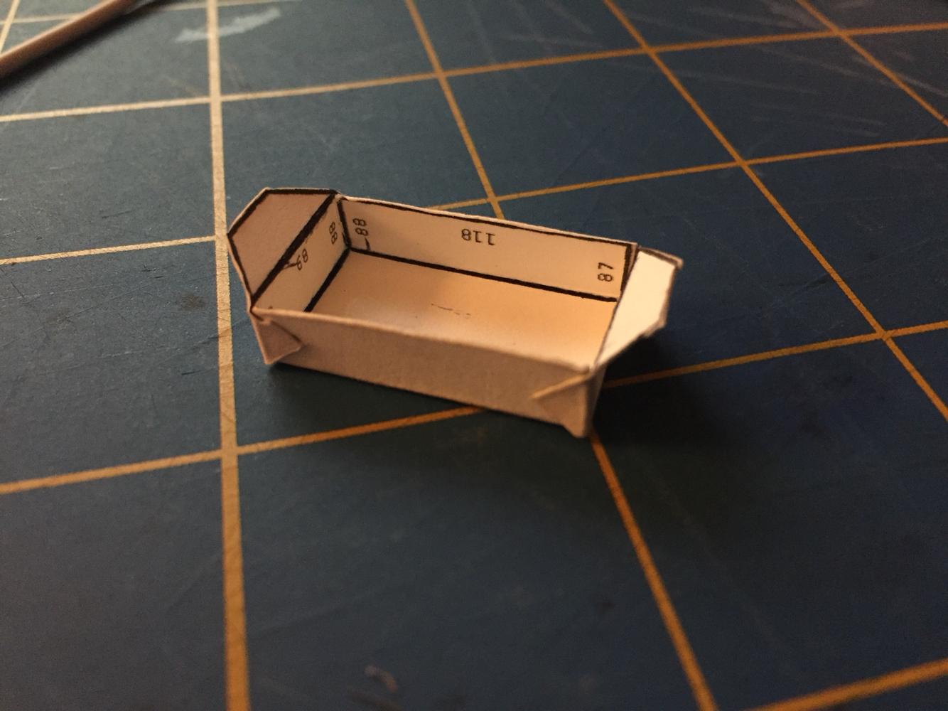

Thanks, I'm going to watch those videos ASAP. I have some thin craft foam that needs some using. :) Here's two pictures of pieces so far, I'm making a test shin. If it fits, make a second, if not, ad nauseam.
How clean is my pepping?
