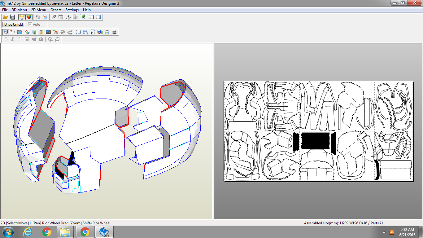

Another question, how do you go about assembling and attaching the ear pieces if the pep file has 'em like this?
I was pretty confused with this particular model, as well. I wound up assembling the ear separately, and fed the tabs on the upper part of the ear through the slit in the side of the head and glued them to the interior of the helmet, and then wrapped the bottom ear tabs underneath the helmet and glued them to the trim. I'm sorry if that didn't make any sense, but that's the best way I can think to word it. It definitely required some tweaking, though, as it wasn't apparent to me what the intended form of assembly was. If all else fails, you could trim off all of the tabs of the ear and just glue it directly to the helmet. Hope this helps!

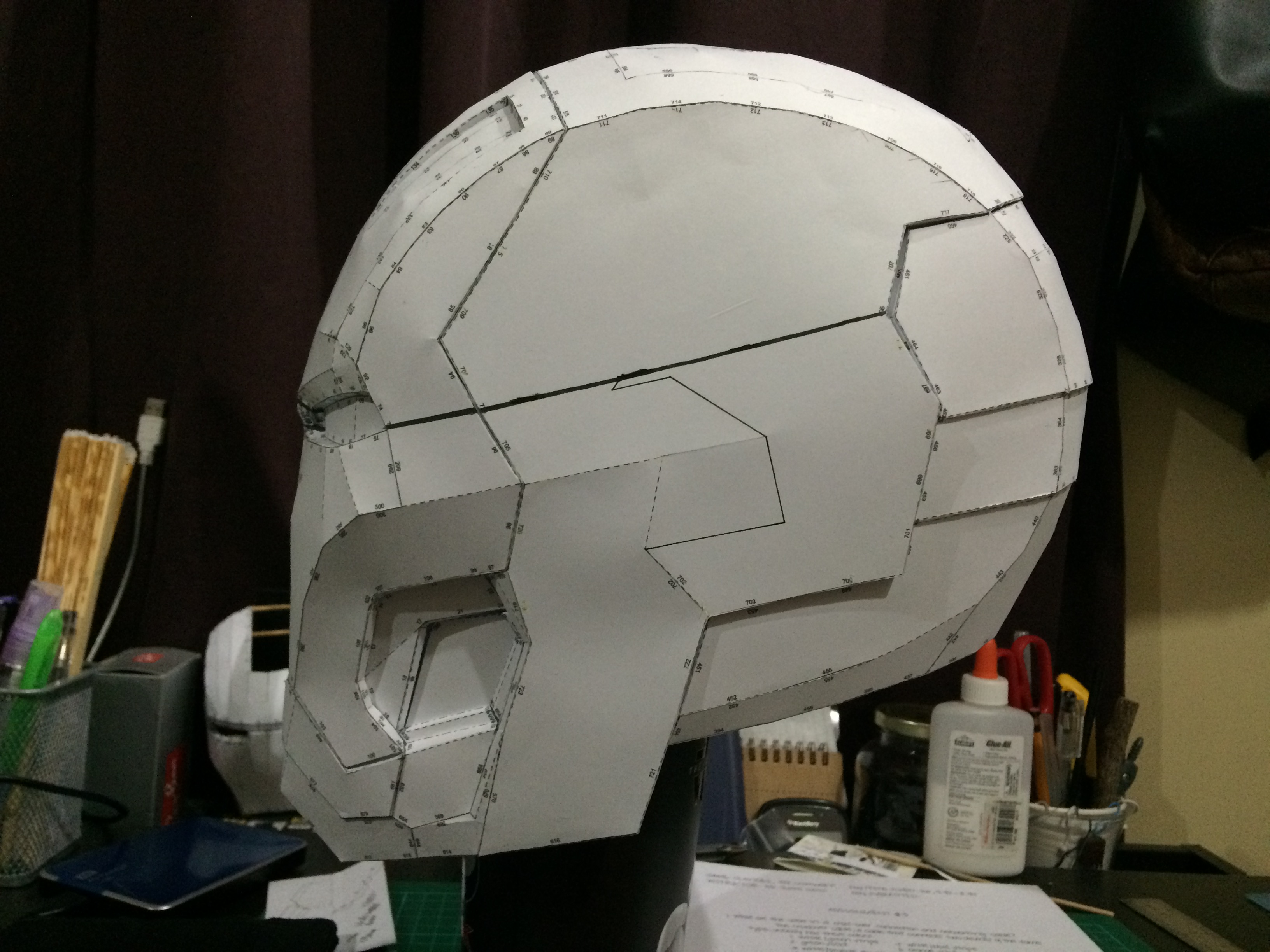

jonnytrooper Same! I thought about filling the ear pieces up with resin at first but I really want the extra space around the ear section. I think it will make for a comfy form-fitting helmet. I modified the earpieces then made pencil marks on the side of the helm where the earpieces are supposed to go. I'll cut that area out, then glue in the modified earpieces so I get a little more space on the sides. I'm just not sure if I should glue the ear on before or after the resin/fiberglass. Thanks for the input, though!
recklessjes That's genius! I wish I would've thought of that. My helmet fits well, but I definitely could've used that little extra space for the ears. Make sure to post pics when you're done! I'm actually still working on this one, myself.
jonnytrooper thanks, I'm still working on a Mark 42 gauntlet as of late (yep, I'm working on two projects simultaneously). If you don't mind me asking, do you have a build thread for your helmet? Once I start working on my helmet you'd be the first to know :lol
