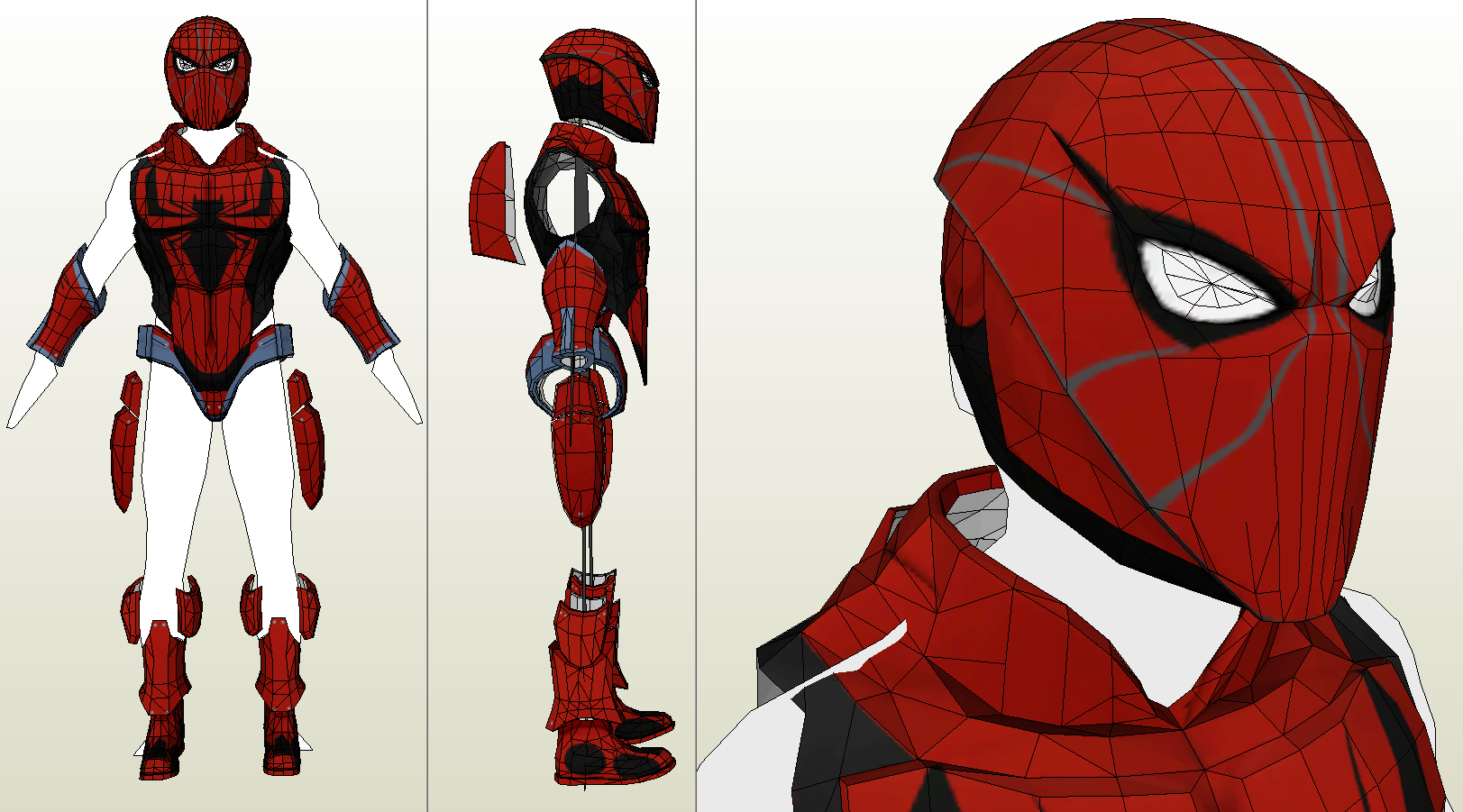

Hey guys I'm a big noob in pep but I was considering a free hand attempt at this beauty. So before I even pick up some tools I was wondering If anyone had any files for this beautiful spidey armor? Thank you very much in advance. :)View attachment 293089
maybe this could help you ^^
Splitted: Darhood's_Spider-Man_Armor (EotE) (Pep) - Download - 4shared - Elvis Dunkly
All-in-one: Darhood's_Spider-Man_Armor (all) - Download - 4shared - Elvis Dunkly
