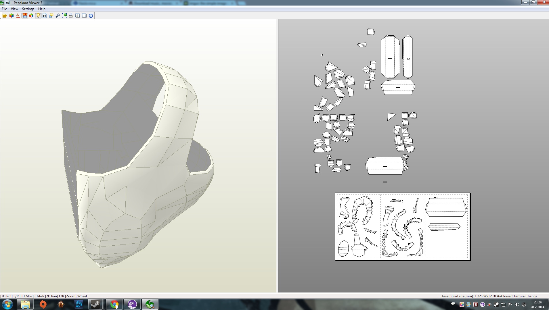

Hey guys, can someone pls help me with this problem? it seems like some of the parts aren't on the paper...
EDIT:nvm guys, downloaded the designer and seems that it works :)
Hey guys,
Im having some problems with printing.
When i have my settings to Vector Print, it wont print out any pieces, but when its set to Bitmap Print, it prints a whole black page.
Anybody know what i am doing wrong? other documents print out correctly and even other projects will print out clearly

Hey guys,
Thanks,
Atmosph3r3
Corrupted .PDO file can cause that. Best bet would be to try and find another copy of the file. Also, make sure your printer drivers are current.
It's my own file, could that have anything to do with it?
It's possible. If I were you, (and yes this is a bit of legwork) I would open the .PDO, extract the .OBJ, import the .OBJ into something like Blender, now export the .obj from Blender, and then reopen in Pepakura. You'll lose your original unfold, but it may fix your problem. I've had files corrupted by the settings in my modeling software, and by Pepakura itself because of structural problems in the model that Pepakura has problems reconciling. The export-import-export trick has worked like a 'cleaner' of sorts for me in the past, and the final .OBJ converted to .PDO and printed fine.
An afterthought, make sure you've got the newest version of Pepakura too :)
