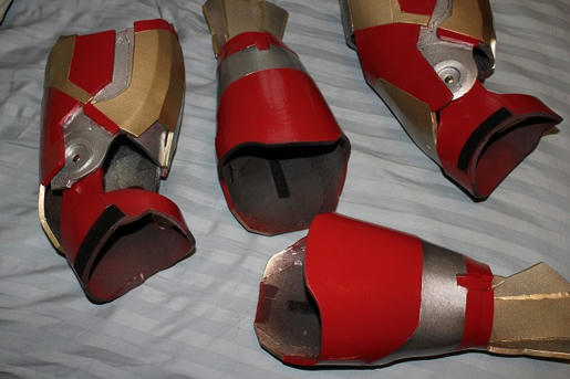

Hey all, just a small question. Does it really matter what kind of chicago/binding post screws I use? Also, is it possible that someone has a diagram of where to place washers and the screws to join two pieces.
Any help is appreciated, thanks. :)
I use 1/2" chicago screws from amazon (I build with 1/4" foam). For elbow and knee joints, I just add foam tabs so that the joint overlaps on each side, and then approximate the pivot point. You can also make adjustable joints by adding velcro to the inside of each joint. You then make the joint with the Chicago screw connection separately, glue velcro to each strip, and then attach it where it works best and spaces the joint correctly. It gives you a bit of extra adjustment room for length as well. Here's a Mk42 arm I added the velcro too, so the length is adjustable. In this pic, only the forearm-side is adjustable:

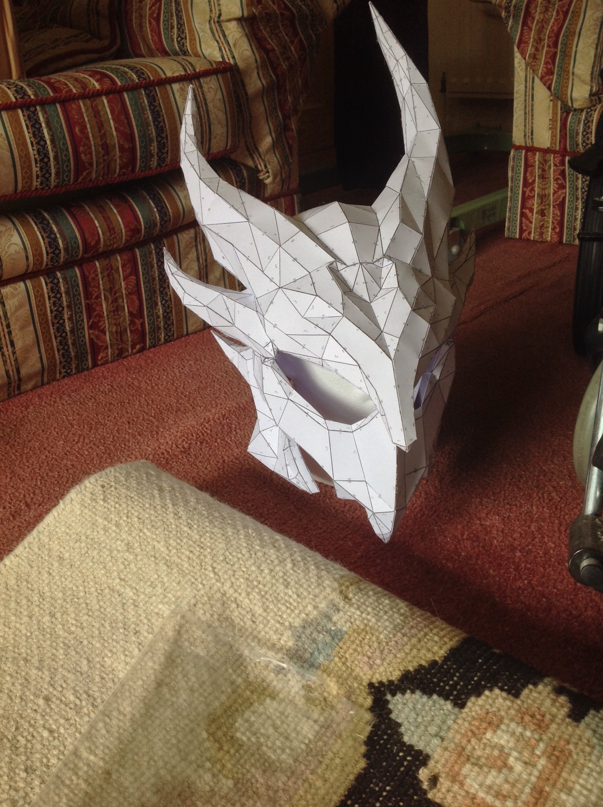

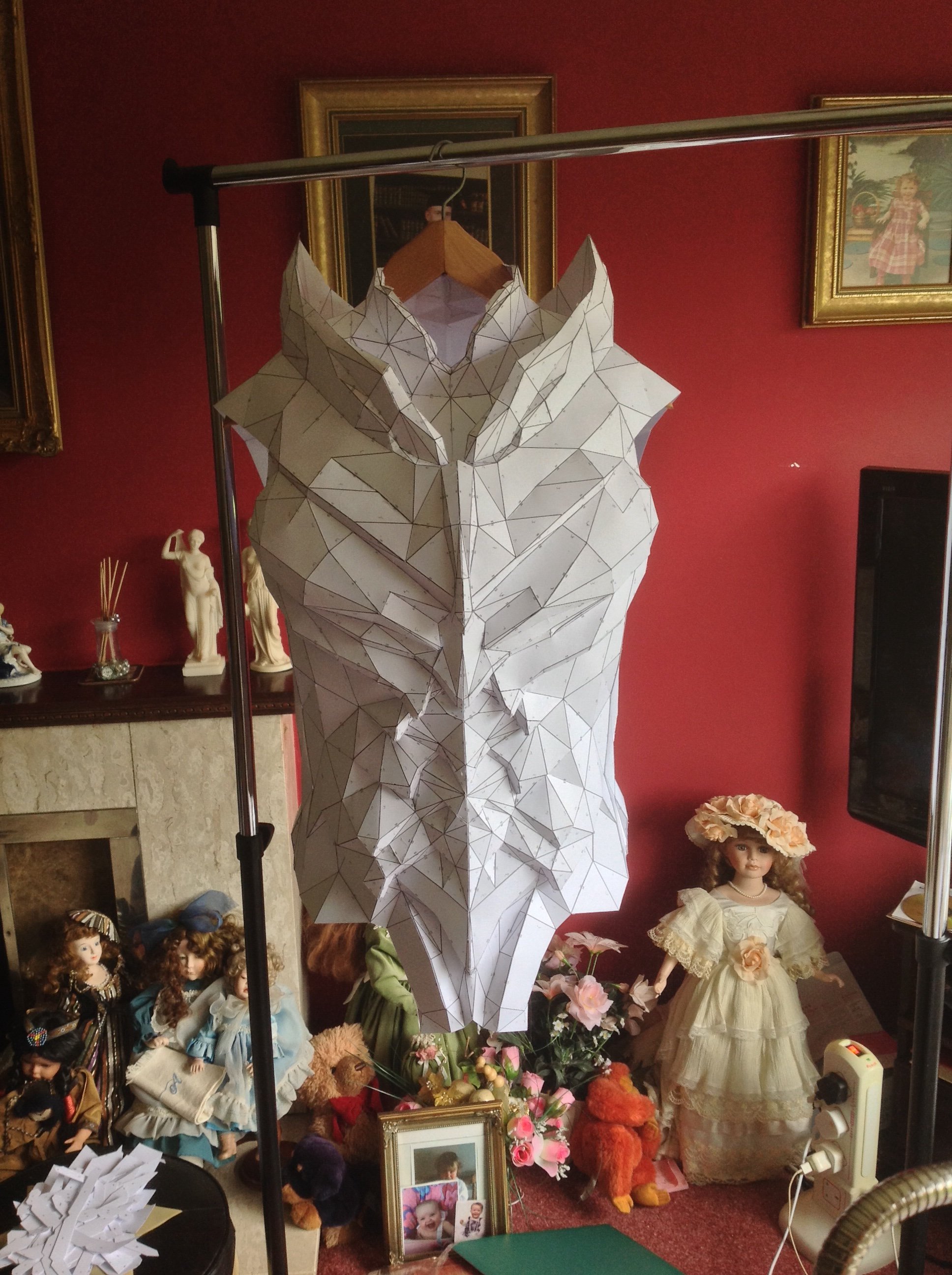

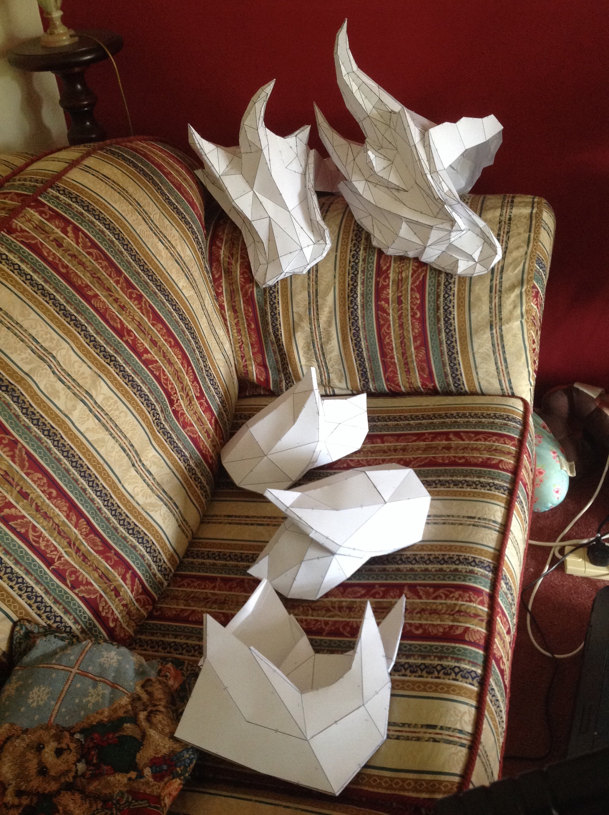

I have a few questions. Please refer to pictures in relation to my questions.
1. For pepping, I used 280 gsm card stock, I'll be using epoxy with a slow hardener. Are supports really necessary? If so, when doing the inside, do I just work around the supports then fill them in later or take them out before I start?
2. Do I / should I fibreglass the inside before or after the outside resin coat dries?
3. Do I/ should I resin the inside as well as the outside before fibreglass sing the inside or is a resin coat only needed on the outside prior?
3. I assume by build will need to be done in sections, should I start at top or bottom? Specifically with helmet as I would be worried if I did horns first, their weight could promote warping.
4. As I will be using car filler and sanding, how do I go about preparing the horns/ spikes for this, as getting fibreglass mat the whole way up and around May be a bit tricky. (Also is it necessary to sand the resin before applying filler?
5. I'm going to have to cut the armour to get it on as I have did a pretty decent job of sizing it. Am I best just seperateing the whole thing in half or (because it's not exactly a flat build) should I cut the collar out, then cut it in 2 and cut a back plate out of the torso?
6. Should I cut after fibreglass or after the car filler?

1: Definitely use the supports. The weight of the resin adds up quickly, as it is also soaking into the paper and weakening walls. I add additional temp supports just to reduce warpage.
2: Let your external coat cure first. You can add a second coat as well to increase the rigidity, it won't hurt the piece to do this. Once my external coats are dried, then I tear out my interior supports and apply resin inside. You can also hit the piece with a heat gun at this stage to remove warpage issues; It's a lot easier to do it at this stage than after mat/cloth has been added.
3: (part a) You don't have to resin the inside before fiberglassing, but it's a good idea to be sure the paper is getting saturated with the resin on both sides. Otherwise you can get separation between your first layer of mat and the paper if the mat doesn't soak enough resin through. You probably should also do some research to make sure your epoxy resin and your fiberglass resins will work together as well before starting on a finished piece. If they aren't compatible (they may not bond together, the heat of the fiberglass resin cure might affect the epoxy, etc) you could end up ruining pieces.
3 (part b): Sections are better for larger pieces. The more reinforced your piece is, the better. On larger areas, I will resin the edges, and then 'paint' resin bands across the piece to connect the sides. That first resin coat will dry as a kind of a skeleton, with the bands now working as bridges of hardened paper. I then resin in the missed spots on my second pass. Warpage is going to happen no matter what, but it takes a lot of the stress off of the paper while wet doing it like this.
4: For your horns: After the hardening resin coats, I'll dip patches of fiberglass mat in resin and push them up into the inside of the shape (doesn't have to be perfect) so that the very tip ends up with a ball of resined mat. You can continue with that a couple of more times if needed until you can reach in and lay mat by hand. Spray adhesive on your mat or cloth is a big help too; you can lay most of the mat into the inside of the horn before resin ever touches it. I just scuff my resin with a course scotchbrite pad before applying filler.
5: That torso is a monster. After it's all resined/bondo'd/etc, I would look at cutting the collar out like you said. You could add a flange around the collar so it can be worn as a bib that the rest of the torso would lower down onto. Once again, just me, but I would cut the rest of the torso in half (from the sides), following the natural shapes and curves to hide the seam. Add hidden strapping under the front and rear shoulder areas so they could be snapped together there, and rare-earth magnets on the sides ot hold the 'clamshell' together. That's just me though, that's a challenging piece, it's so loooooong.
6. I cut after. The filler might chip out somewhat on you, but your seams will already be lined up and level.

Thank you for all that info. I've a better idea on what I'm doing now.
however, just to clarify, my epoxy is industrial boatbuilding resin and is used as fibreglass resin, so no compatibility issues to worry about to my knowledge. =)
what sort of supports would you recommend and placements?
also would you suggest resining the horns on the helmet last? As they would get heavy.
Sorry for all the questions, but tbh the resining is daunting to me as I've never done it before and really don't want to put all that hard work to waste. Lol.
