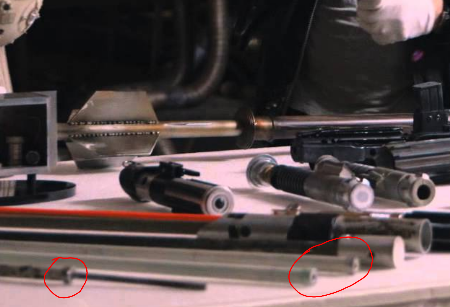

If these blade collars are set into the cores, and they certainly appear to be, then they are only set in by a few mm.
Idk Kurt, if the 8mm rod only goes up the blade a few mm I see a chance of these not working
I think the 8mm rod traveled up the blades a good distance
This is why they hacked the blades off the dv6 and v2
I'm not talking about the inner 8mm rod, but the outer (20mm approx.) collar.
The same collars Tom is refering to in his post that precedes mine.
Look how short they are.

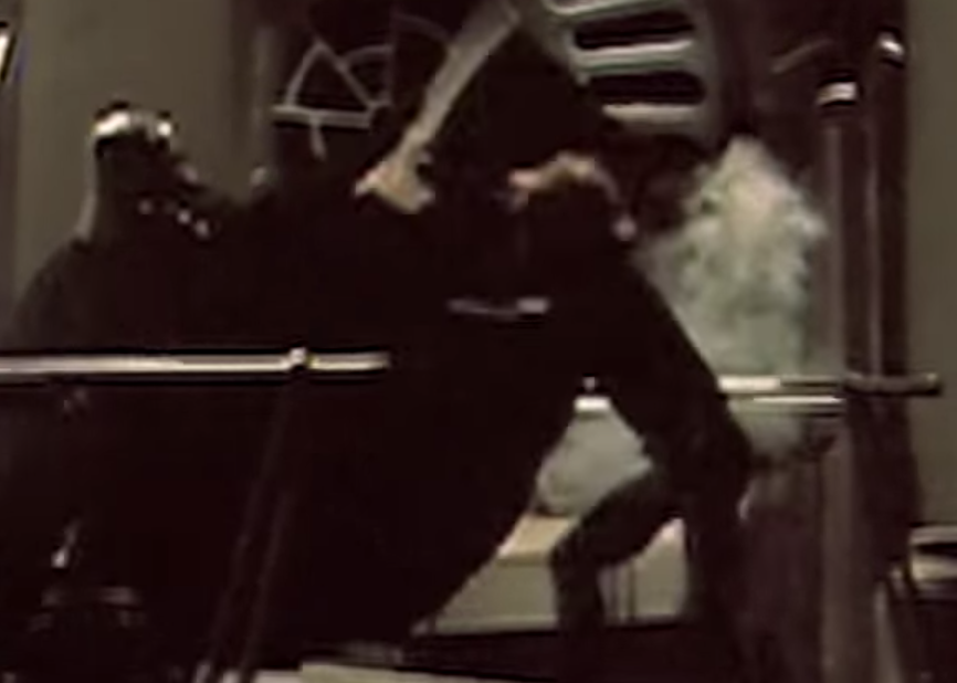

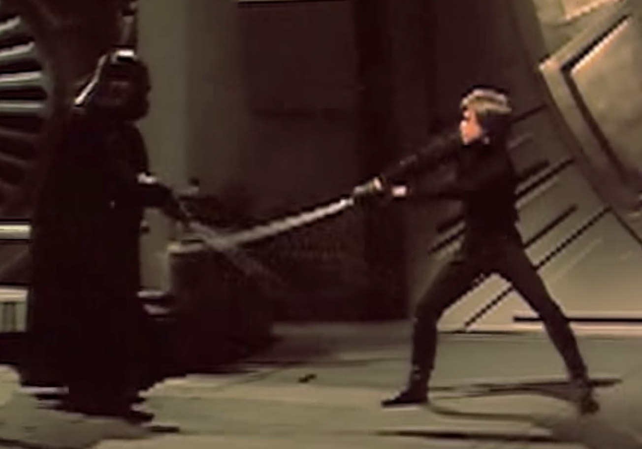

I noticed this piece of bending while looking for something else. Very flexible blades in ROTJ so has bearing on what they were made of.
(loop starts when blade is at it's highest ends on bounce back from rail).
Bottom pic is conservative on how much deflection is going on but we're getting close to 90 deg.
This just before he starts wood chopping at DV & the blade flying off.
Wow, yea, here are some other moments of pretty intense bending.

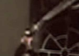

At least for this part of ROTJ it looks like they had clacking flexible material, it does sound like metal after the blade flies loose, making me think old graphite material
it does barely look like there is a tang in this blade that flies out
Screen Shot 2019-03-29 at 7.06.19 PM.png Screen Shot 2019-03-29 at 7.06.24 PM.png
I did notice that after that blade files out there is no rod sticking out the emitter. The tang must be that rod (like the one sticking out of the DV6 emitter). It must've come right out of the core still attached to the blade.

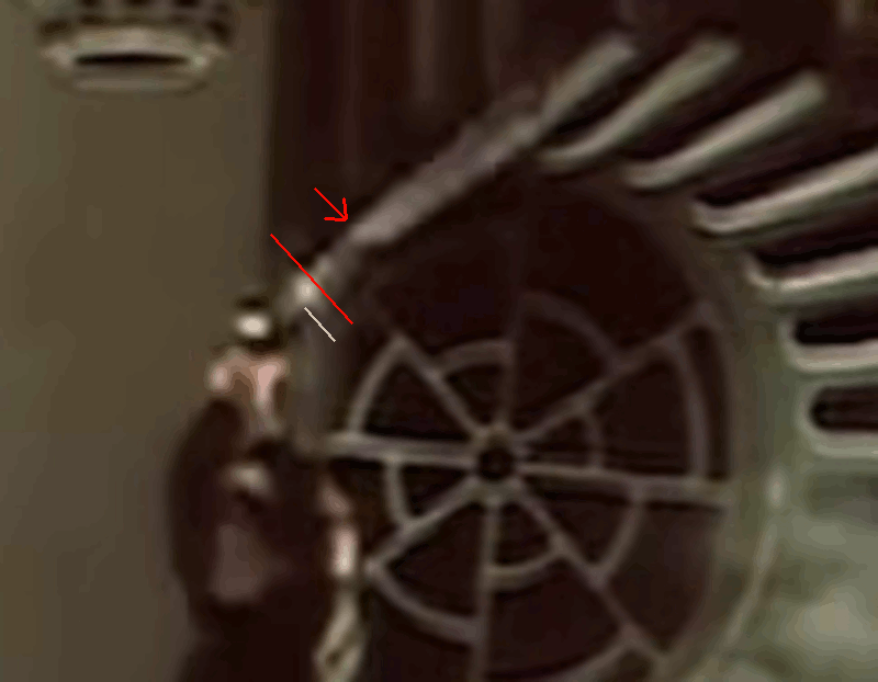

Using those two consecutive frames I have isolated the detached blade, rotated it & overlaid it on the preceding frame, using the arrowed distinguishing feature to line up the two images. The red line is approx. where the face of the emitter is & the white line is where the end of the (detached) blade reaches. This indicates that there is, indeed, some portion of the blade extending into the emitter & pos. as far as the neck.
I hope that makes sense to you if you examine my gif.
Bear in mind these are very blurry images so we can't be sure what that inserted part might be - for instance it could be some sleeve in the hilt that the blade is attached to that has come out with it or it may be a tang on the blade as suggested. This only tells us that the unit that flies off is longer than the exposed blade is situ.

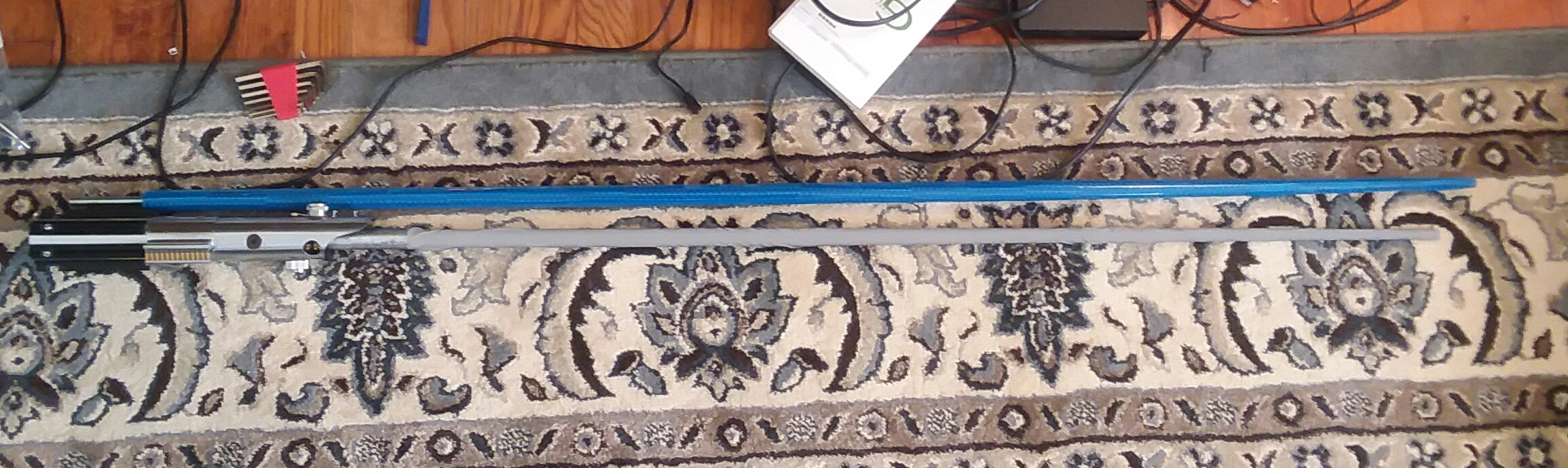

I finally joined the camp of successful (ish) reflective wrap. With wrinkles of course. This is a graphite golf club with a double collar (inner and outer) but the outer collar is too long. Just an experiment but it worked!
That adhesive is a fighter, this was the third time I wrapped thus golf club. Basically I cut a trapezoid of the right length and trimmed it after wrapping too, as to not get too much glue at the edge

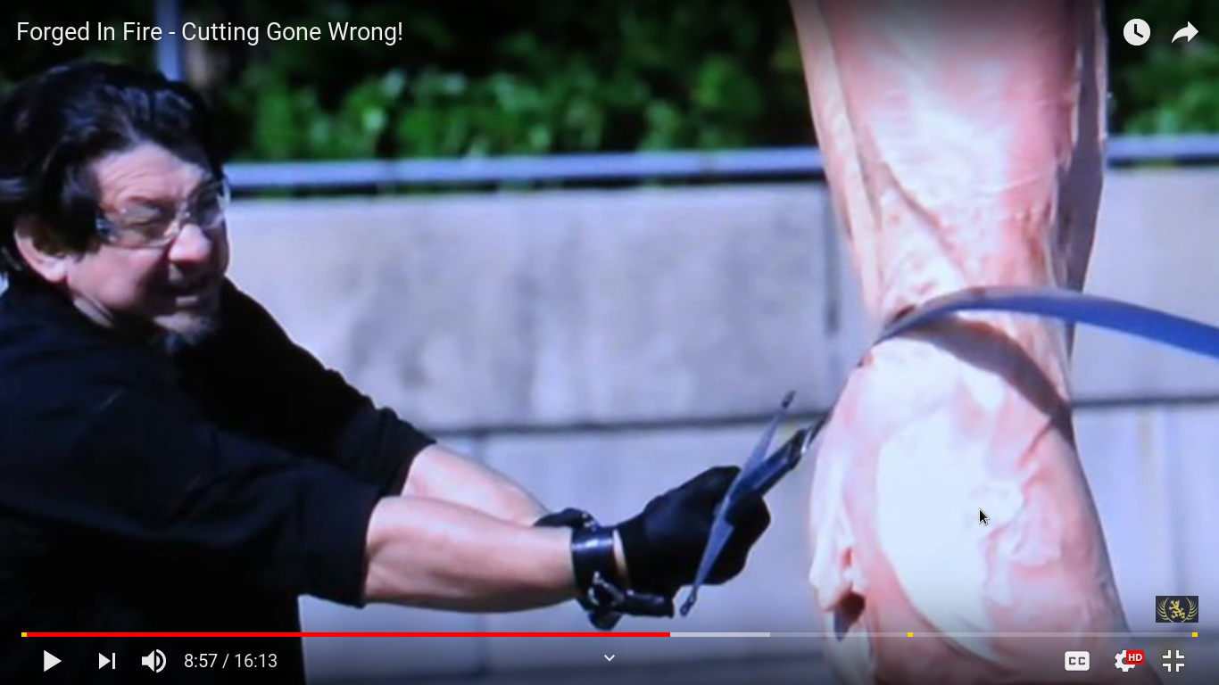

Something that you might bear in mind with these stills of flexing is that what we can see in photographs isn't what we necessarily see with the naked eye - correct me if have the wrong end of the stick with the above quote.
Also I'm not aware of what you know or don't about what follows but I am aware others read this stuff but don't comment & they may not know any of it.
For instance there is this still from forged in fire.
I can't find a motion clip but I did watch that episode & this flexing just doesn't register at full speed. The human eye works about 24 fps which is why movie camera's go at that speed, so what you see is all at 1/24 th sec exposure - if something moves then moves back faster than 1/24 second it will appear stationary. (strobing is a form of this)
It's the basis for a lot of what stage magicians do - literally the hand is faster than the eye. It's also why so much of this flexing that we're pointing out seems so 'extreme' it normally happens so quickly that we actually don't / can't see it.
edit; another good eg is archers paradox & the 'snaking' of arrows in flight, too fast to see under normal conditions.

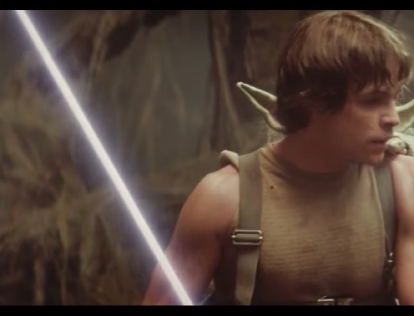

I remember a shot from ESB where Luke's blade shattered on Vader's helmet in the Dagobah Cave. Is this a comparable swing? Does that mean they were different materials?
The Degobah cave head whack doesn't look, to me, anywhere near as hard as what Mark H is putting in on that hand rail, even on a frame by frame basis.
In both cases the point of failure is at the hilt / blade joint, which is where most stress is generated.
In ROTJ something that is inside the hilt (blade stud or hilt stud) exits too, in the Degodah scene it looks like the blade actually breaks at the base. As far as I've come across so far these are the only two blade breaks documented & because they are different failures don't give us a clue if they are the same stuff or not.
