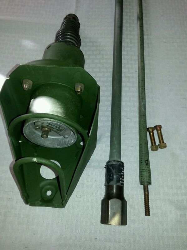

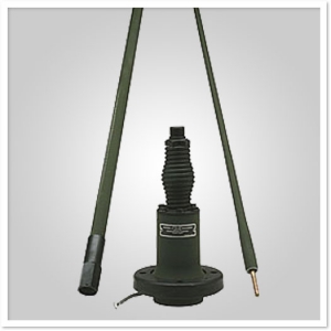

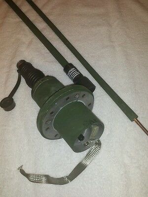

So its a marine antenna, not a military grade antenna. I only ask because of the gigantic amount of surplus the studio bought back then. see attached british and US military grade vhs antenna.
