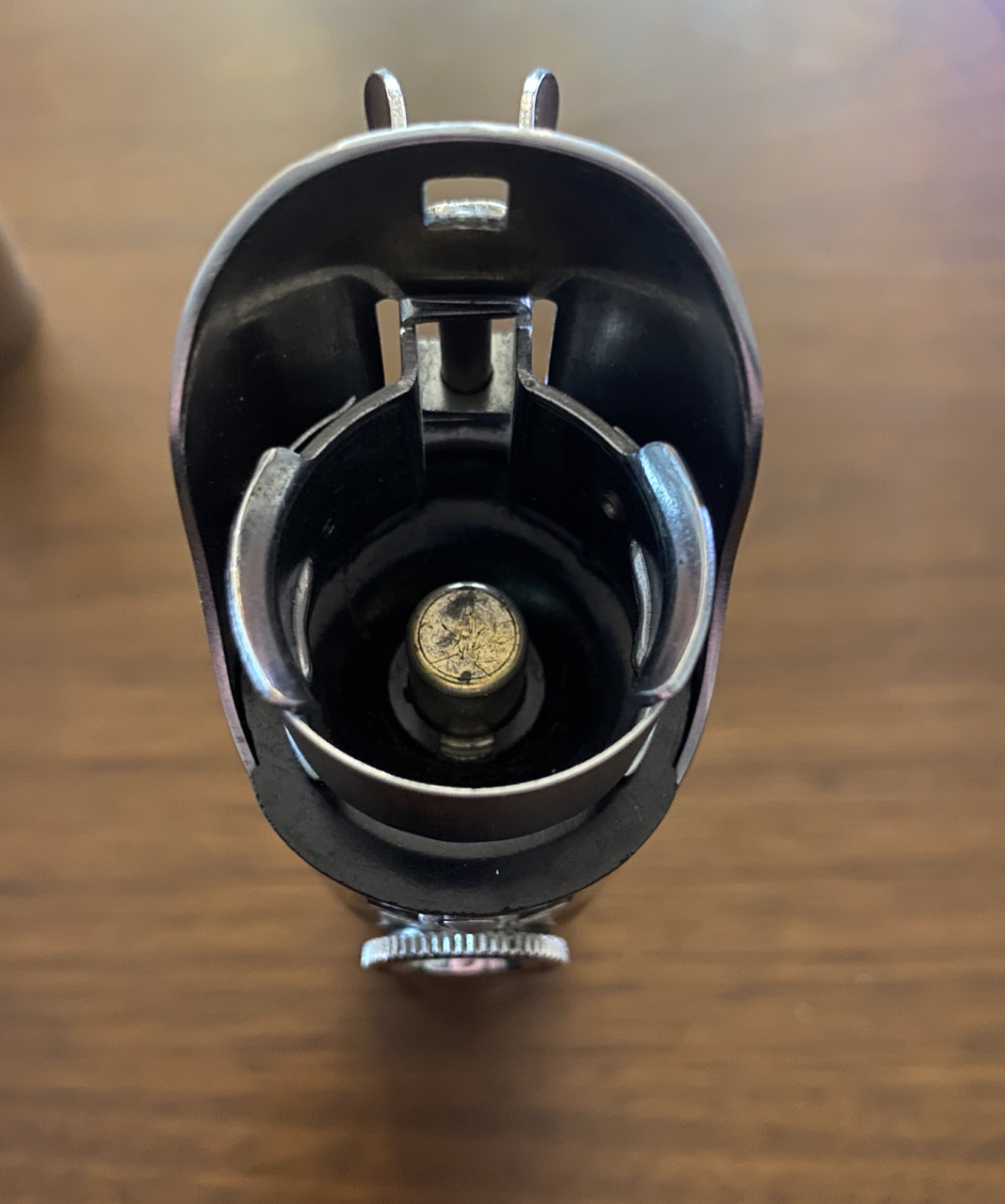

So it slides over this brass bit with the grub screws holding it?
No, that‘s an unmodified Graflex 3-cell or replica of it. Those were used as belt hangers or hand-held props without any physical blades attached to it (with one exception at the Wampa cave in ESB propably). The stunt lightsaber hilts were modified in a way that the inner elements have been removed, and a solid metal core was inserted and fixed to the outer Graflex shell using some strong screws. In the center of the metal core was a metal rod sticking out of the handle for about two or three inches, the stunt blades slid over the rod and were secured with grub screws. I‘m on my wife‘s iPad atm and can‘t post pics unfortunately. Tom, can you chime in, please?

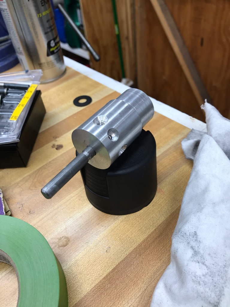

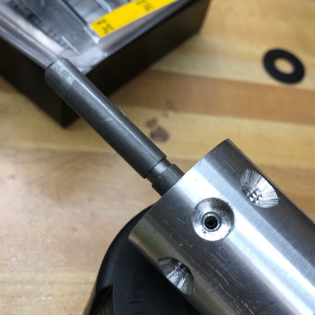

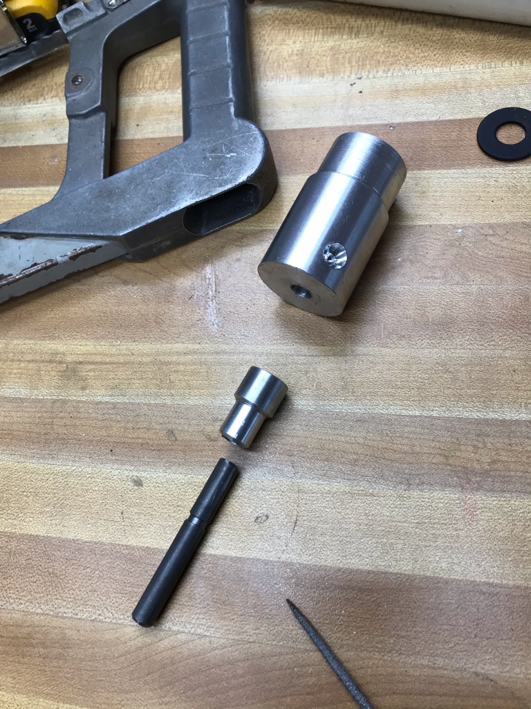

2Cell, the props used for dueling in ESB and RoTJ were gutted flashes, which held a aluminum core, where there was a rod mounted into the core. Which we now refer to as the “Delmonte core” since Tom is the leader is research of this core setup.
The blade which looks like was a antenna of some kind, was modified to slip over and lock onto the rod sticking out of the core
This is what production used for dueling in ESB and RoTJ
Here is the core I design after toms setup
Many flashes were modified with cores, including blank pipes they dressed up to look like a graflex
Pipe stunt in center with blade attached, core with blade attached in man in right hand
You have to check out tom’s thread, he has done a ton of research on the core
