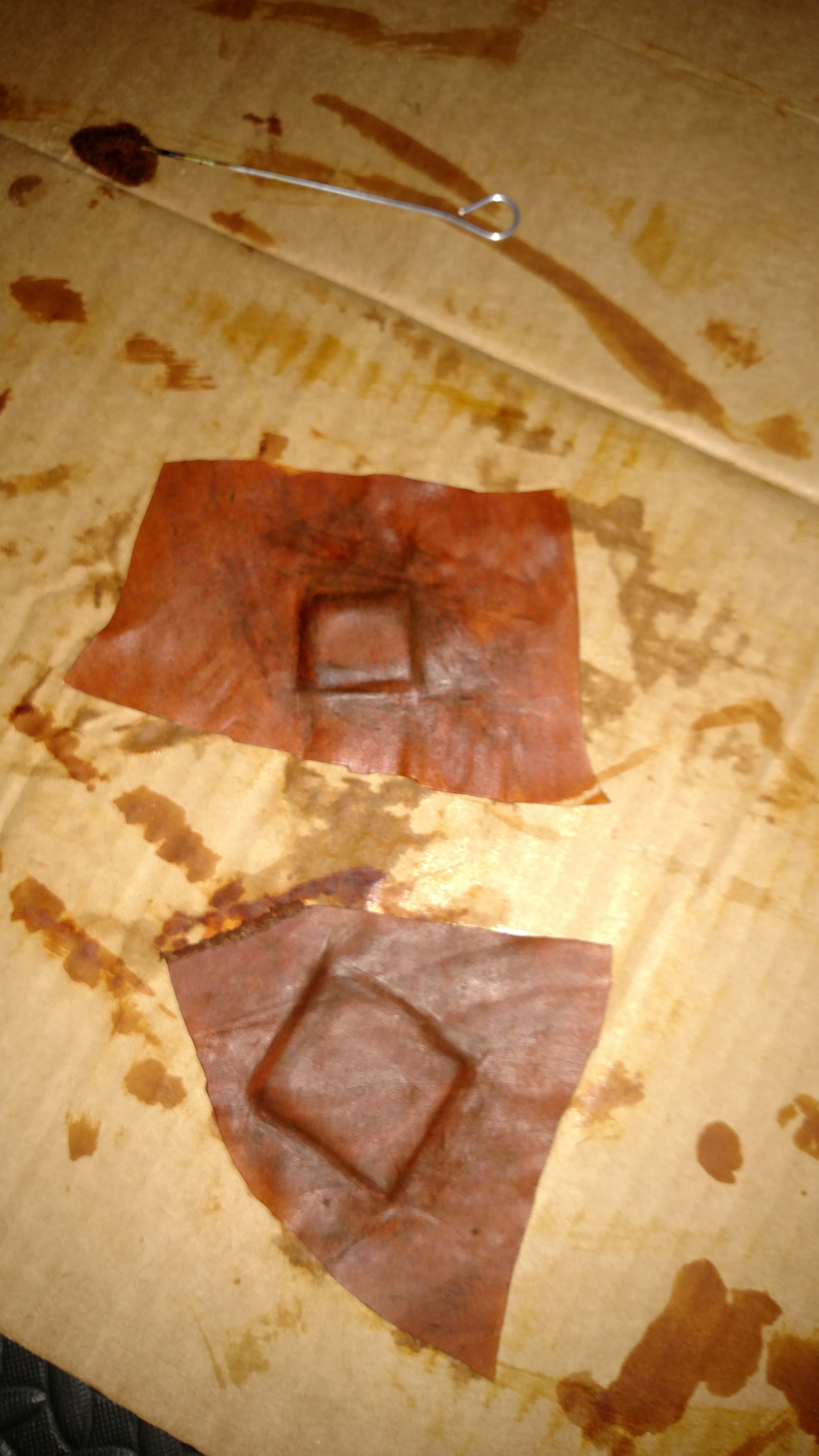

What kind of color do you use that requires you to wet the leather? I've been doing leather work for years using water and alcohol based dyes and I've never needed to do that. The trick is just to use a sponge brush.
What leather are you using to die when wet? Veg-tanned leather of most grades will harden on you if you wet it and then saturate it with dye. Wetting can also cause blotting.
And my most sincere apologies, never meant to take a pot shot, only to simply state that we can save hours of stitching time.
-Arcko
I'm not talking about soaking the piece. Just lightly dampening the surface. I've never had it harden the leather, and it actually gives me a more even color. To each their own.
I haven't had water harden the leather unless it's hot water. But yea, a foam sponge brush, give it a shot.
Kevin is correct. It is beneficial to wet veg tan leather when using alcohol dyes. Alcohol dyes go on MUCH darker on dry leather than damp.
For instance (these were down and dirty dye jobs for quick tests, but they get the point across)
With wet
Dry
Both are Feibings light brown alcohol dye
I will usually lightly dampen my leather prior to dying with a wool dauber for even coverage. You will get blotching though if the leather is too wet, so don't over-do it.
