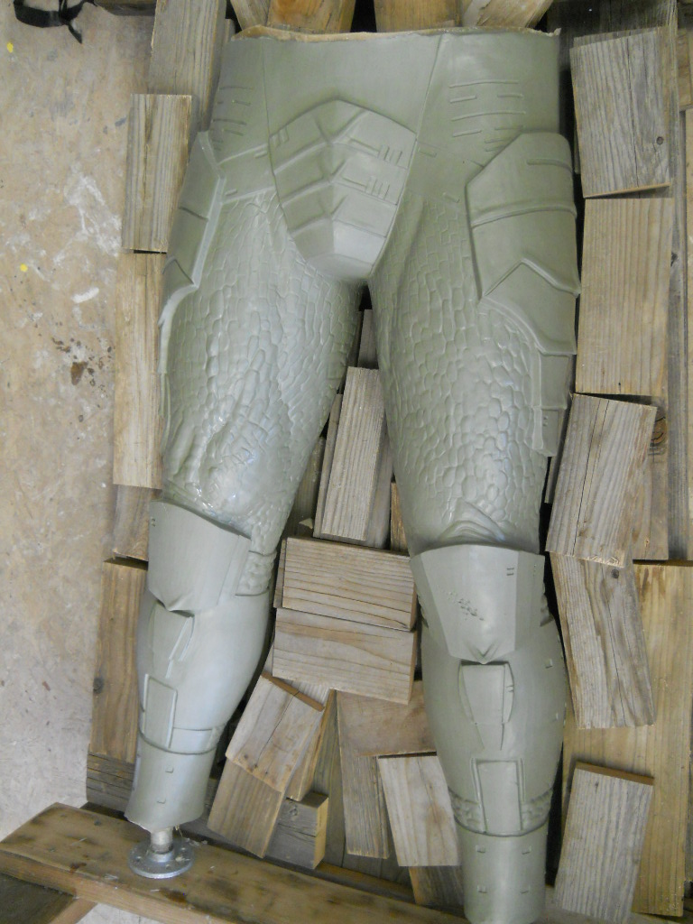

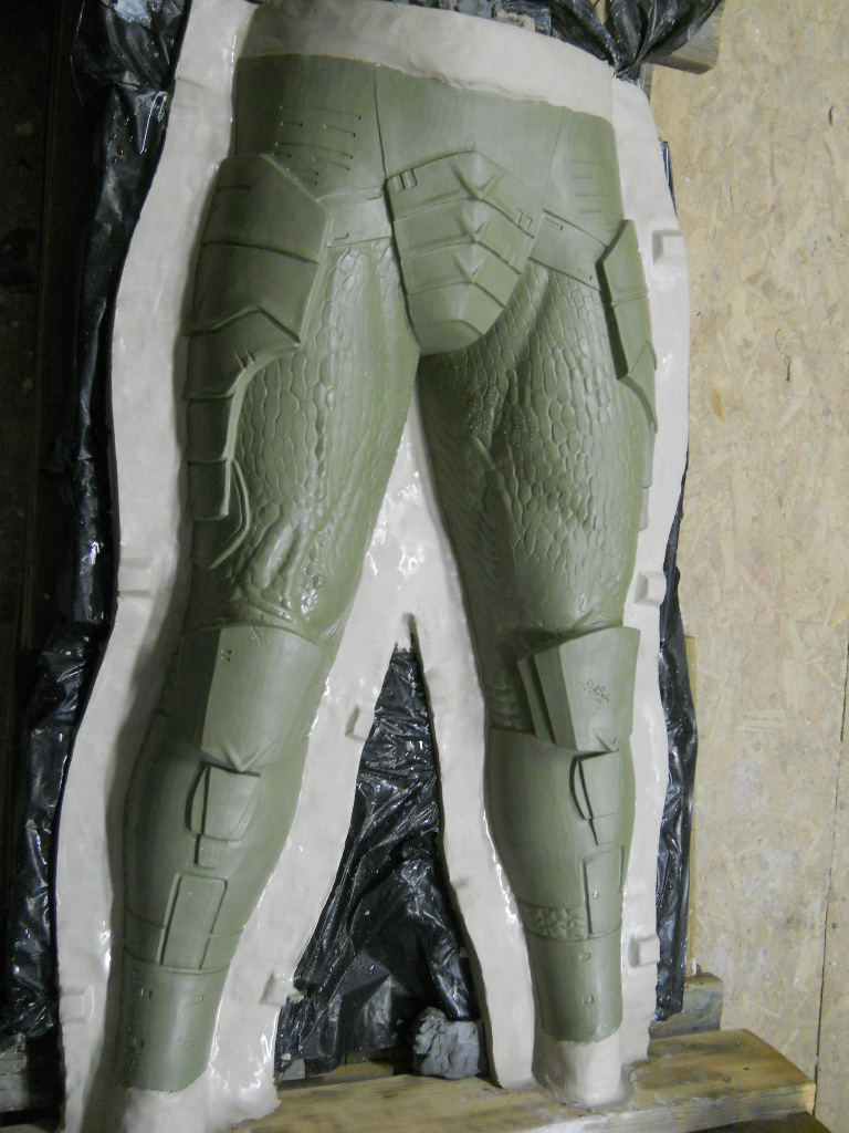

Thank you very much gentlemen. I have started the mold making process, and have some pictures to show of it. I first laid the sculpture down and pinned boards inside the legs to hold it up. Next i built up a wall around the sculpture with old wood scraps and covered them with black plastic to keep the clay clean. I built up the clay wall and got everything prepped to start bushing on ultracal. I should be starting that process tommarow so it will be done in just a few days.

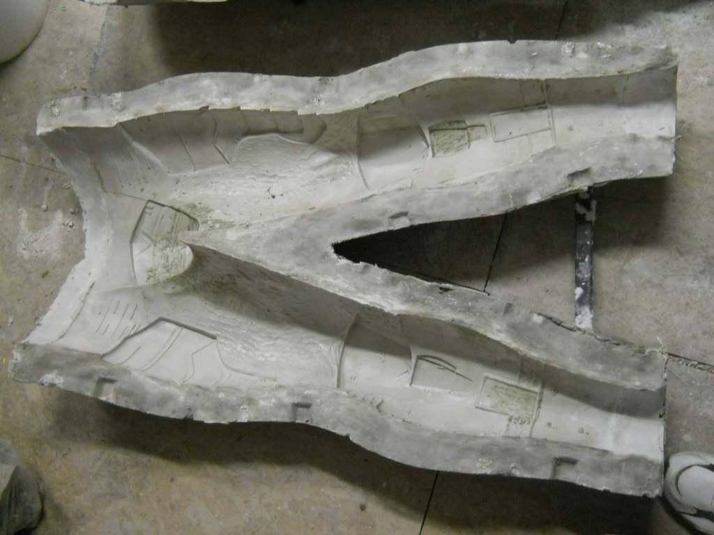

Well the mold is done, its just waiting to be opened. I was going to bring it out into the sun and warm it up so the clay would be nice and soft, but we are having cold rainy weather. I should be able to open it this weekend and get some pictures of the finished mold.

Thank you sir, i got the molds apart today and they came out looking good! They had some clay that decided to realy get stuck in the crotch and back of the legs but i am working on getting it all clean. I should be able to start casting very soon.

hey Corey, when you were laying the block supports for the clay wall, how do you prevent them from accidently knocking into the sculpture repeatedly as you build up the walls? All of the looses blocks look like a nightmare to me.
I ding my sculpts countless times when i try to make my walls.
Hey daman, the block walls i made were not touching the clay at all. SOmtimes i will bump them and make a little ding in the clay but for the most part they are free floating about a half inch from the clay everywhere.
i know that they were free floating, but i think i would constantly knock them into the clay if it was me.
Yea you have to be carful untill the water based clay is on top, then it kind of buffers it and holds it together.
