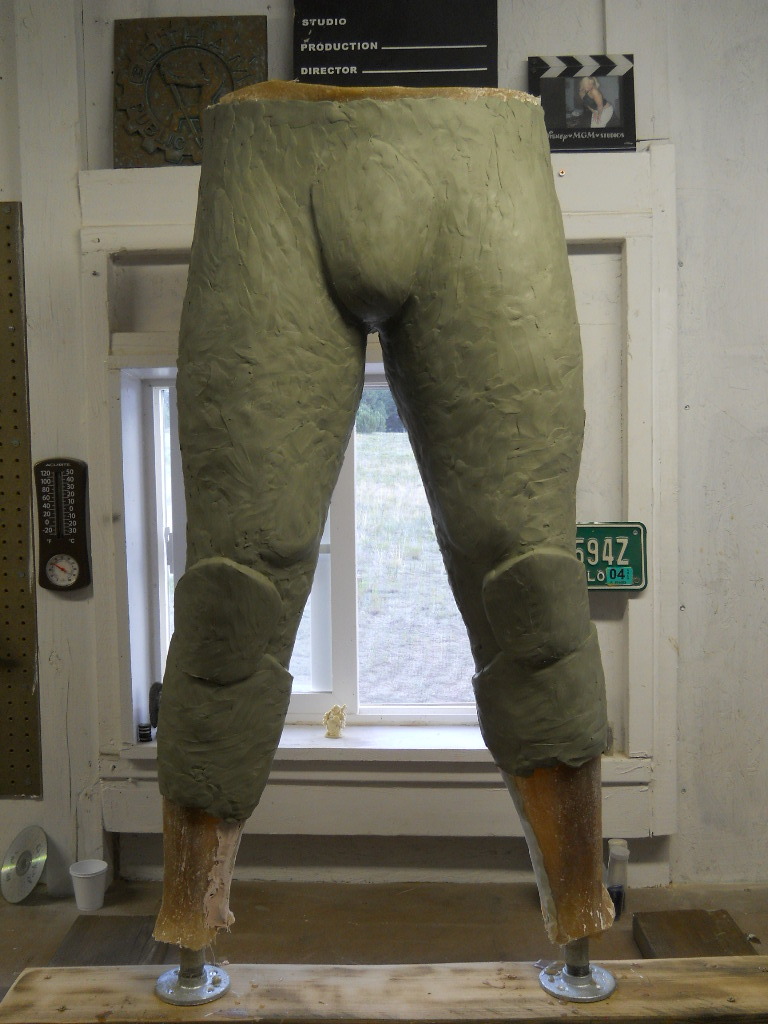

actually the way you used the 2 half plaster bandage molds and then cast them seperately is great idea. Something I defo gotta try out.
Looking forward to seeing this sculpt come to life
Looking very cool. Did you try heating the seams with a heat gun and bending them back? Did the casts come out easily or did you have to break the plaster? Are you foam-filling these, once seamed? Love your threads, bro. Keep 'em coming!
Hey i didnt try heating them, mainly because i had already painted fiberglass into the inside and couldent see the gap. I am filling it now, and its almost all fixed, but im running low on epoxy sculpt so probably gonna order some more. The bandages came off easily in some areas, and stuck like crazy to others. I used a home made wax and naptha blend as a mold release. And yes one of the major point to having this is so i can foam the armour parts and the insides of the latex legs once they come out. The lifecast itself will remain hollow, but will act as a core for foaming latex skins.

So, the plaster mold warped when you took it off and laid it down to finish drying? yeah, I meant hitting the glass cast with the heat gun. Picked that tip up from Stealth per his Pep vids. Works pretty well, once you get the hang of it. Though, I have a feeling yours would be too thick, anyway. What resin did you use? How many layers of glass? Could you briefly explain your mounting to the board process?

Well the legs are mounted to the board with 3/4 inch falanges, on a foot long metal pipe. I just fiberglass the pipe into the legs then attach it with the falanges. It has 4 layers of fiberglass to make it sturdy. The resin is a bondo namebrand fiberglass. Did that answer all your questions?

I am back in action! I have been working a bit today on getting some clay onto the finished life cast. Its all still very rough but its getting some basic shapes. I have been heating the clay in the microwave and trying to apply it evenly so i dont loose the origional shape of the life cast legs. I will have more updates soon!
