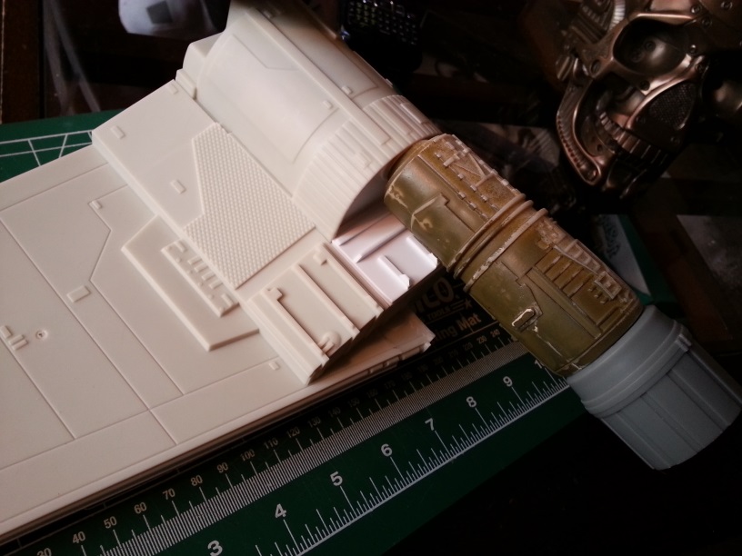

Here are some pics showing some comparisons with original part.

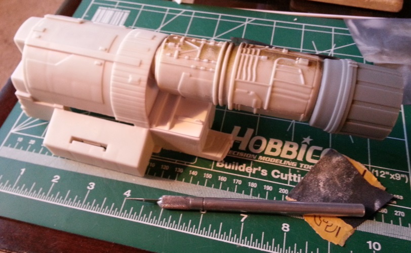

Completed engine mounted to the firewall.
I attached the engine to the wing to show
the details in relation to the details of the wing.

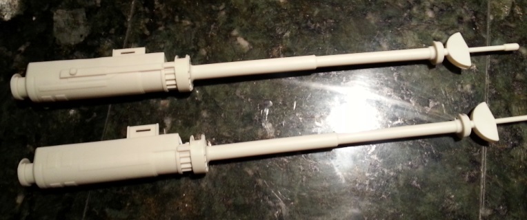

So I don't get burned out on a section of something I'm building I have to move on to another area so as to break up the monotony!
I thought I'd work on one of the Laser cannons, basically have to go through the same process as the
engine. Cut thing apart...scale details on these guns are not all that great and these cannons are also hollow just the engine.
It took 2 Cannons to make 1 good cannon wing pod.
After cutting most of the crap off these cannons I cut them in half
just like the engines.

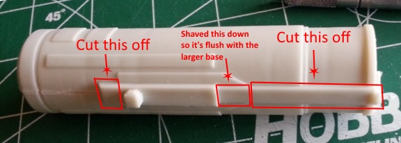

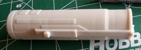

When I cut the cannon pods in half I kept one half that had the most raised detail.
The other half will have to have that extra detail cut away so the two halves will fit together properly.
The other half should be cut away the exact opposite
as the half pictured above.
When one is cut away and the other not, they fit!

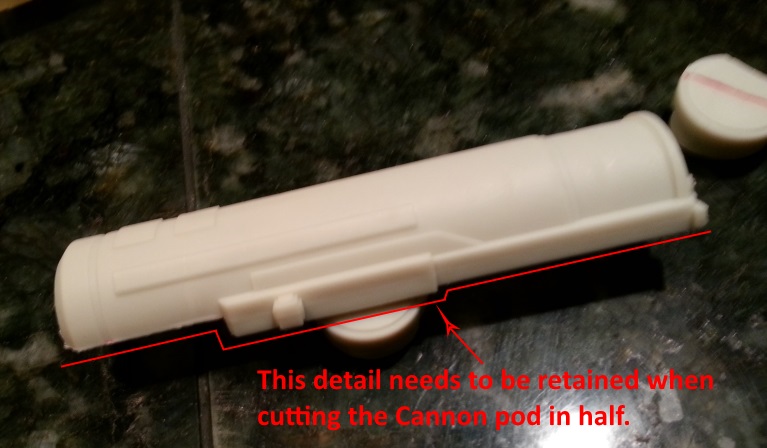

I compared the detail to an ILM X-wing, they're pretty close.
After cutting here and adding there, my cannon pod detail will look just
like it!
Two wires or dowels will be added later so
the cannon pods will like how they're supposed to.
This pic showing where I've cut off the unwanted detail, It was important to retain the lip
on the edge towards the center of the cannon.
A score mark was made to help gauge just how much of this is going to be cut down. Oh look, Crow or Tom Servo!
