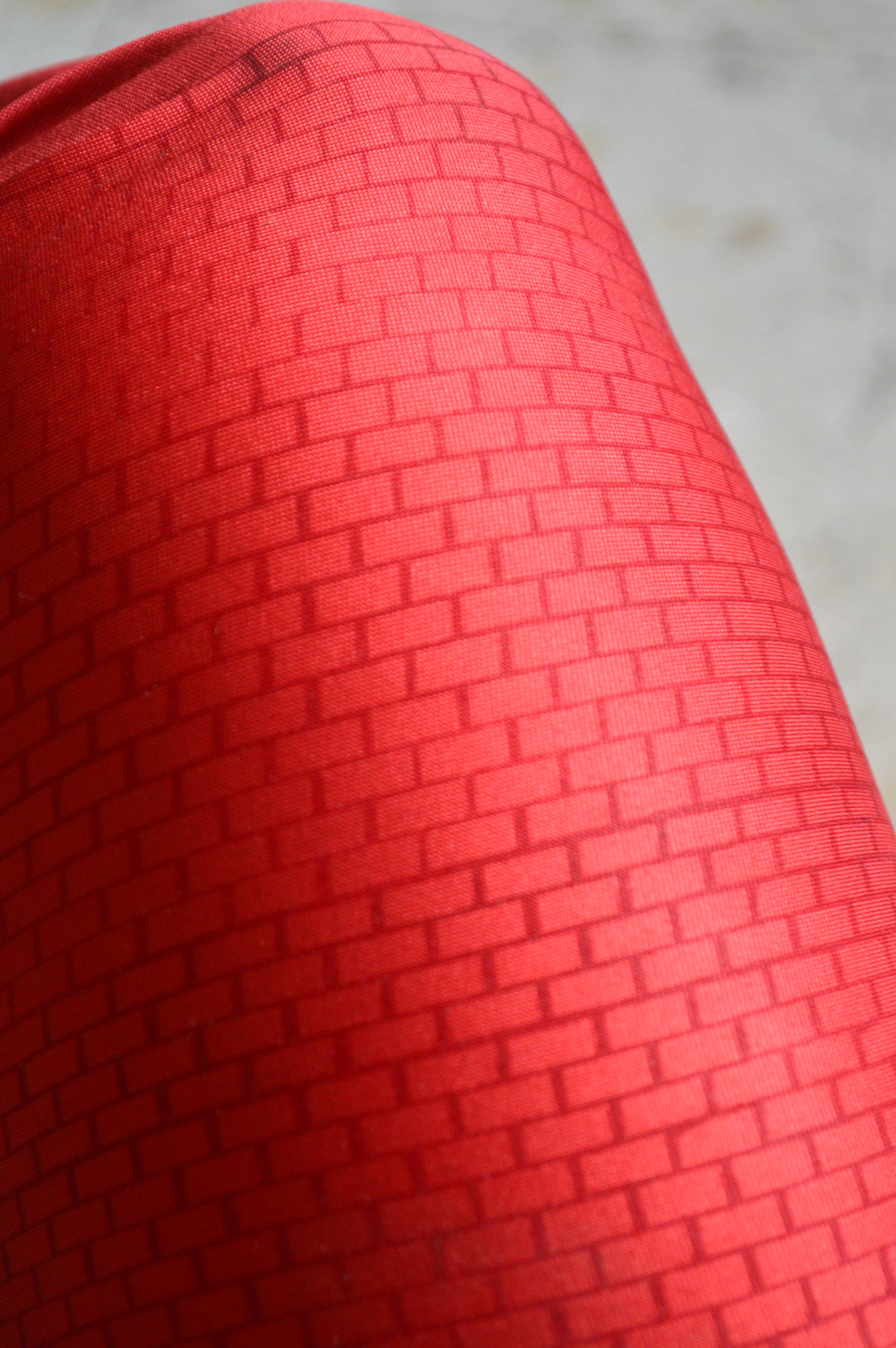

I disagree. In this photo you can see a very noticeable difference in how the light hits the black bricks versus the red. The light reflects off the black bricks, but not the red.

I just talked to a few other people who've seen the suit, and they said that the printing actually does sit on top the red fabric, similar to the ink on the blue fabric. According to Zach Luna, there were some wear and tear on the fabric.
http://d.pr/i/10YNB+
Gee, can I chime in here? Instead of being third-personed.

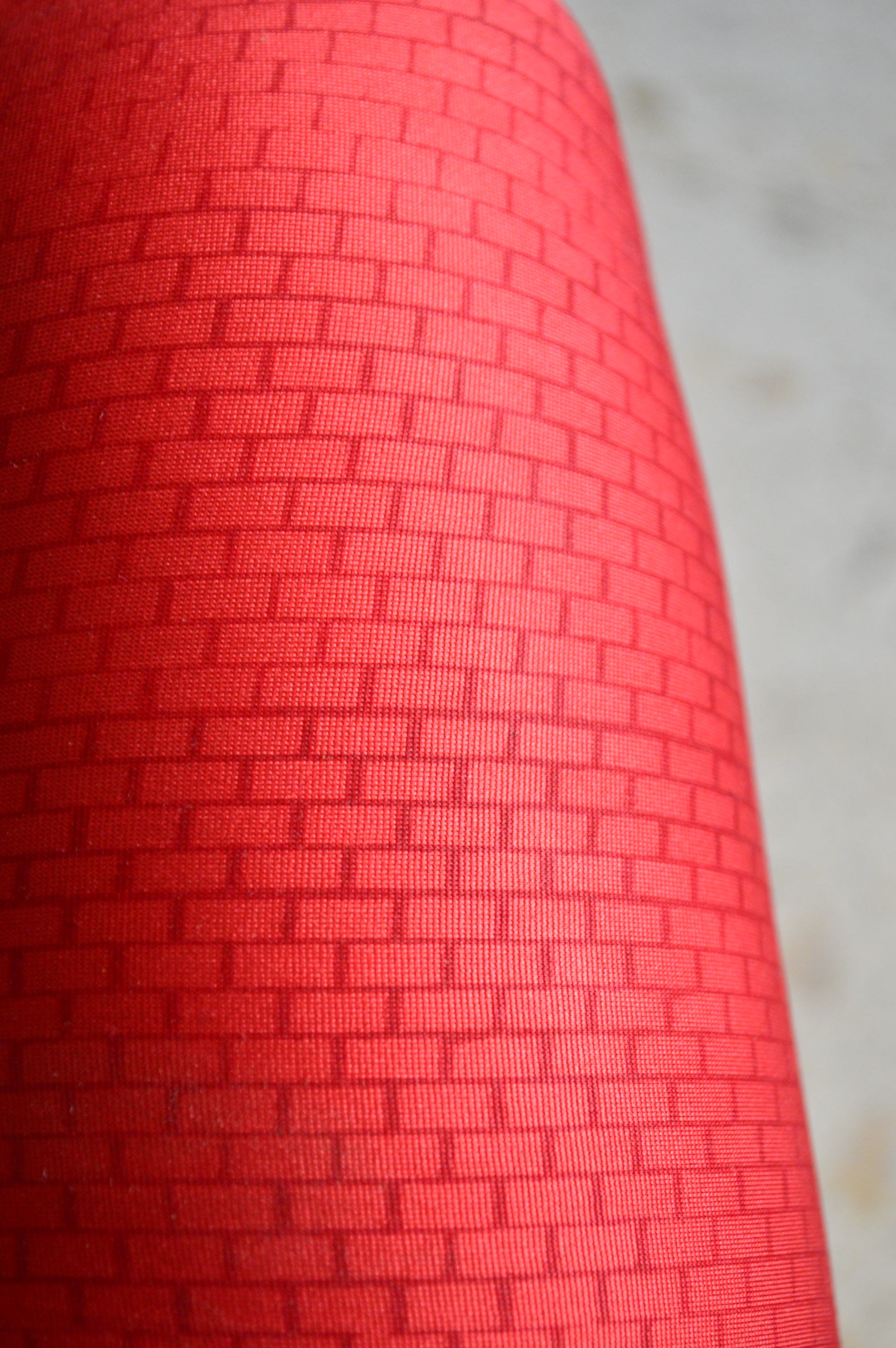

The suit definitely used different inks for the red and the blue sections (the brick on the blue being a thick emulsion), but the bricks on the red DO change the way the surface of the suit reflects light. It's hard to capture on camera, but the ink on the red DOES catch catch ambient light a bit. It is, however, more "soaked in" to the weave, leading me to wonder if the red sections used a water based ink rather than the plastisol based inks used on the blue sections. I don't have clear images of the wear and tear areas, since the red brick is hard enough to photograph in the first place, but there were areas that looked like it had worn away. That and the surface sheen and some info I've gleaned from people in the local industry is what informed my conclusion that everything on the suits was screen-printed.

However, as Jake mentioned, the red portions show a similar appearance as results from dye-sublimation, which can be less of an ordeal to manage. Other suitmakers like Anneys have gotten good results from using dye-sublimation on satin-finish fabric, which would be a fine approach and the one I aimed to take on my own suit.

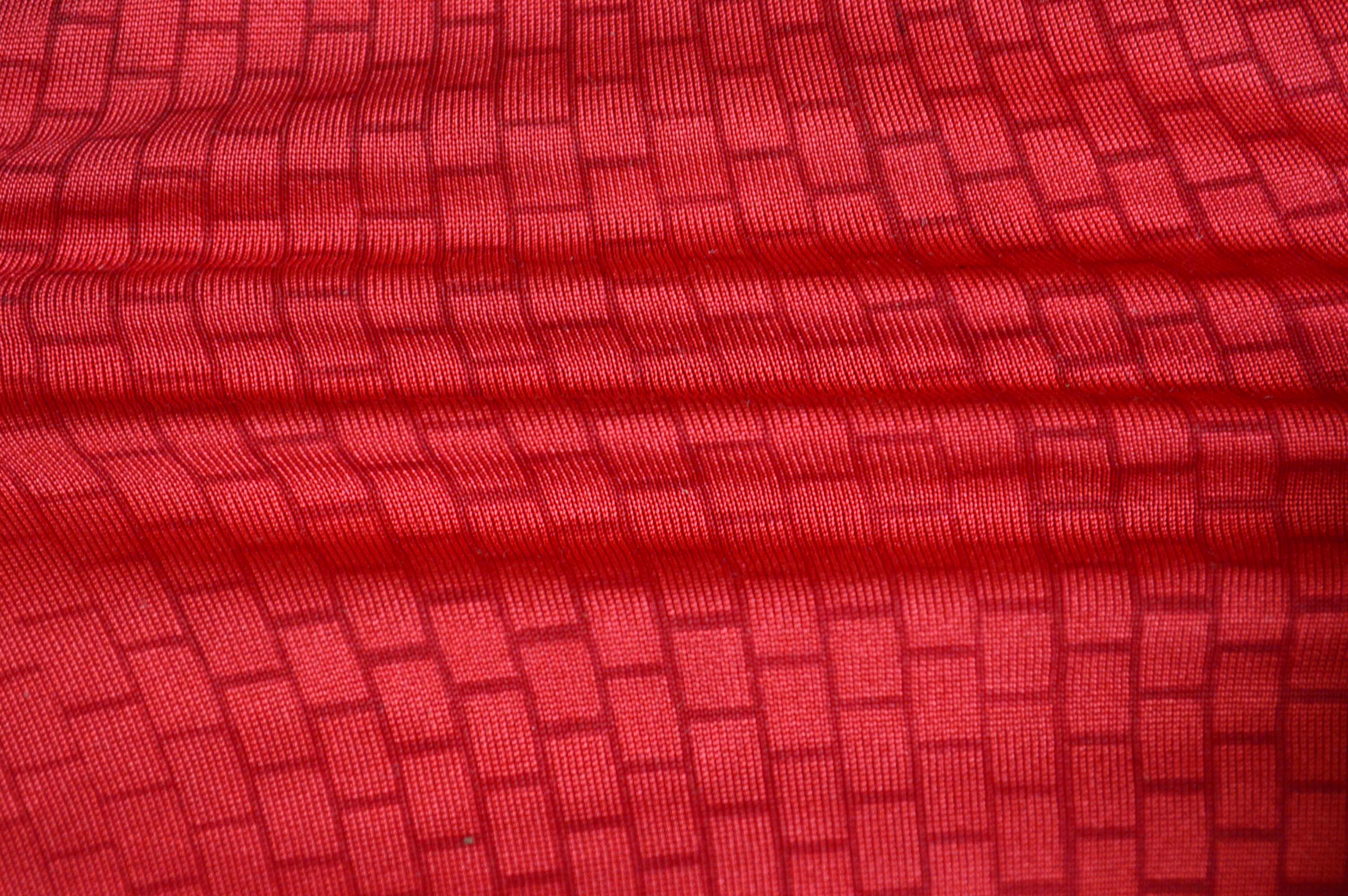

The main reason I'm leaning towards sublimation is because you can still see the knit of the fabric on the brick portions.
Whether or not they actually screen printed the bricks, this look is definitely achievable via sublimation and that's probably a much easier process.

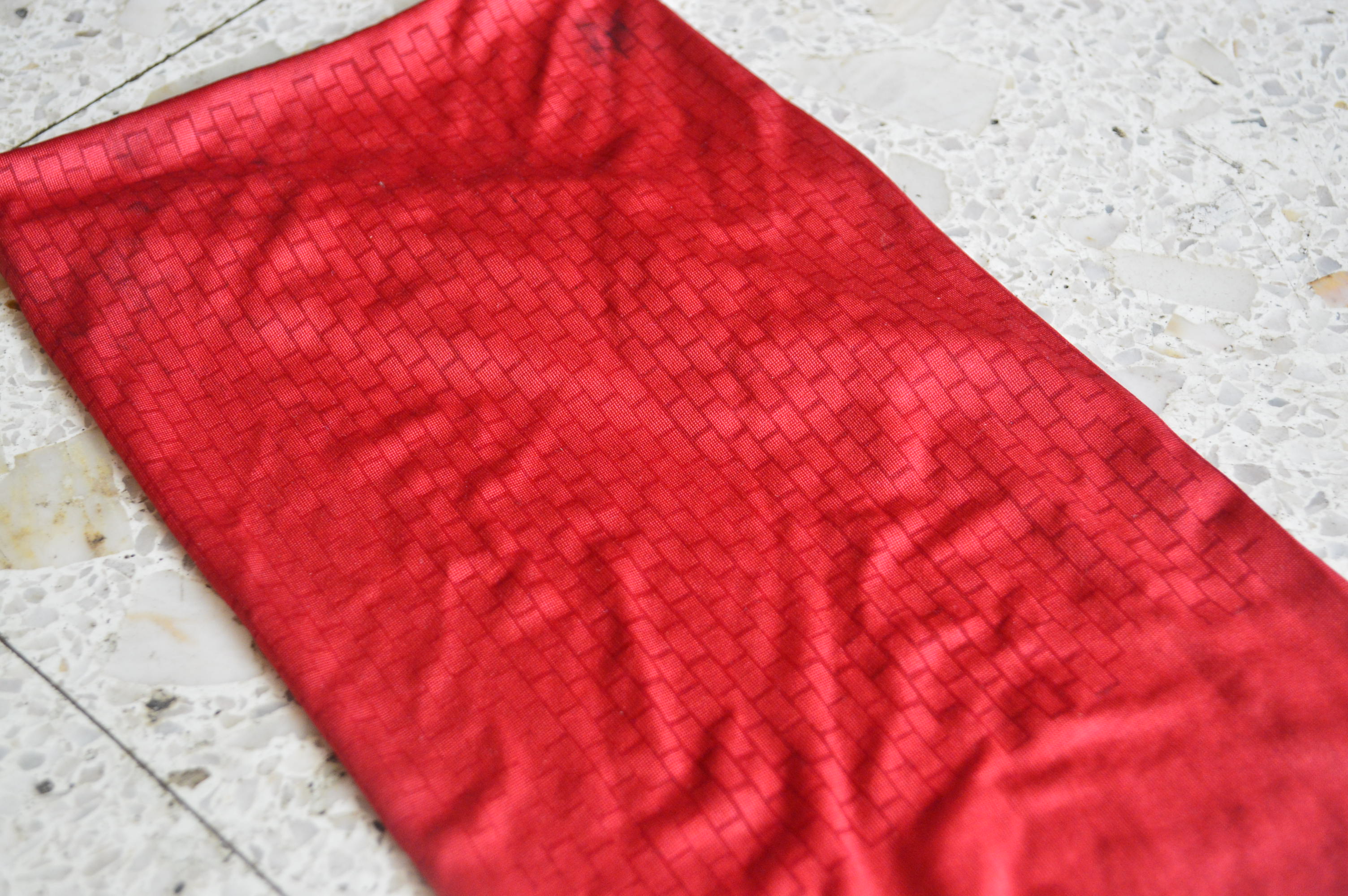

Well it's mostly just really scratch red spandex fabric which i tried to create a continuous brick pattern on with a 9x12 inch silkscreen. Results were disappointing though since it did not line up. So don't judge it hahaha. But okay, I'll post some pics tomorrow. :) It's pretty late here in my country

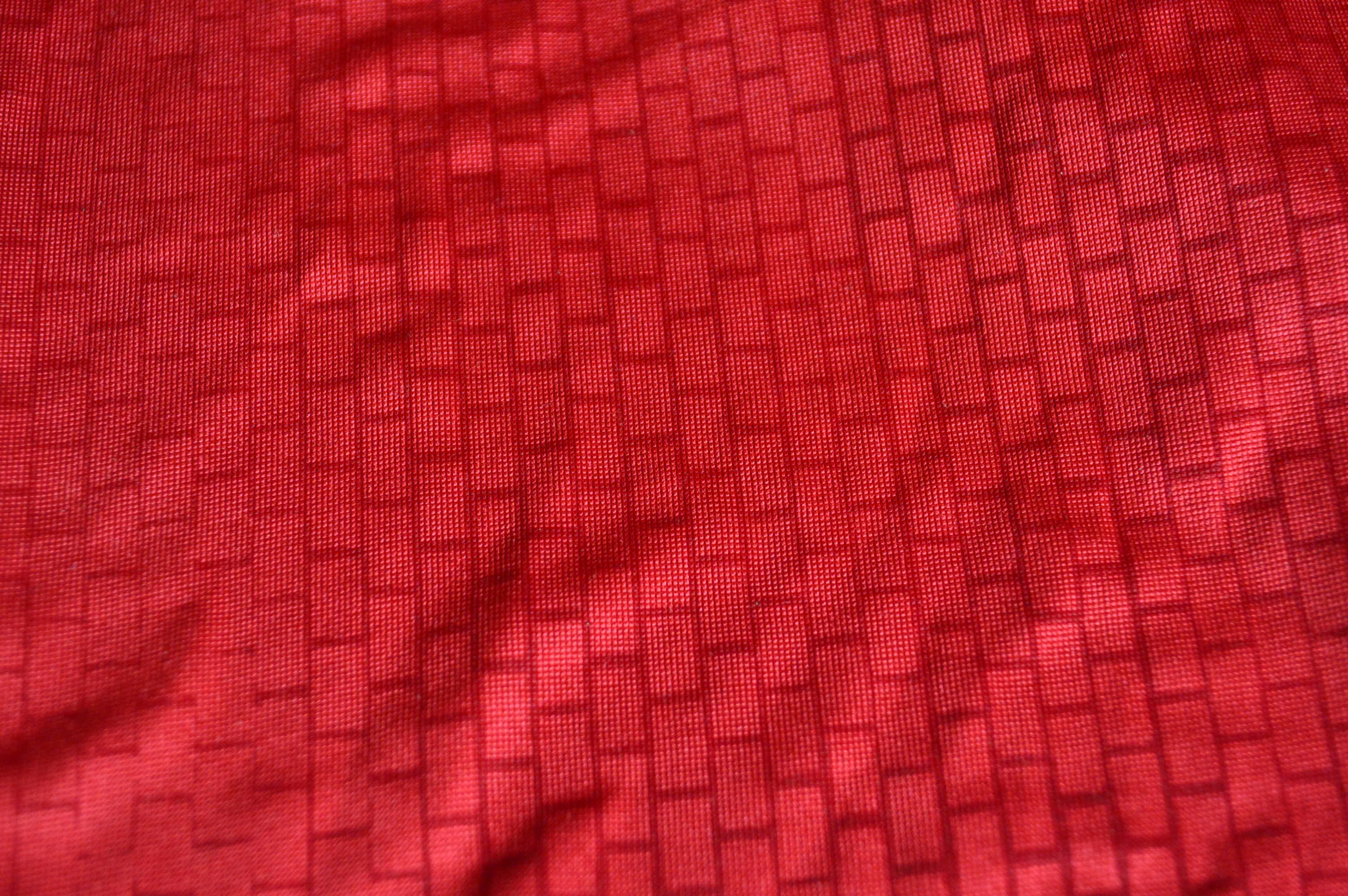

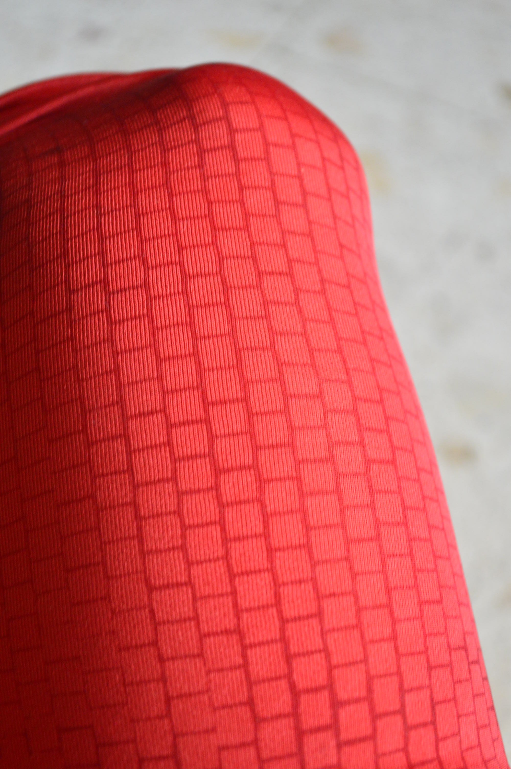

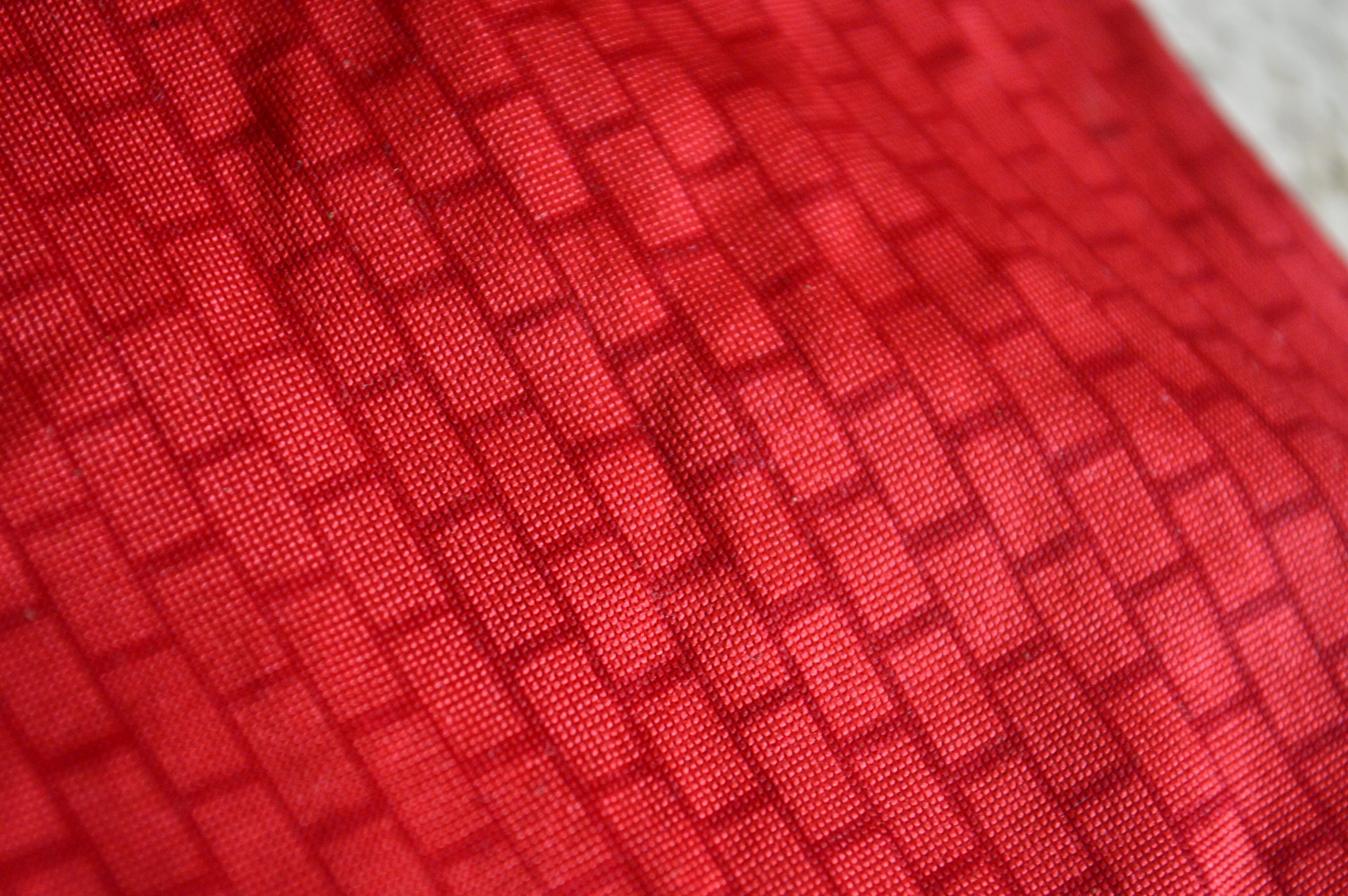

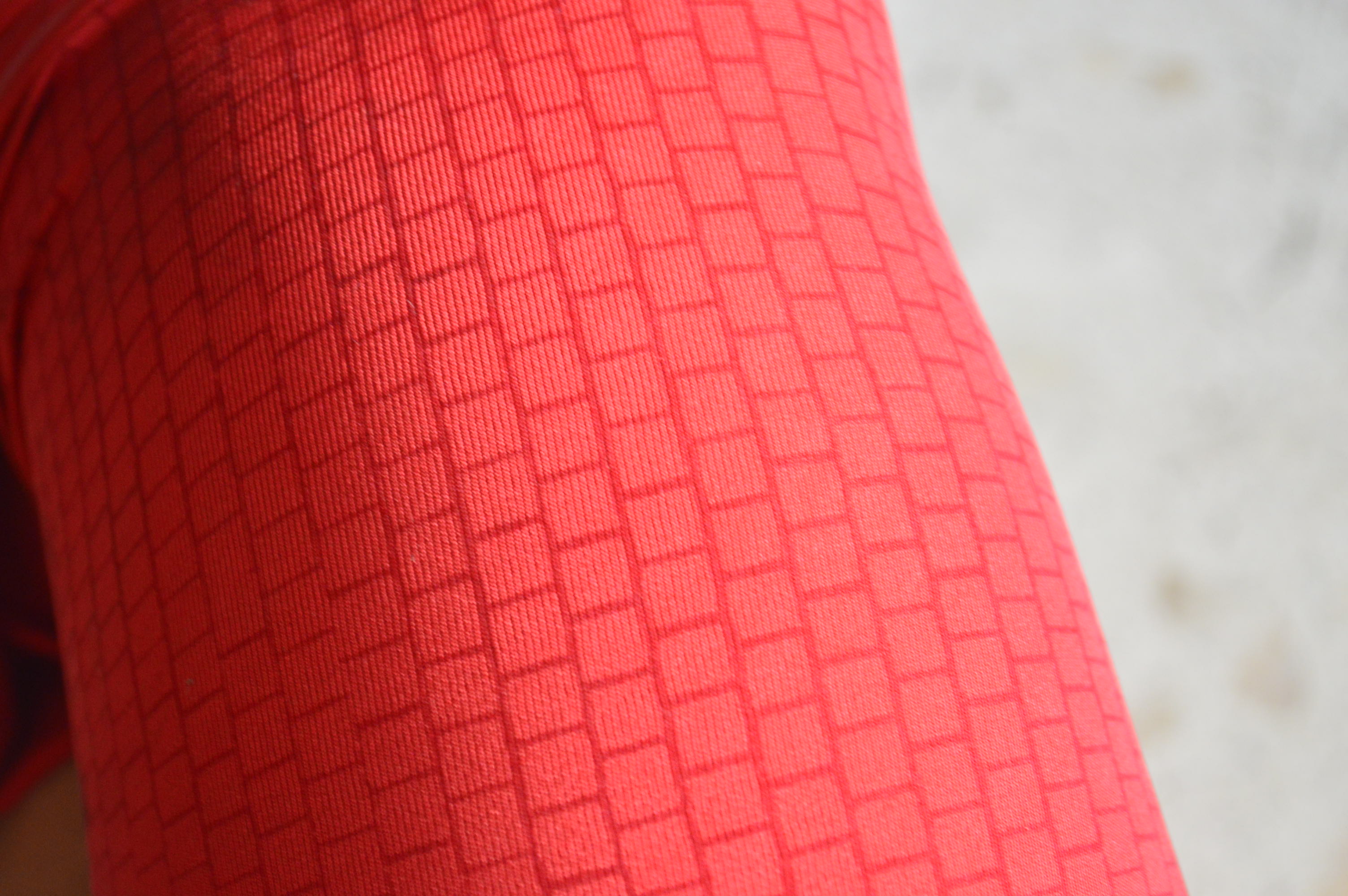

Alright, well here are the pics of my screen printing! :) I used a red ink which I lightened by mixing in a bit of white.
Unstretched:
And here it is stretched horizontally:
And vertically:
P.S. the fabric is a much darker red in person than it looks here in the pics :D

Thanks for sharing the pics, nice looking results. This is a water-based textile ink?

It's a four way stretch lycra that I got from a market. Very very cheap too, I got 2 yards length with a width of 65 inches for like under $5 (It was 160 PHP in the Philippines). So I went ahead and bought blue and red lycra. And now I'm just trying to figure out how to create the brick pattern on the blue :)
