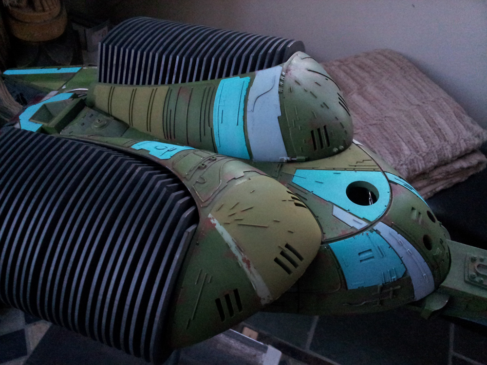

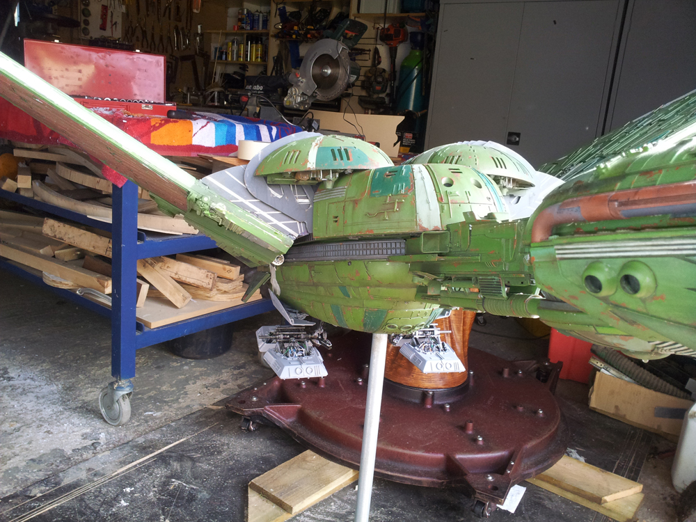

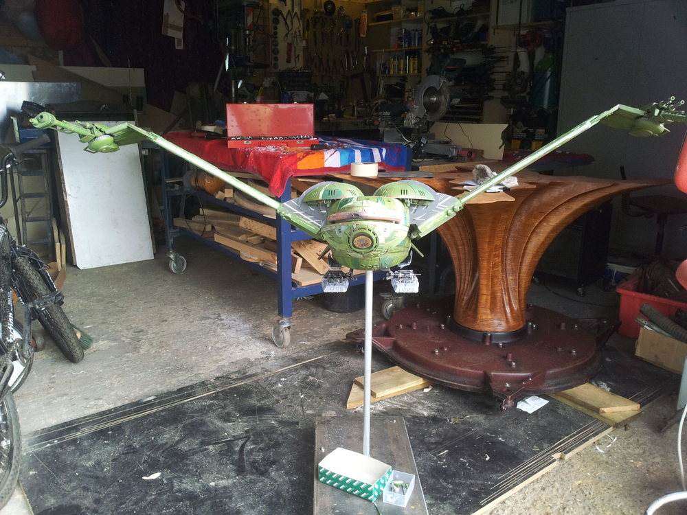

I ground down the cooling fins to the right length to allow the wings to be in the maximum position. I was worried about this a bit as I didn't know how to attack the parts without removing them and cutting separately. After some trials I found they are made from some kind of Perspex material, and as I've done Perspex before I decided on the angle grinder with a coarse grit sanding disk. It worked a treat with no breakages and an easy grind. once the fins were done I needed to grind down the rear shoulder parts under the tank body. I had removed the porche engine lids to get a decent look at the angle. I did these with a hand rasp as the angle grinder could not reach into the corners, and after a couple of trials and regrinds I managed to get the edge of the wings to meet the main body.
then it was time for a quick reassembly and evaluation before final strip down and starting to remove any loose paint before the start of the re-spray, and I got this
View attachment 602029so that's it for today. I love it with the wings up, even if the port wing is a little high ! The landing gear looks to be about right, just some more width on the spacing I think to bring them out a little. NOw for the strip down and paint job !!! ooooh fun times!!! More tomorrow.

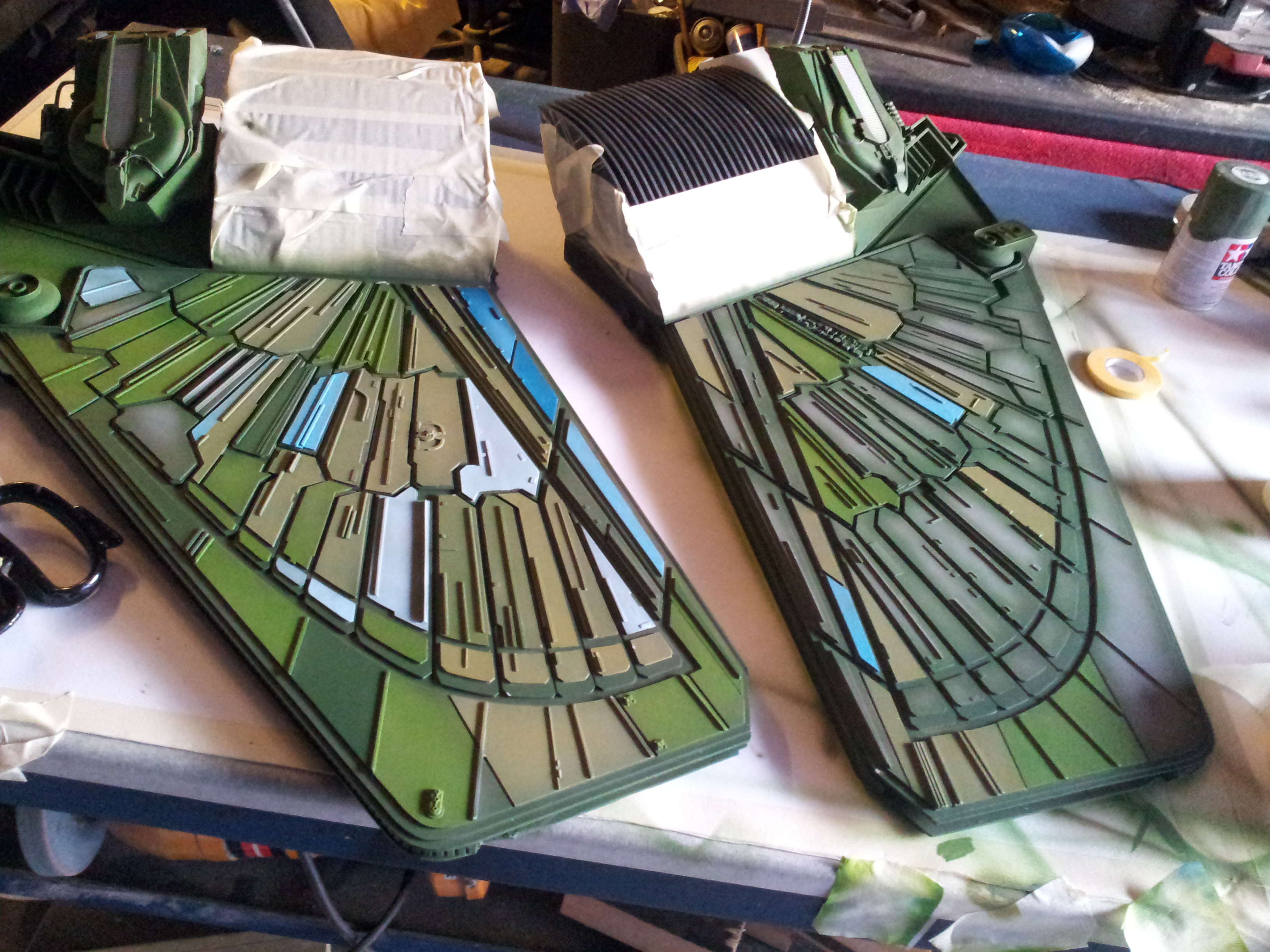

so first it was a low light pass in all the recesses of the wings, allowing overspray to fall onto the top of each panel. I used a dark green matt tamia colour paint with cellulose thinners.
Then a second pass with a lighter green not on every edge, just random on top of the dark green.
Then a third pass with a brighter green again to lift the colour away from the main body, but again in a random way
Now were all fuzzy and horrible, its time to get some panels masked up.
I mask each panel separately in order that I can vary the colour intensity and shading on each panel to add some subtle difference to each.
It sounds like a long way to work, but it really is quite a speedy way to work and does minimal damage to the paint from the masking tape as it is only on the model for a matter of minutes instead of hours

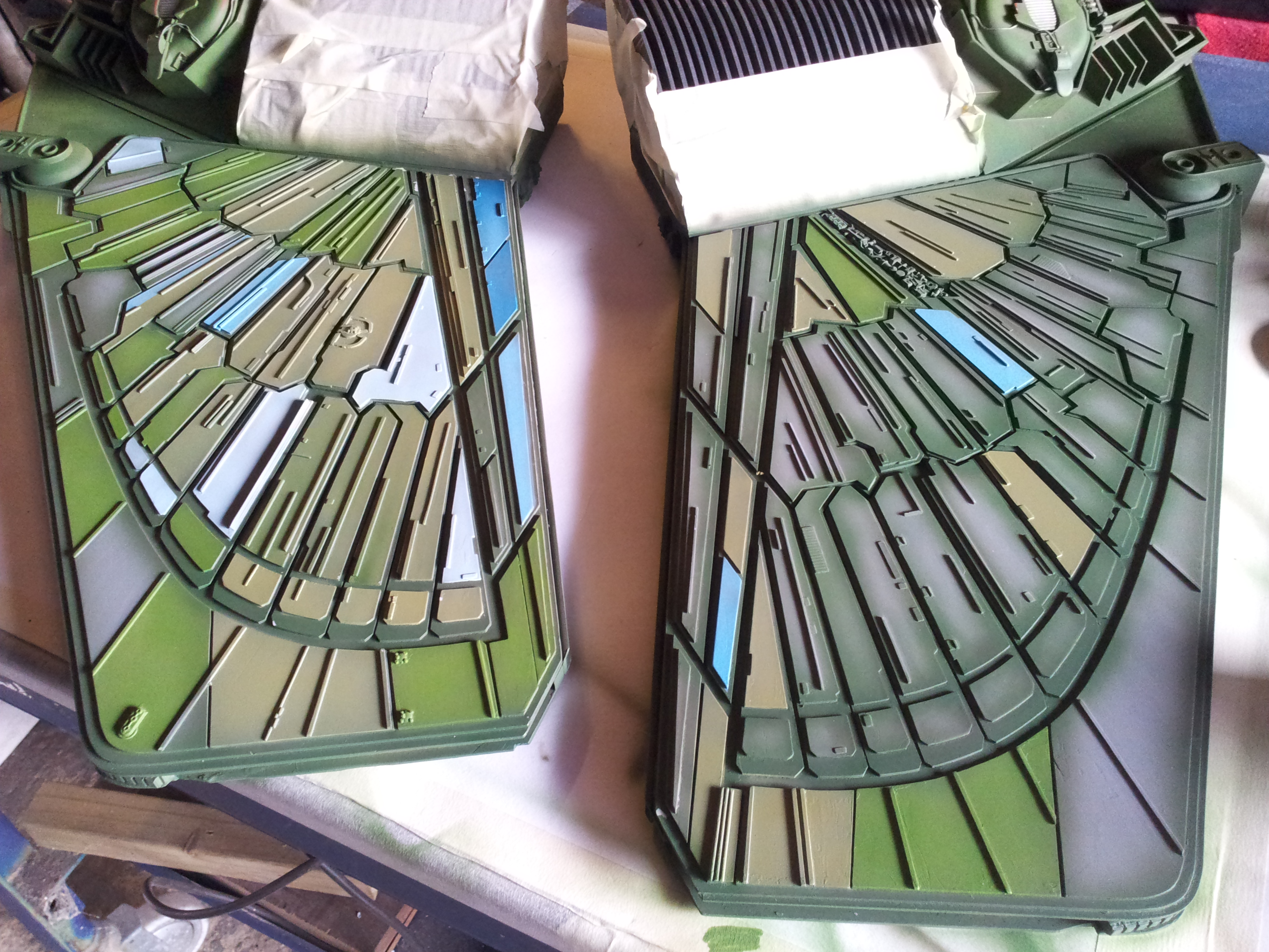

So after a few passes with colour the wings are coming together nicely.
So that's it for today.
Im pretty confident that I have the starboard wing 90 percent accurate for panel colour placement, but I don't have any decent reference for the port wing. I know there are a few guys out there who may have some reference of the top of the port wing, if you know them , or are them, please post it on here. Thanks guys

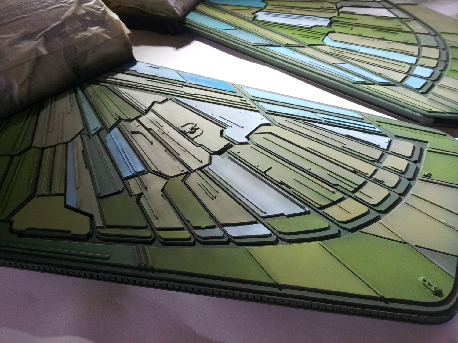

So after another day sorting bits out, ive finished the first layer of paint on the top of the wings.
Now onto the bottoms. There is a lot more light colouring to the recesses on the lower wing, so I've added some sand/olive colourationto lift the colour of the wing a little
top wing overviews.

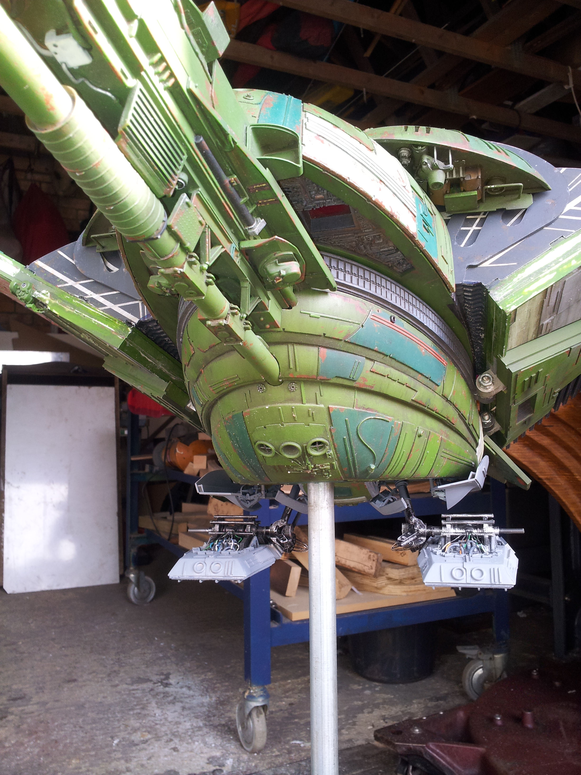

The body and other surfaces are now getting covered in the base colours, these will provide a colour base for the weathering and other shading when I get to it.
I have carefully removed the nose gun housing to repaint the small panels on there, also ive remade the gun with a smaller circuit gear from an od video camera ad a super glue top !

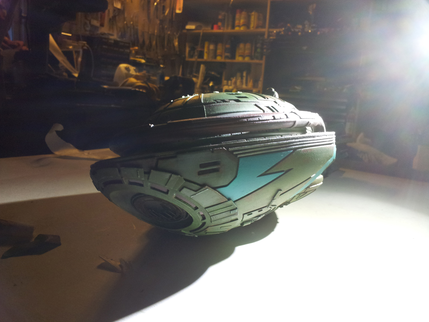

Ive done more today on the body and head with other colours.
I worked on the neck areas to introduce some detail and shading and to get the transition areas from the neck to the body visualised. More blues mixed to add the more red/blue colour seen to the rear of the neck on the ref image above.
a2.jpg and some highlighting of panels etc.
top of the head is coming on nicely a well.

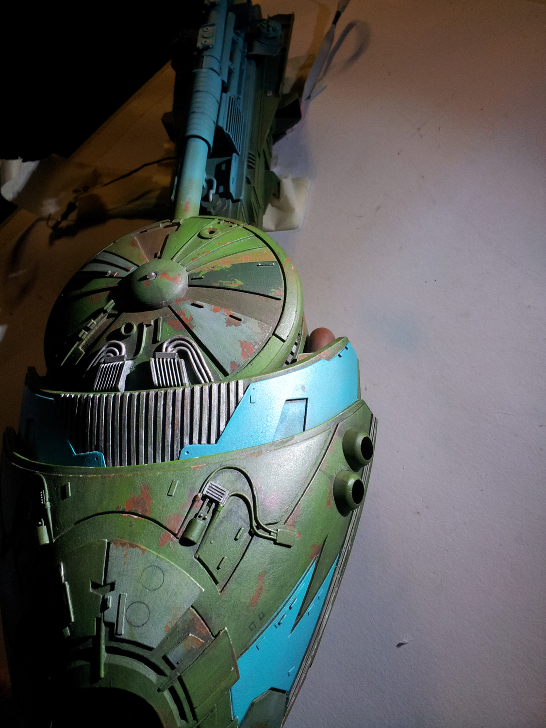

I couldn't resist doing something on the turquoise section so I knocked it back a little and added some chipping to see how far away from the reference I was. I think its coming on nicely, still a long way to go though.
The camera is picking the turquoise out really well, as ive noticed in real life its a couple of shades lighter. Ill try another camera or reset my white balance next time.
