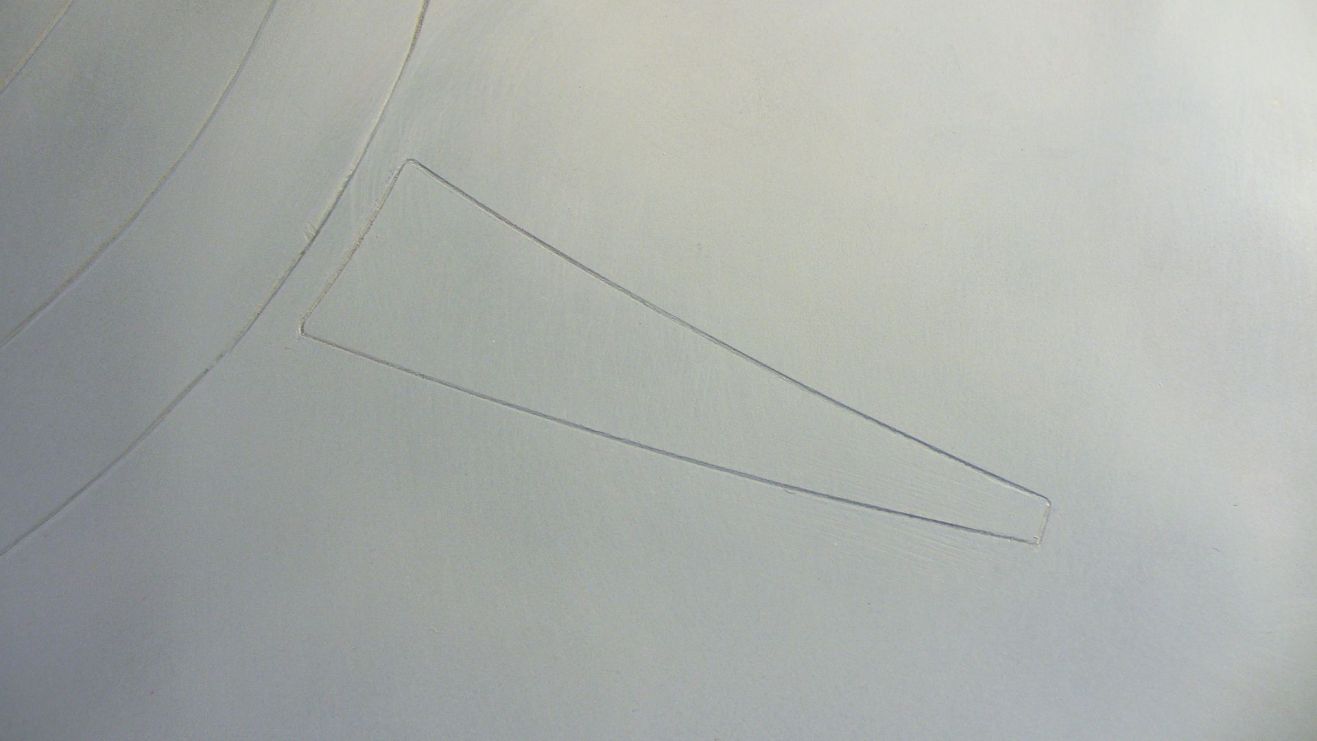

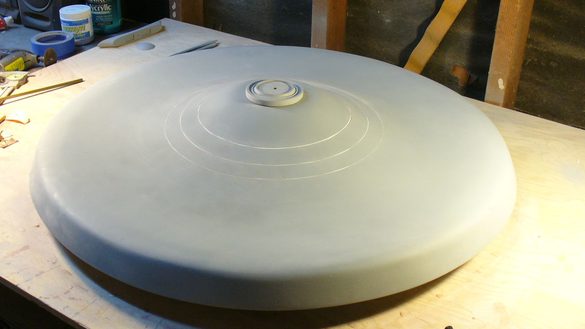

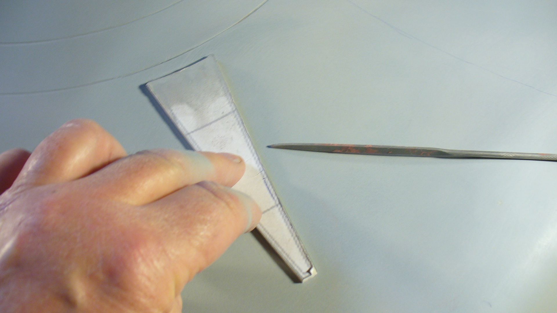

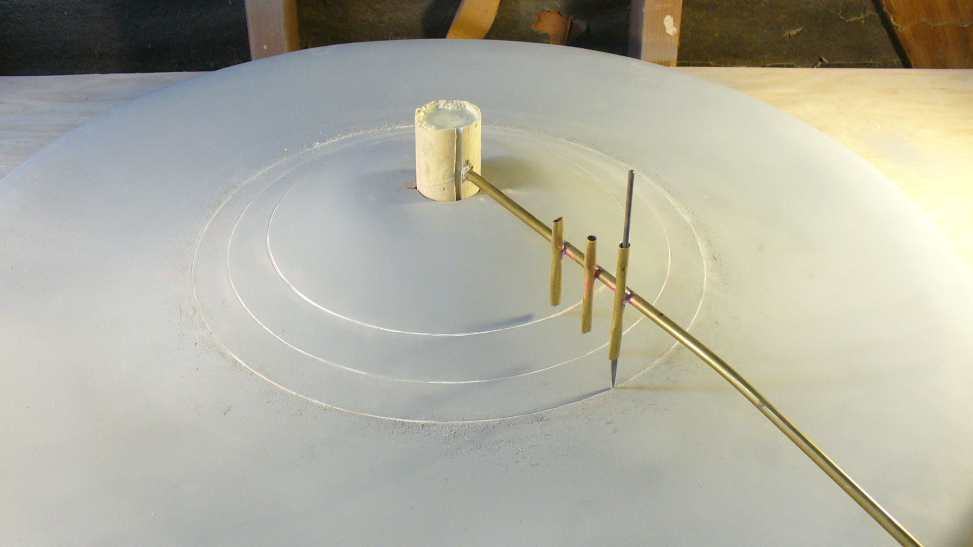

More today. Got the bottom hull scribing started. Here's some pictures that make it all self explanatory I think. Easy stuff as long as you keep the measurements all the same. ;)
Steve
That's a rap tail file in there. Line them up and start scribing.

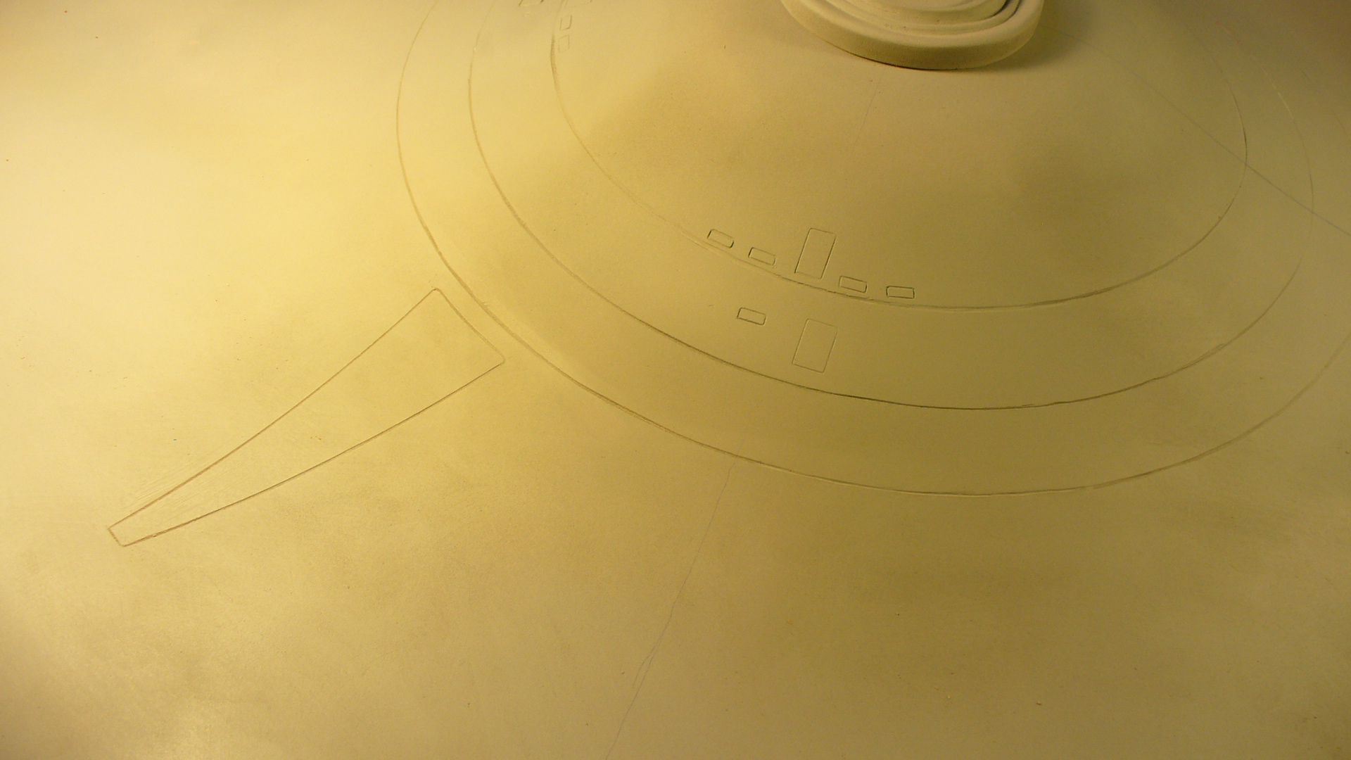

This is how the windows and other parts locations will be marked so they show in the epoxy castings.

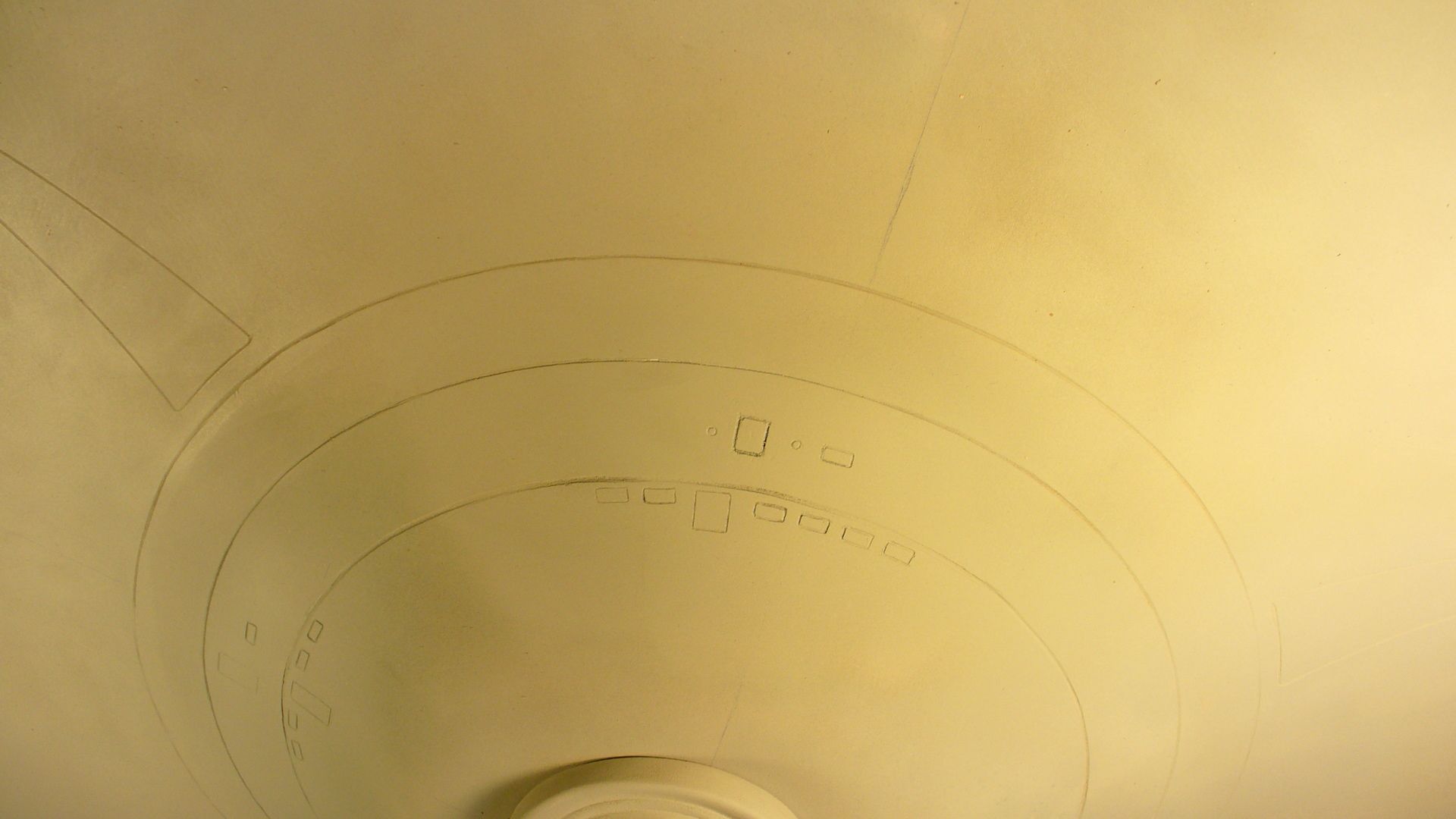

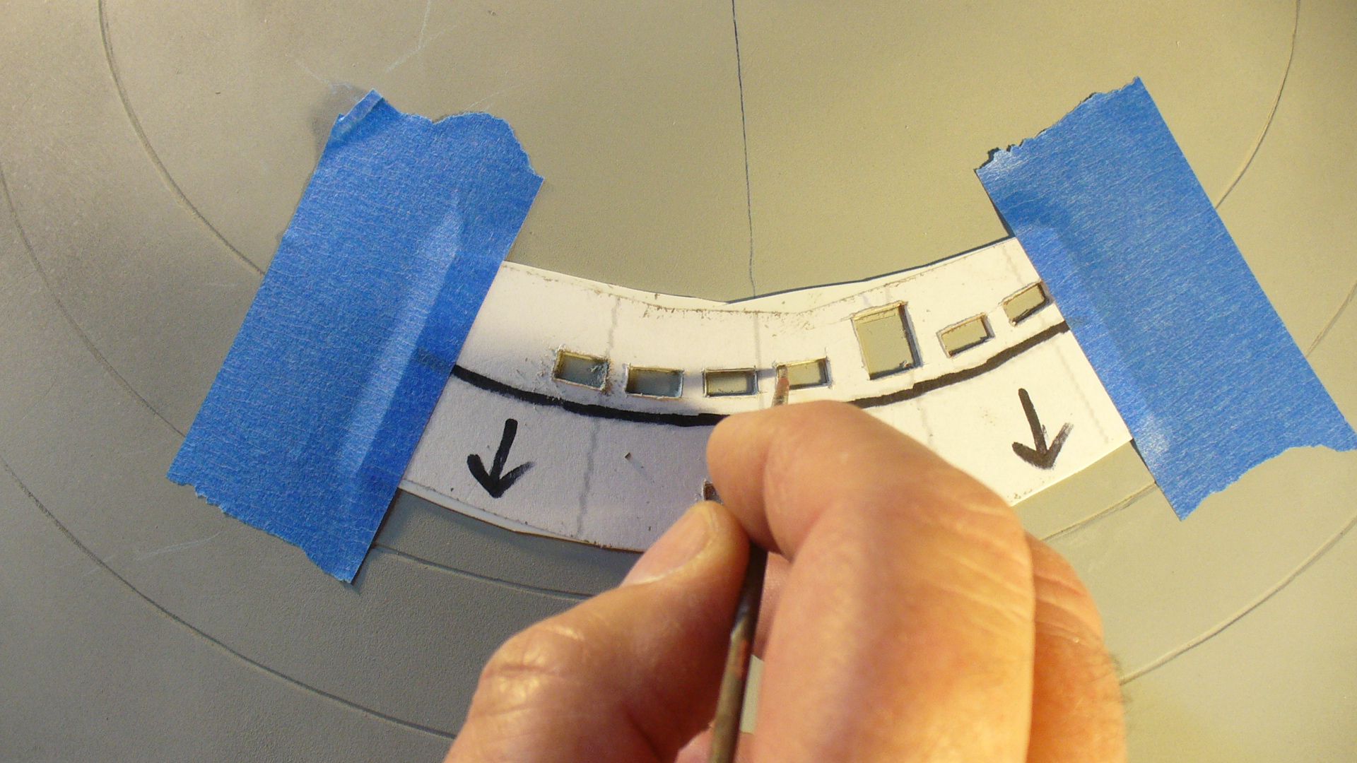

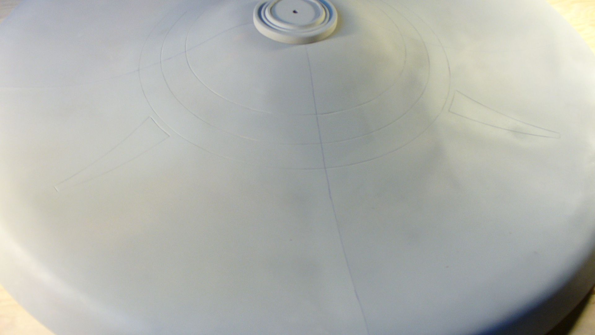

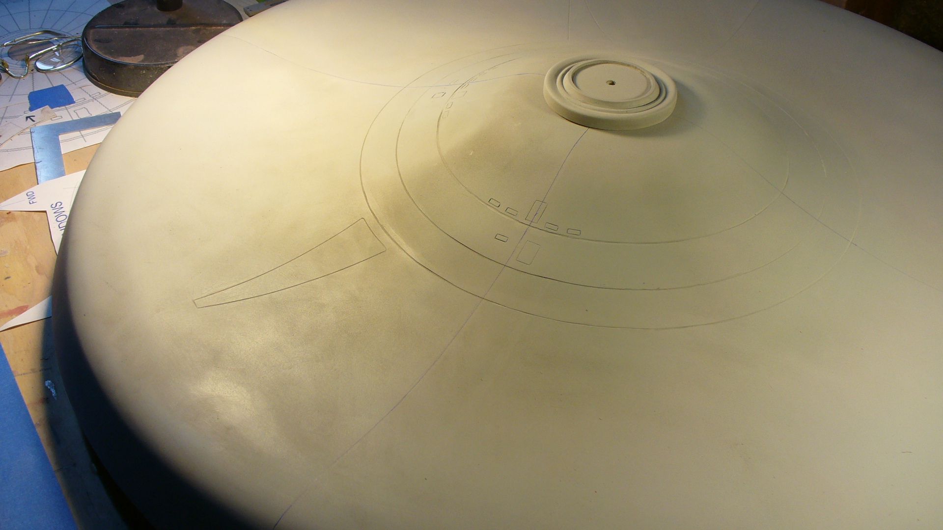

This weekend has been one of these weekends were it's hard to get anything done. Today I managed to starting the scribing of the windows and the few panel details this ship has. All those concentric hull plating lines were all penciled on the original so I'm only scribing the ones they did back then. The windows are locator's that will be used to cut out and file the windows on the actual model build.
I suck at scribing. Maybe one day I'll get good at it with more practice. But this will suffice and I still have yet to clean them up.

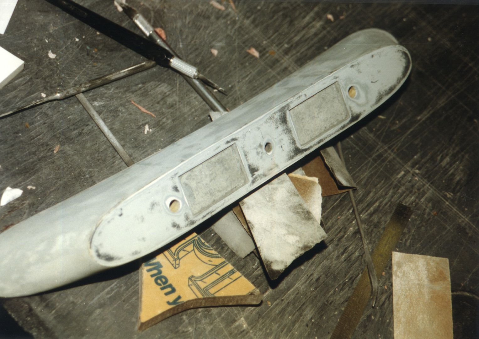

Should the sides of the impulse engines have a texture to them?
Here's the original impulse engines from the 11 foot model.
I don't see any. I have been working closely with these pictures and they are of great help.

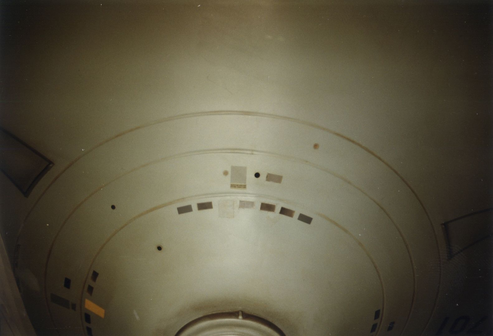

For instance here's the original 11 foot saucer belly:
And here's the one I'm working on:
Comparing like this as I build really helps me see if I'm on the right road or not. So far so good. In fact close up the big 11 model has it's fair share of irregularities.

Out of curiosity, why did PL make theirs textured on their 1/1000 version? This is the only reason I thought they should be.
There is a fabric coating on the ends of impulse engine seen on the restored model. This is from a fantastic photo essay Chris Trice took of the model in its current display at the Smithsonian (not my pic obviously so if we need to remove it I will gladly do so).

On the impulse engine, is that really how it was when used for the TV show? Gah!
