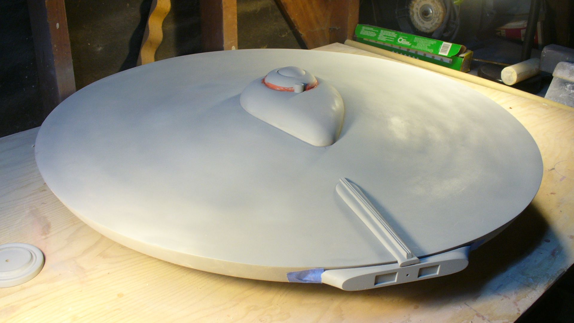

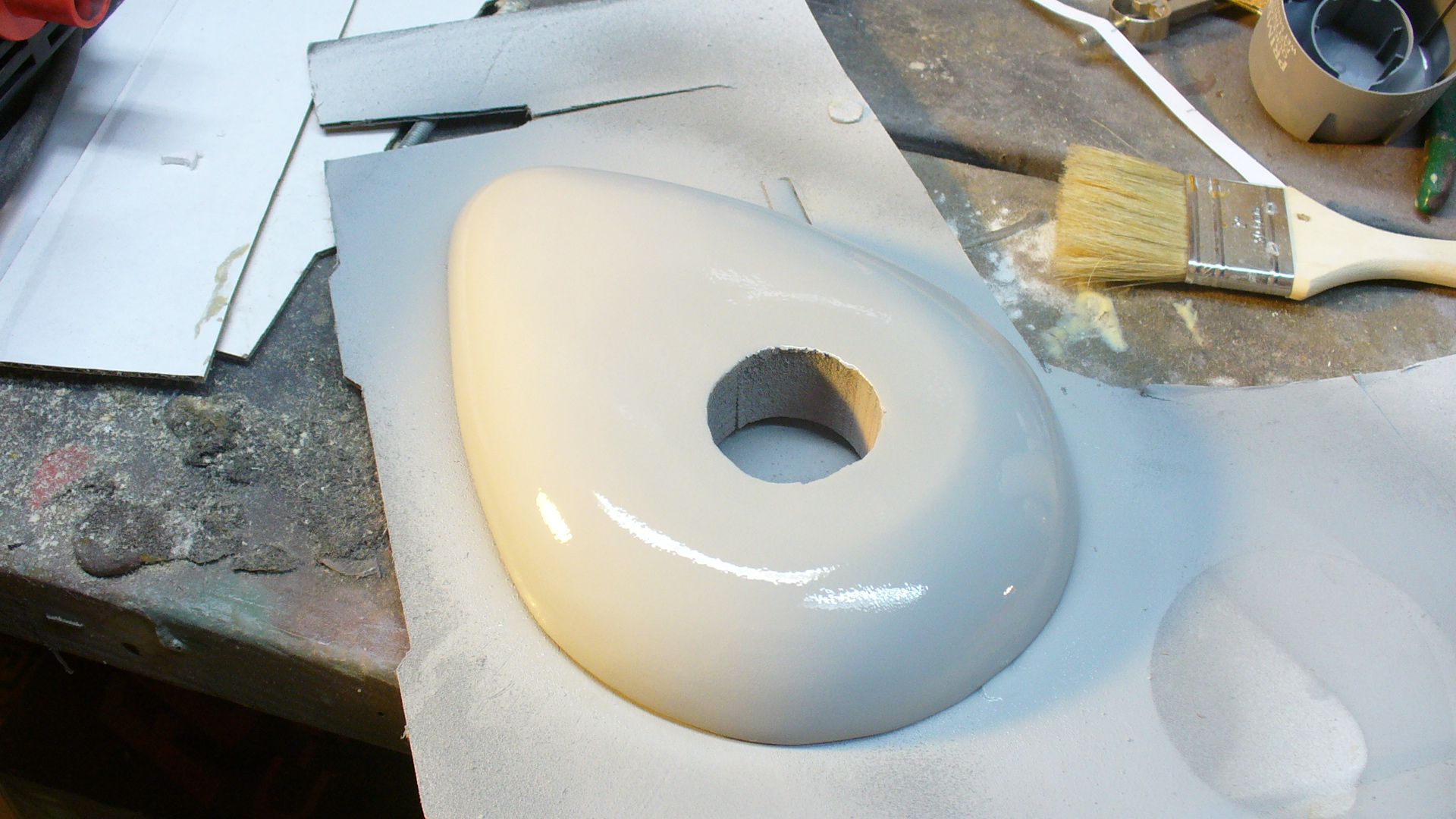

The contour came from my plans. Cut the side view into the part. It's close but will have to have a bit of putty squeezed nicer it against the saucer for the final fit. I'll show that pretty soon but today it's impulse engines.

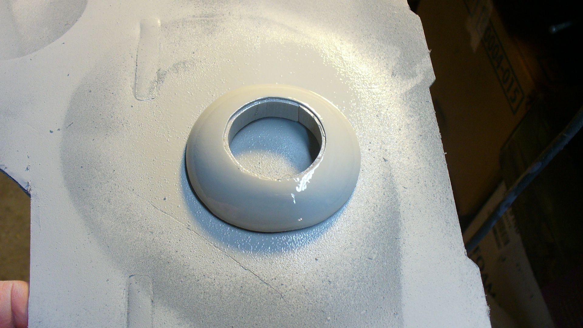

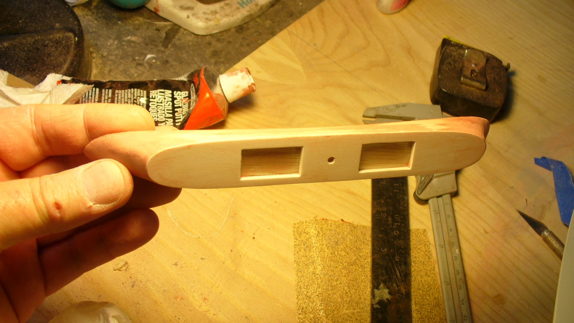

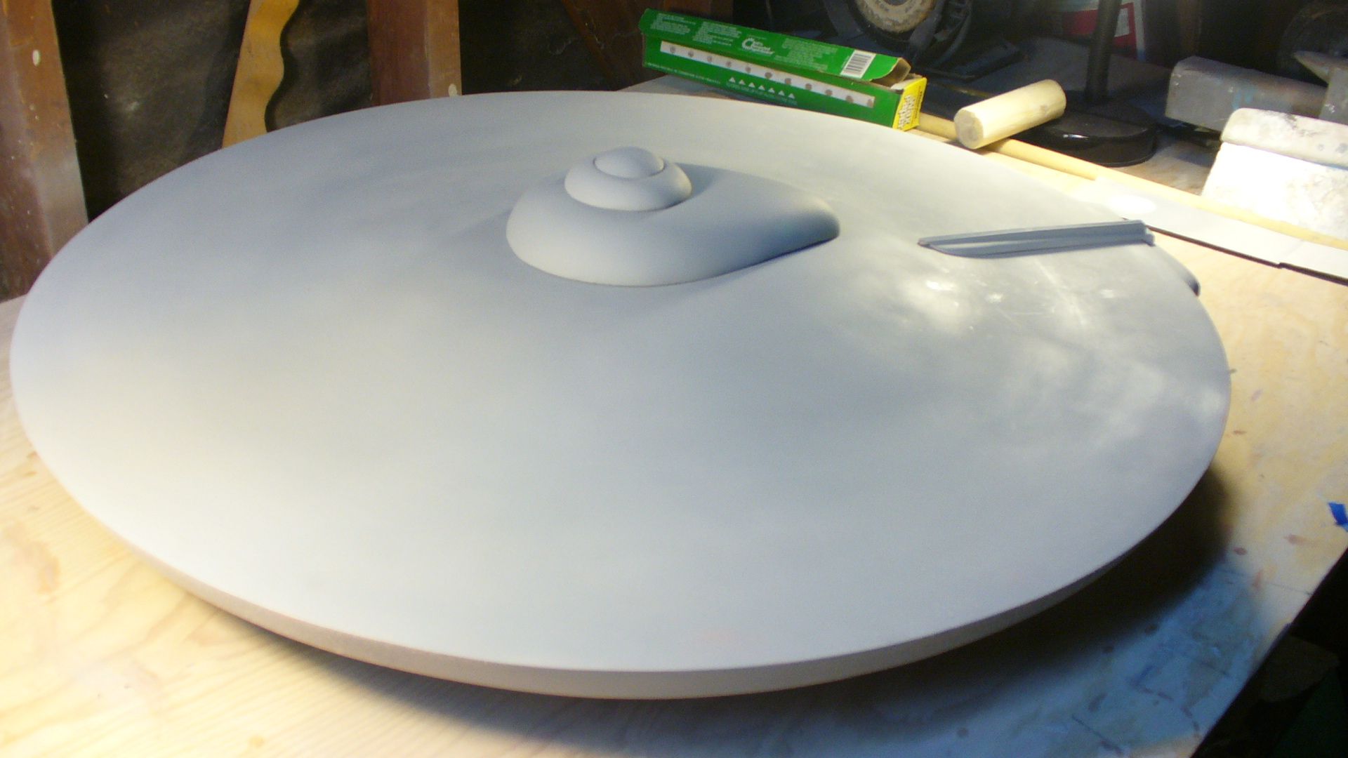

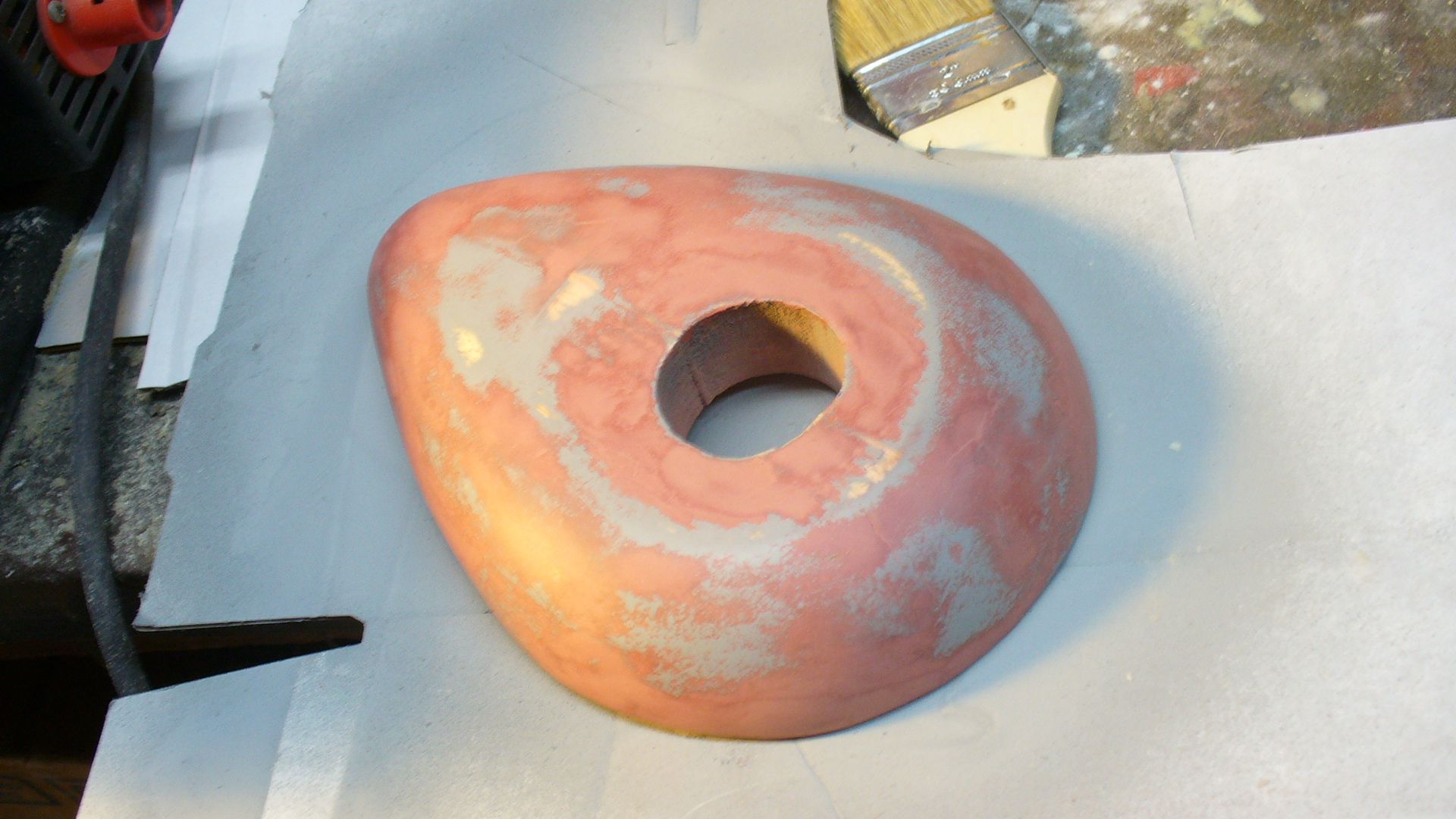

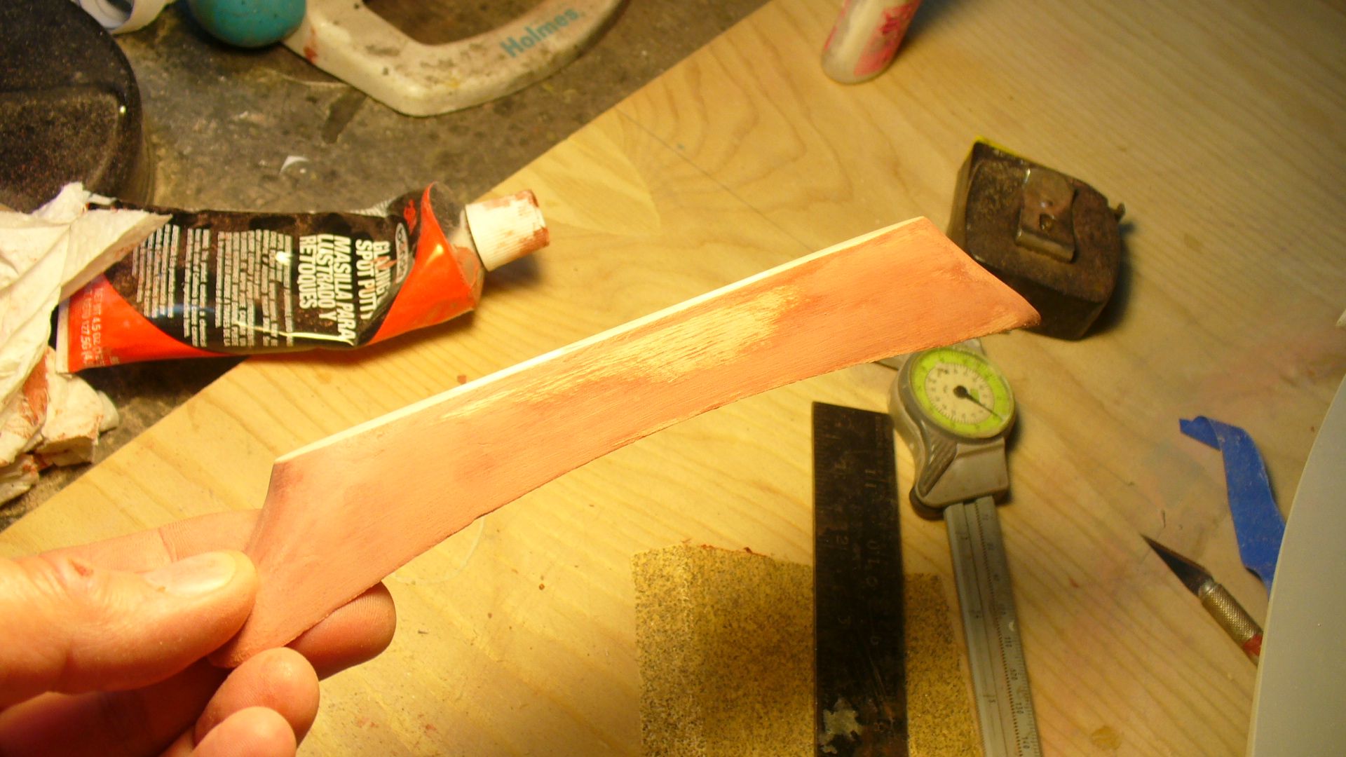

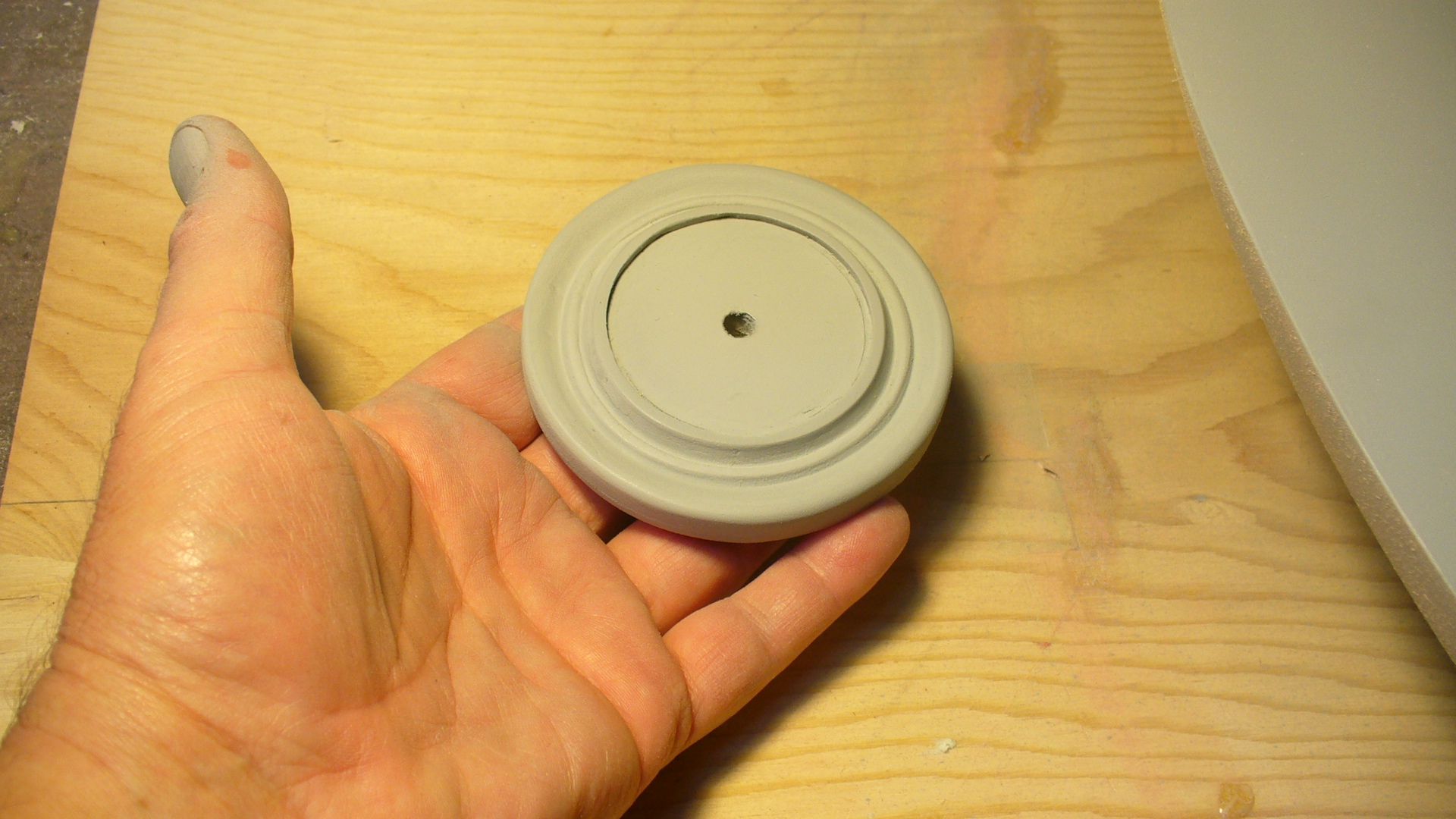

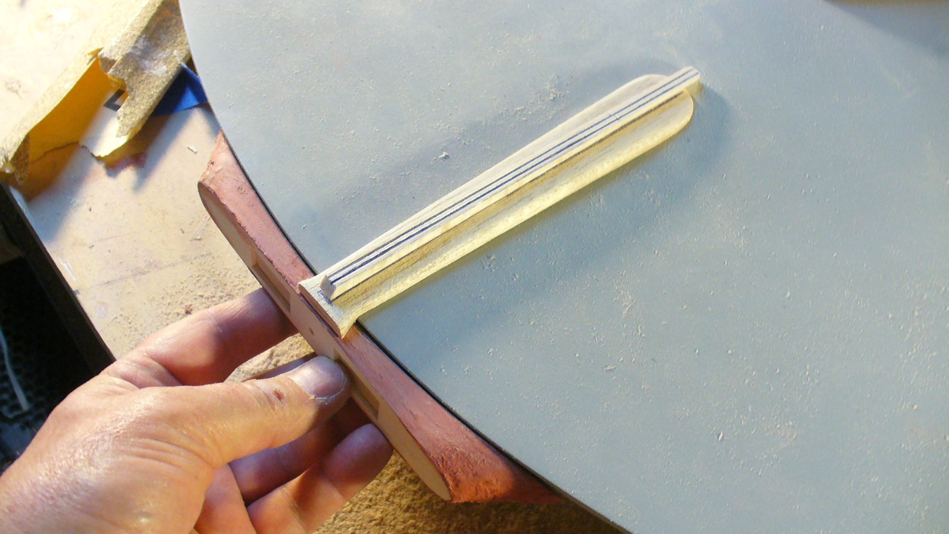

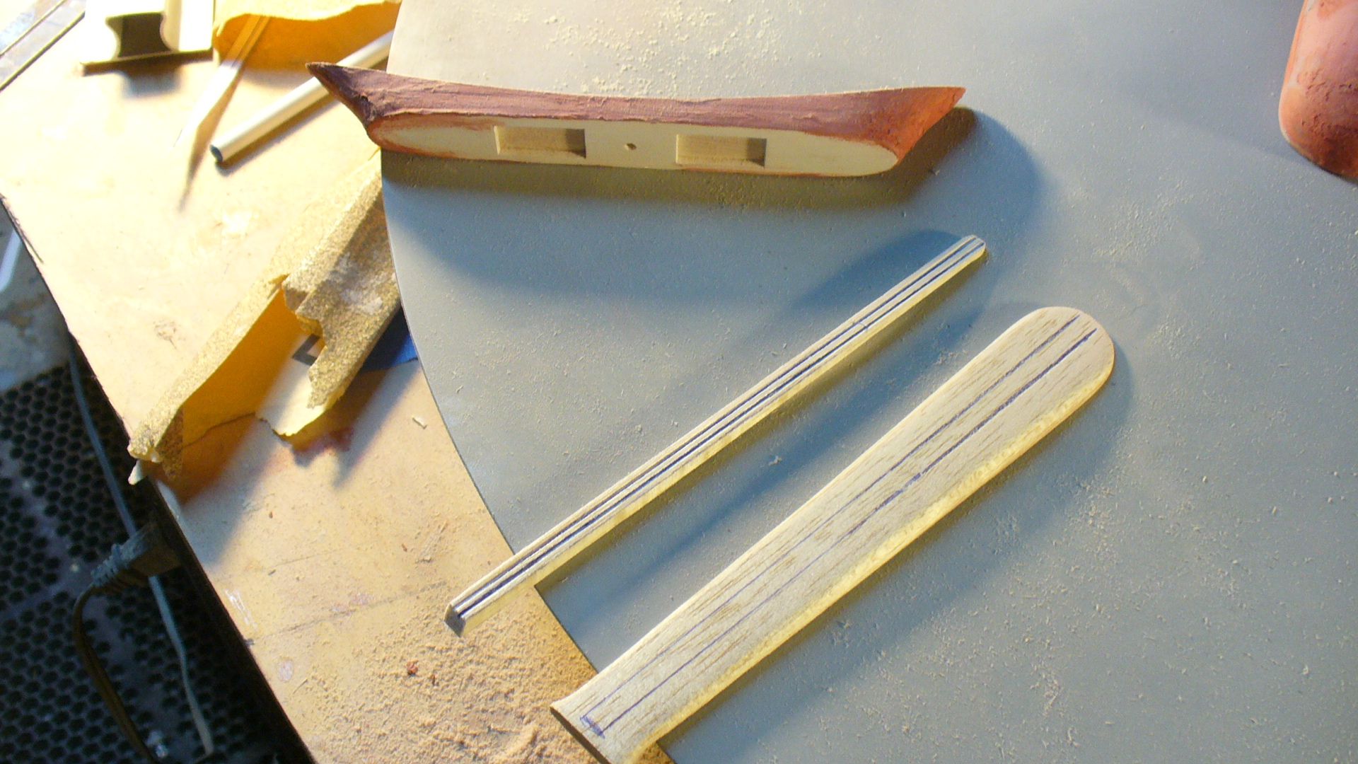

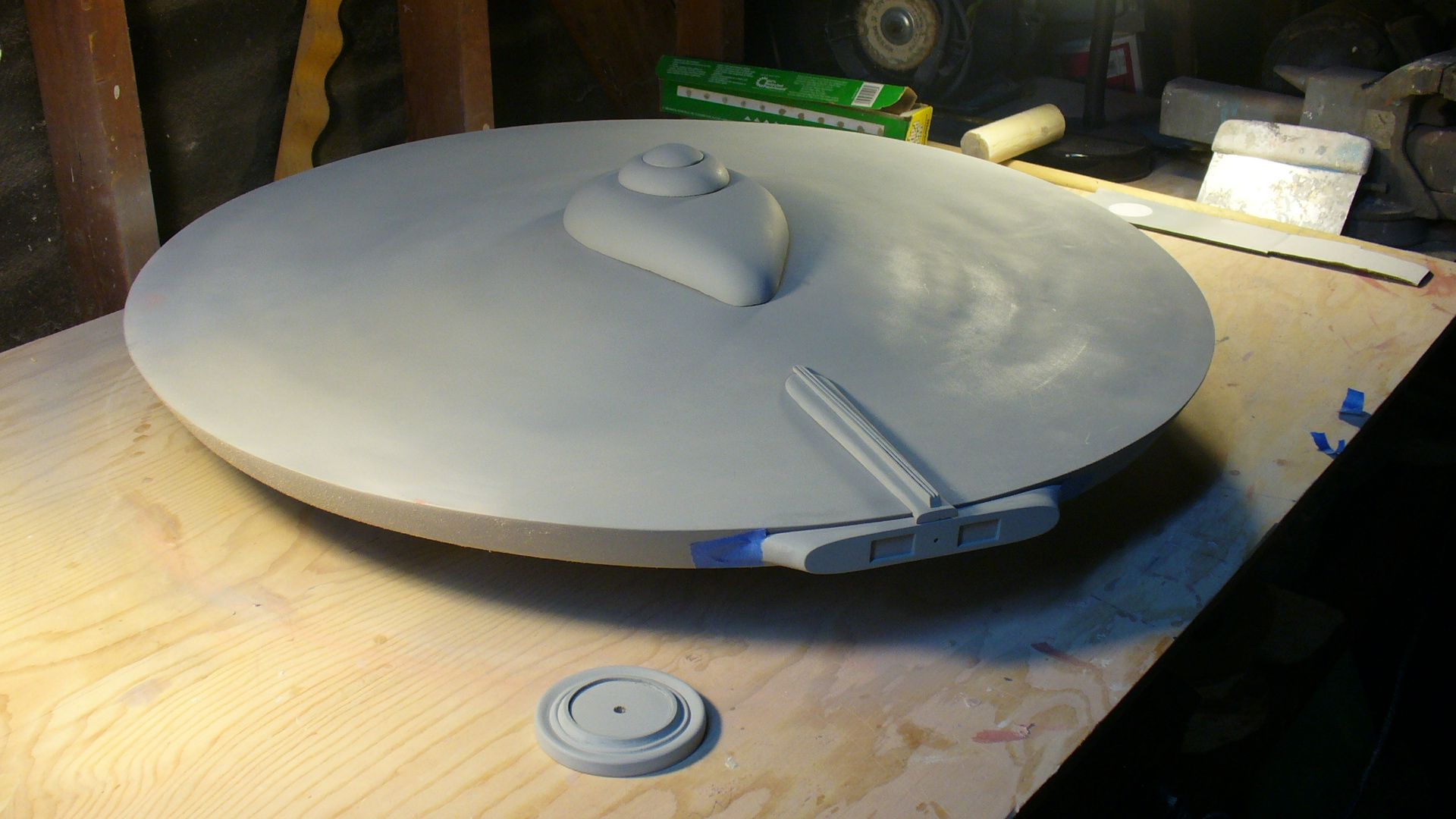

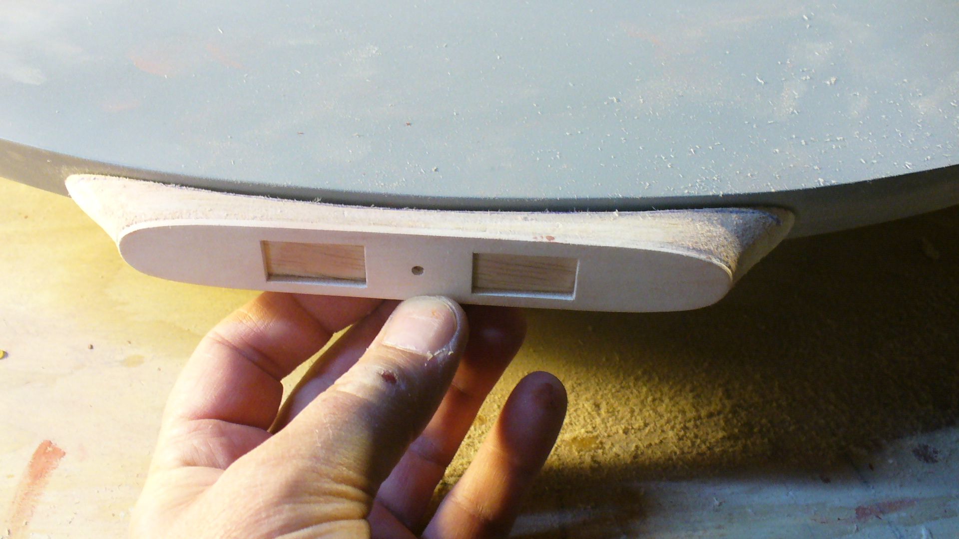

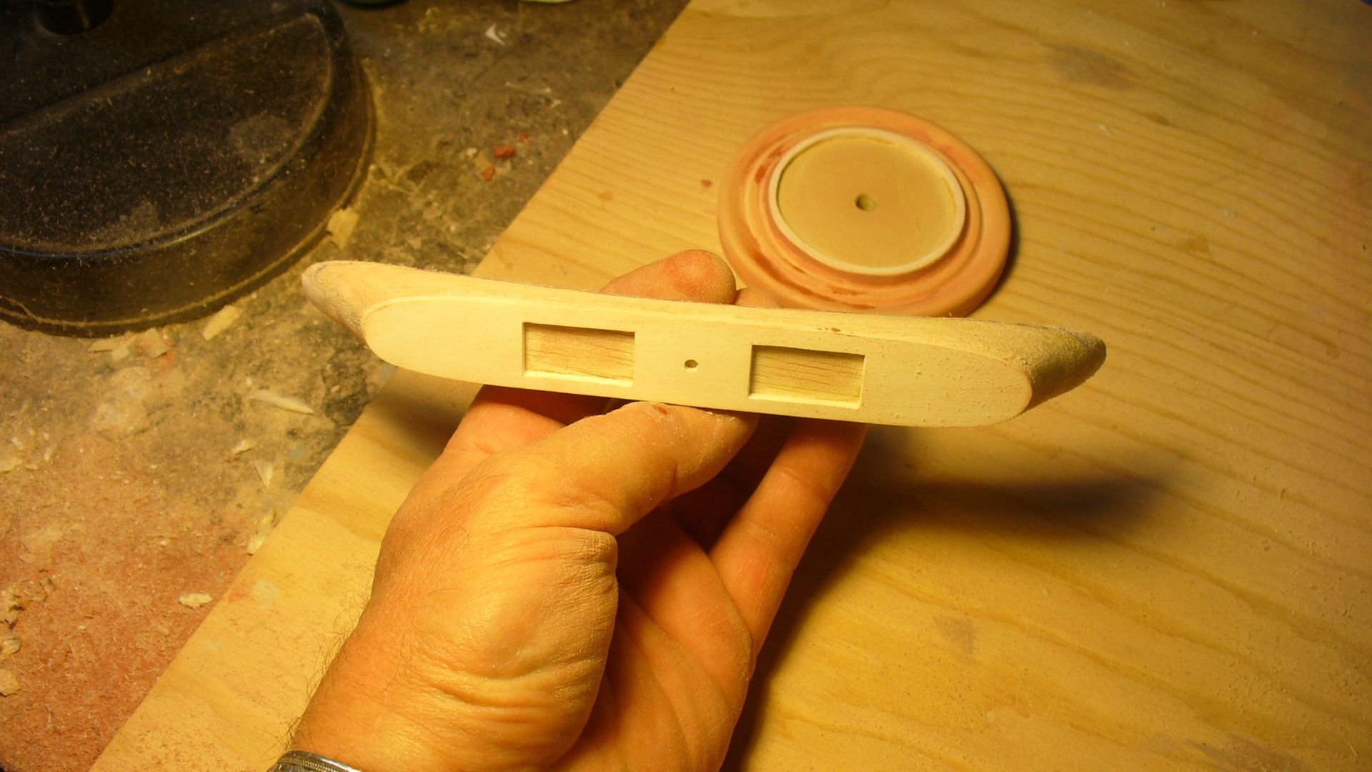

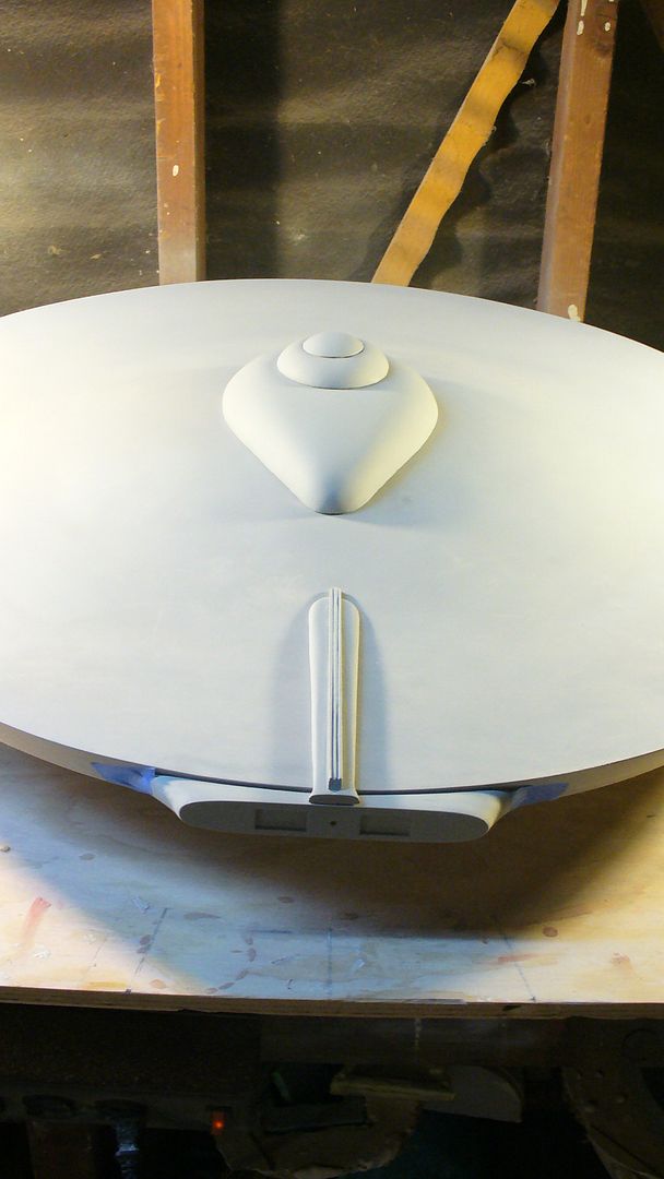

Today I made a lot of progress. Got the linear accelerator made. Not an easy part to free form. Got the impulse engines made. Finished off the bottom saucer dome ring. Went over all the parts a few times sanding and filling and adding lots of primer. Sanding that down again and doing it all over several times. They are starting to look pretty smooth.
A bit more tomorrow and I can start the scribing.

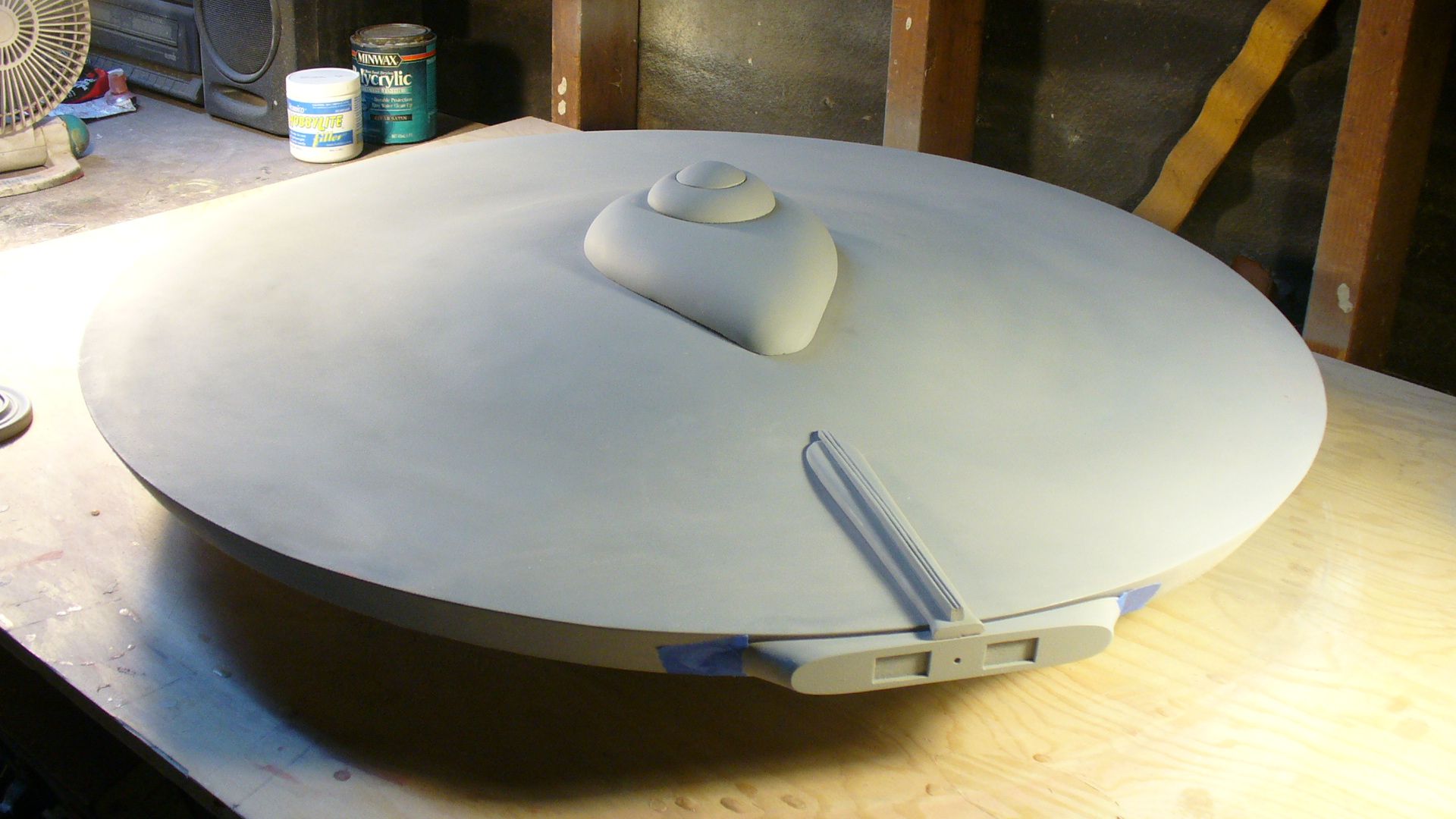

Taped the parts on for a look and I'll be darned if it's not starting to look like the Enterprise saucer section. Here is a bunch of pictures from today. Enjoy.
Steve

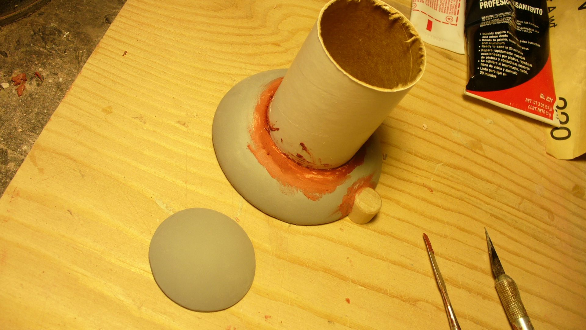

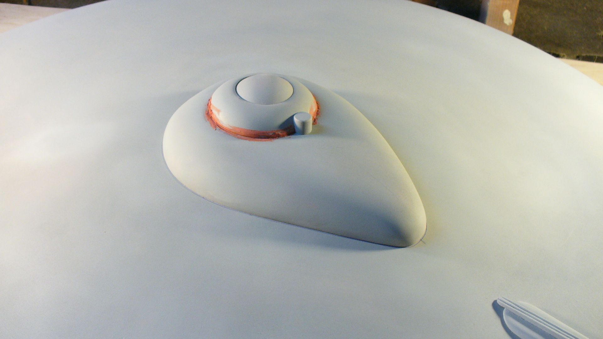

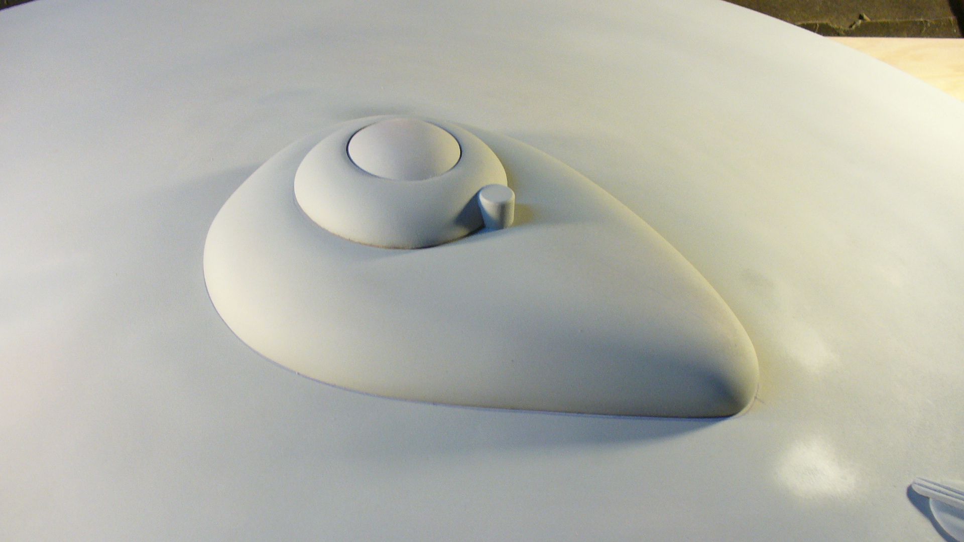

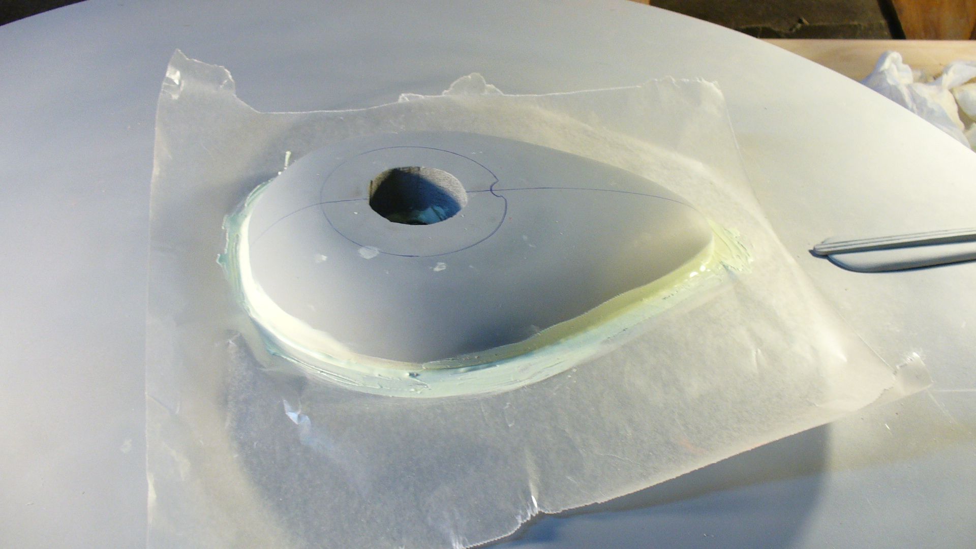

So today was mostly spent doing things around the house with the wife. All good stuff but I managed to get a few hours in on the big E.
Mostly cleaning up the parts I have already made. Making them fit well and true to each other and to the saucer. Laying down wax paper and putting finishing glaze between the saucer and the bridge assembly to get that perfect fit and clean edges. Later finished off with spot putty to make it super clean.
Also, I added the Turbo Lift. ;)

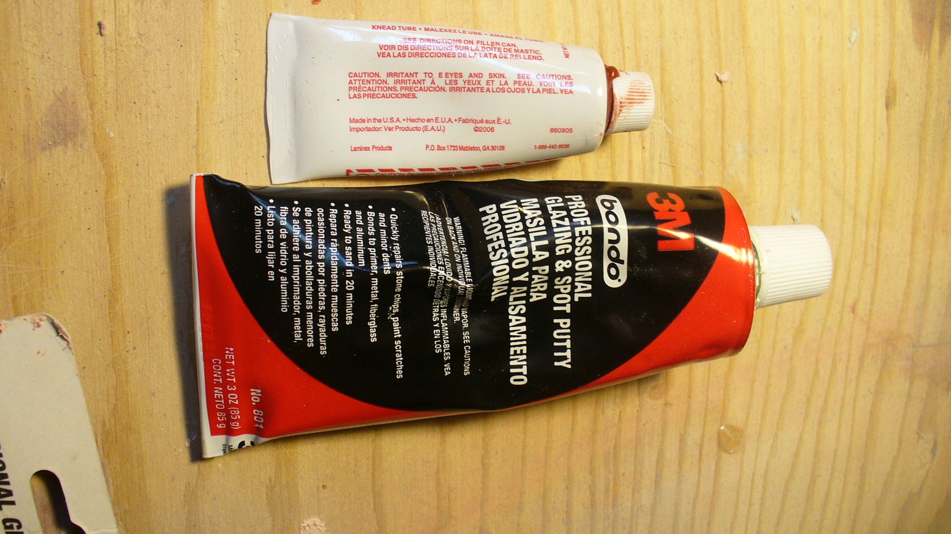

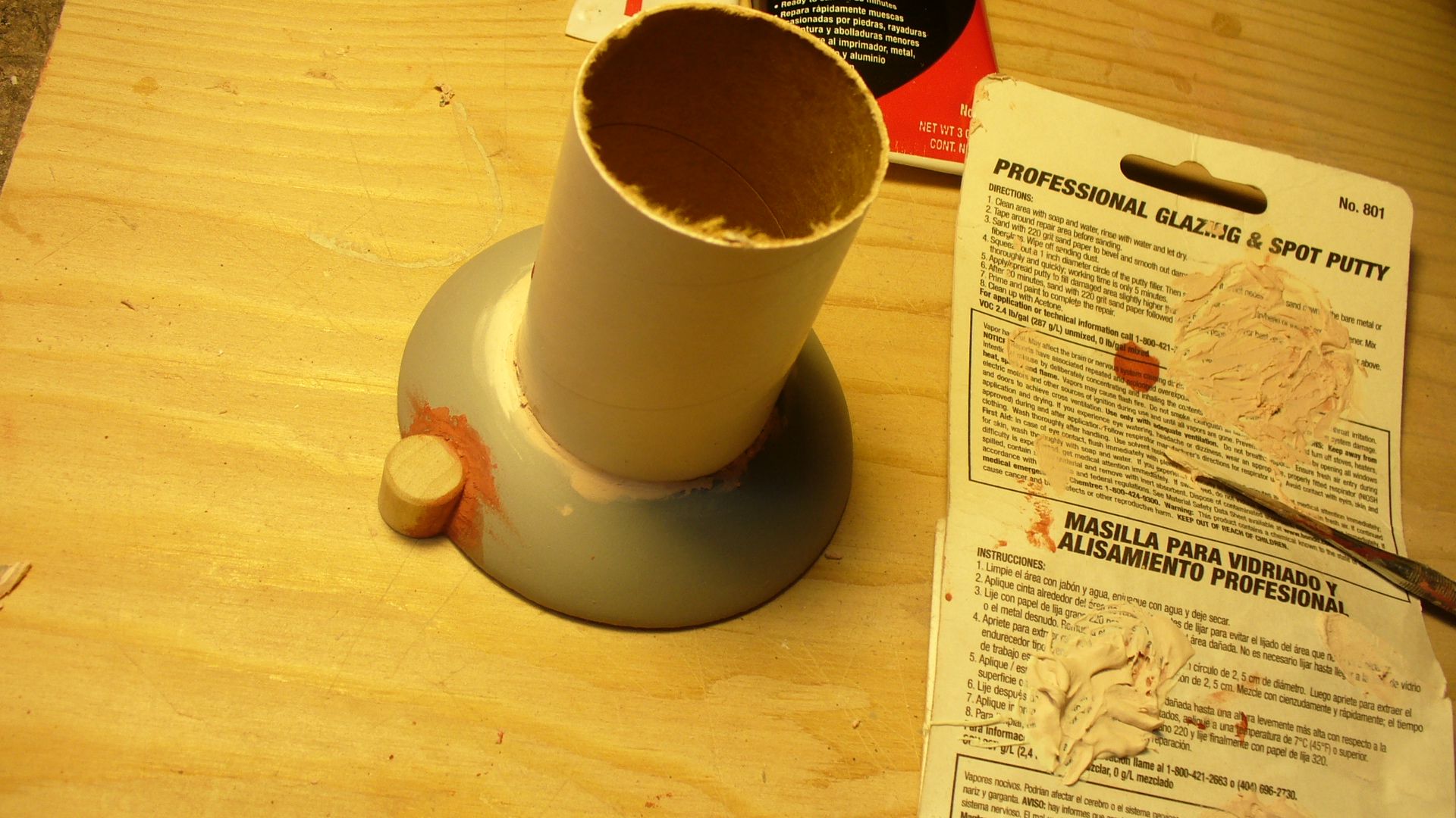

I bought some more Bondo spot putty the other day but when I got home I realized that one of the two tubes was different. It seems they looked so close I grabbed it my accident. It turned out to be happy accident because I had no idea Bondo made a finishing glaze and a good one at that. Small tube but it's handy and about 7 bucks. This is good stuff!
I'm hoping tomorrow to finish these parts off and move on to the bottom of the saucer. I'll be adding the three concentric circles and the landing gear covers.
