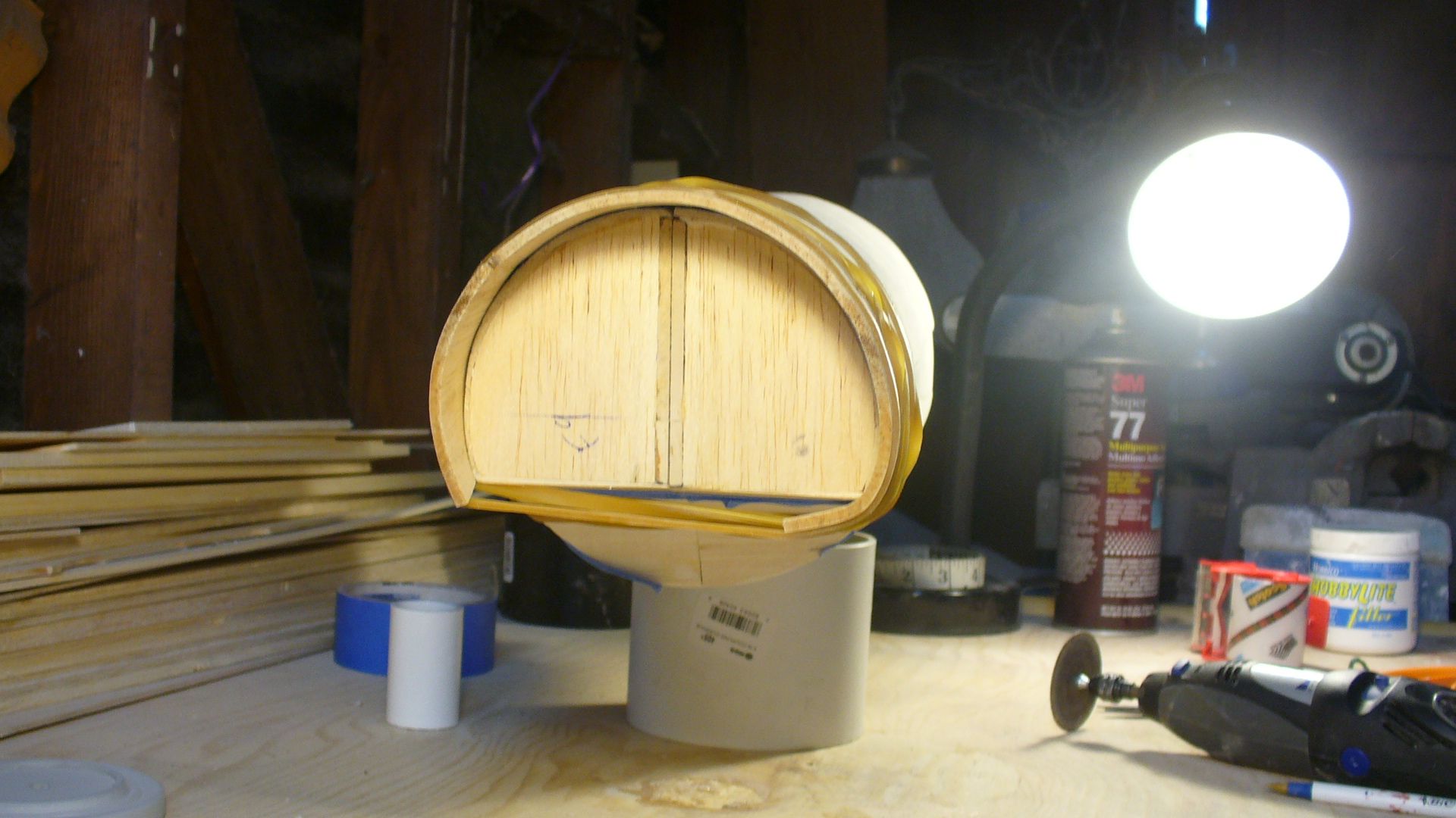

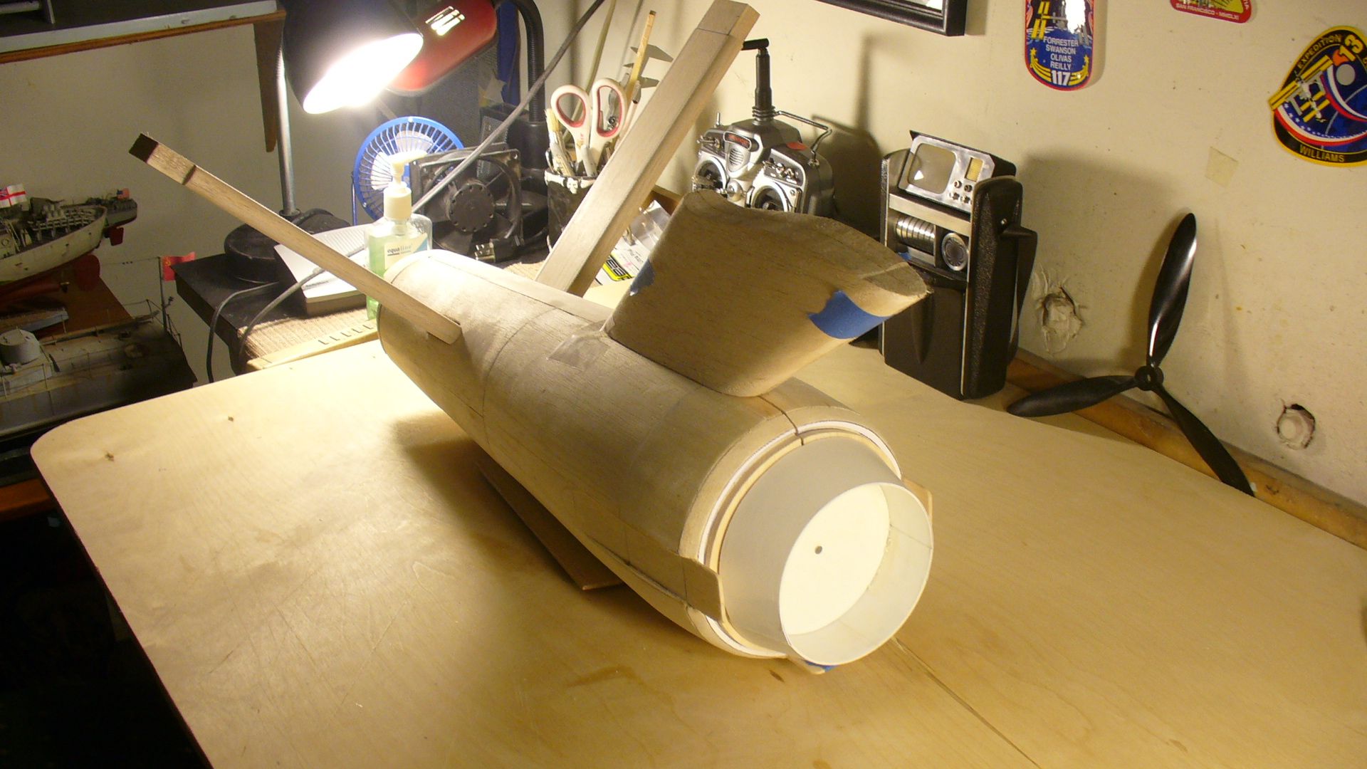

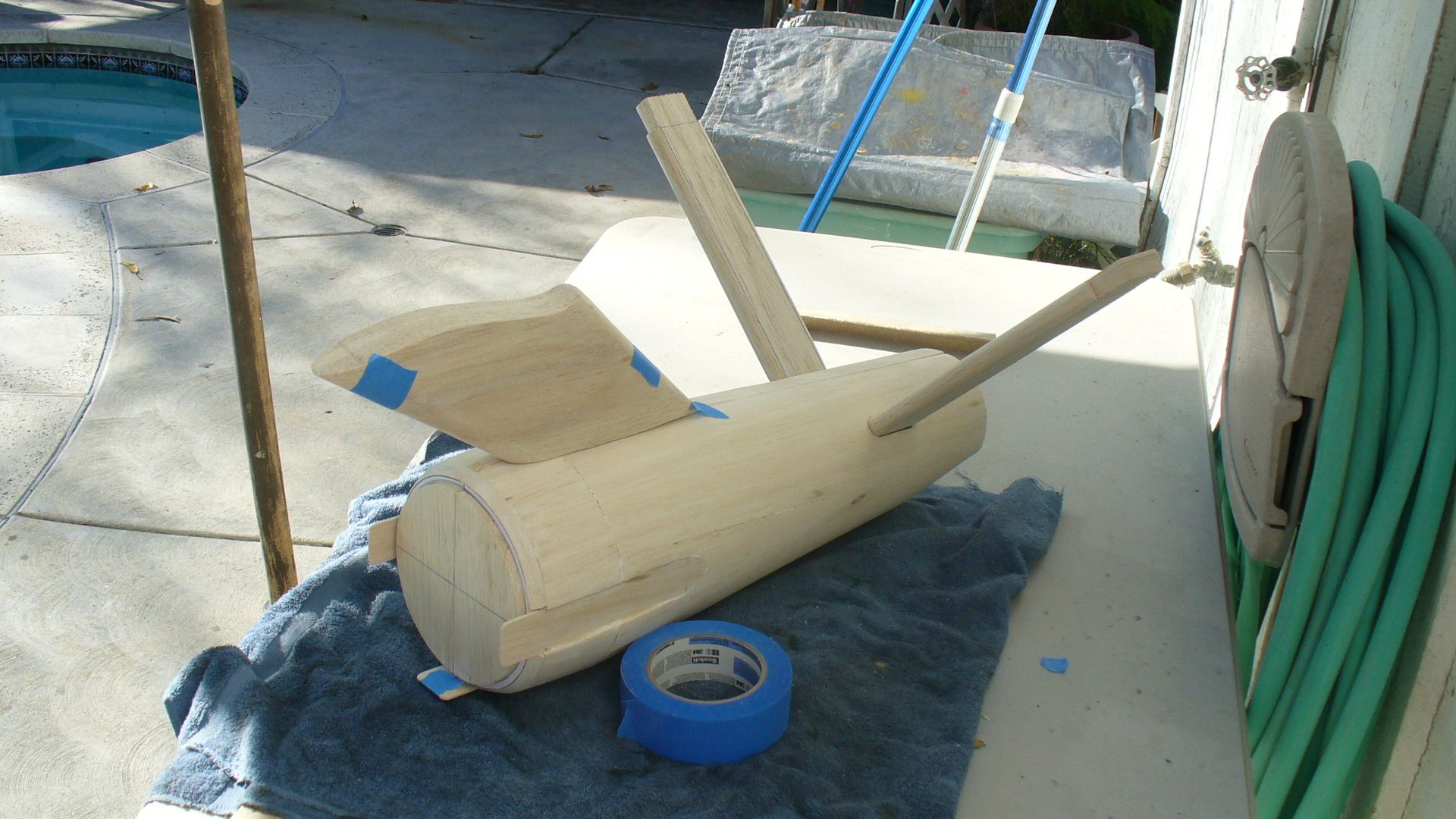

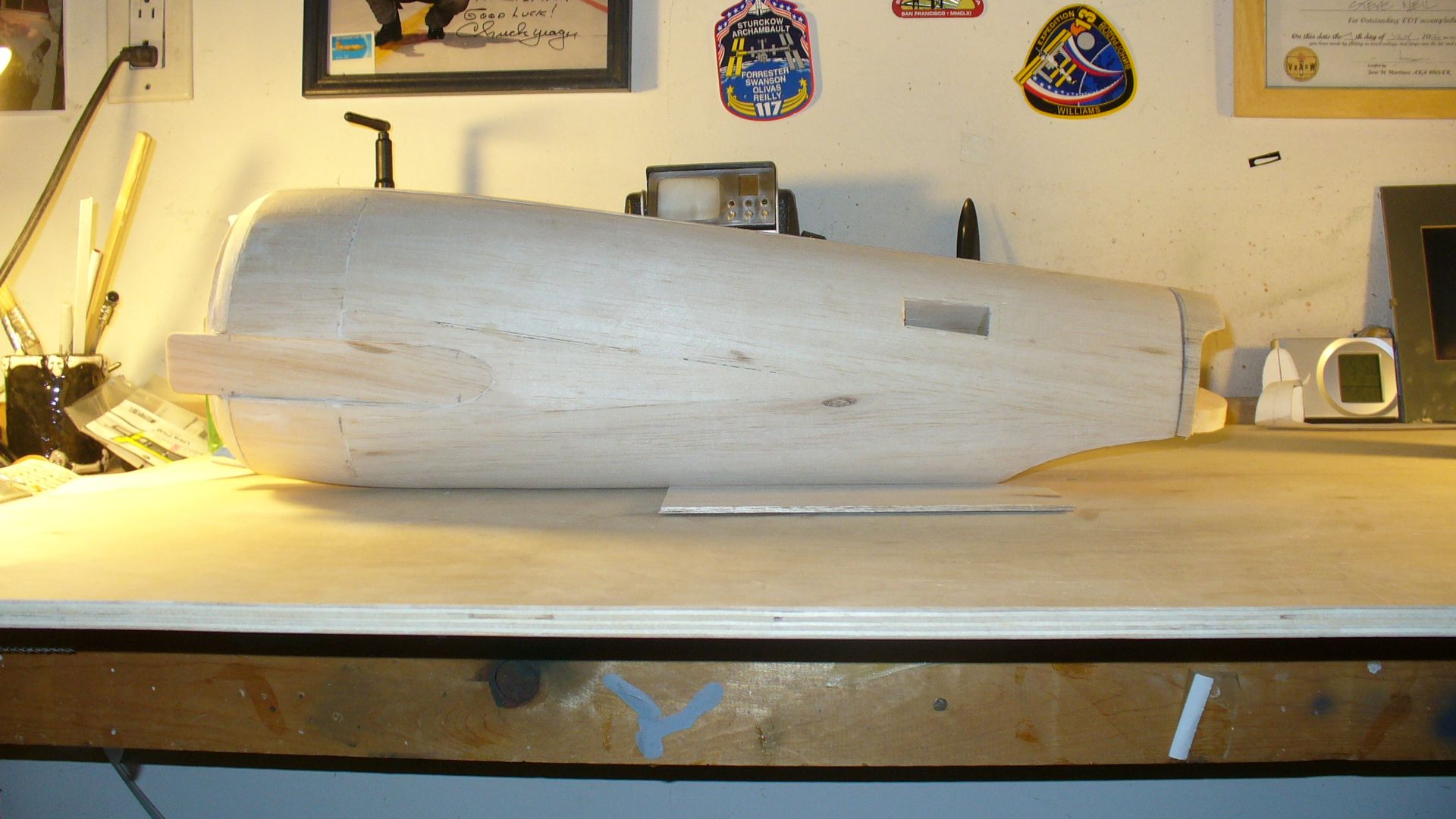

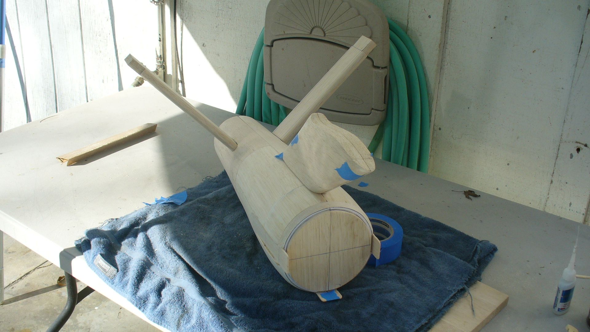

Today I spent sanding and pointing up the masters for the secondary hull and the pylon neck. This needs to be done before I glass. You can always fill valleys but it's hard to get rid of them mountains!

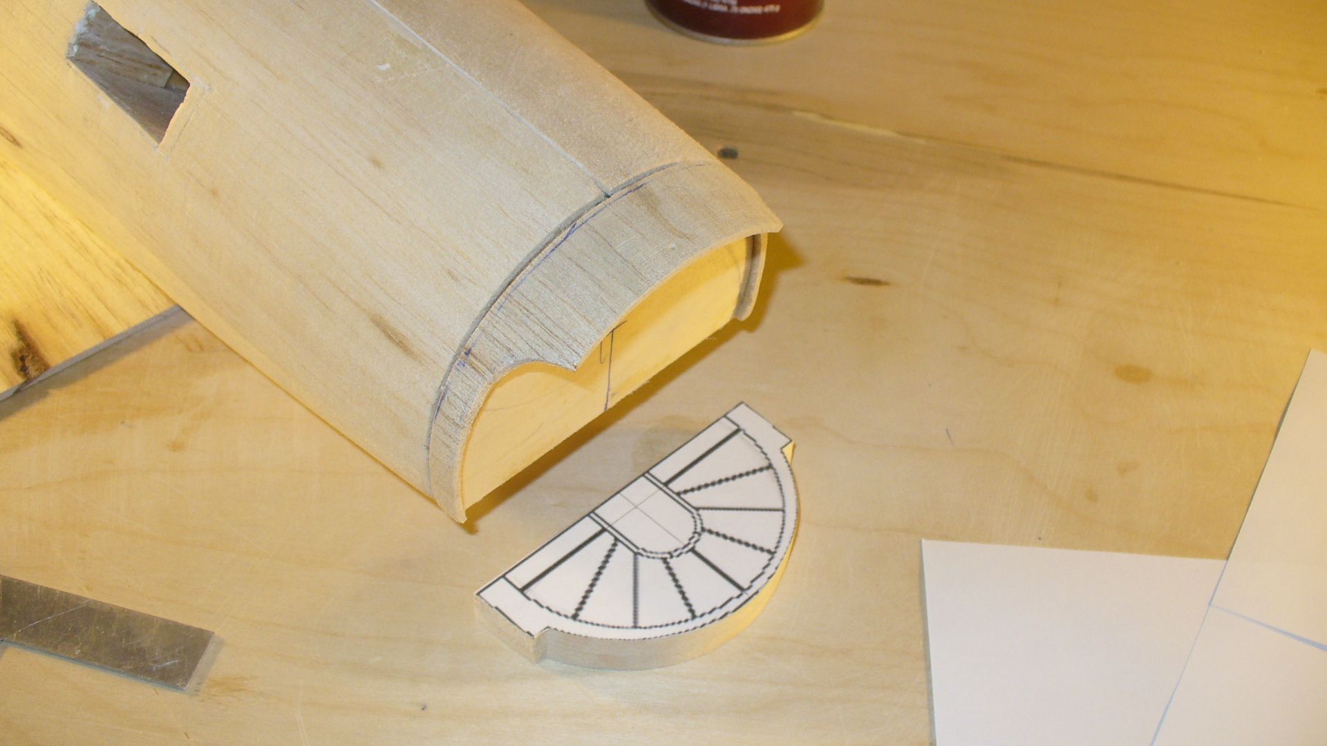

Additionally I started work on the hanger bay structure. This assembly when done fits deep inside the hull. Currently until I have a casting of the hull in glass I can't show that.
The final part will have the rear bulkhead, doors and the outer structure as one piece if it works out like I hope. The idea here is to make a rough balsa and acrylic dome master. Mold it and cast it from Alumilite and really point it up again and make another mold for production parts. This works very well as you can tool up the resin to be perfect unlike balsa or clay.

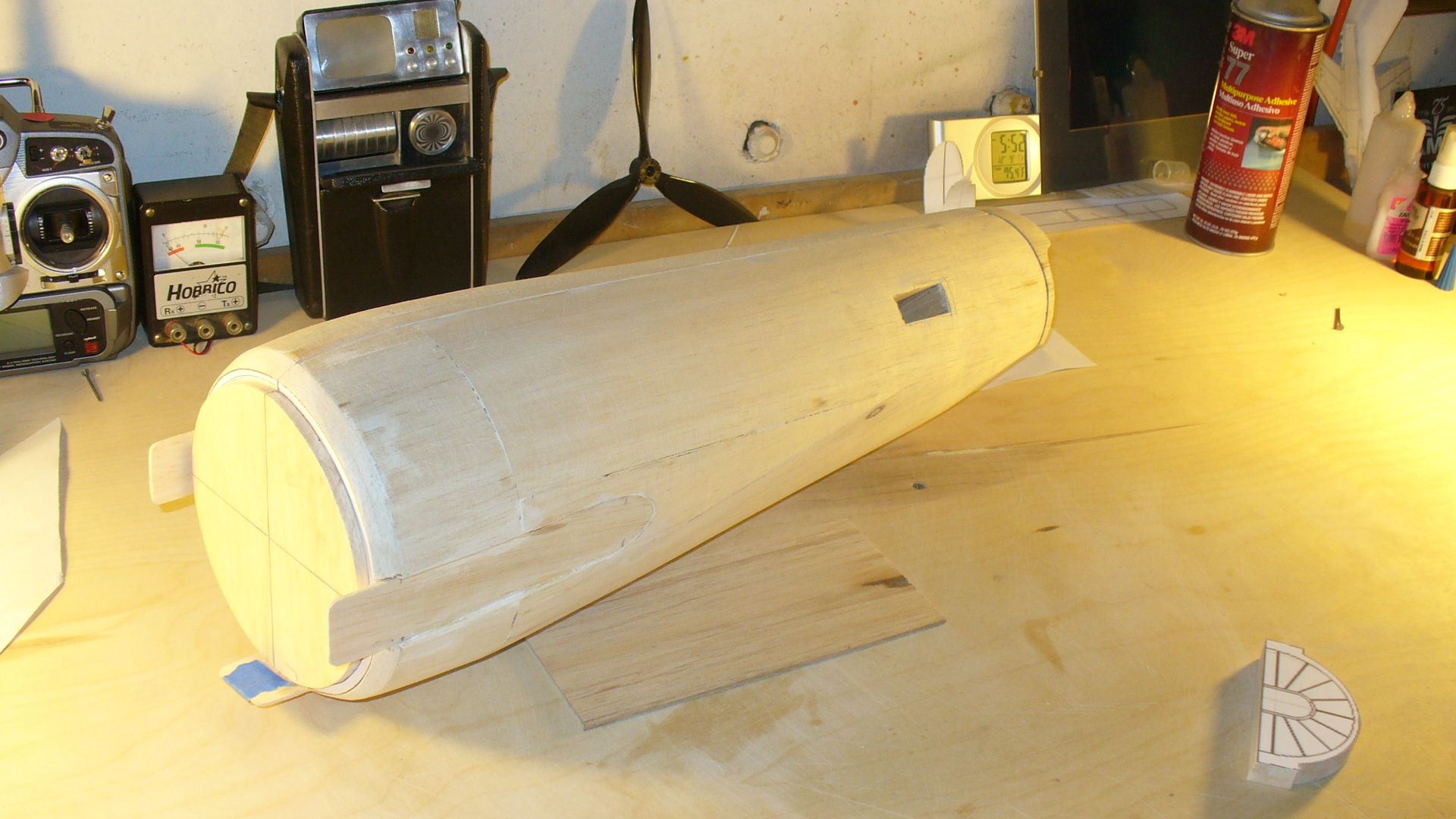

Tomorrow I hope to finish off the hanger bay and move to the sensor array concentric circles and outer cone. These need to be all roughed out and attached to the hull and cehcked before I glass it to make sure every thing is right.

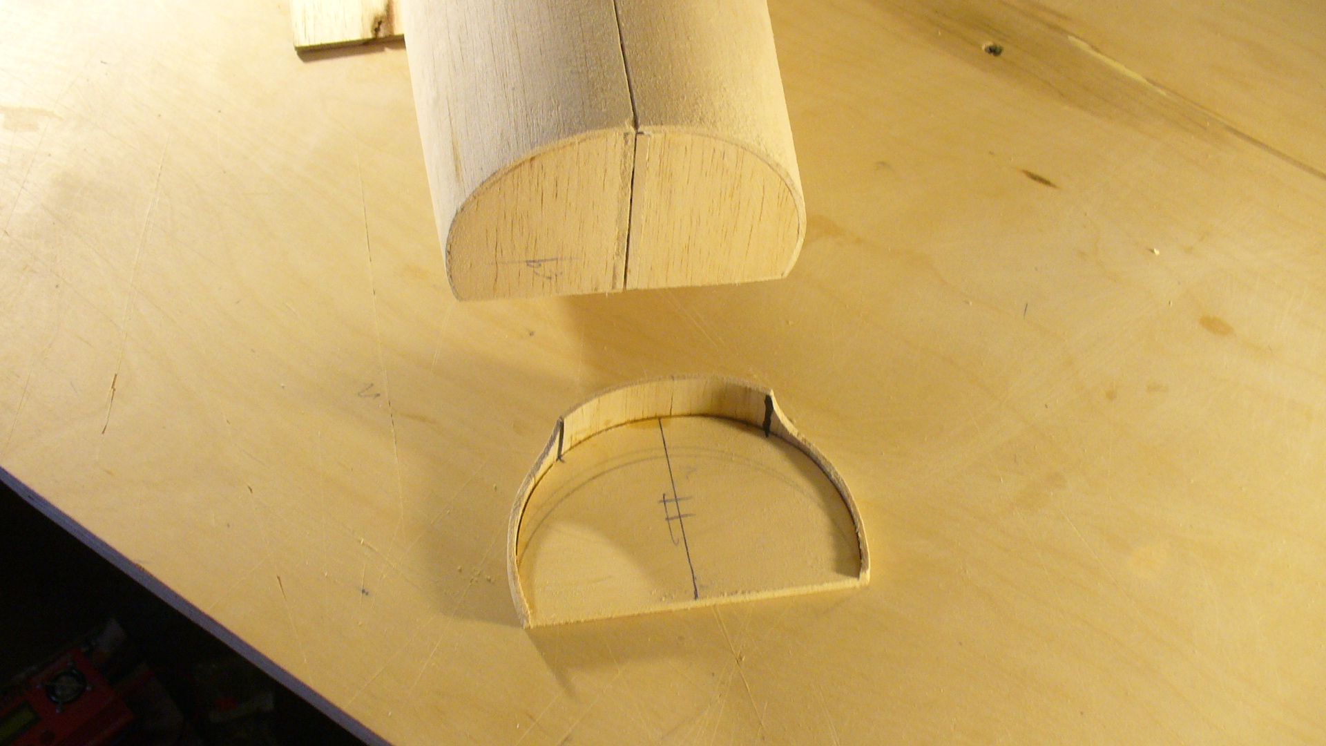

I added this part just for a look to check profile and measurements. It doesn't get used. The larger piece with the template is the actual part to be.

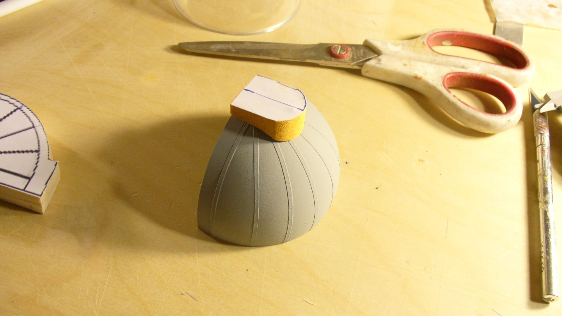

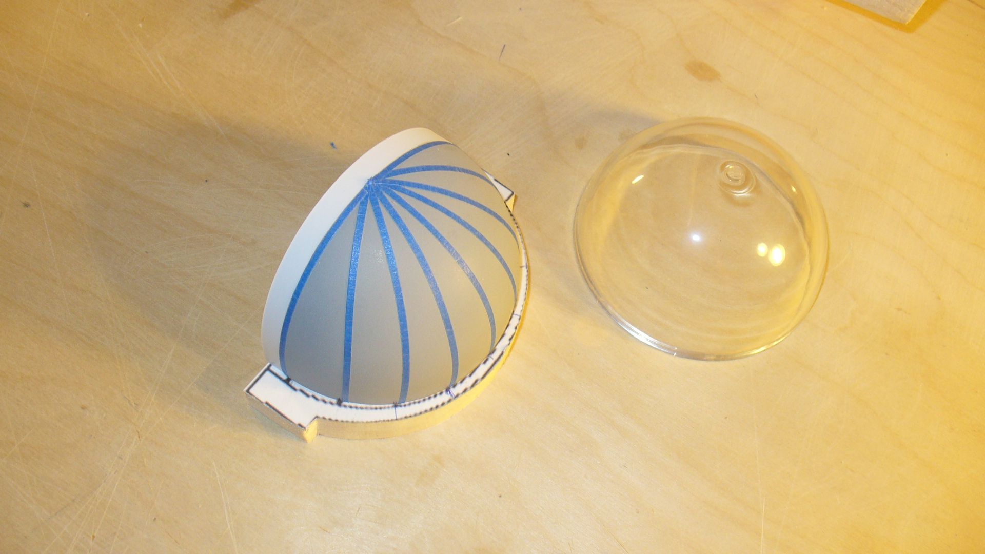

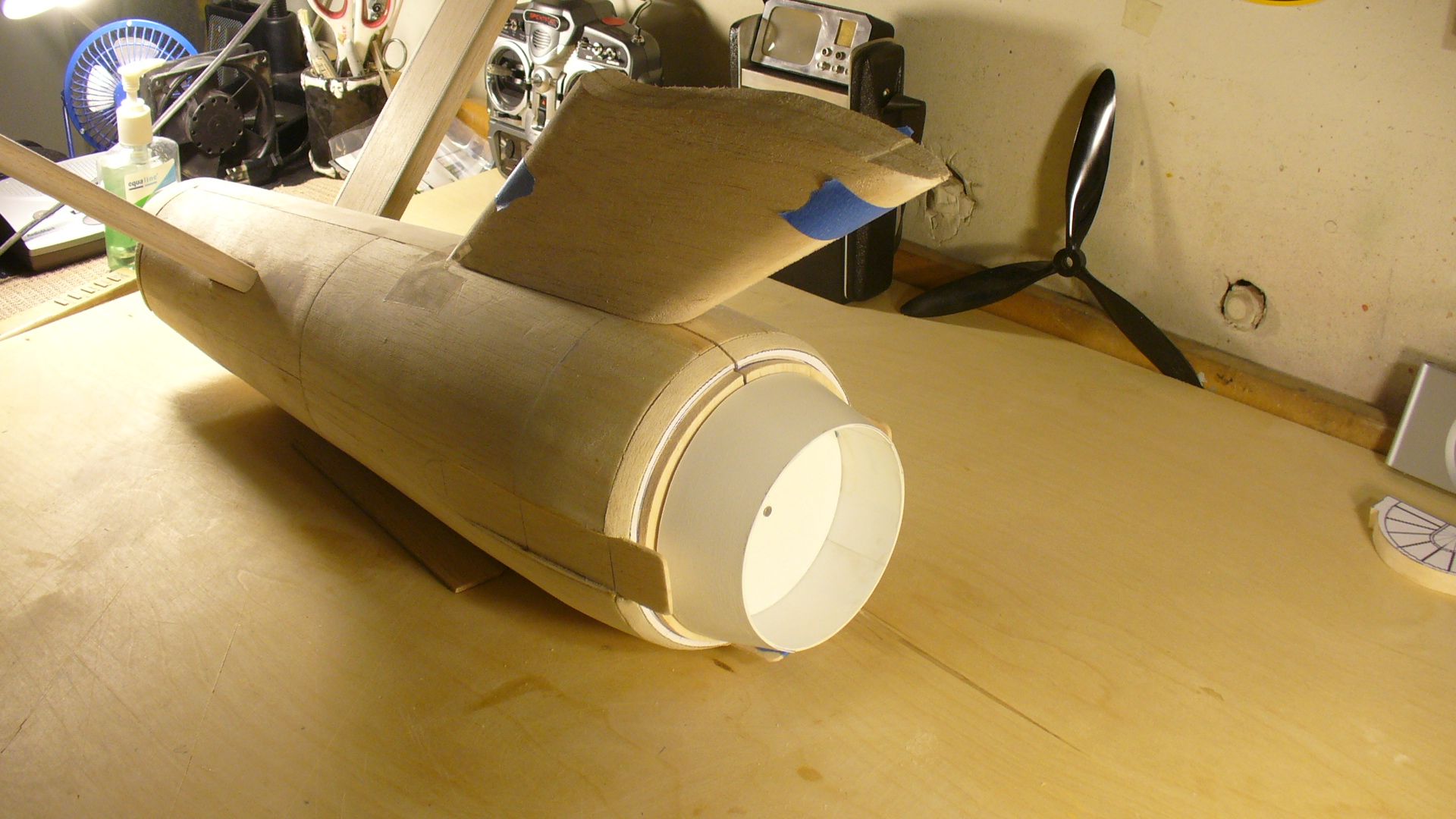

Another long day on the Big E. First a trip to Kit Craft. What a place. Go check it out on line. Got the half domes I needed for the nacelles and the hanger door. As fate would have it they had exactly the correct size for both. In a perfect world. Huh?

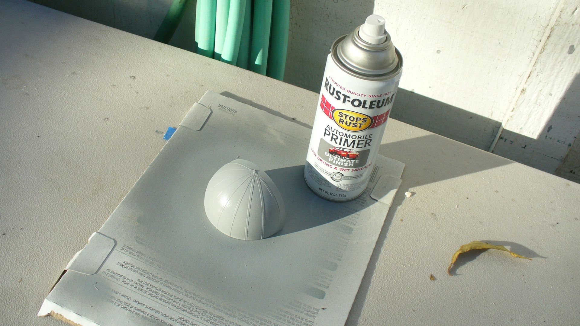

The technique I'm using for the hanger door panels is an old one used on model airplanes to simulate panel lines. Primer the surface first. Cut thin strips of tape. Lay them on until the look perfect. They are easy to readjust. Then primer the hell out of the surface lightly sanding in between ever 4 coats or so until it builds up thick enough. Once you remove the tape it leaves nice deep relief. Lightly sand the sharp edges off and one last light coat of primer. Works every time.
Got that difficult outer sensor array cone built today using PVC sheet for formers and styrene. This came out nearly perfect. I'll mold this and produce a resin part, point that up and make the final mold. Same with the little structure over the hanger door with the window. I made this out of balsa foam. Neat stuff. Never tried it before.

How many coats of primer do you usually end up spraying to get the right thickness/look? (for a nice, deep panel line)
Brandon,
Best thing to do is what I didn't. Do a test. But it's safe to say when you see the tape begin to submerge you are there. ;)
