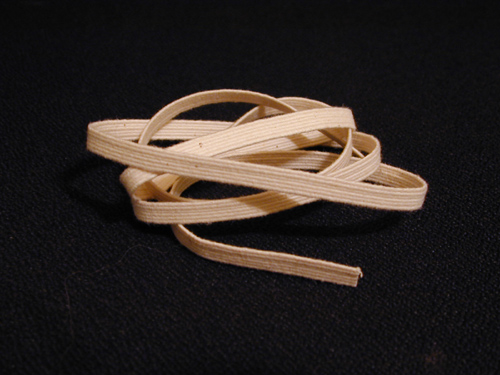

I've just come to the frightening conclusion that I will not be able to dress myself! <que shocking music> If I put the chest and back pieces on, I can snap the shoulder bell/bicep combo to the shoulder strap. However, I can't reach over far enough to snap the other one. I need to think about this.
You were right about elastic straps. I had some leftover canvas ones that have no give whatsoever and they came unsnapped from the bicep pieces at the slightest movement. Hopefully, these elastic ones will give some when I stretch my arms.
I found some off-white cotton elastic that should work well with the shoulder straps:
