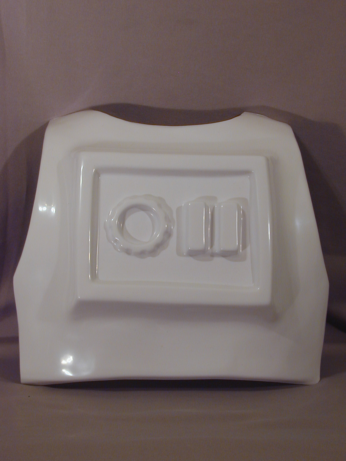

Here are shots of the individual armor pieces and some soft parts. The images are huge, so I'm just going to link to them.

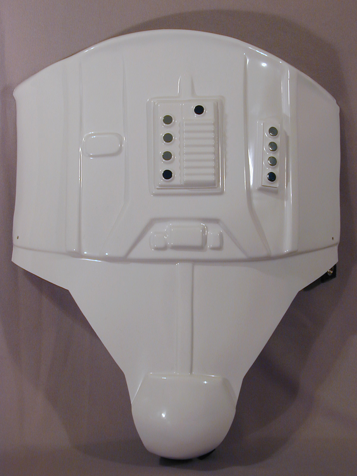

ab plate back
ab plate front

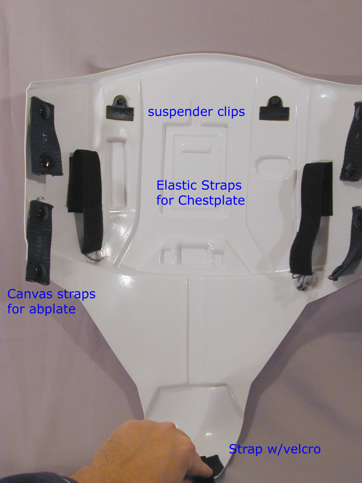

back front
back rear

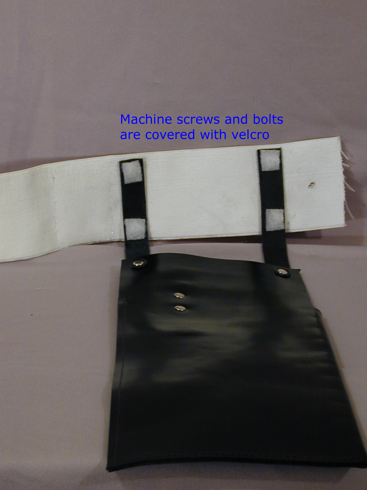

holster front
holster rear

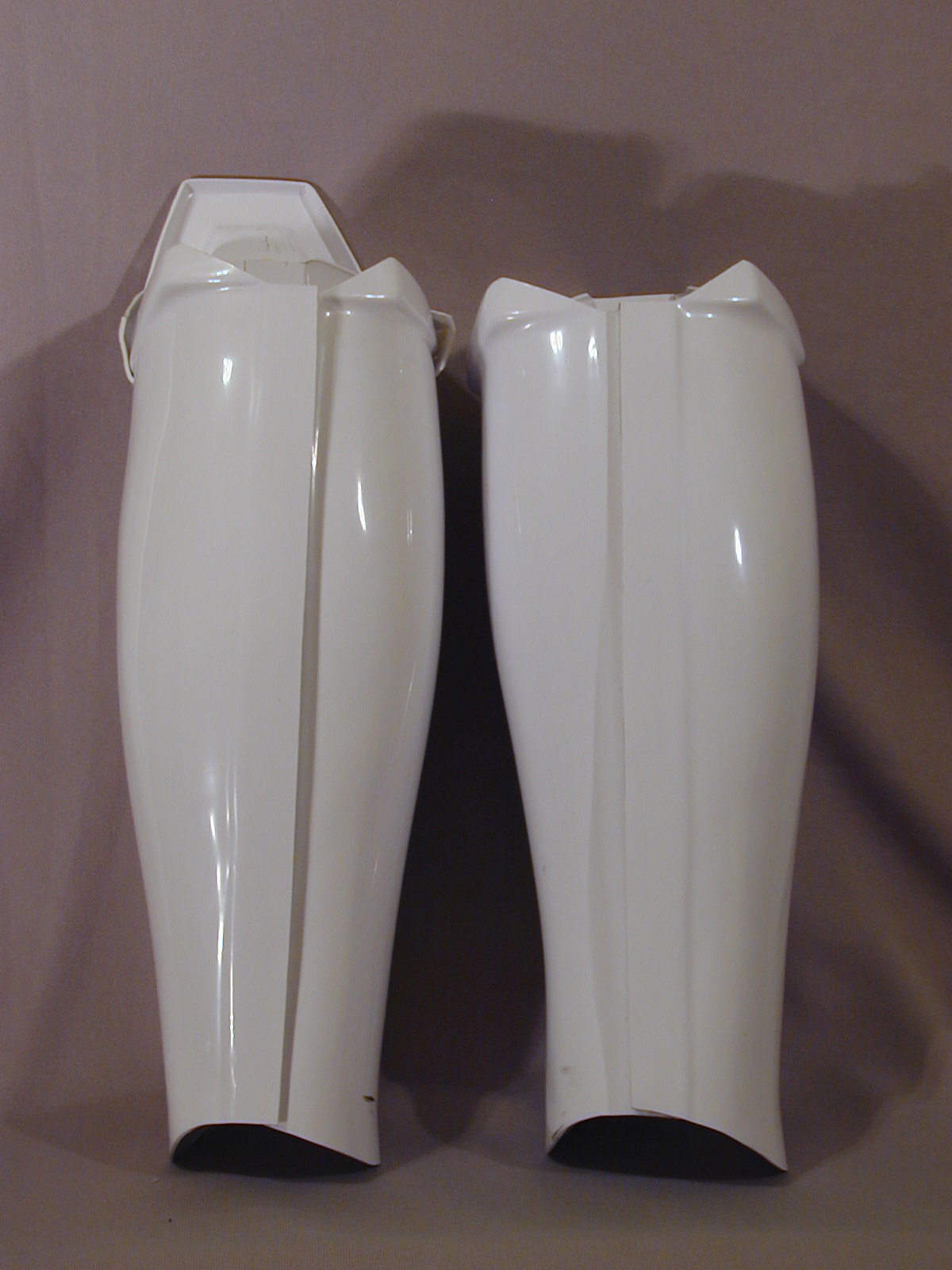

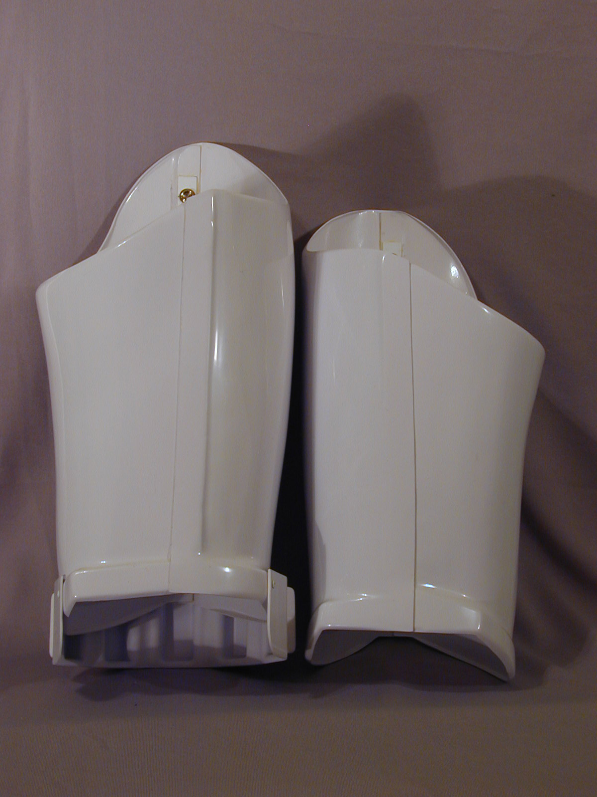

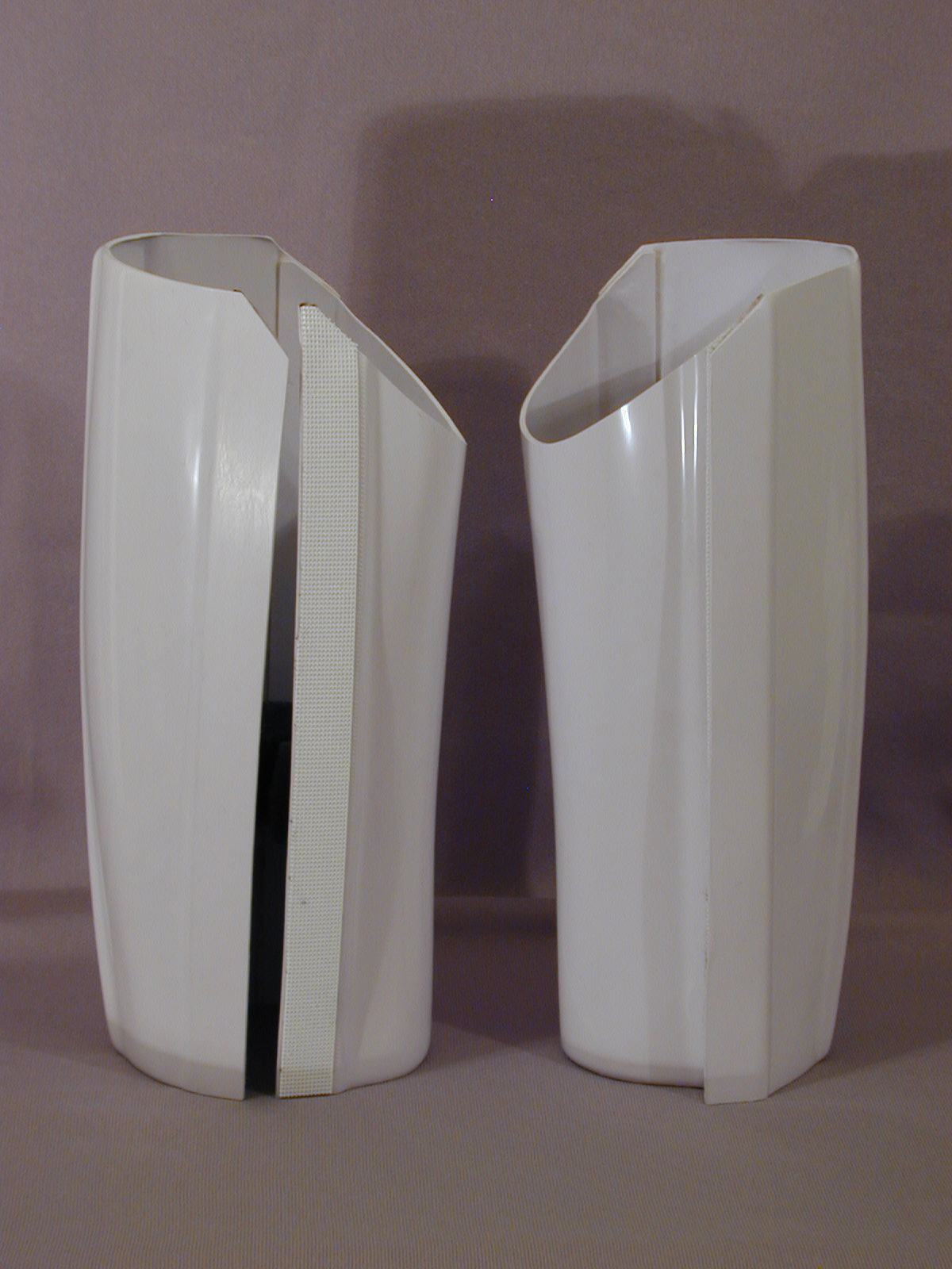

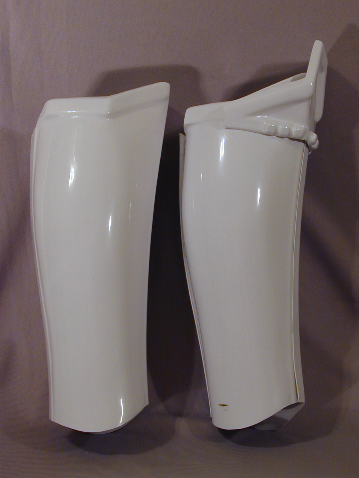

shins front
shins left
shins right
shins rear

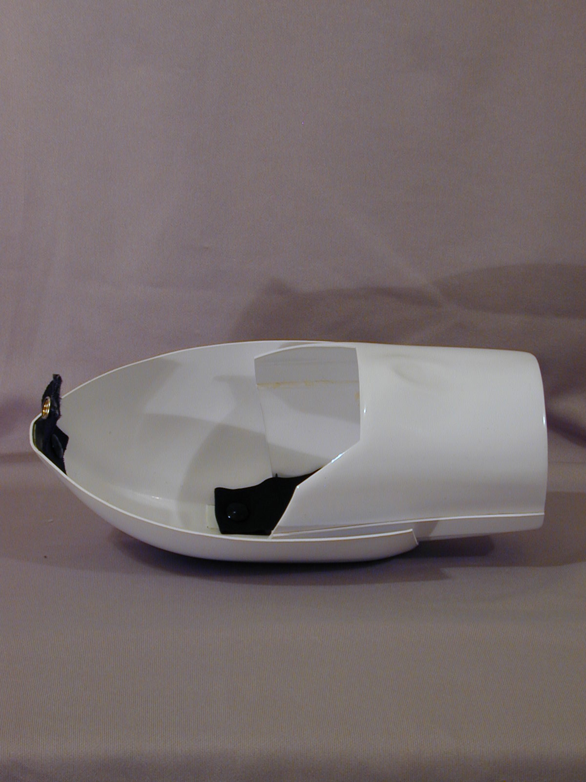

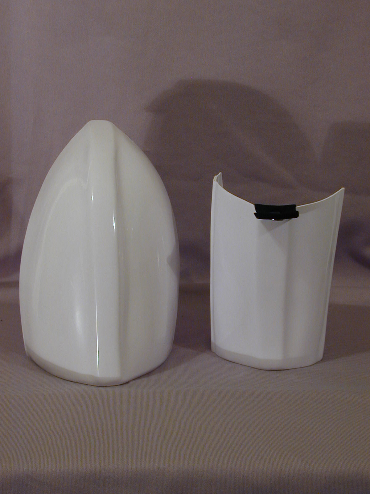

Some notes.

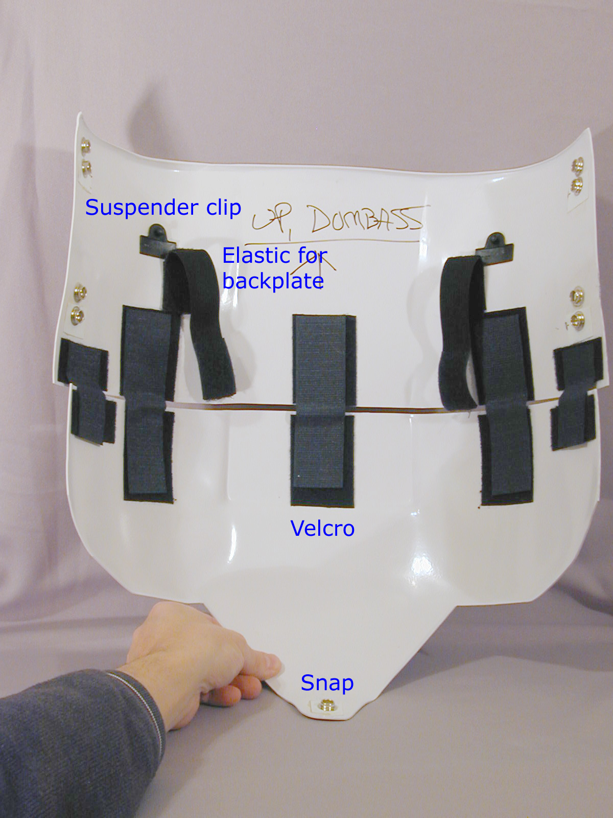

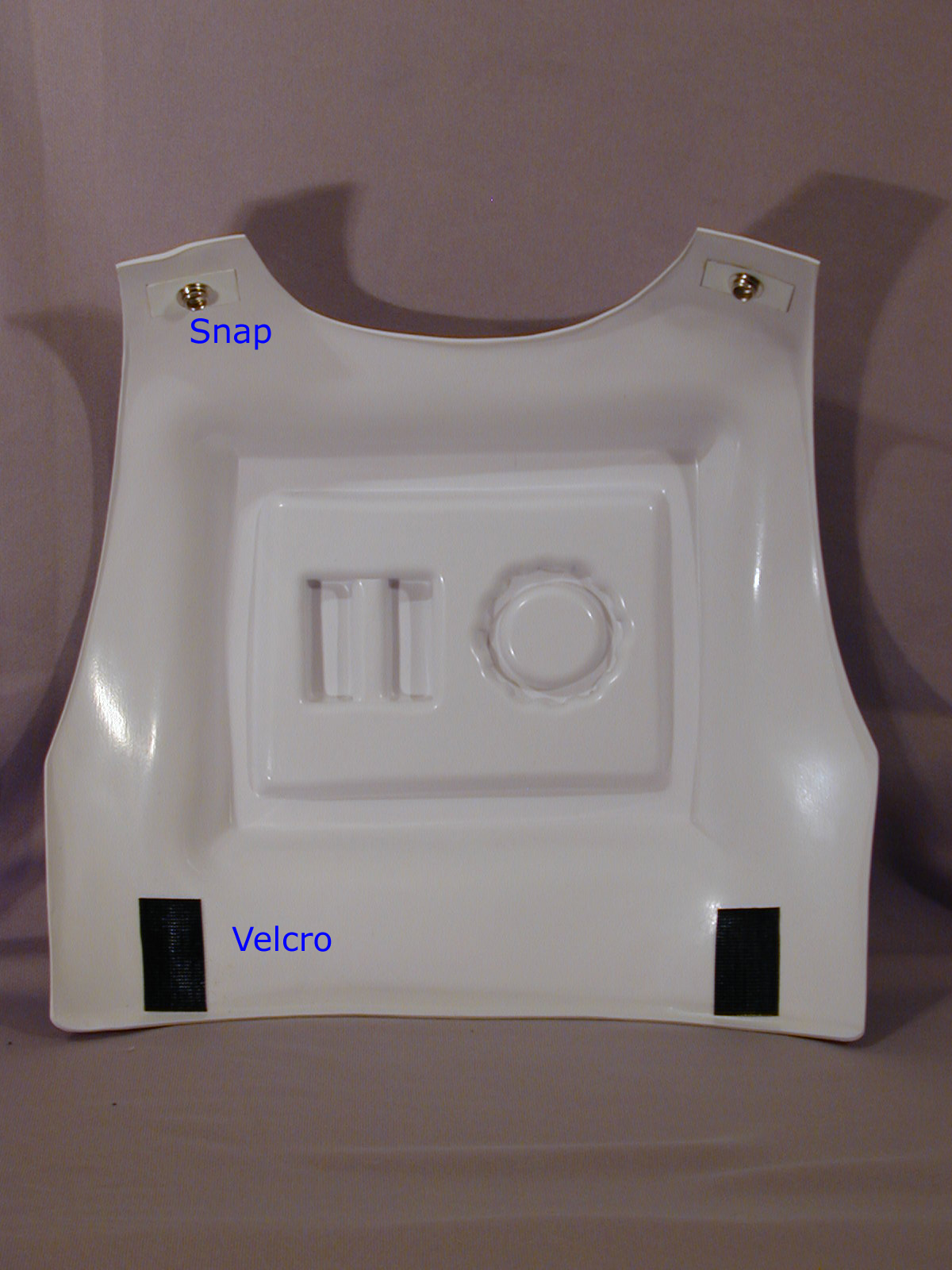

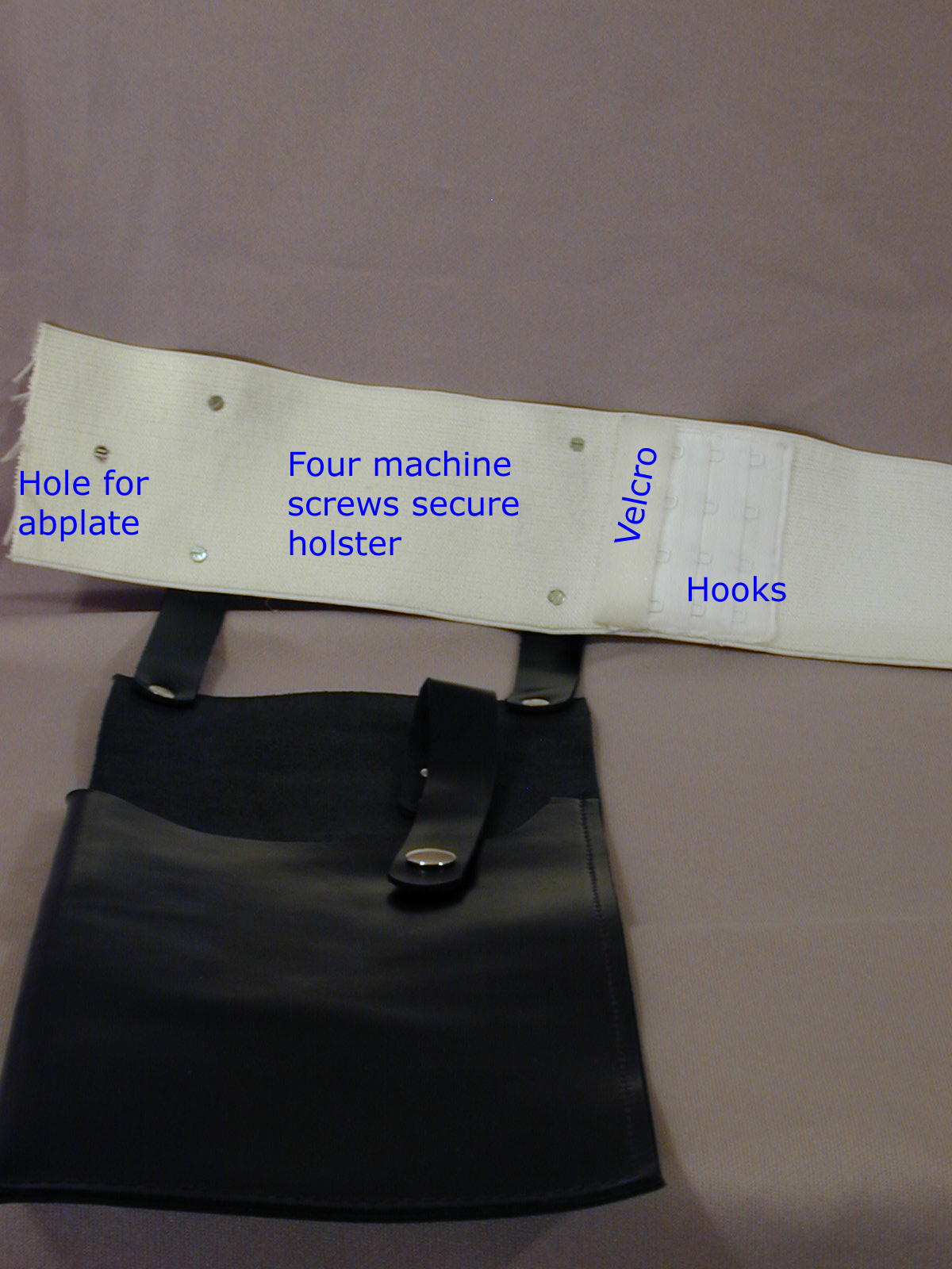

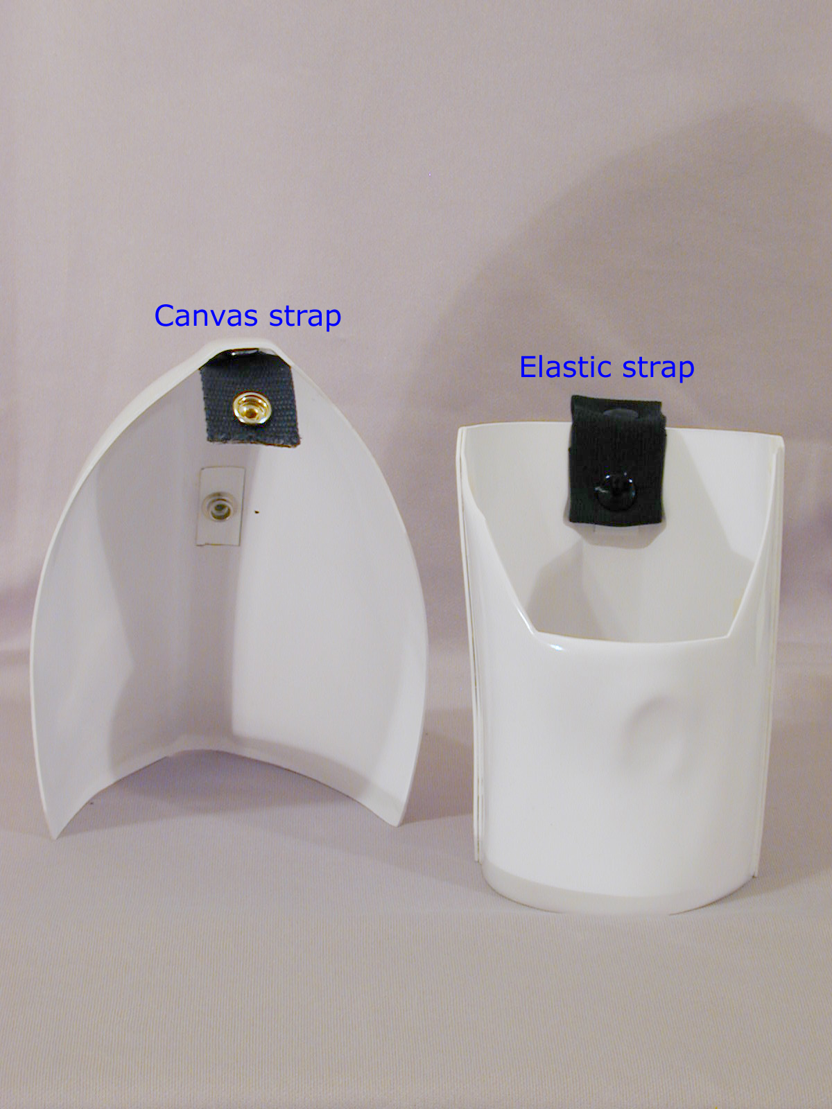

The holster should be held in place by rivets but I wanted something 'less permanent' just in case.

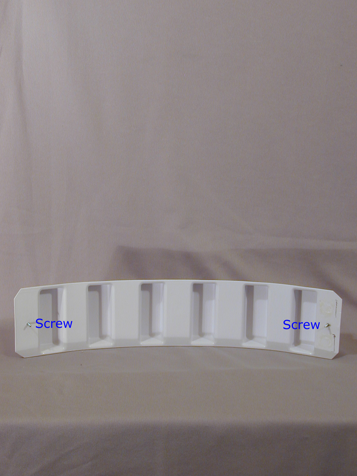

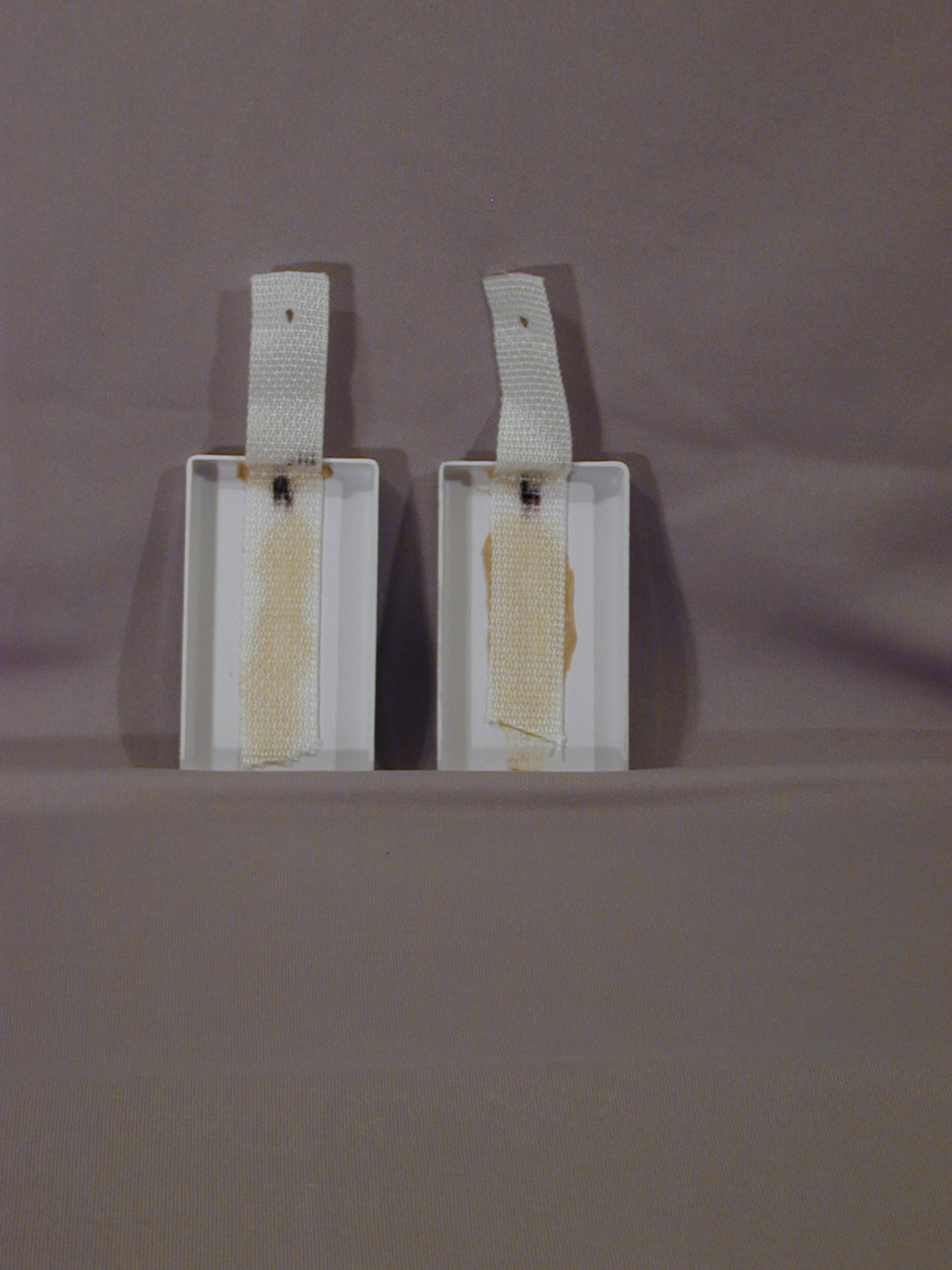

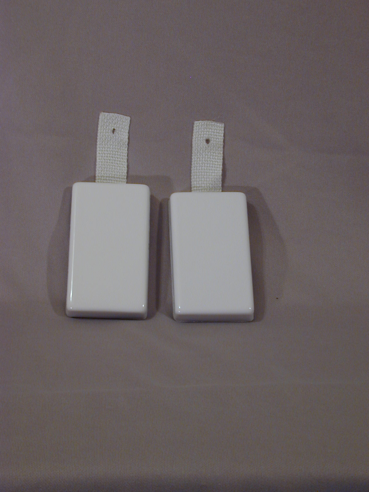

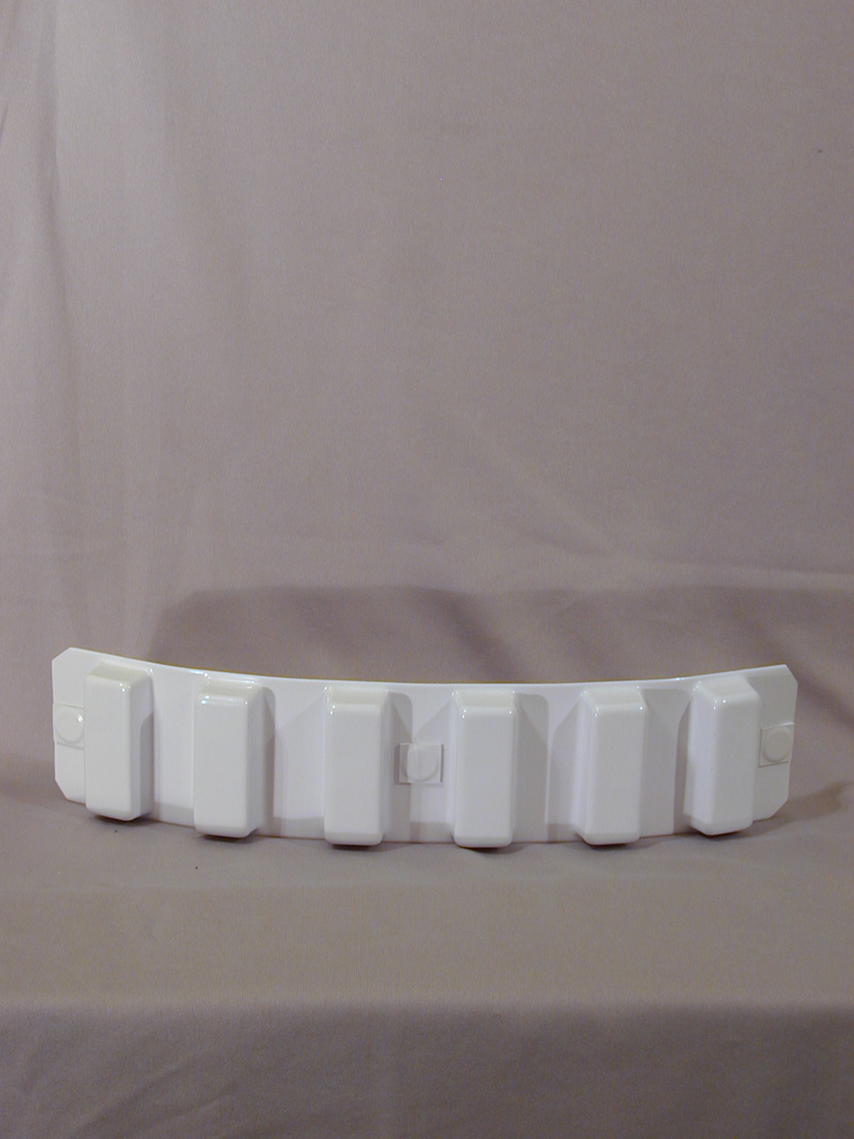

The drop boxes were a rush job with liquid nails. I've been toying with the idea of filling these with resin or something to permanently lock the strap in, but I'm not sure about the weight/sound.

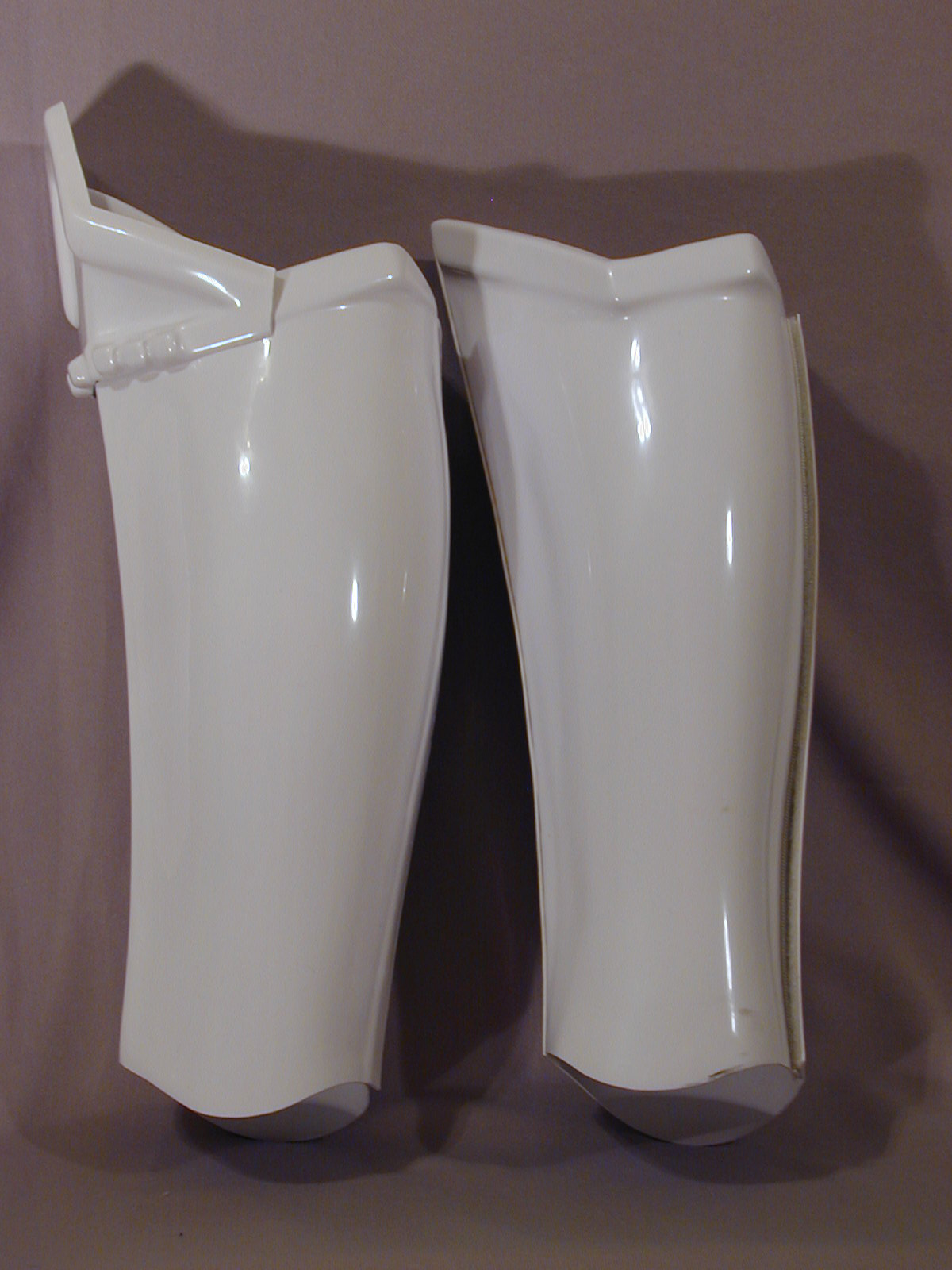

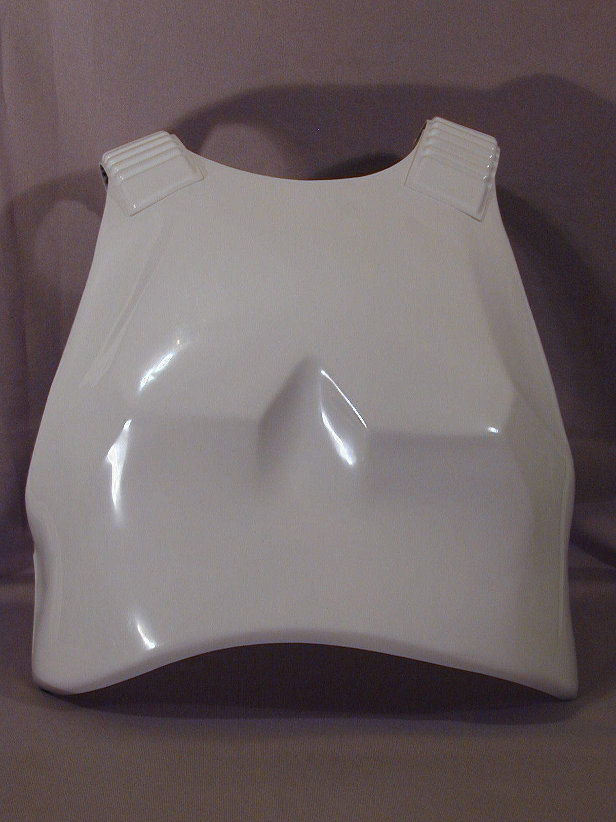

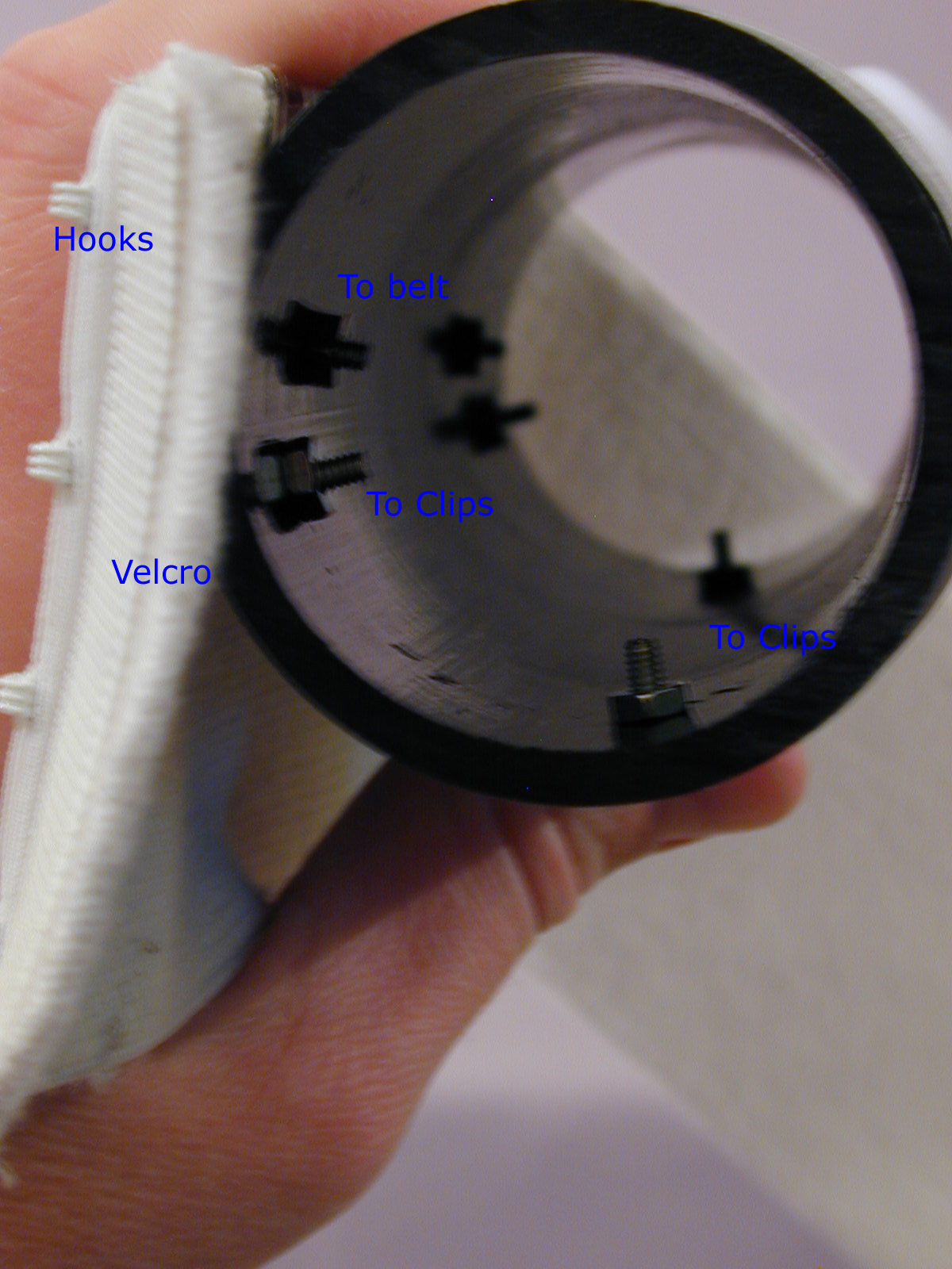

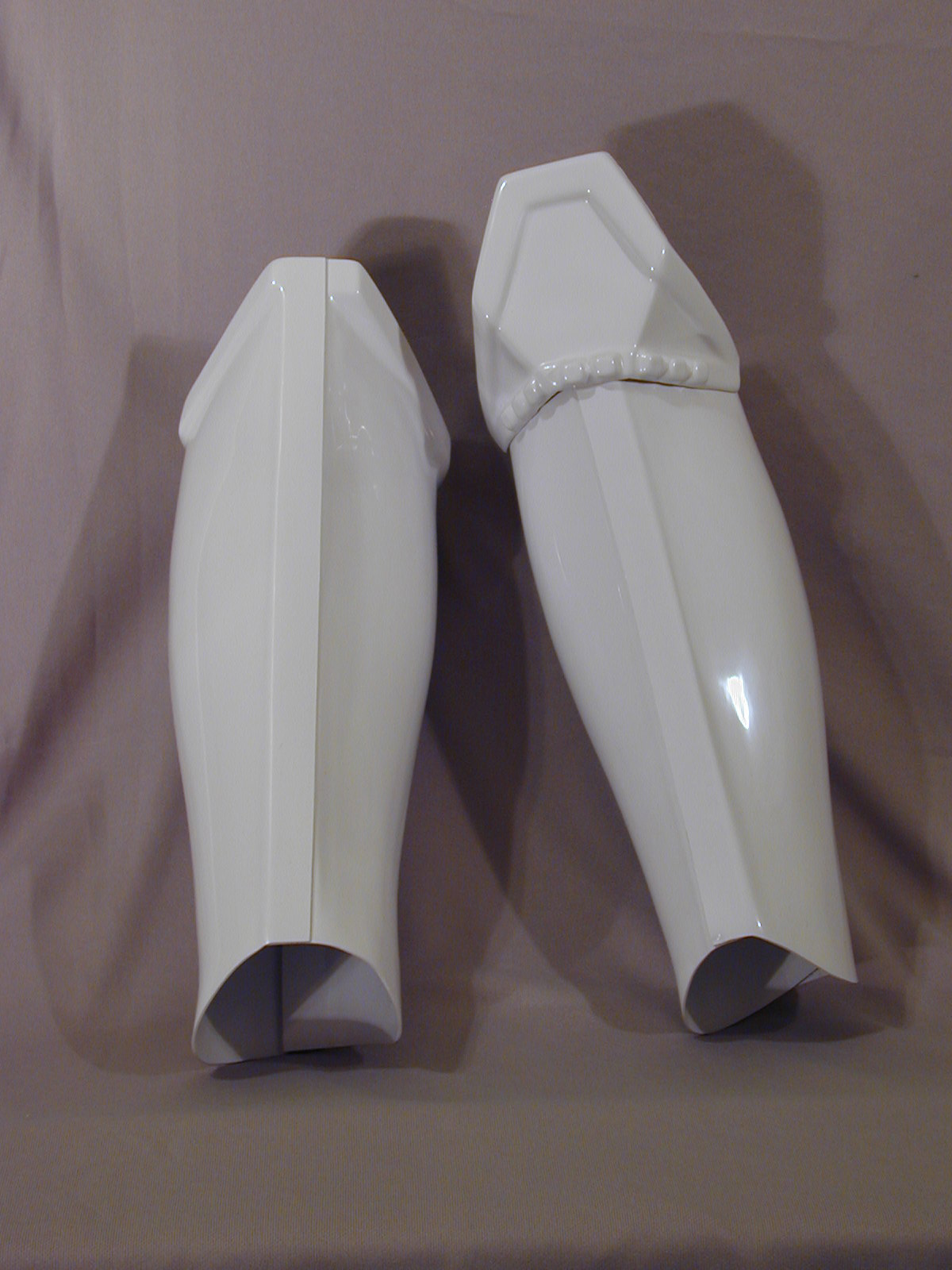

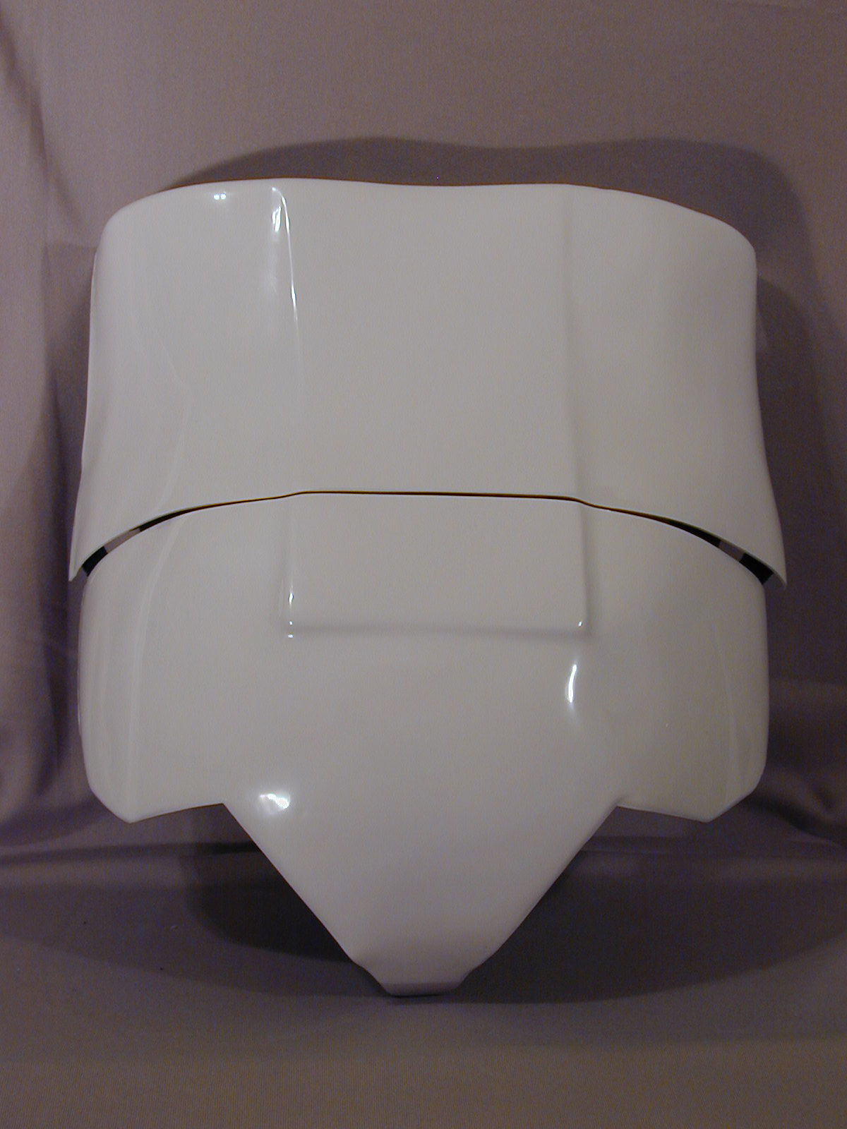

The sniper plate is held on by plastic welder in front. I had the sides glued down as well and had planned on putting rivets in, but with it attached at the sides, it made it difficult to put on. The glue even snapped when I popped it open to put it over my shin.

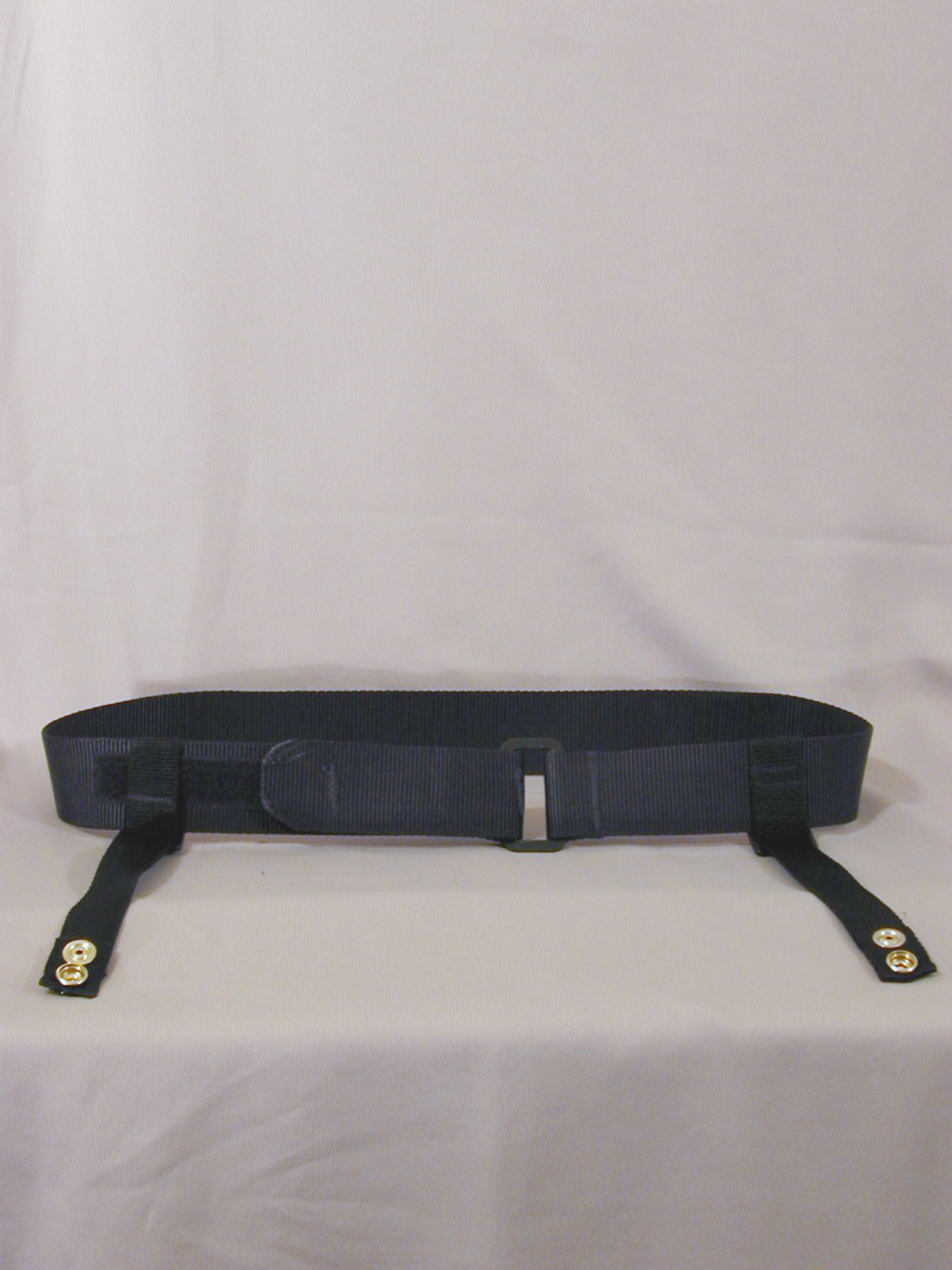

The belt is held on to the ab plate by machine screws. The square caps are hotglued on so that they can be removed if need be.

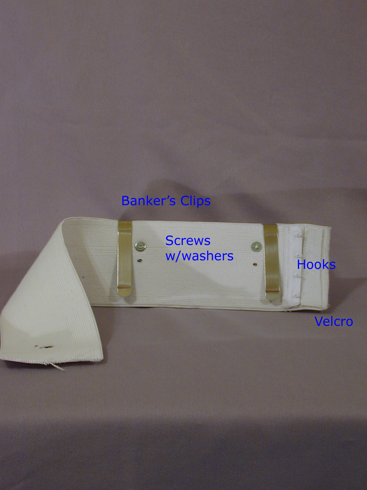

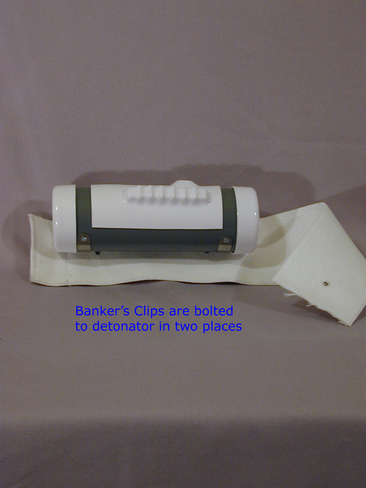

I tried gorilla-gluing the banker's clips to the thermal detonator and the glue would never hold. They are bolted on now and the machine screws really aren't that noticeable.

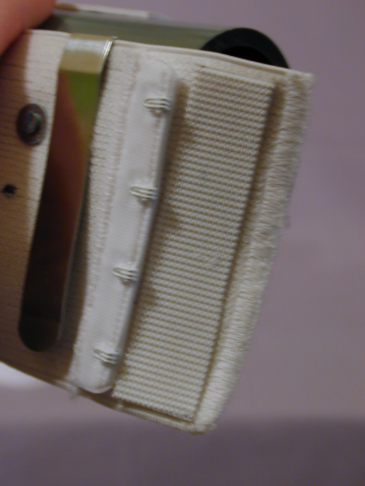

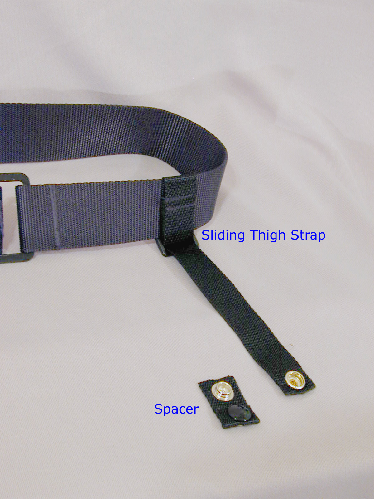

The thigh straps were a little too short, so instead of re-building the straps, I just made two 'spacers' to lengthen them.
The two sets of snaps on the kidney plate are due to a mistake. I originally had the kidney plate sitting higher than the ab plate which was wrong. It should sit lower. I just never bothered to remove the first set of snaps.

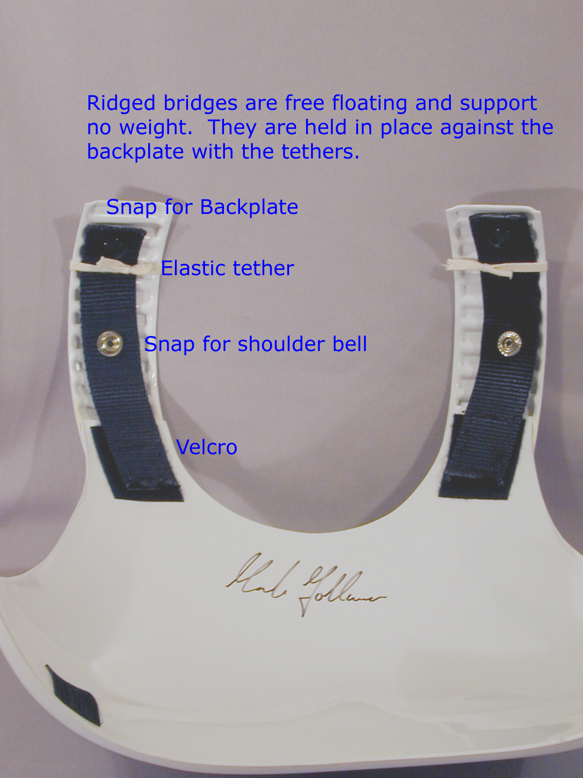

I had planned on replacing the velcro on the butt/kidney pieces with snaps, but it seems to be doing fine so far.

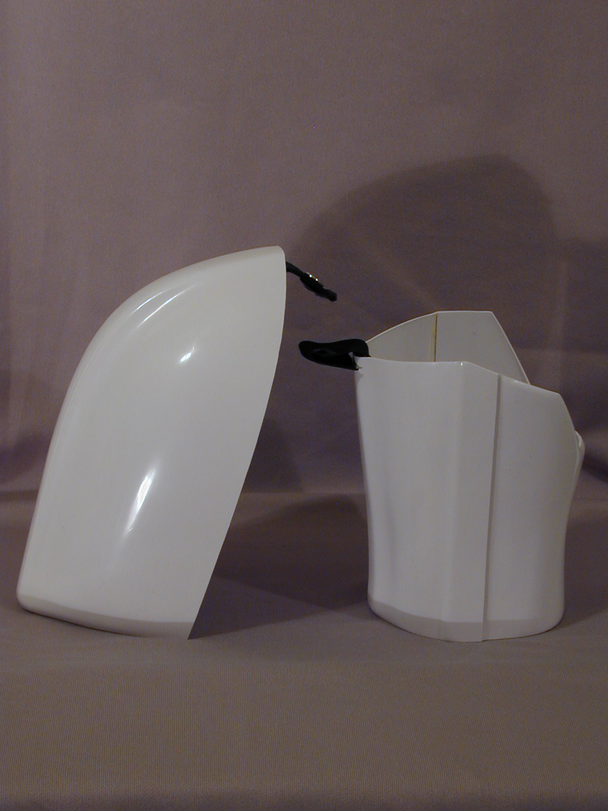

The only rivets I used were on the battery belt on the right knee.
