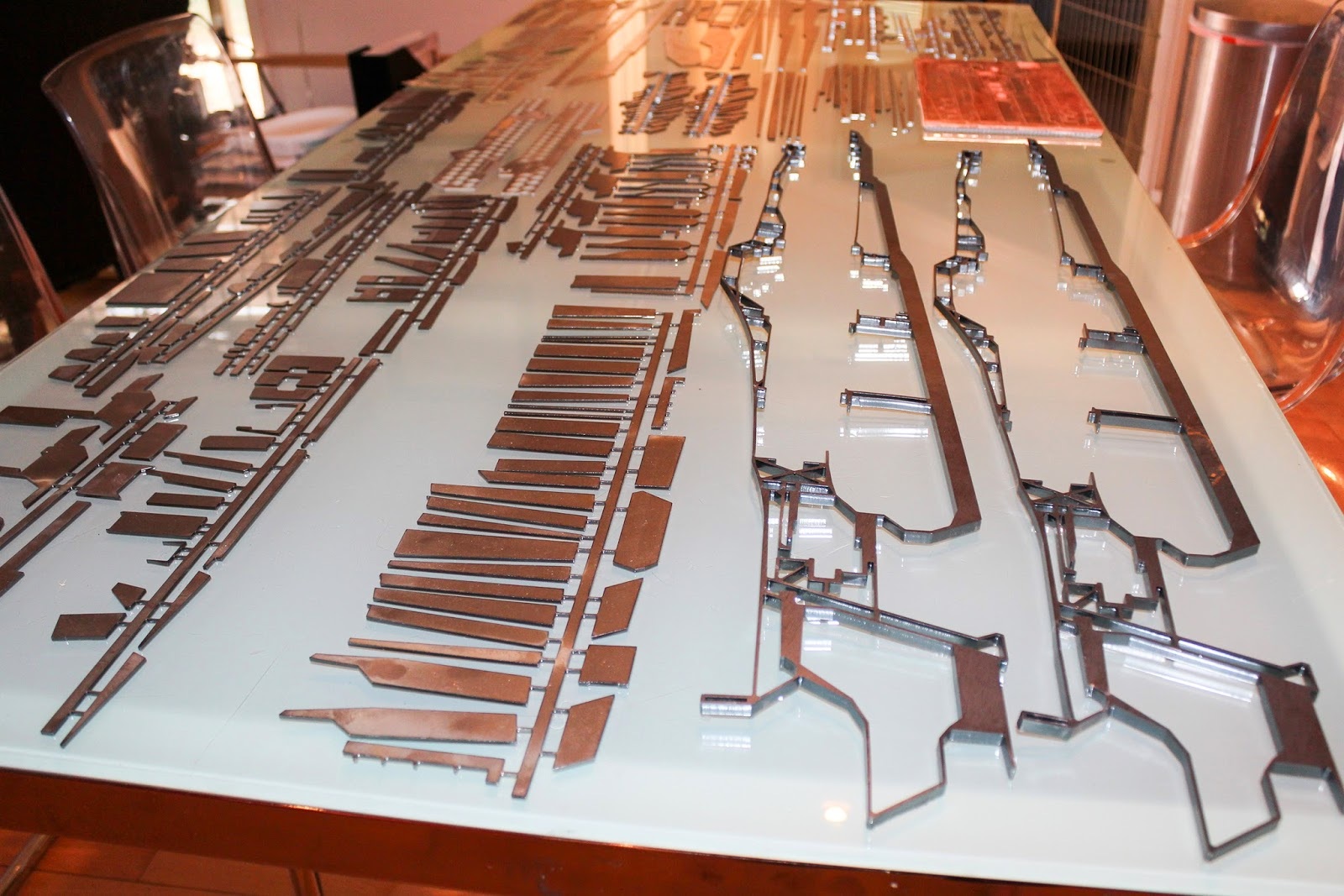

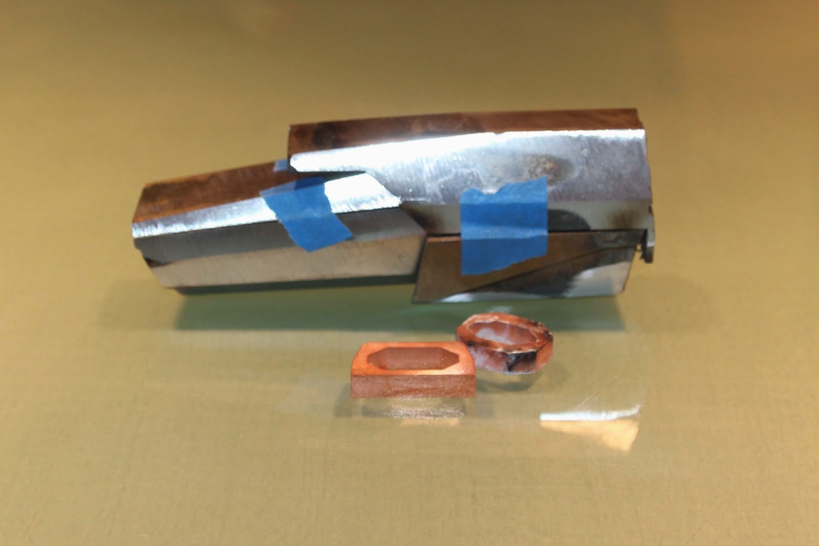

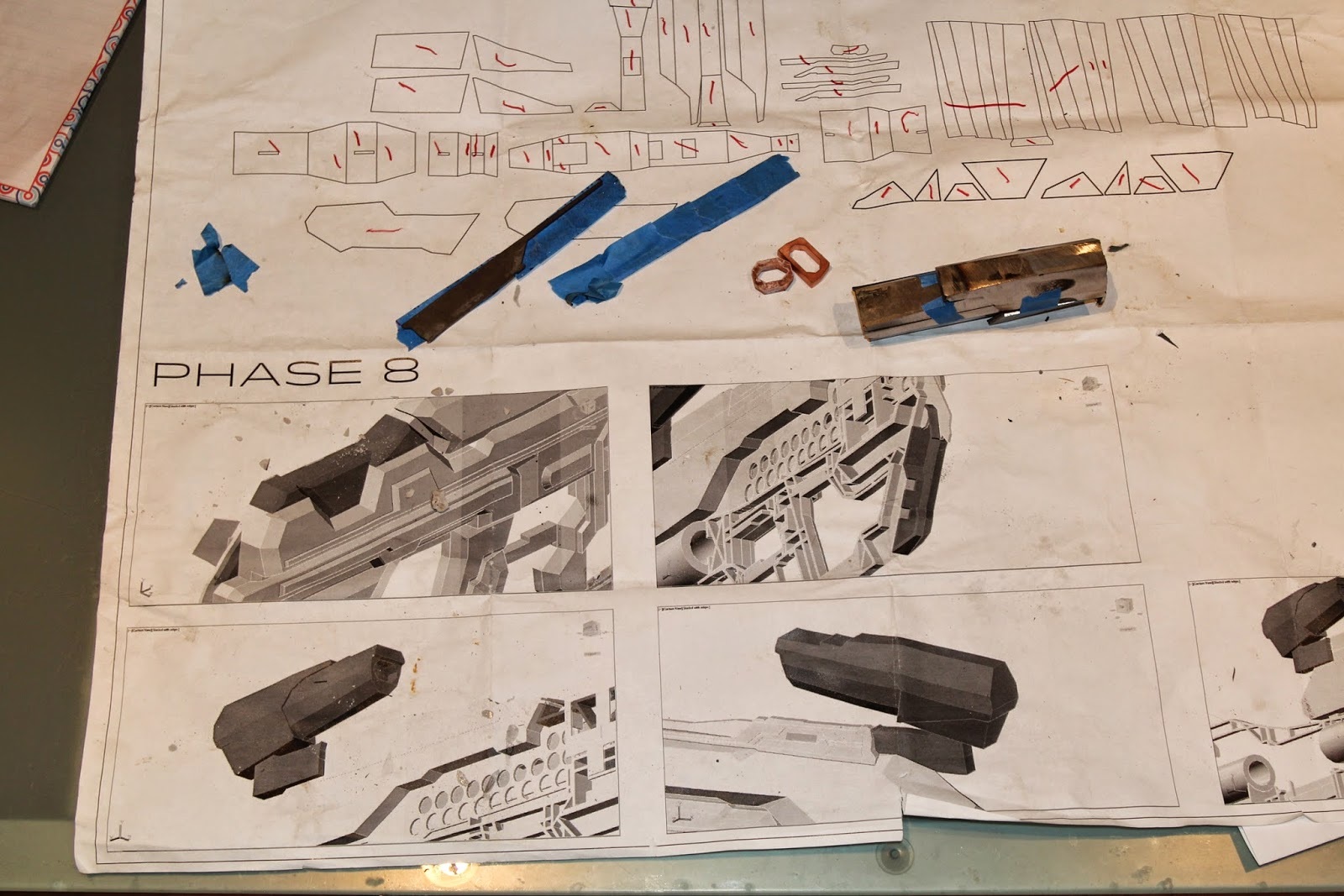

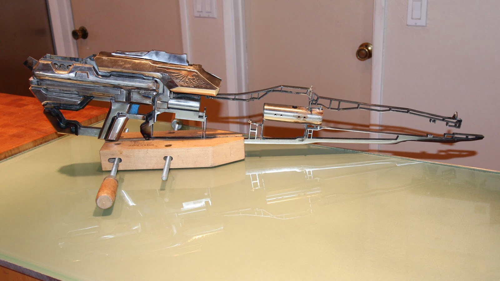

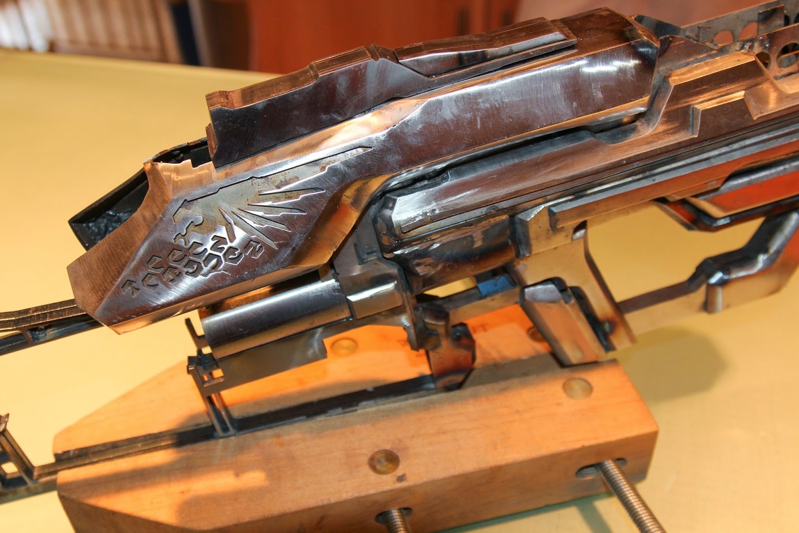

This is my light rifle project. It's been in the works for about a year. The whole thing is welded steel and some solid copper pieces.
I spent about 200 hours on the computer figuring out the parts in cad. Then I had them all laser and/or water jet cut at a local shop. There are more than 500 pieces. It's mostly 14 gauge cold rolled but there is also some 1/8" and some 1/4" steel as well as 1/4" copper. It's going to be heavy for sure...probably around 20 or 30 lbs. maybe that's ridiculous but I really wanted to get the real material look and feel for this one.
anyway, I live in the phoenix az area so welding and grinding for hours a day is brutal, but I'm trying hard to get it ready for comiccon. Wish me luck.
