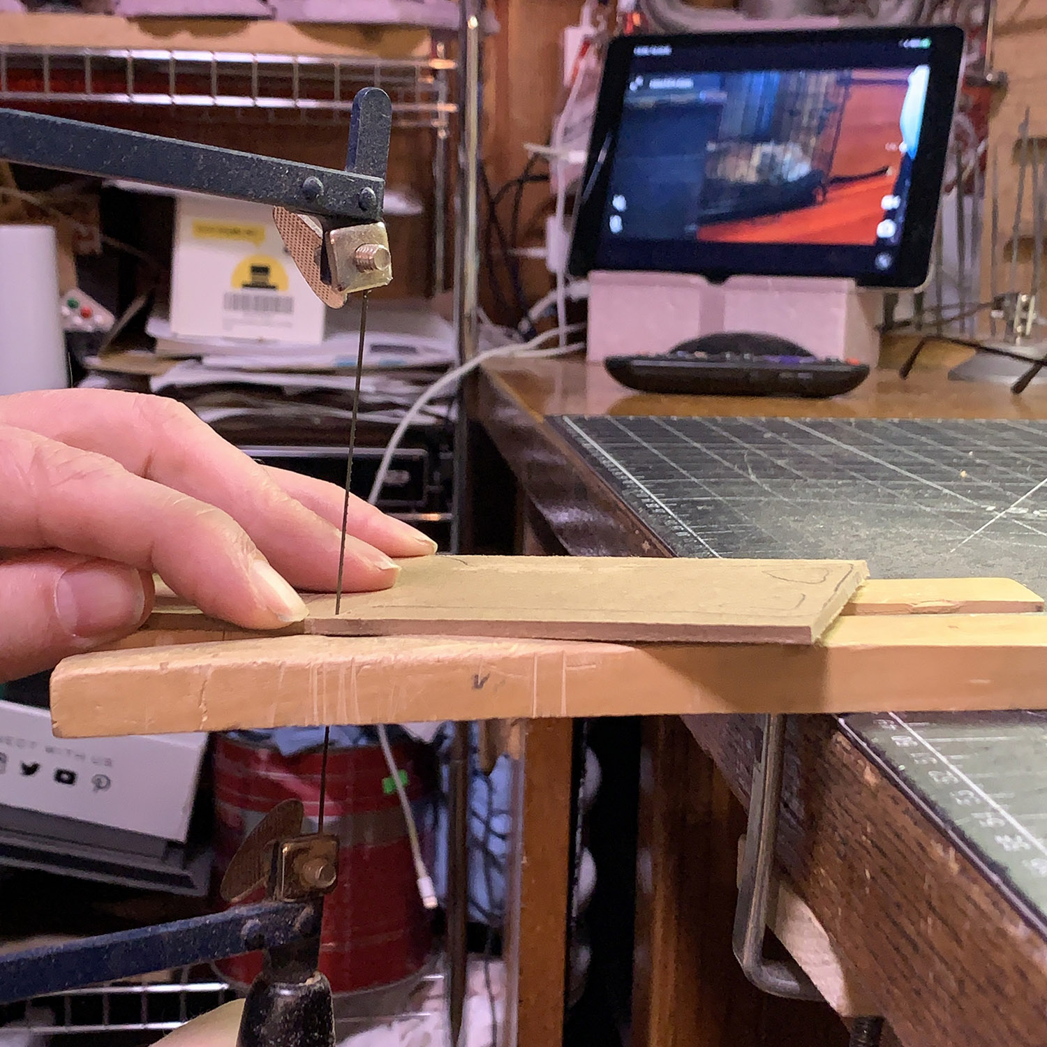

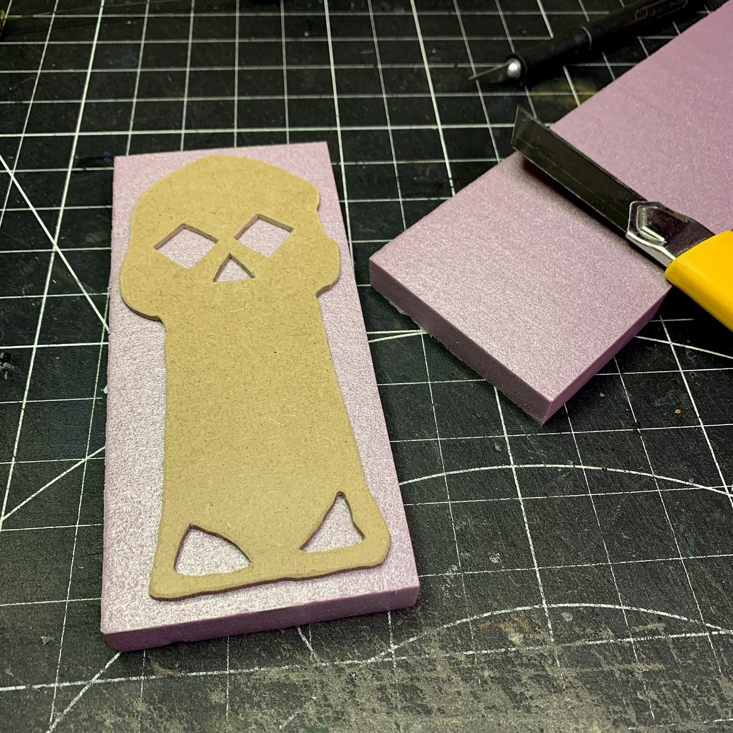

Step 1
Printing out the reference photo to scale and tracing it to MDF that will be used as the backside of the prop.
Step 4
Removing the eyes, nose etc. from the foam, cutting the foam portion into three slices - this will allow me to make a relief area from the top piece and a cut away area below to add some weight to the prop (sort of a foam sandwich).

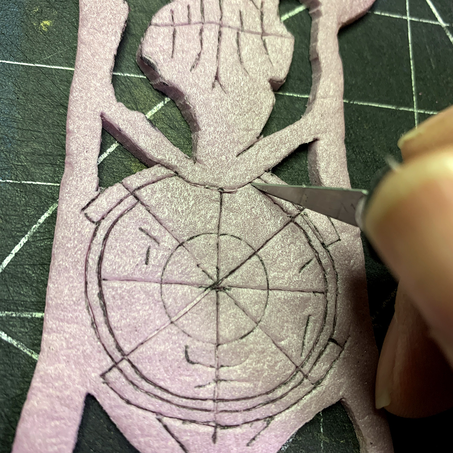

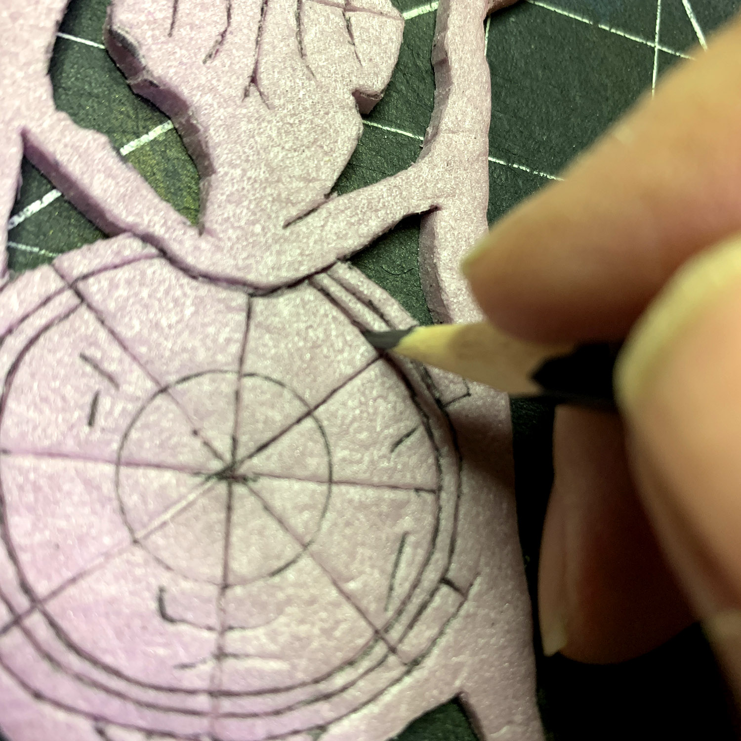

Step 7
Making the markings with: Pen, exacto blade and deepened with a pencil. Filing all the inner edges.

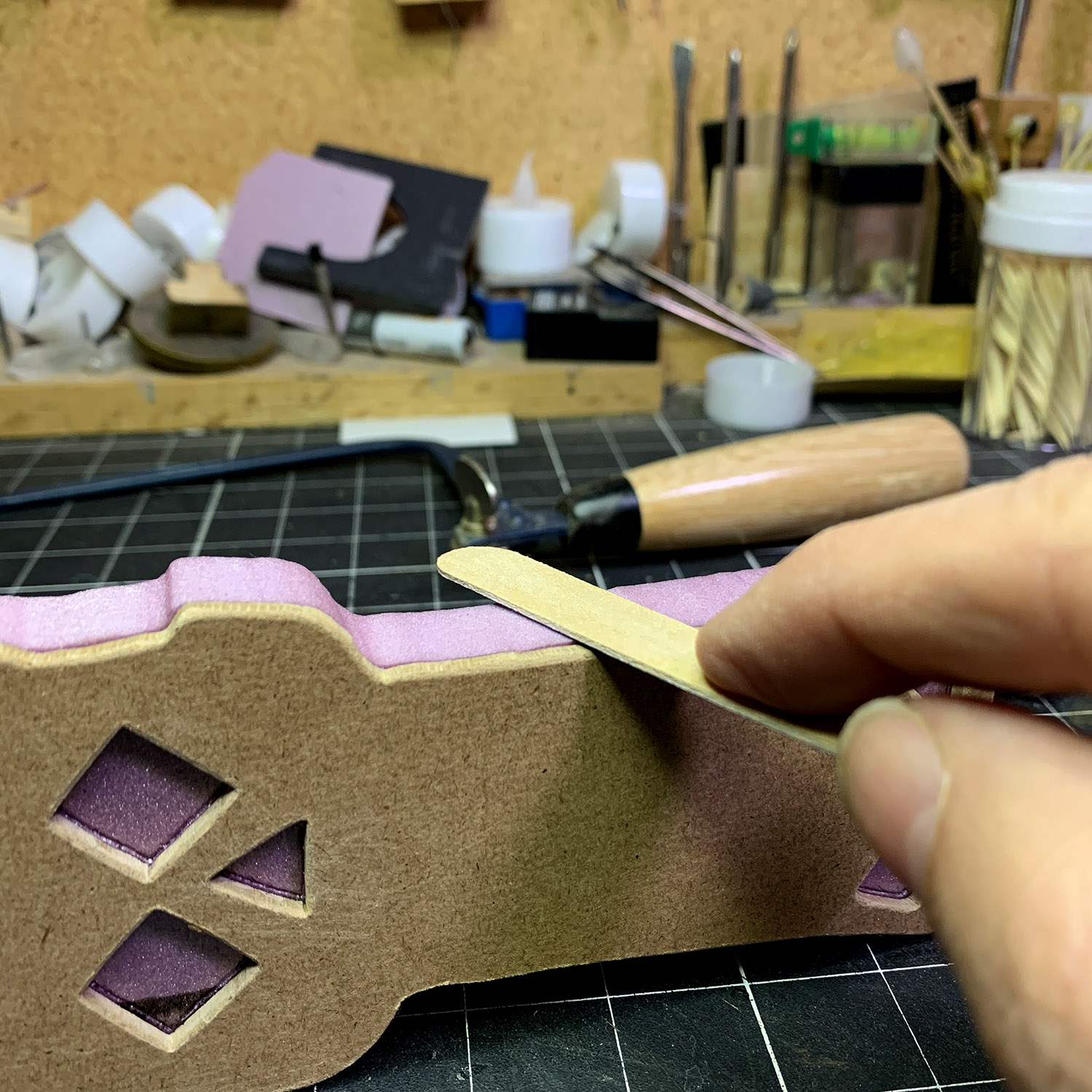

Step 8
Adhering the 3 slices with "foam safe" CA Glue and sanding of the outside edge - it is looking pretty good!

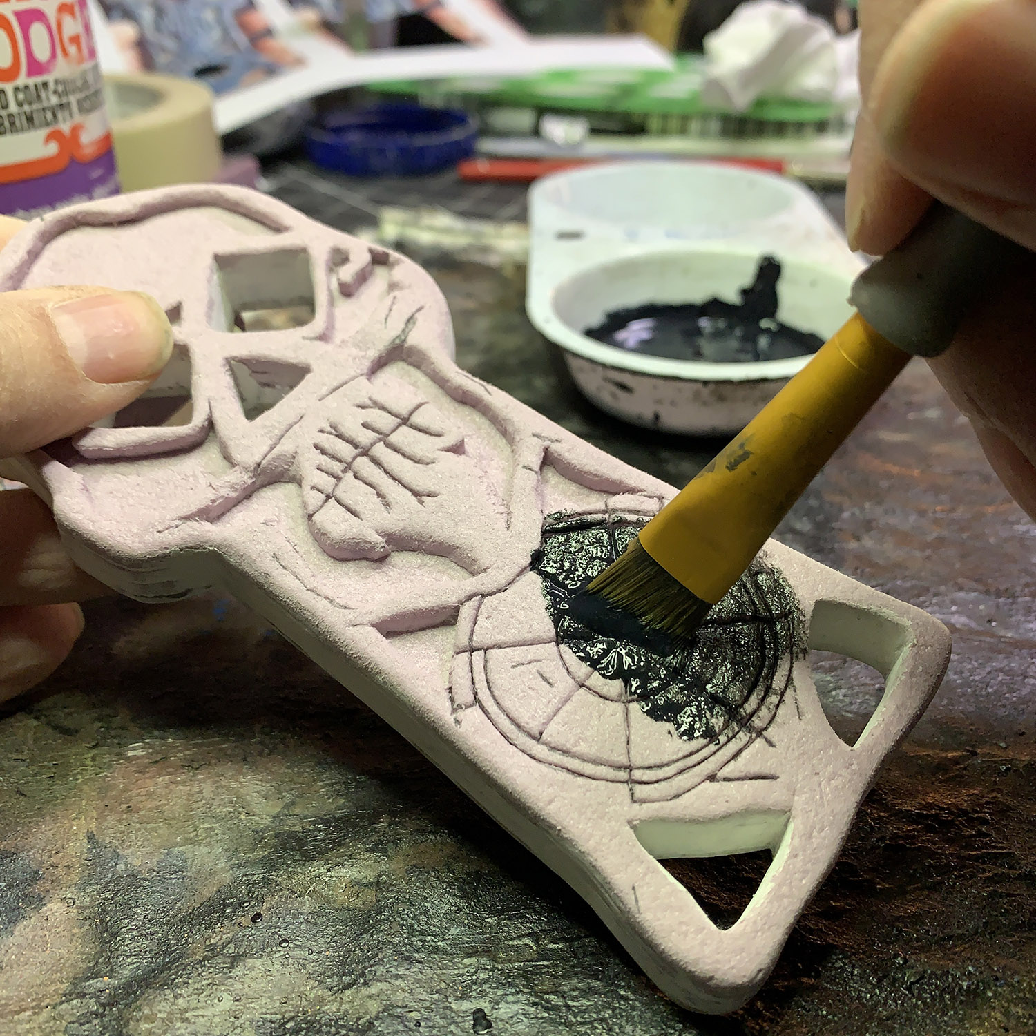

Step 10
The prop was sanded and base painting with Mod Podge hard coat tinted black.

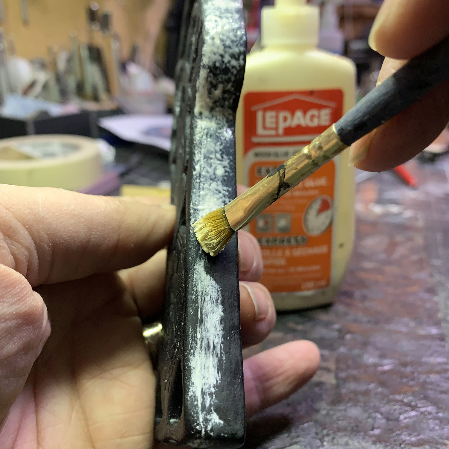

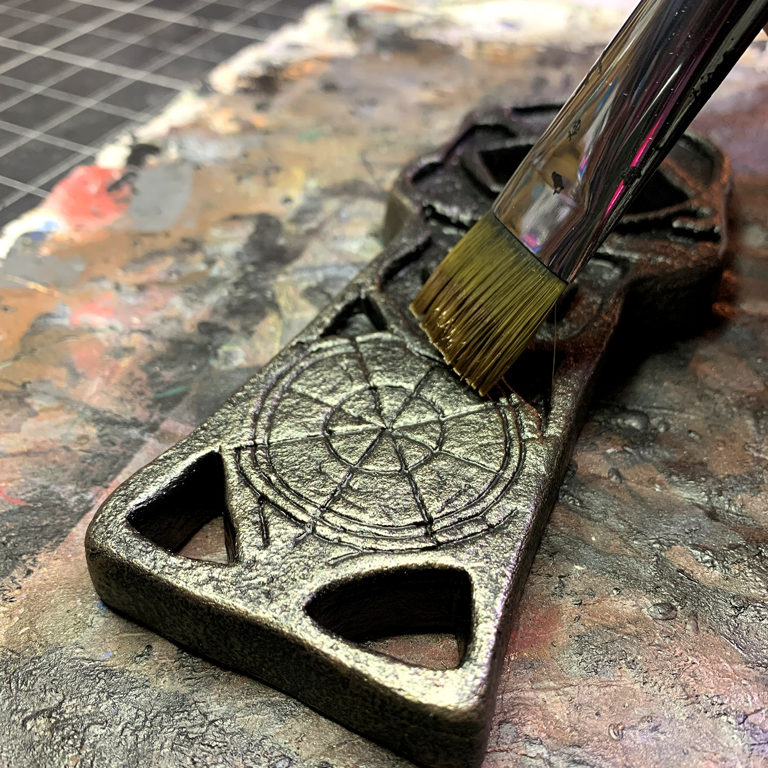

Step 11
"Dabbing" PVA glue on sides and back to give a metal-like texture to those areas - then re-painting black.

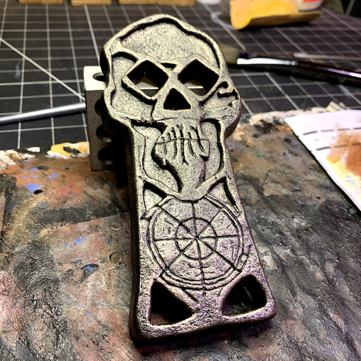

Step 12
Dry-brushing a metallic Bronze followed by a metallic Gold - she is really coming to life!

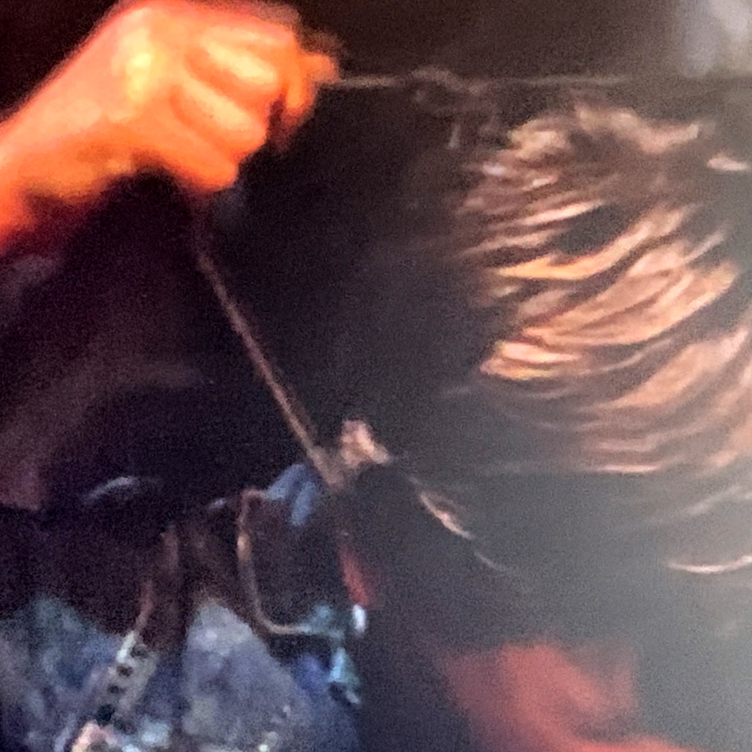

Step 14
A couple of quick screen grabs from the movie to make sure to loop the leather lashing through the bottom correctly and try to get a similar knot.
For a light weight wearable CON going Goonies prop, it's cool. Can you imagine trying to wear a solid copper one for the whole convention? Yeah, foam all the way is going to save your neck.
Ha ha - yeah a full metal one would be crazy. I am glad I added the washers and nuts though - it does give it some weight so it doesn't feel it is made out of foam.
