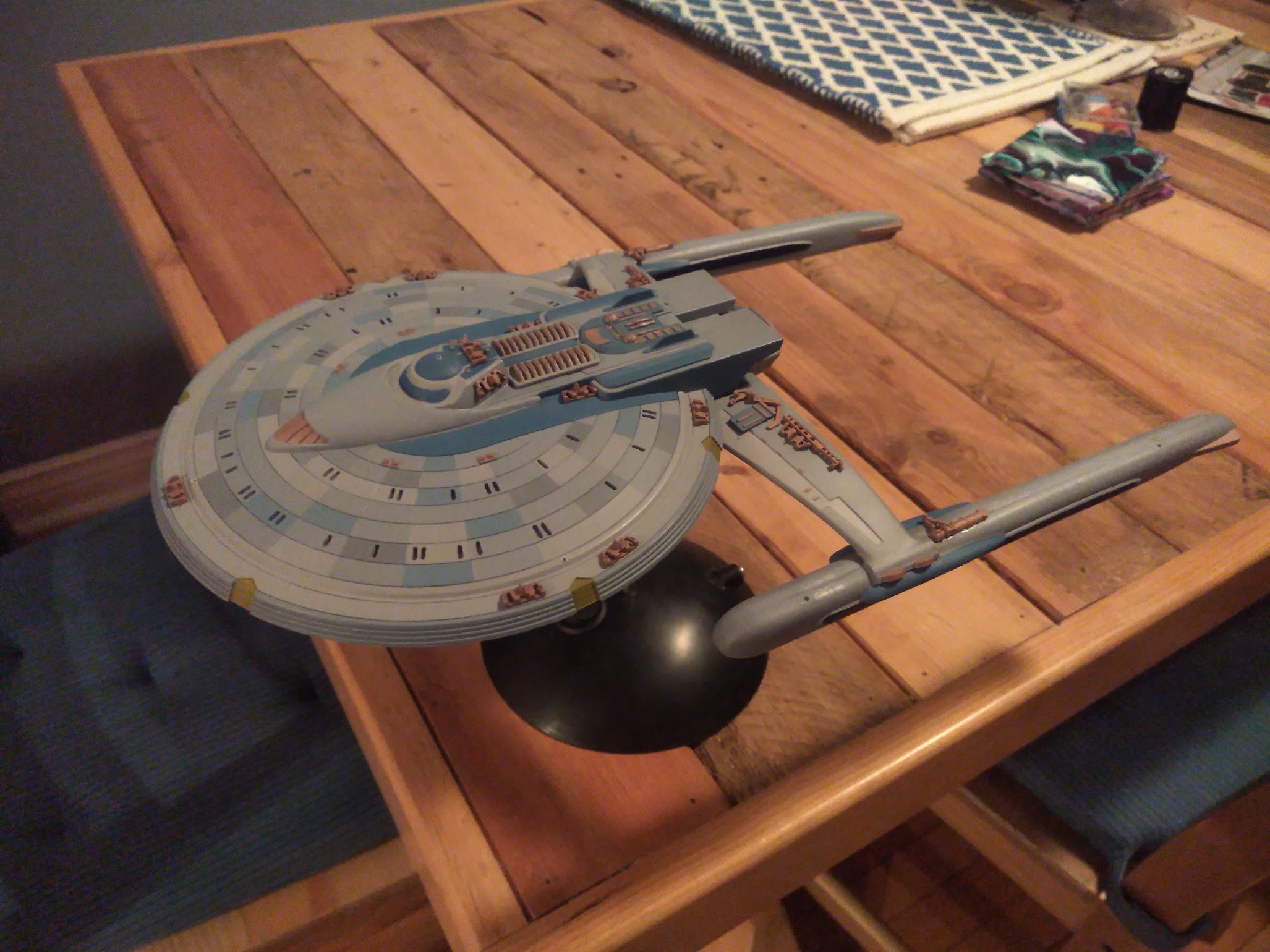

That's looking pretty good! Nice job on making the lights work. Yup, I spotted the missing parts. ;) (y)(y)
Just a follow on, did you over coat your paint with a clear matt or did you use all matt colors. I like how it came out.
I'll do you one better, here's my paint notes:
base coat tamiya gray primer, left as-is for the lighter grey colour (ie: ring of ventral saucer, outer ring dorsal saucer, various saucer panels, etc)
main colour, "centaur grey", 1:1 XF53 neutral grey:X2 white. You can use XF2 instead, but the gloss white gives it a subtle sheen which I like. I did play with this a bit, often I did 2:1:1 (XF53:XF2:X2), so 2 drops neutral grey, 1 drop flat white, 1 drop gloss white. Really allowed for a quasi-aztec pattern in the light without an actual aztec pattern, since the grey panels would shine a bit different than the light blue or darker grey
dark centaur grey (used on various saucer panels), 2:1 XF53 neutral grey:XF2 white (I did add some drops of X2, again just for a slightly different sheen)
light blue centaur grey (used on various saucer panels), 15:1 centaur grey:XF8 flat blue. I lightened up the centaur grey for this, more like a 3:2 instead of 1:1
saucer edge, literally 10 drops X2, 10 drops XF2, 15 drops XF53, and twice I dipped the very tip of a toothpick into XF8 and used it to stir the mix. Just wanted to give it a subtle hint of blue, didn't want it to stand out at all
dark blue, 4:1 centaur grey (flat):XF8 flat blue (tried 1:1 XF53:XF8, and 1:1 centaur grey:XF8, and 2:1 centaur grey:XF8, but blue was just too dark)
copper, maybe 5:2 copper:centaur grey (5 drops copper, 1 drop white, 1 drop grey)
yellow, 10:1 yellow:black (I think... didn't love the colour. I'd recommend mixing yellow and orange, but I didn't have the orange colour)
shuttle bay colours, I think it was 2:1 flat white:neutral grey. Should go lighter though... ideally it's closer to the primer colour, but the rattle can is much harder to spray than airbrush
I do plan to apply the decals in the future so I'm a bit worried I'll lose the variation in gloss that I achieved through mixing various ratios of X2 and XF2... but we'll see. My plan is a coat of pledge, apply decals, then a coat of matte. Might do a test run first
