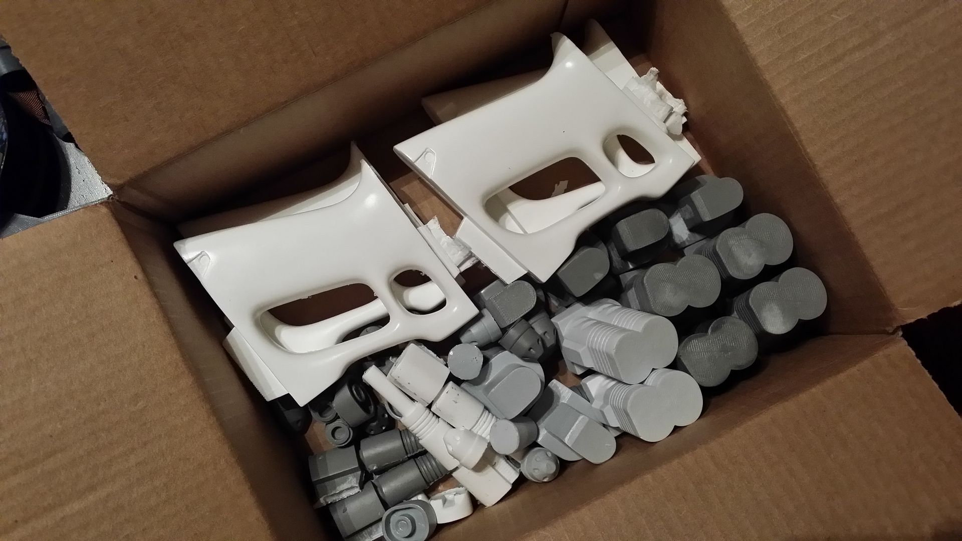

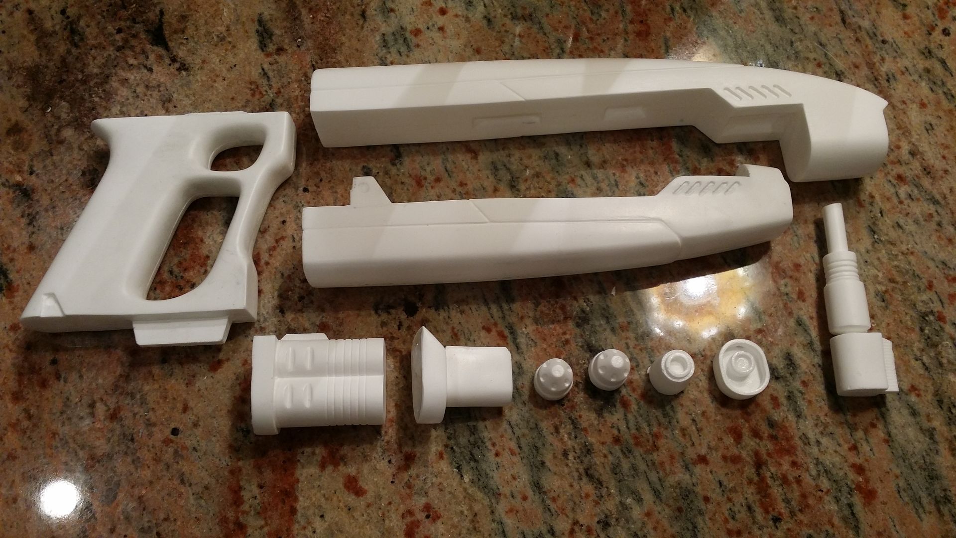

Raw cast kit:
There will be some minor seam clean-up, and a couple of the recesses need some dremeling. Pretty light duty work to get everything fitting properly. All flat surfaces that get mated will need to be sanded flat (bottom/back of greebles). Optional: drill out the holes in the bottom of the grip and the lower body that connects to the grip so bolts can be inserted
It will make things easier to sand and dry fit everything, then paint each component separately, then glue everything together

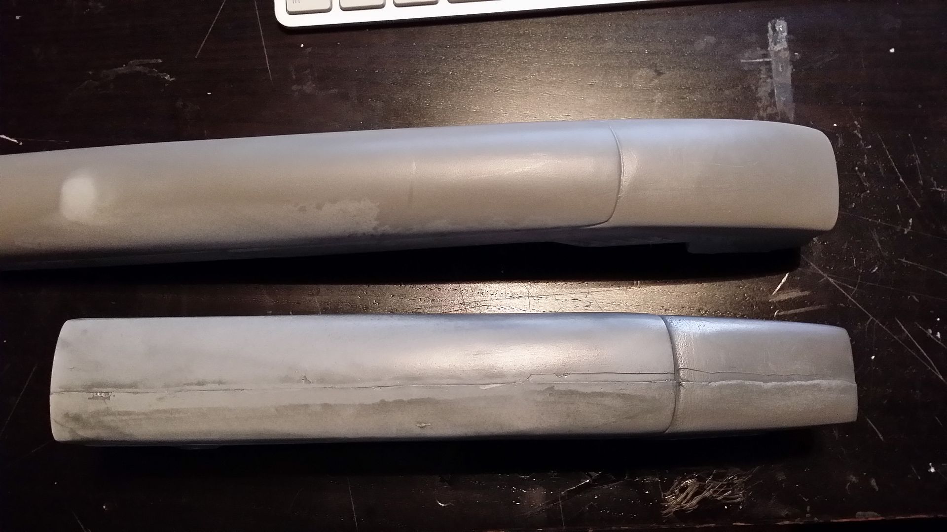

The goal with the new molds for the cold-cast kits is to have no seam clean-up making for a smooth, polish metal surface. I'll post up the results Monday or Tuesday
Pulled the master from the new mold this morning and that was a challenge! The first couple of test casts produced a flawless top surface with some bubbles on the under side. Going to experiment a little more before I start pulling the cold cast pieces. Those should be ready to go this weekend though :)

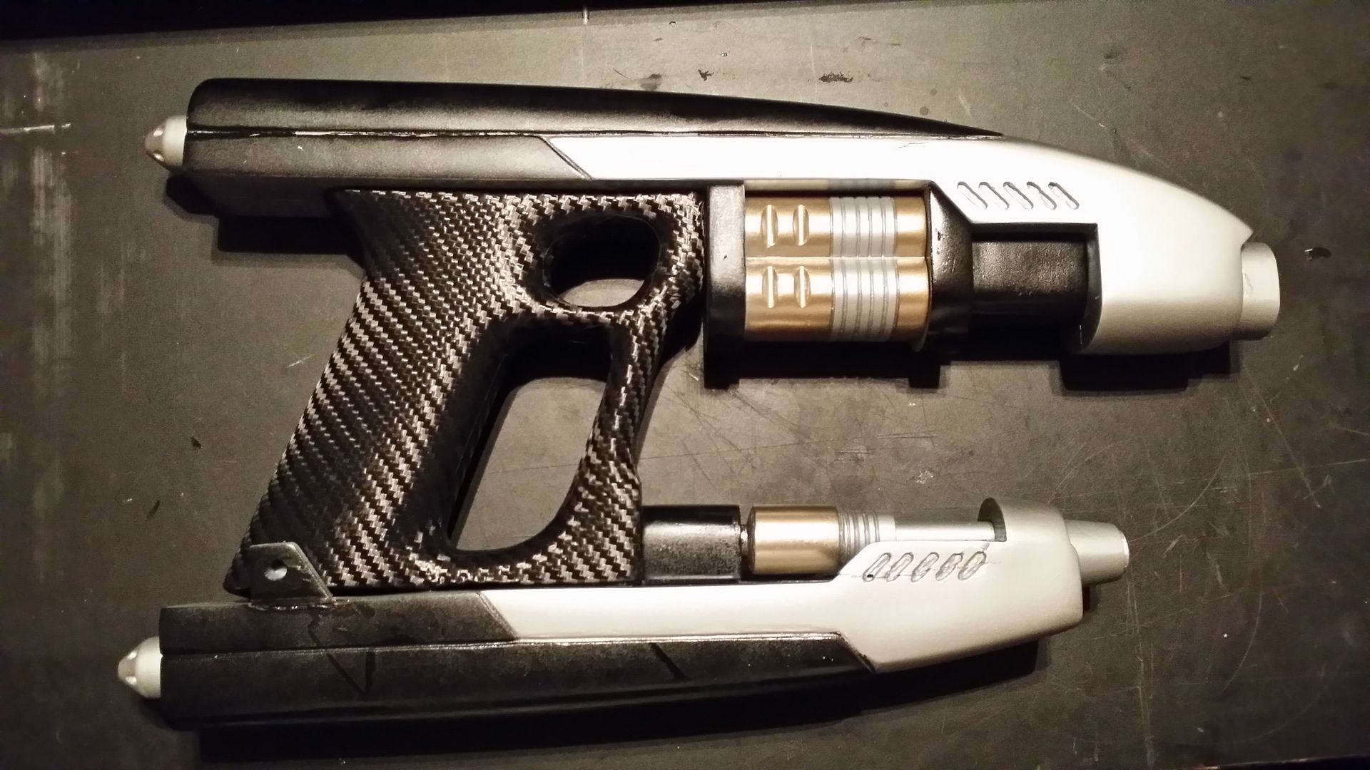

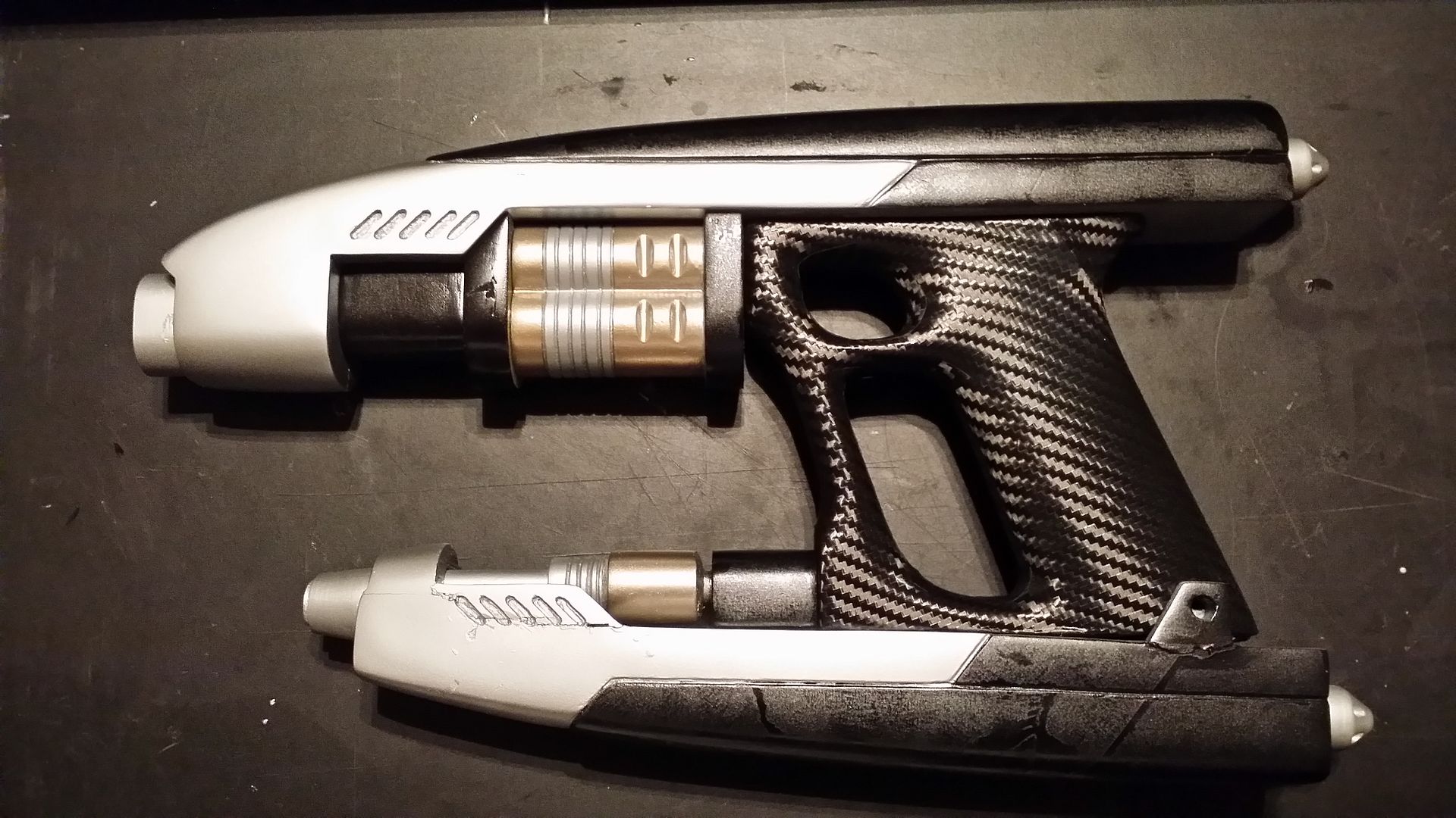

Thought I would throw some paint on the master to show what a finished piece will look like. I still need to do the weathering and the blueing of the barrel, but you get the idea.
I'll probably go with a more toned down silver as well, but we'll see what it looks like after the weathering/black wash
http://i60.photobucket.com/albums/h33/wkevingossett/20140804_004643_zpsygd5m8dq.jpg
http://i60.photobucket.com/albums/h33/wkevingossett/20140804_004620_zpstgvfk4iz.jpg
Looks awesome, can't wait to see it finished.
These are looking freakin' awesome. Will totally have to spring for some when you're taking more orders...!
