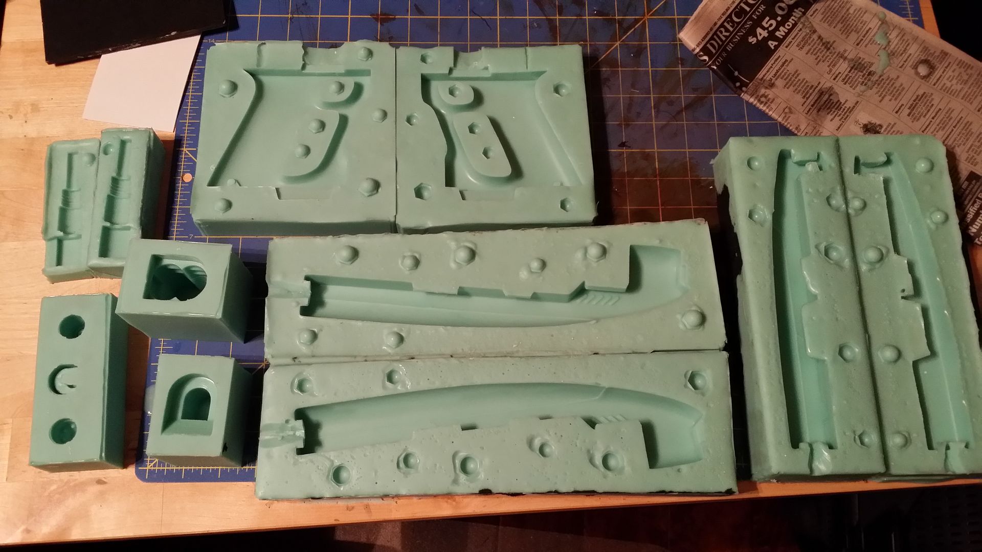

Quick update, I've got the first half of all the two part molds done. Tonight I should be able to pour the second halves

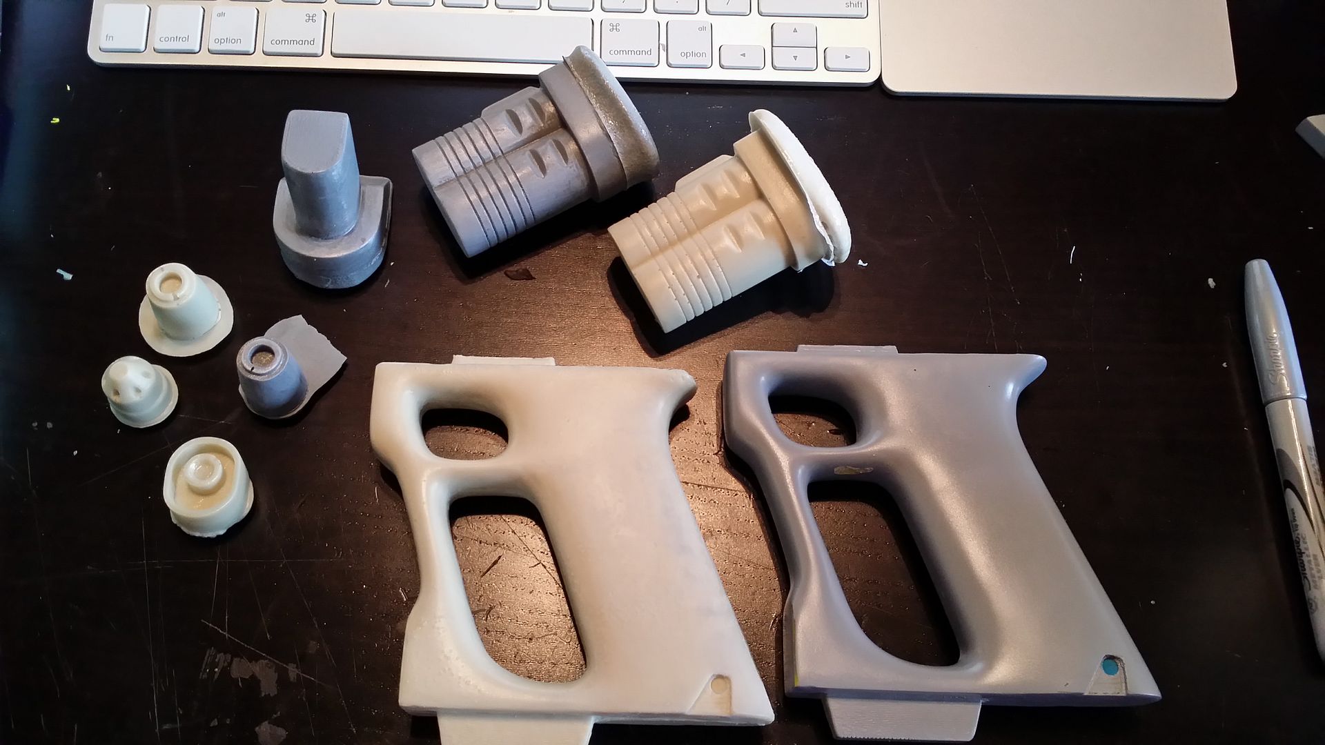

Some of the first test casts! I'm just using an older, cheaper resin for these, so there are some bubbles that I don't anticipate being there once I actually start casting.
The main top and bottom molds are still curing, and I need to pick up a little more silicone to thicken them up a little too. I will say, casting those pieces will not be easy!

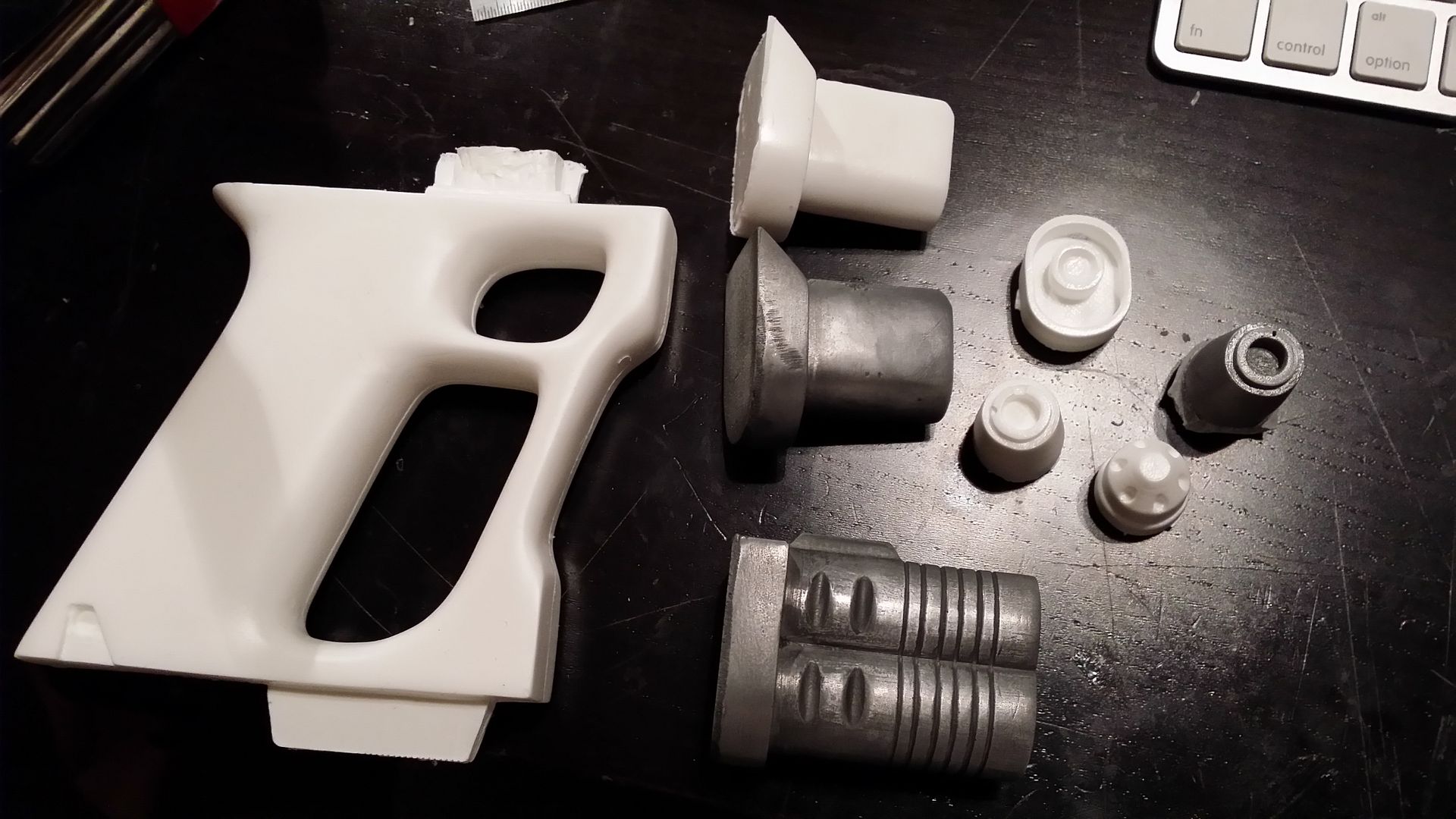

Molds are all done and I was able to do some test casting today. The grip came out perfect with minimal flashing! I still need to tweak my technique on the bigger pieces, but I am very happy with how the molds turned out :)

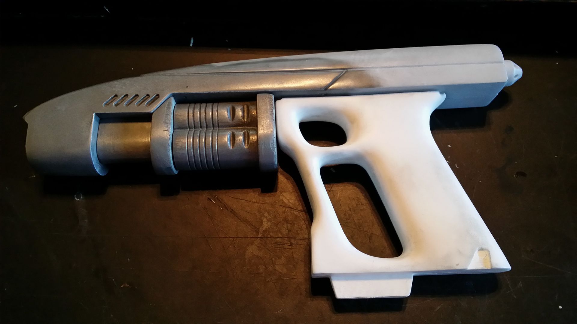

First cast of the top main section... Cold cast looks great! The mold shifted ever so slightly around the seam, so I need to tweak the pressure my bands have on the mold during casting. Other than that I am pretty happy right now!
I'm going to do a cast of the bottom piece tonight so I can get one assembled and figure out shipping costs. I'll start taking payments soon :)
