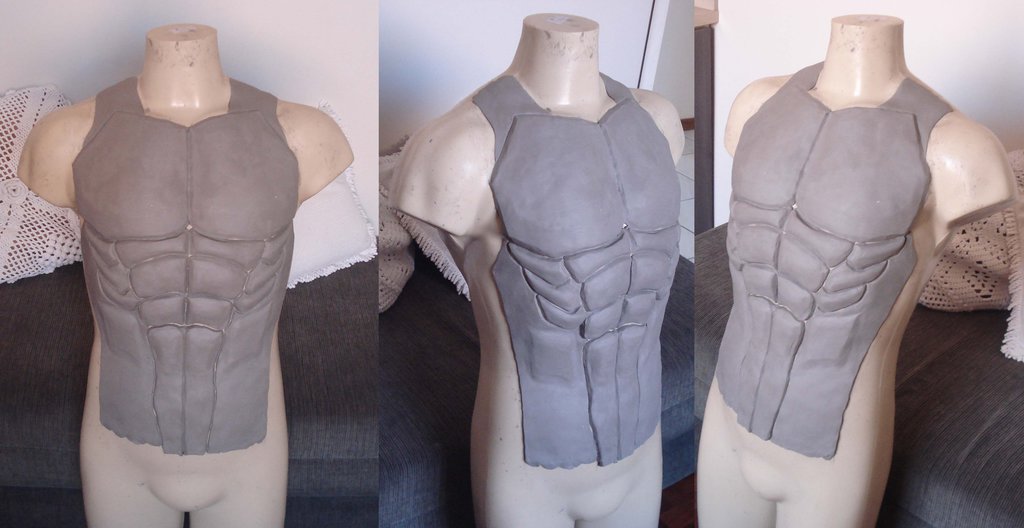

Great work on this sculpting, Masked Rider! Sorry for deviate from the thread, but please, let me ask: is this oil-based clay over a lifecast mannequin? I was working on a "generic multi-purpose super-hero chest", intending to use it as a base for a Batfleck and other costumes. I used oil based clay (medium hardness) over a plastic mannequin, since I was short of material for a full body lifecasting. One more question, if you allow me: how do you will replicate your sculpting?
Mine is here:

Thanks bro and great work on your sculpting .
I used WED clay and its a water based clay and more easy for sculpting big project and sculpture . Its more easy and faster to work , but u will need to take care the sculpture everytime after done , u will need to spray it with water and wrap it up to prevent it from drying and break . As u can see it took me few months to working on this ...lol.... i only have 2 - 3 hours a day to work on this , sometimes 0 hour on sculpting a day ...lol..
My sculpture was based on a slim version 6 foot tall male mannequin , not a life cast . So i will have to used lots of clay on it to make the body structure bigger in shape . Im using some body builder pics , Henry Cavil's body pics , and the mannequin that display the real body suit pics as reference .
This will also be my future costume display ... Man of steel , Batfleck , Captain America ....... ;)

Thanks for your answer, bro! I'm familiar with the use of water based clays, but I recently gave up them because this need of keeping it in wet chamber. I have a pretty busy life as you, and sometimes I become depressive about that, since I know I could advance way further in my works if I had more time available. But keep the pace man! One day, We may have more time available for our beloved works (I refuse to call a "hobby", since it's a true passion) :)
