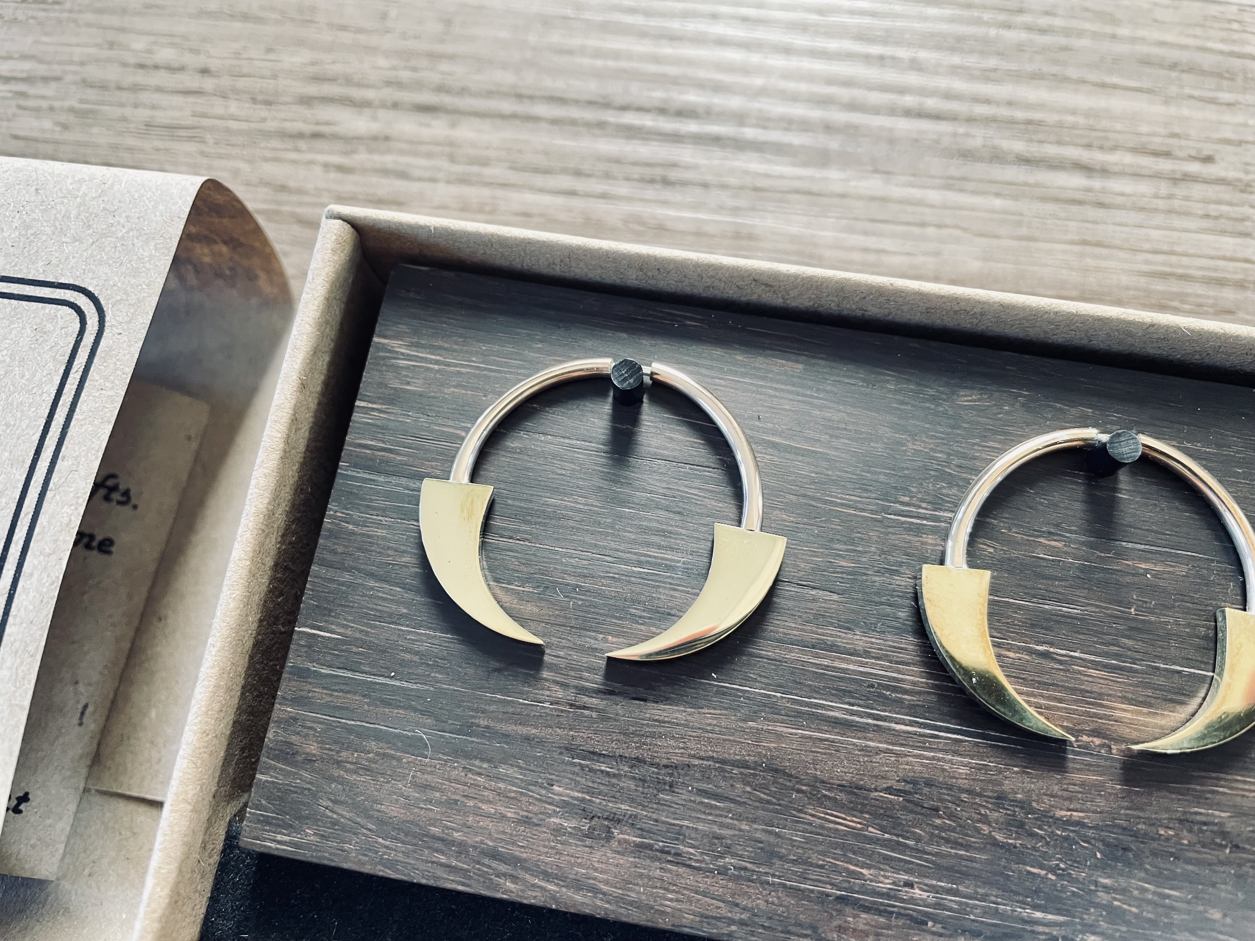

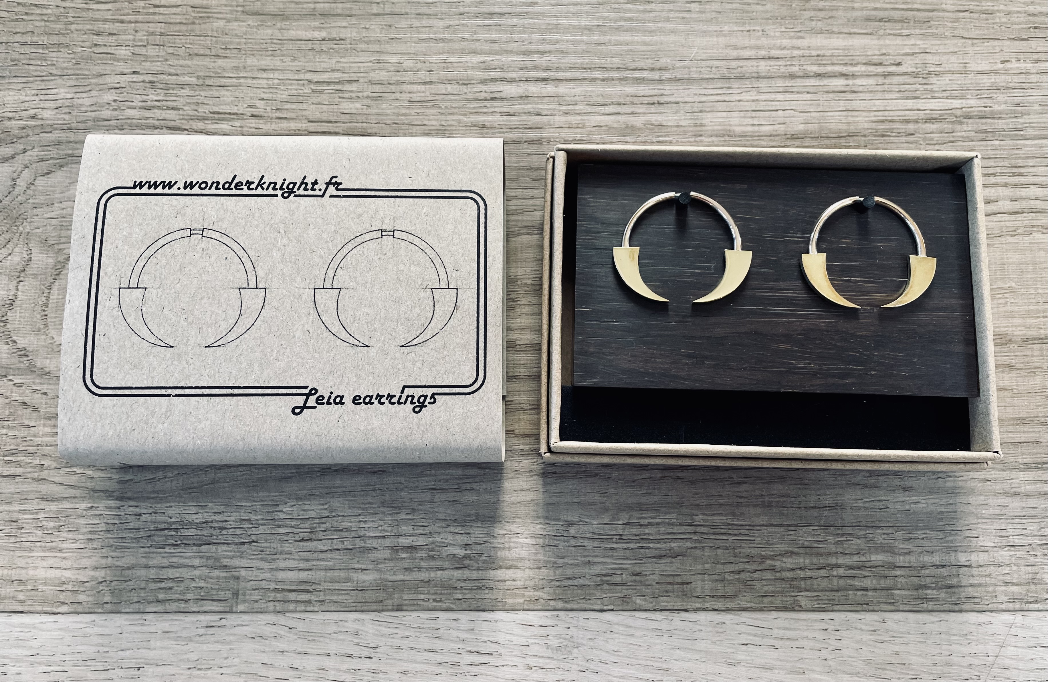

Hi everyone :) ,
Some earrings will soon be ready for sale. Here are some photos of the end result.
Do not hesitate to watch the video to have a better idea of the rendering. The brass parts have micro-scratches that you see when you get close or in a strong light, but the overall aesthetic is really shiny.
