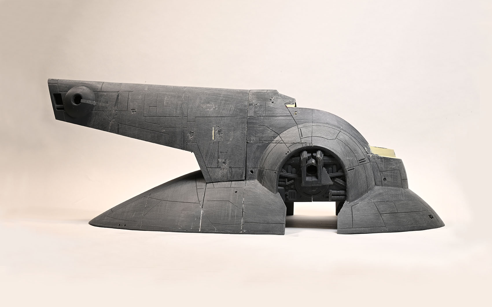

Hi, I'm building a studio scale model of my favourite Star Wars ship, Slave 1. The files were sourced from Gambody and 3D printed in ABS on my Ultimaker over many weeks. The 3D prints only provide a basic framework as there are quite a few inaccuracies and the detail is a bit wonky. It's getting some major surgery and a lot of scratch built detail including an all new cockpit.

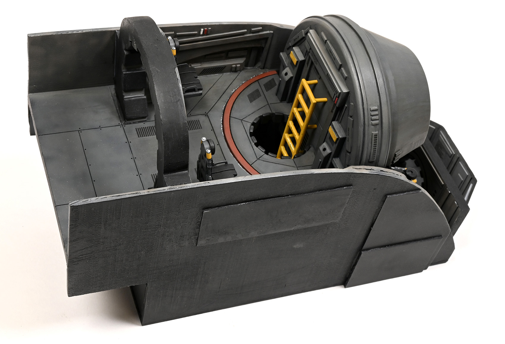

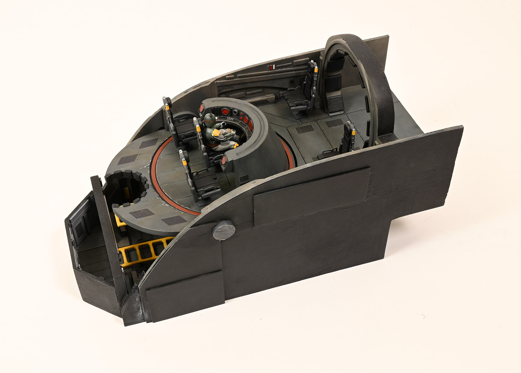

WORKING ROTATING COCKPIT

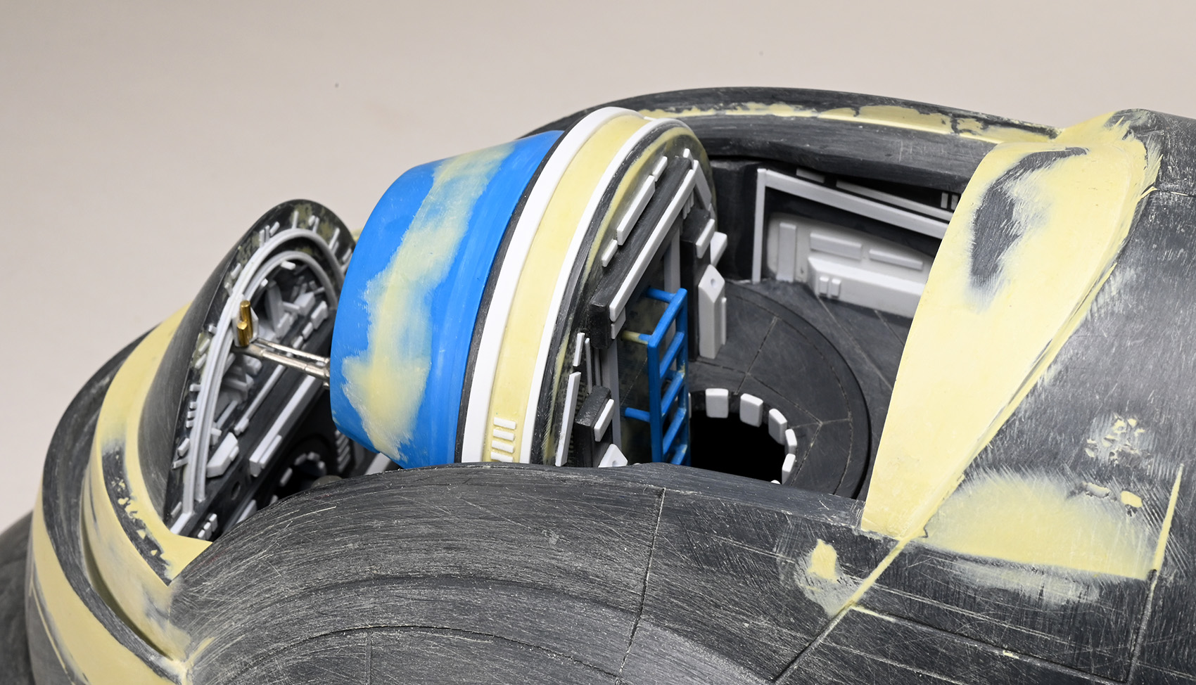

Hi guys, after your encouragement and a few beers I have re-built my Slave 1 cockpit to make it actually rotate! You can see the build video HERE on my YouTube channel. The explanation of my concept is below. Hope you like it.

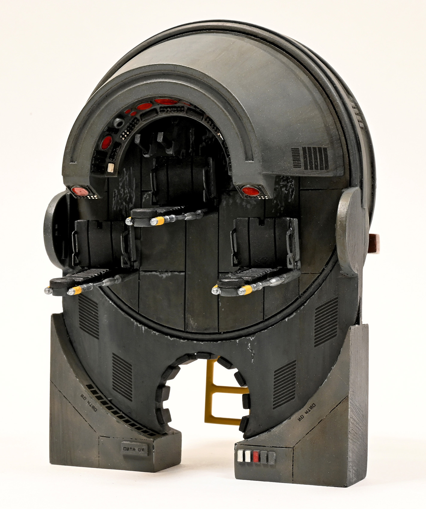

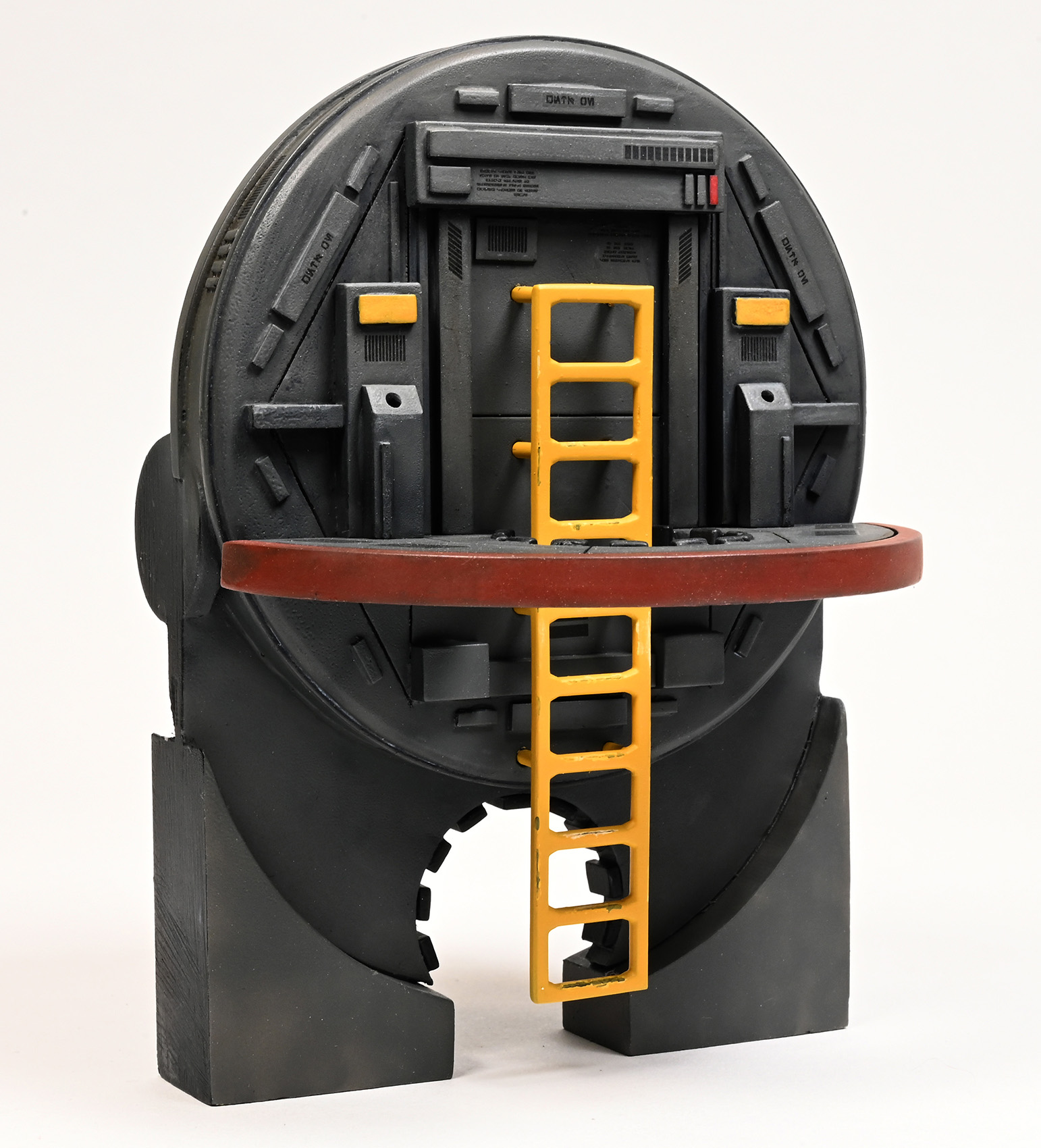

This is the landing / take off position for the flight deck.
The flight deck rotates 180 degrees.

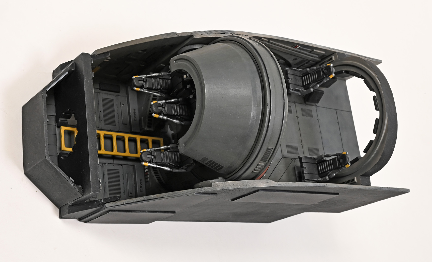

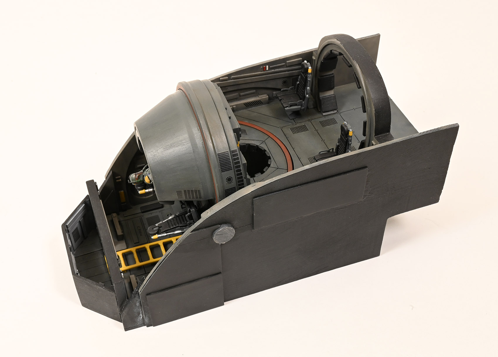

The unit then tilts back 90 degrees for flight

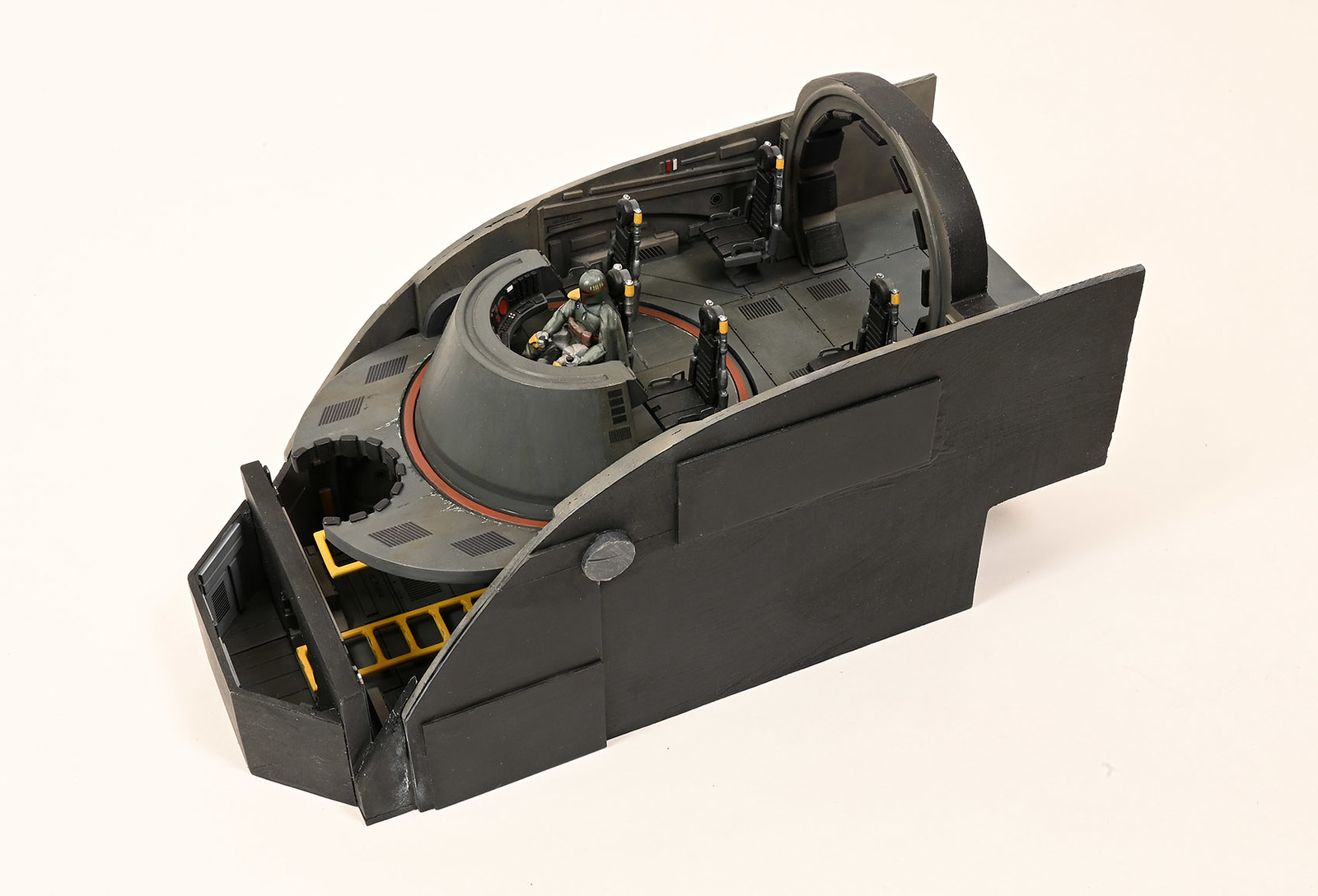

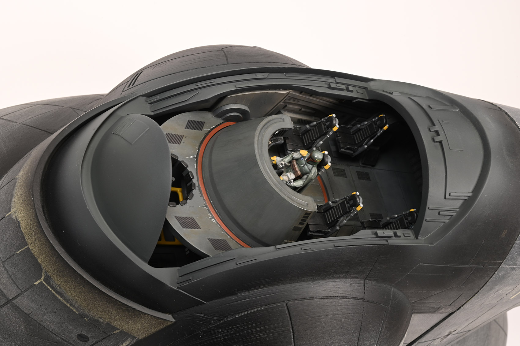

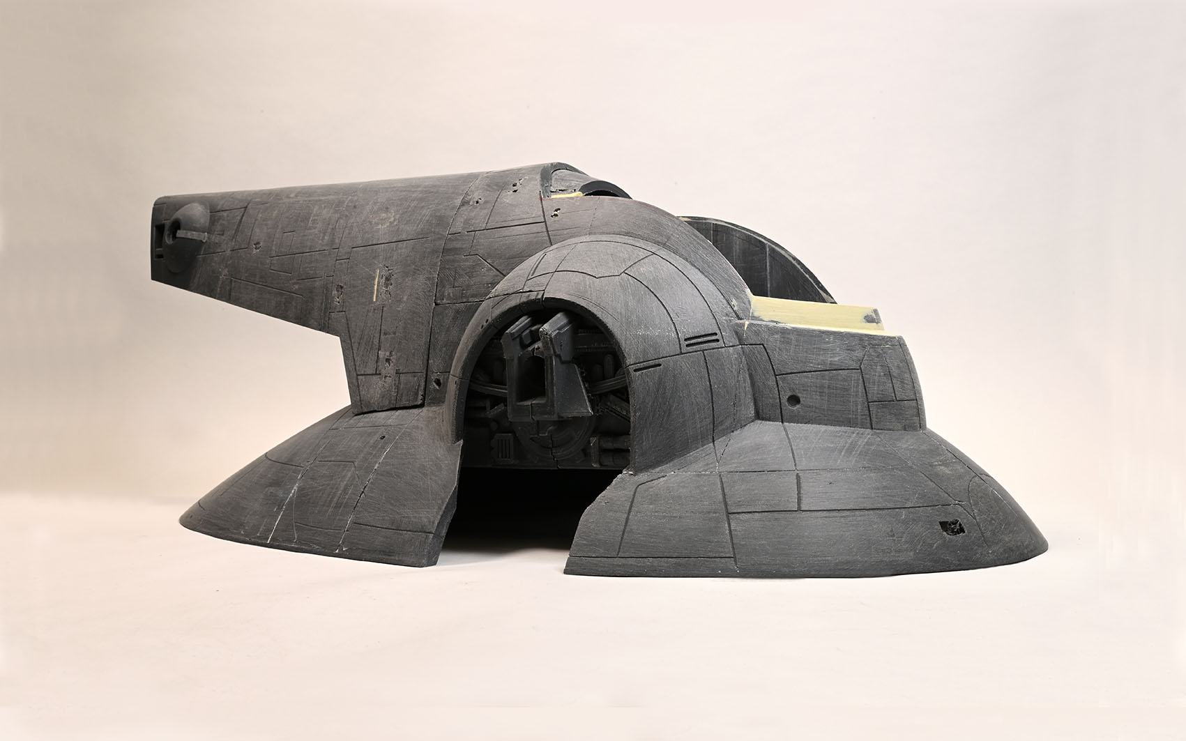

Here's the cockpit unit inserted into the main hull in the landing position.

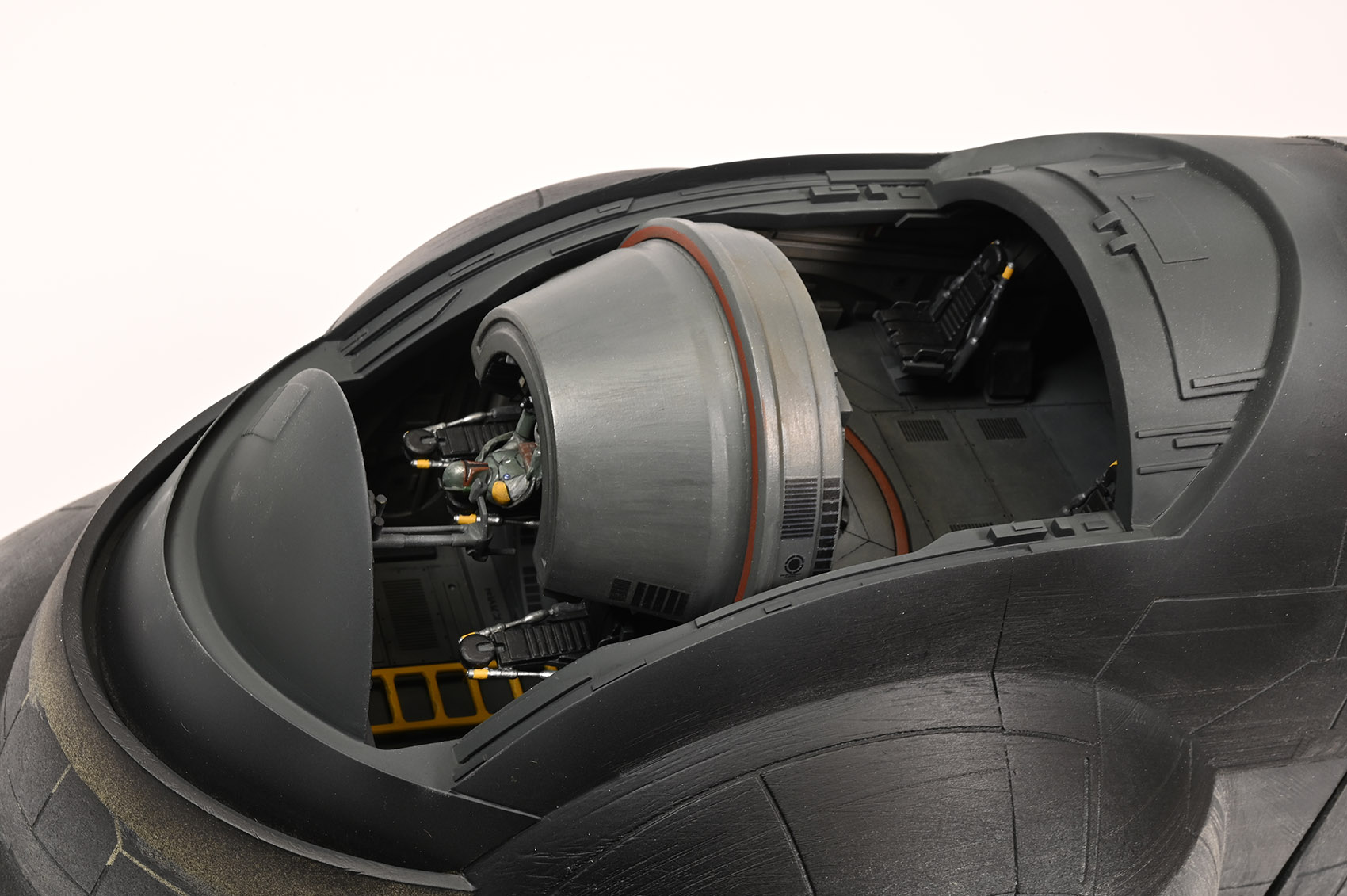

And here it is in the flight position.

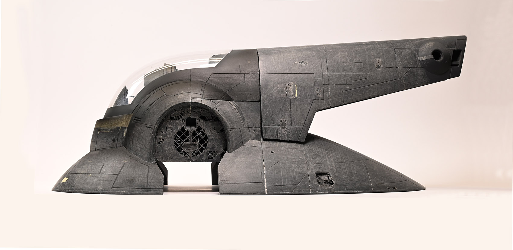

An overall shot with the vac formed canopy. Now I have to start work on the tail and bond everything together before detailing the outside.
