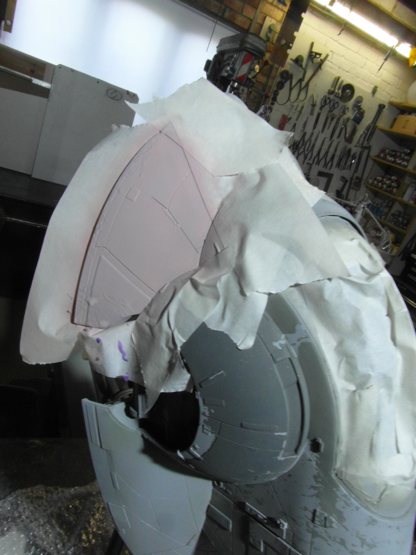

More done this last weekend. Nice to take a break and get something done on the Slave again.
So first hit with the paint.
Sketching out the main details on the panels before the weathering and layering take place.
I painted a tester on a hasbro jango beforehand to check the colours. I had seen the Slave 1 at an exhibition a couple of years ago and was blown away with the overall grey feel to the paint job. When seen in reference images only a few convey the really nice look of the model. So all colour references from other painters and such were thrown out the window and i have mixed these all on the fly to get the feel i remember. Also it is worth noting that there are at least another 5 passes of paint and colour to go, so this is just the starting point.
Heres the side
then onto the pink. Tricky colour to get right, but i think its pretty close. You can see the first layer of masking fluid to reveal the grey.
Next up, more masking fluid to reveal the pink, then shot with my custom red. Once dry, it was dotted with some bubble wrap moistened with some tamia thinners and allowed to dry to create a mottled look, then airbrushed with the grey basecoat to lighten the panels in line with the reference!!
Then rub it all off :)
Well most of it ;-)
repeat around the skirt

Its coming on a bit more after another day and a bit of work. Some areas need a bit more time spending on them, but you get the idea.
im pretty happy with the results so far. Now its time to sit and contemplate the next weathering and detailing passes.
