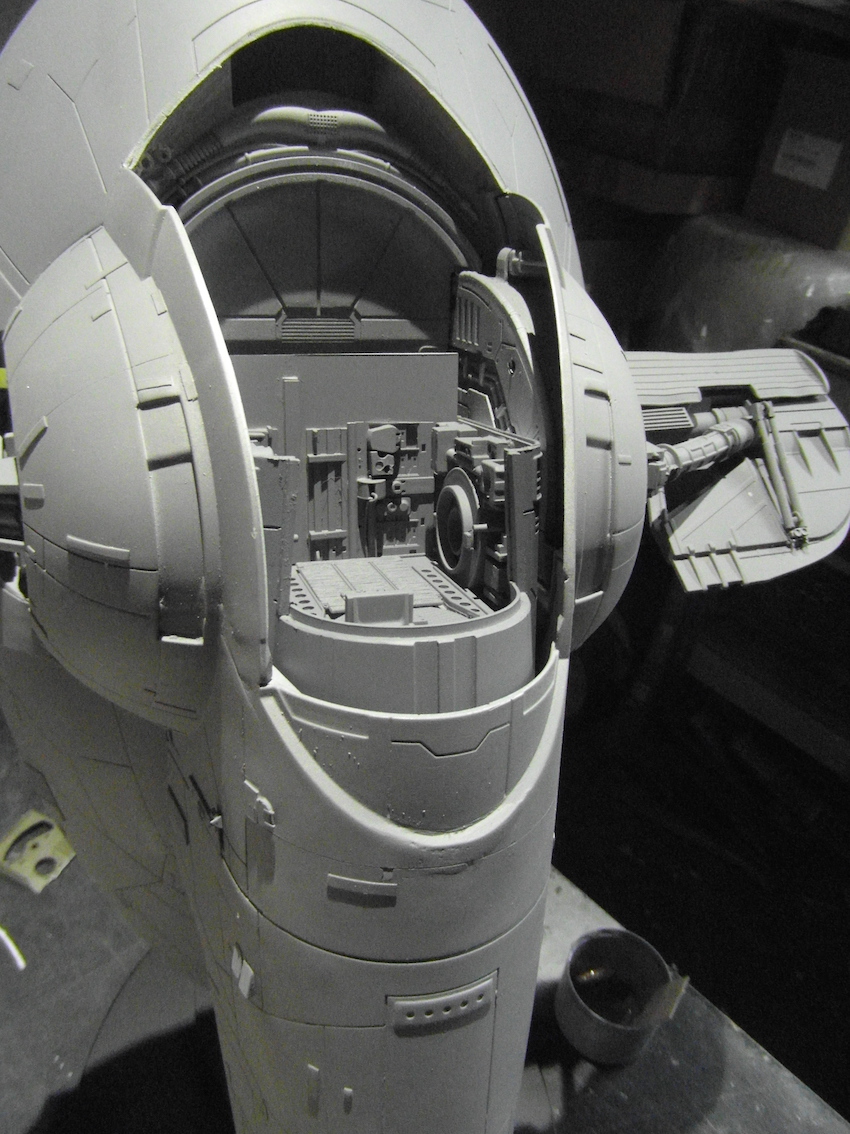

Ive been playing with the cockpit for a bit, I used the main toy interior and chopped it into two, built some new walls and just kitbashed stuff in there in a Mando kind of way.

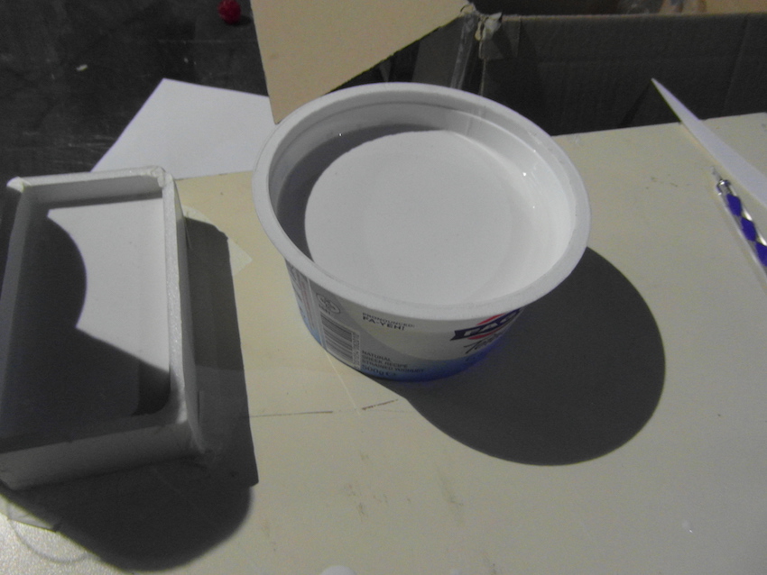

Also poured the first half of the saucer/dish mould.
Nothing to see here :), i was very careful not to confuse this with my breakfast.

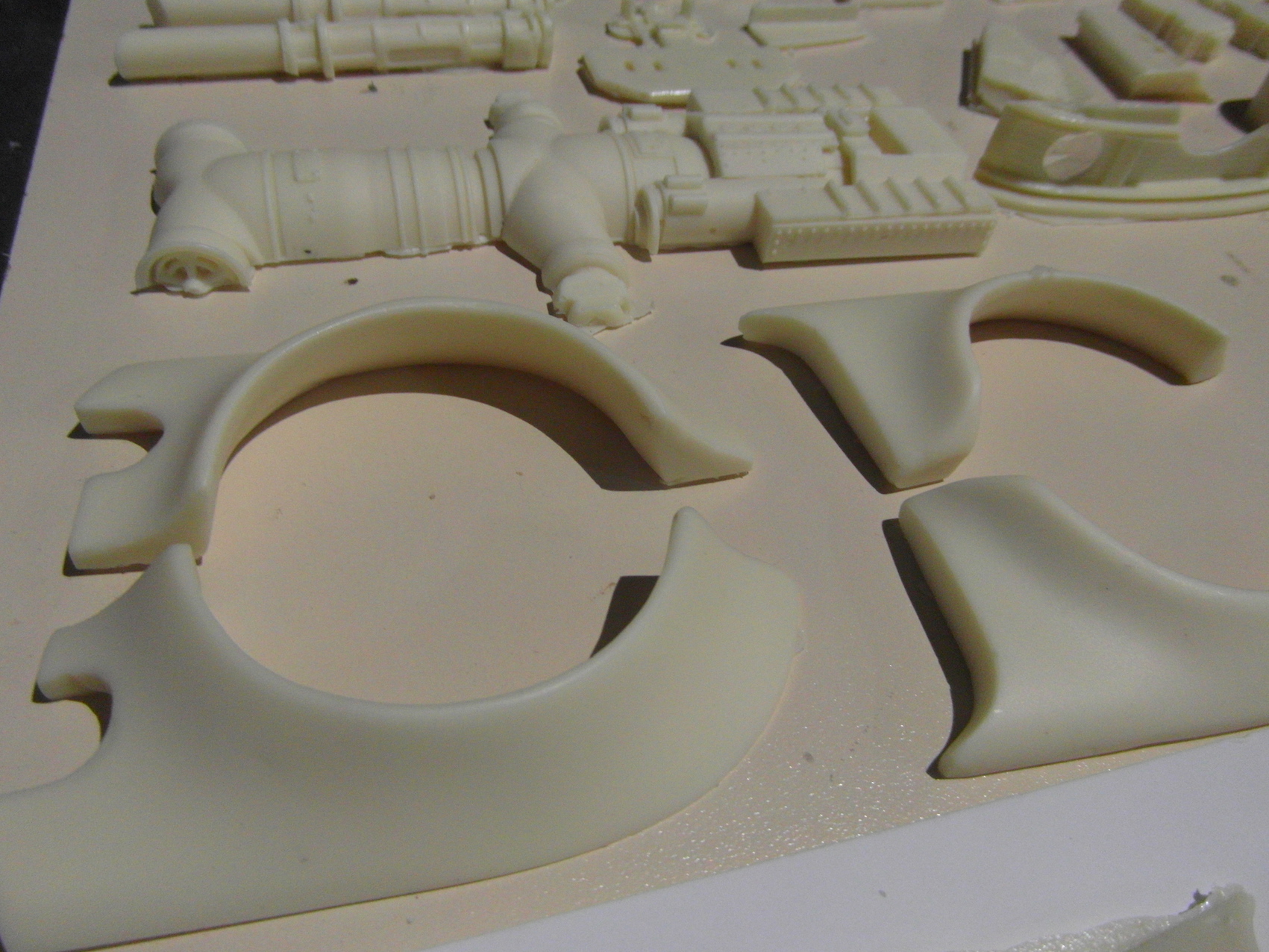

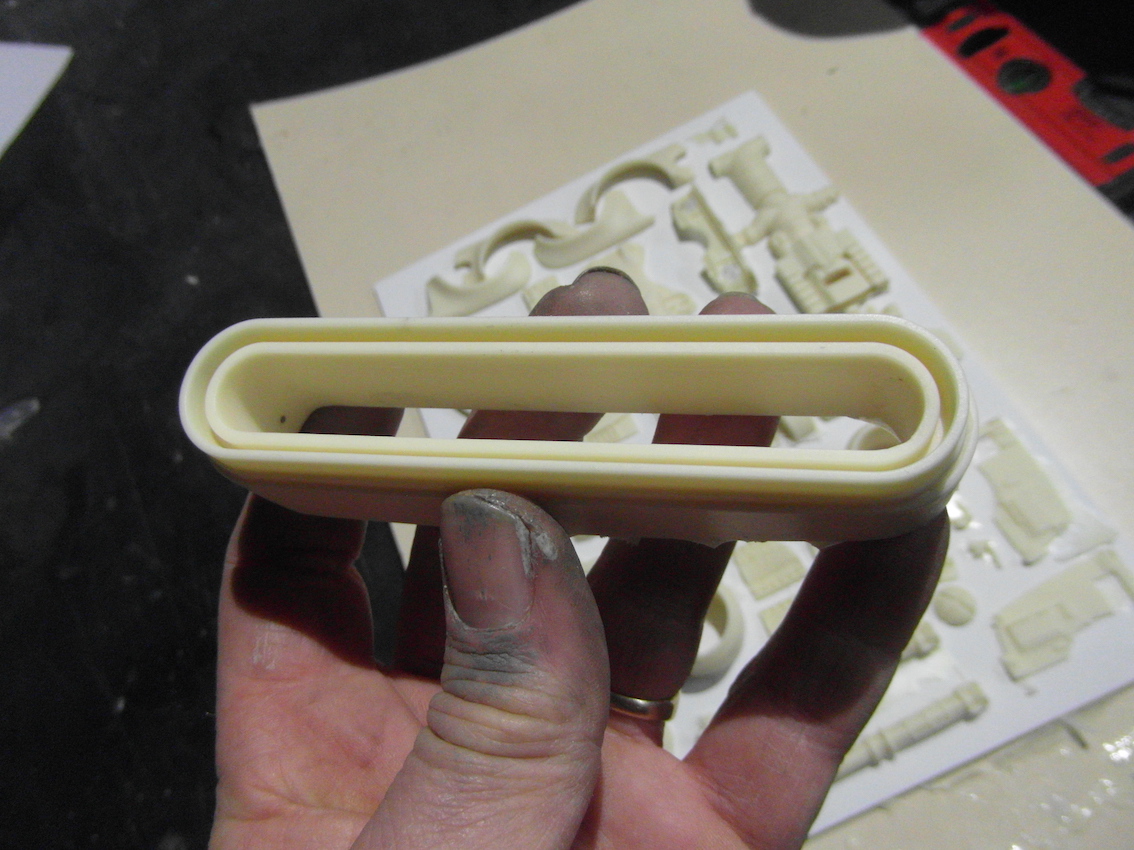

I cleaned up the moulds after removing the master patterns and did the first pour. Once out i could tell where to concentrate my efforts to poke out the bubbles. I dont have a pressure pot or a vacuum chamber so im working this as a true garage kit !!!! LOL.
Here are a couple of shots from the first pull.
I was super happy with the finish on the Porsche arches. Uber smooth.
The main spine details had the potential to be really troublesome, but it came out easily good enough to use. A couple of air traps, but im happy with the result.
So knowing where the bubbles liked to be, i did another pull.
Now were getting somewhere :)
First pull on the left, second on the right.
more to come soon.

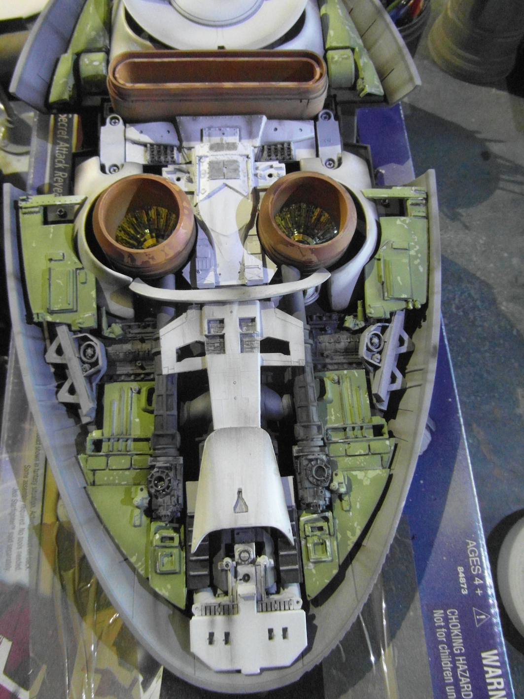

More done on my surface upgrade.

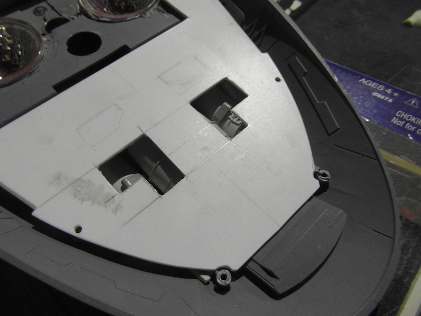

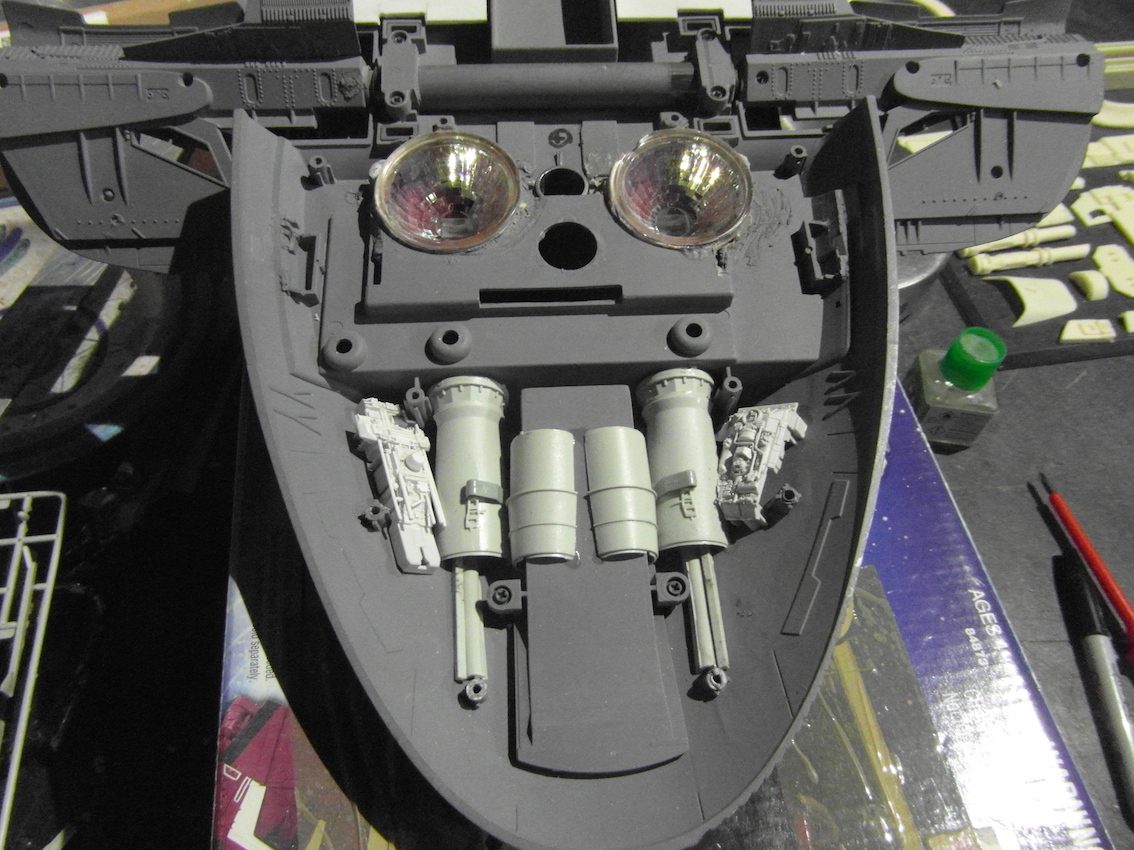

Now i have some parts to mess with i decided to open up the baseplate to allow a view to the underneath area.
I added greeblies in here and an old hacked up finemolds y wing i was given a few years back.
Now adding the detail parts to get the finished look in my mind before painting the parts and assembling the base.
All laid out and now im happy to attack it with some final greeblies and gun barrels then time to paint.

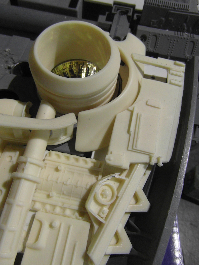

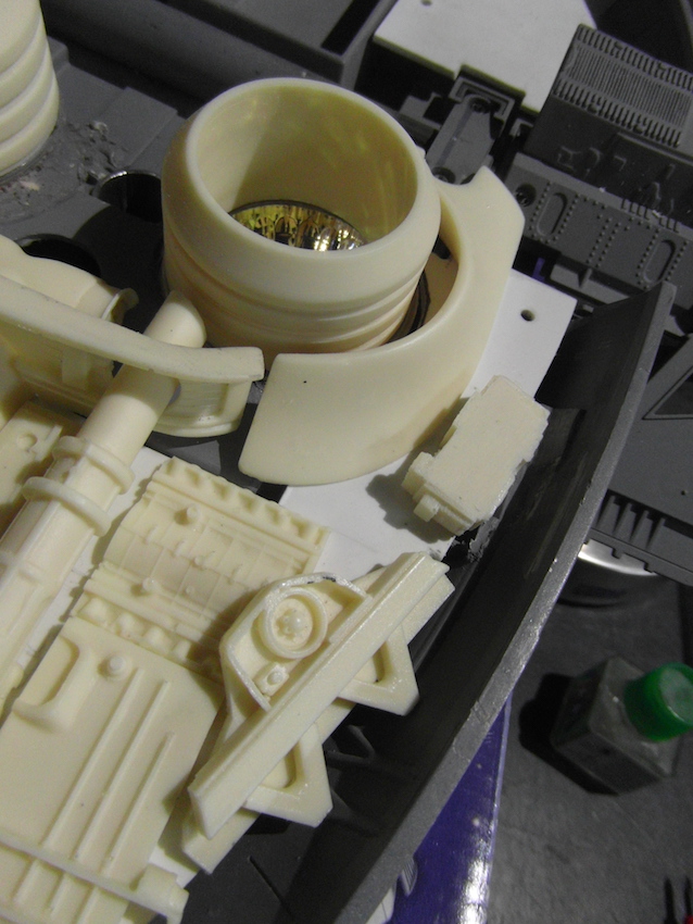

Ive done more today, all parts now stuck down, I'm adding some more detail parts and getting them ready for casting.

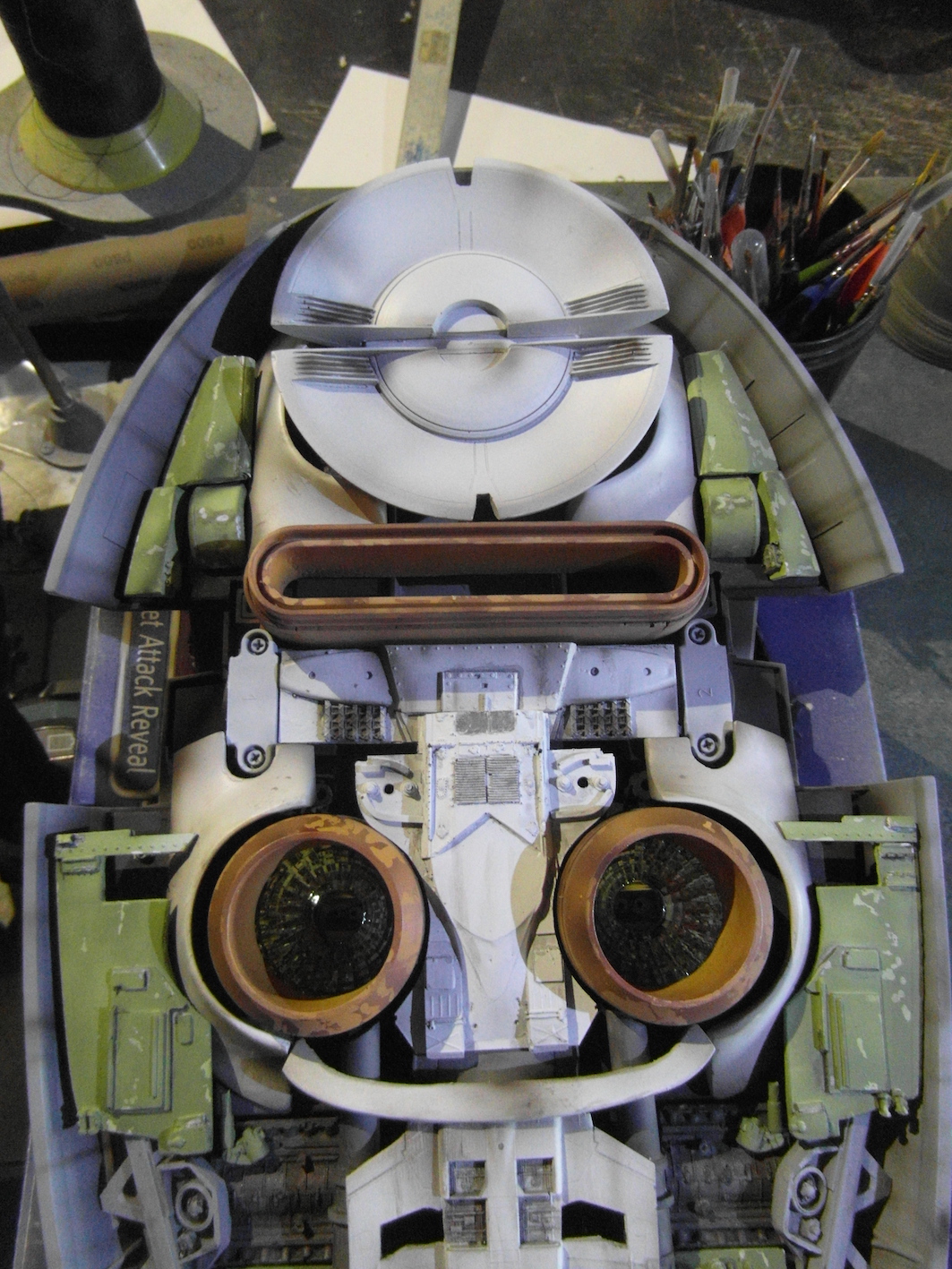

Heres todays painting update. All other moulding stuff is now on my other interest thread.
Cheers folks. :)

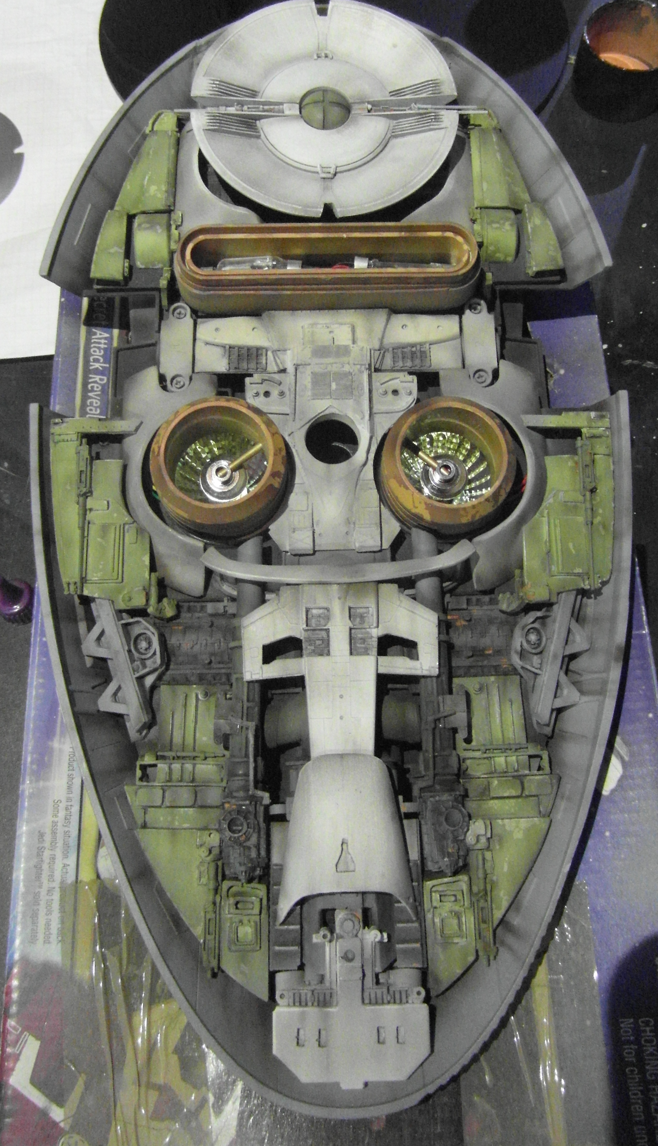

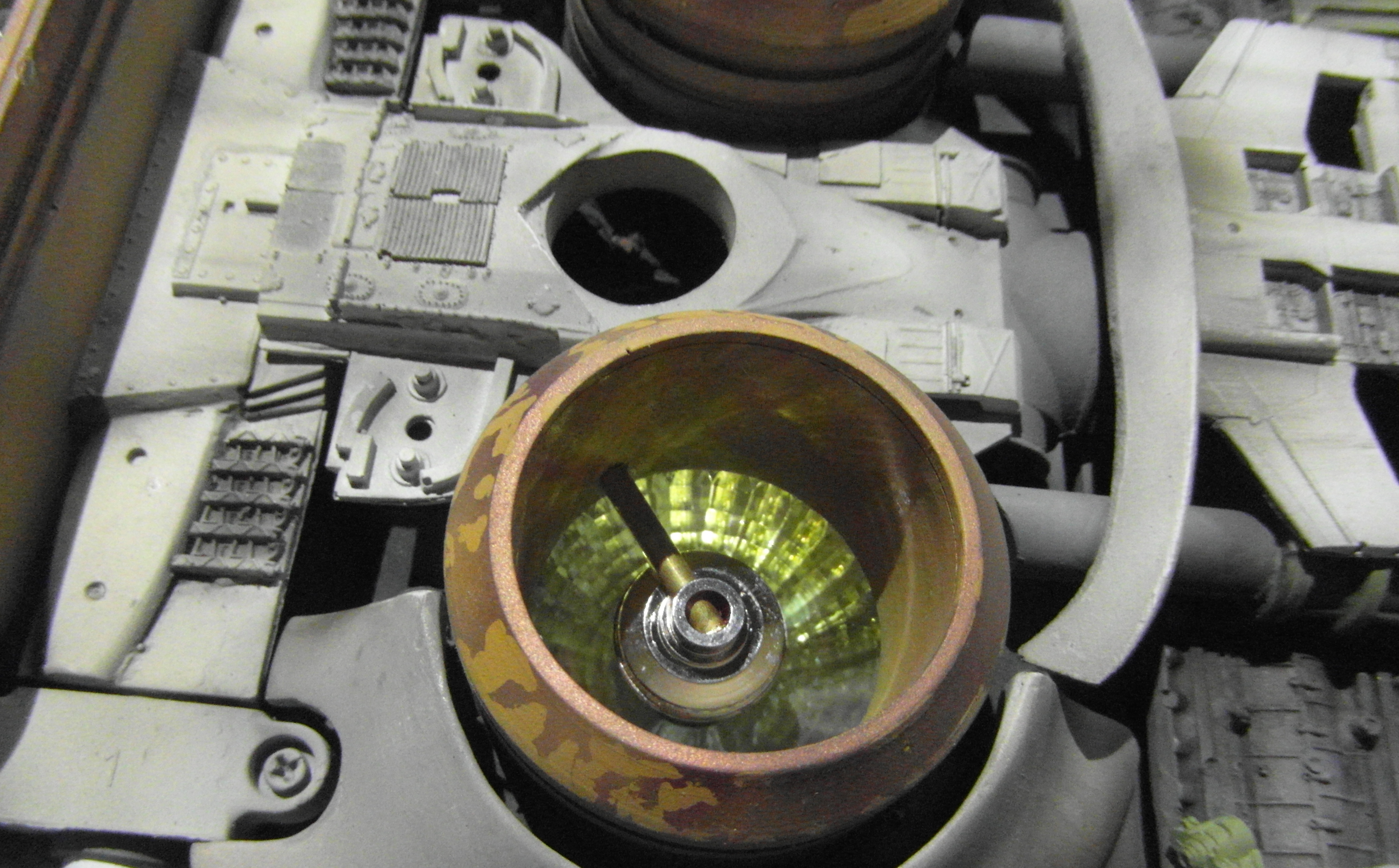

Ok. I think i've done enough on this lower surface upgrade, now its time to get the top surface ready for paint. all the other paint details on the bottom will go on once the whole thing is painted to this point and ready for the final few weathering and sharpening up passes.
Its been a mission doing this upgrade, i know its not accurate by any stretch, but i am more than happy with its final look.
FYI I used parts straight from the moulds, no filler. I have done this to accurately show what the final finish is like without hours of sanding :). There are some small defects here and there, just being honest about it.
Hope you like it, i cant wait to get the wings and the top half sorted.

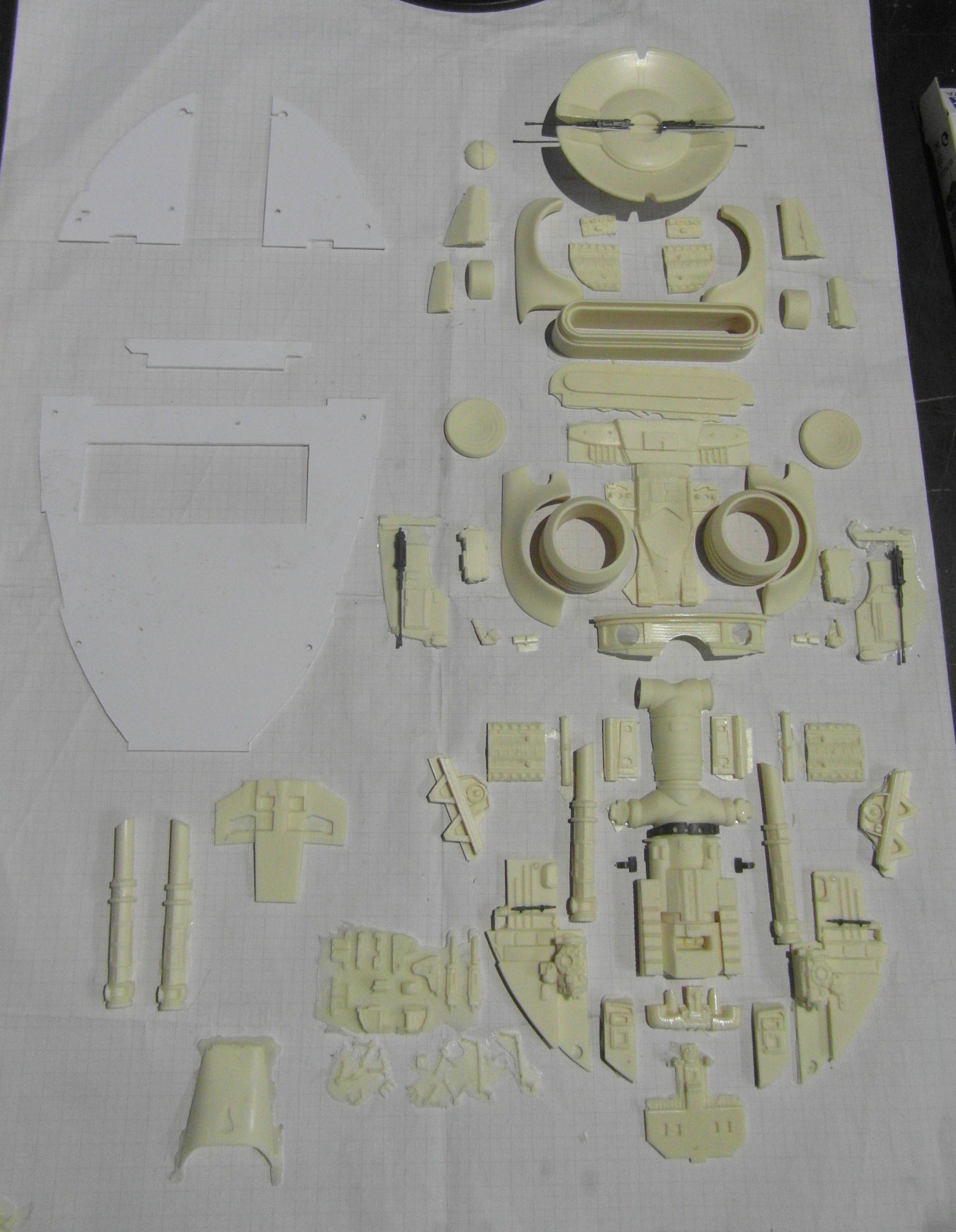

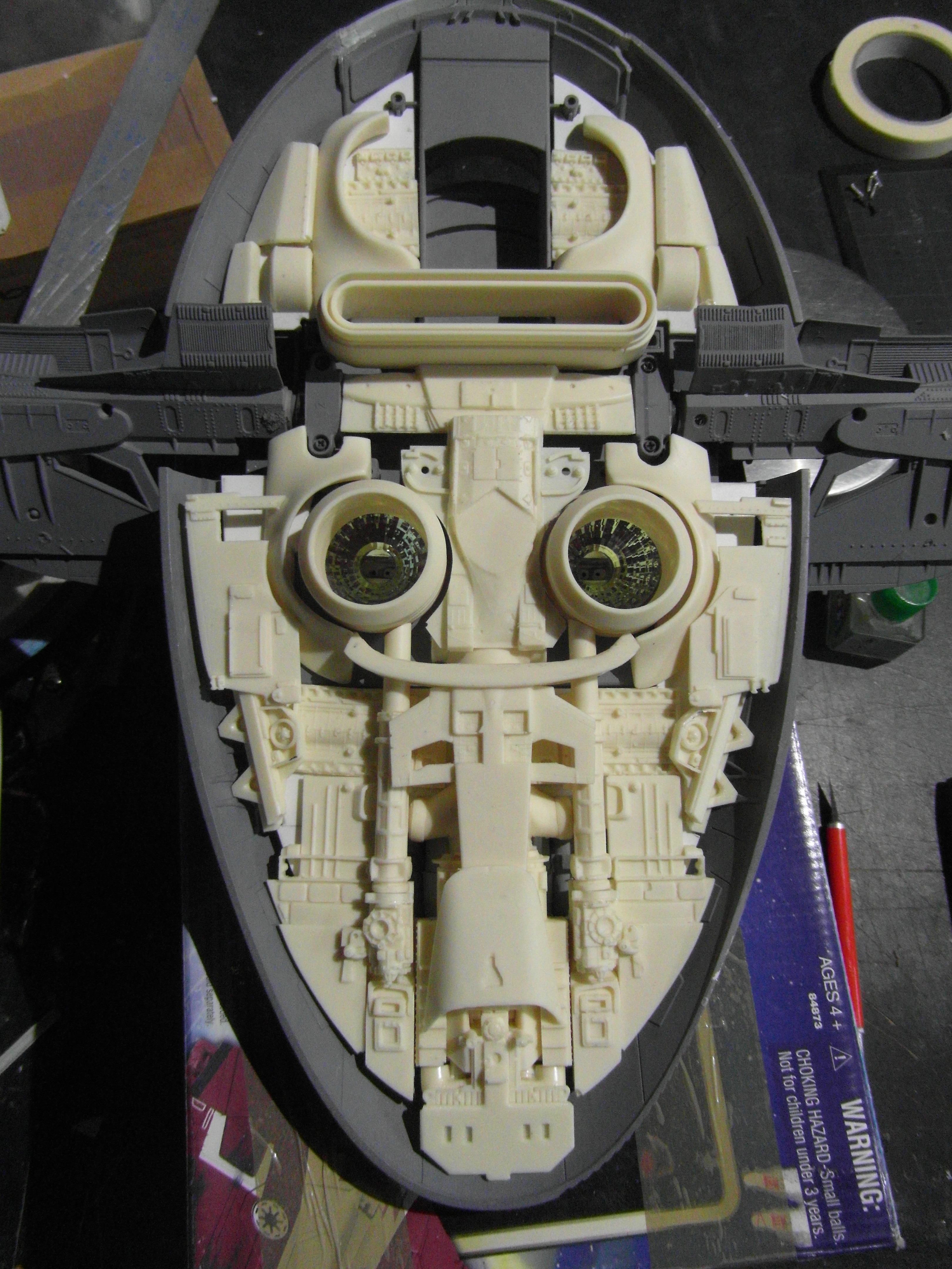

So heres where its at now. Kit complete, all greeblies cast and on their now.
Time for a break from this one for a little while and get to some other jobs which need doing.
Ill post more here as it happens. Kit parts updates are on the other thread for anyone who is interested in having one of these.

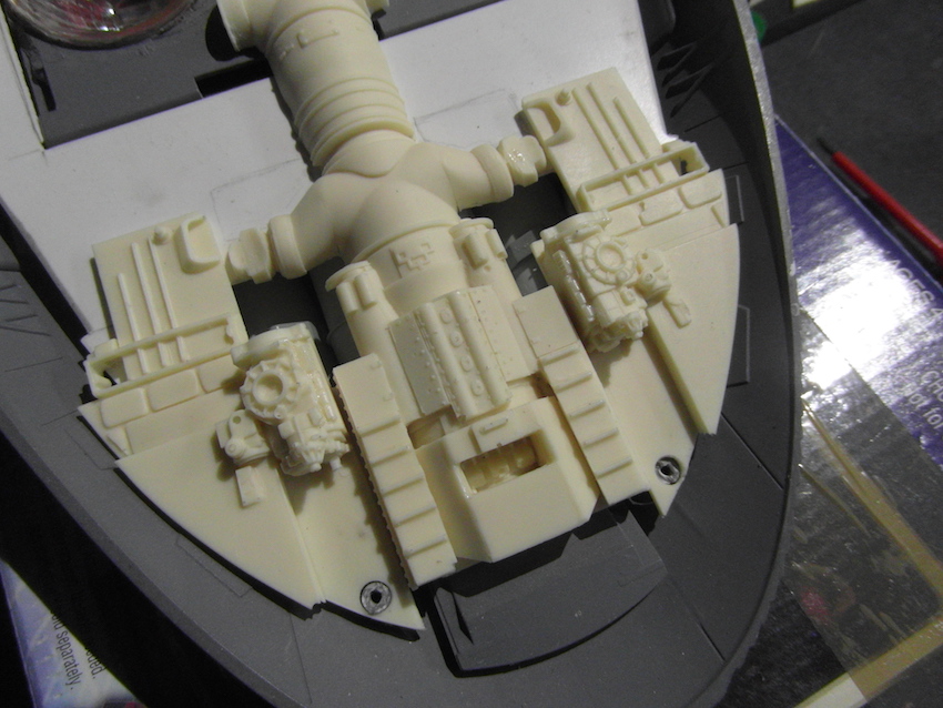

Just to show off a bit, here are all the parts it took to remake this base.

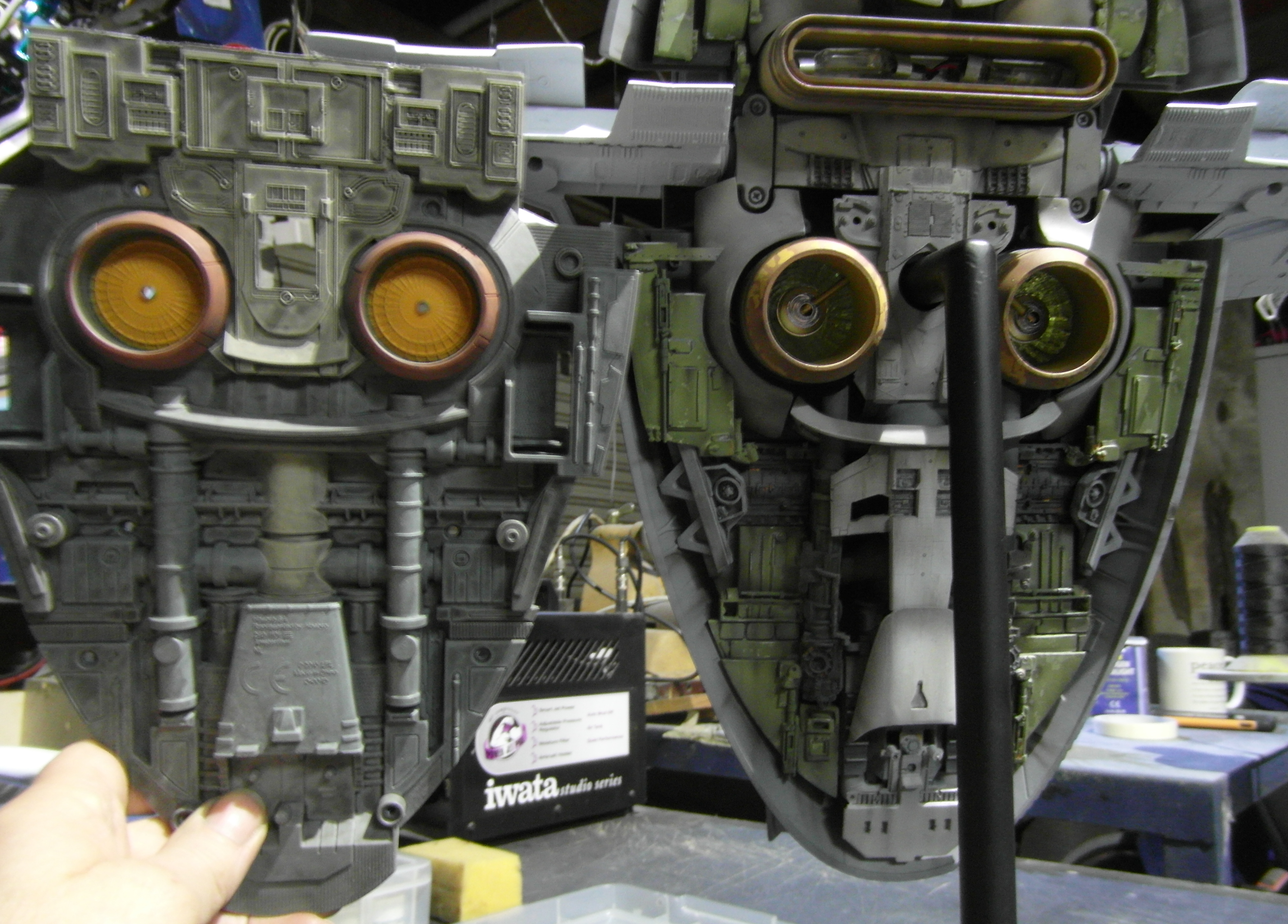

And heres what it looks like next to the original base details
And a final all overall view of the base.
More soon folks.
