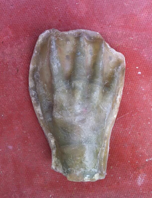

can wait to see the hand cast. oh ..BTW ..i forgot if i told ya or not but i found a replacement for silpoxy. GE silicone caulking 1 ( the number 1 is important) ..its about $8.00 USD for a whole caulking tube rather then the 30 bucks for the small squeeze tube at smooth on. It cures just the same ( yes ..same vinegar smell) and breaks down with Naphtha

yeah you told me about that stuff, ill be sure to grab some when the suit and I land stateside for dcon. thanks :)
Yup feels like I am making some headway at last, i still plan to try and get the bicep armour moulded this week.

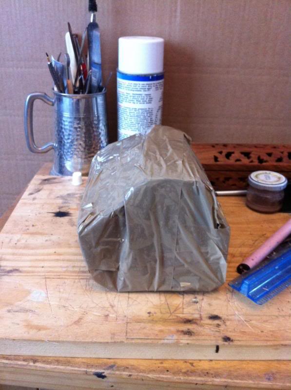

later today i am going to measure my shoulder, then probably make a armature either carved out of expanding diy foam, or taped up cardboard.
Well my expanding foam idea did not work for a shoulder armature, ( the can I had left had leaked a little and screwed up the valve )
so cardboard armature time.

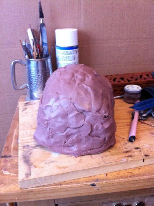

measured my shoulder, then made a cardboard armature the same size, then nuked some monster clay and layered it on top, when its finally cooled and gone hard im hoping I will give me a solid enough base to block out the shoulder piece.

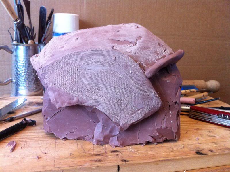

Well, got to this, and I can see it will test my patience.
the side panel is blocked out as you see, and im pretty sure I made it too big.
I was going to cut the edges in but stopped after the lower corner as it looks too big by maybe 10mm maybe, I am going to have to do the other side and fins to know for sure I guess, I hope to have them blocked out by tomorrow night as I am have a few hours of sculpting tonight and tomorrow.
