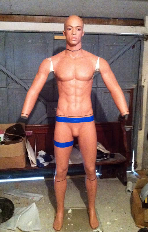

1, because the arms were fibre glassed out to the side, and I will not be walking around like a mummy............ see photo below.
2, because even if they were not, the mannequin has skinny little shoulders.................see photo below.
 I had to considerably flesh out the whole upper body on the mannequin when I sculpted the torso
Hey dude sorry. For all I know you are the same size as the maniquin. You could just do a quick plaster bandage cast of your shoulder and sculpt right on it. Just a thought.
no need to apologise, it did cross my mind when I did the bicep, then I remembered how skinny it was.
Plaster bandage would have been a better idea, hindsight huh, but I am well under way now so meh lol.
