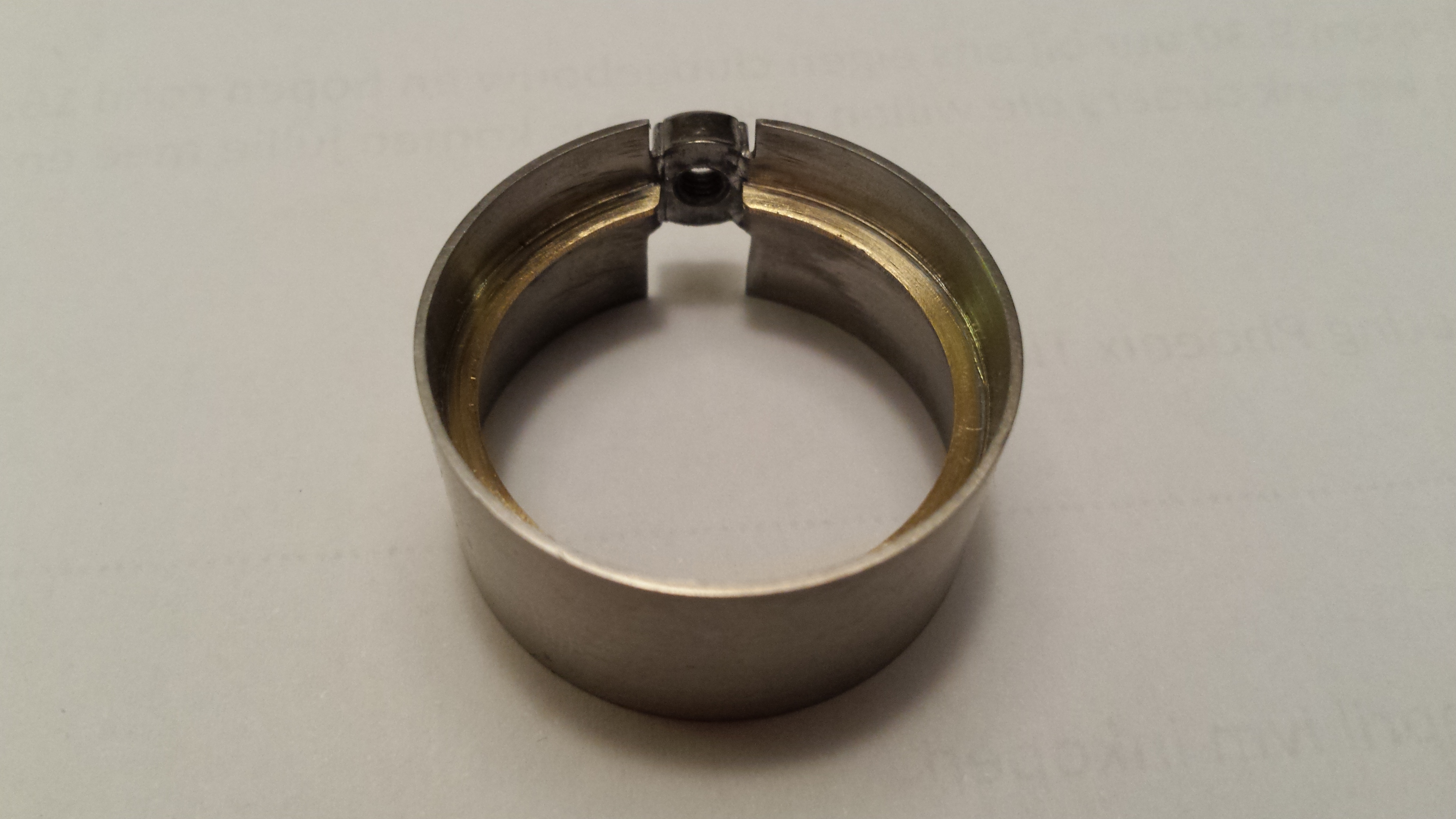

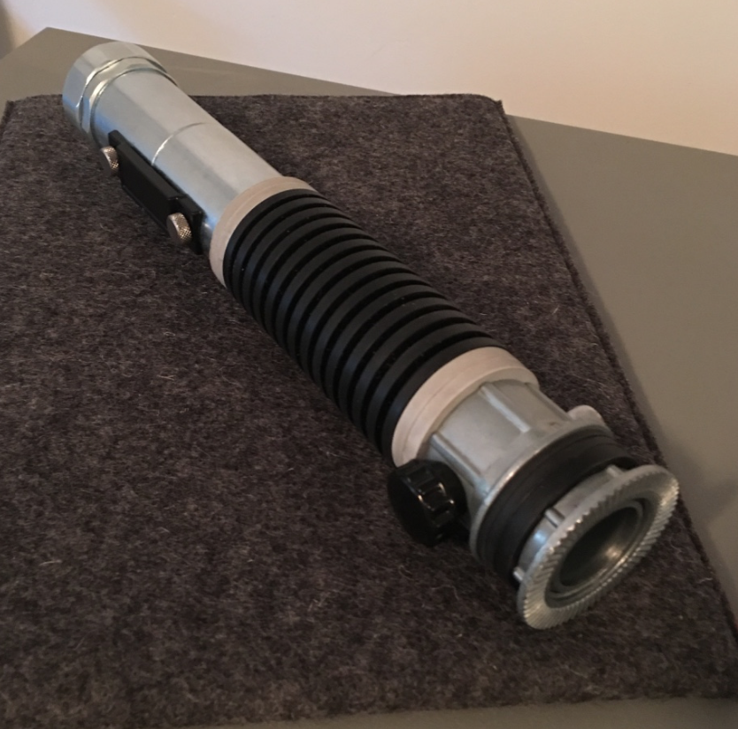

    Hey, I'm currently in the process of building a Luke v2 from hardware store parts and was wondering what I could use in place of a cone knob. Any suggestions would be great!
  9. SethS
    SethS Master Member RPF PREMIUM MEMBER
    Trophy Points:
    2,791
    The V2 actually has a flat top, if you put washers on either side of a flanged pipe piece and us a V2 nipple-esque bolt atop the rod, it would look right. If you want an Obi-Wan / Luke TLJ style emitter, you'll can try finding an aluminum rod that matches the ID of the emitter part, cut a 1/2" slice, drill at tap the center to match the rod you're using, then drill and tap a small hole for a grub screw on the emitter piece to attach it.

    I'm talking about the knob piece near the pommel. Everything else I have pretty much done. I'm not going for a perfect replica, just something to capture the characteristics of the hilt
  11. SethS
    Trophy Points:
    2,791
    Oh -- sorry. Cone knob, not cone adapter.
    You can thumbscrews of all sorts of shapes and sizes and drill/tap a hole pretty easily.

    Hey Velocity502 ! What SethS said about thumbscrews, just chuck 'em up in a fully charged drill and go at it with a file until it has a pointy end!
    Velocity502 likes this.

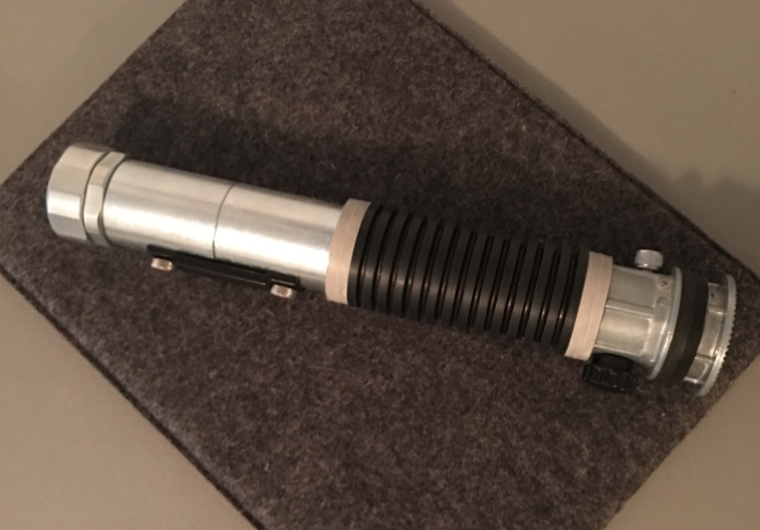

  17. Velocity502
    Velocity502 New Member
    Trophy Points:
    2
    IMG_20190309_150709717_HDR.jpg my hardware store Luke v2. Its not perfect, but I love it

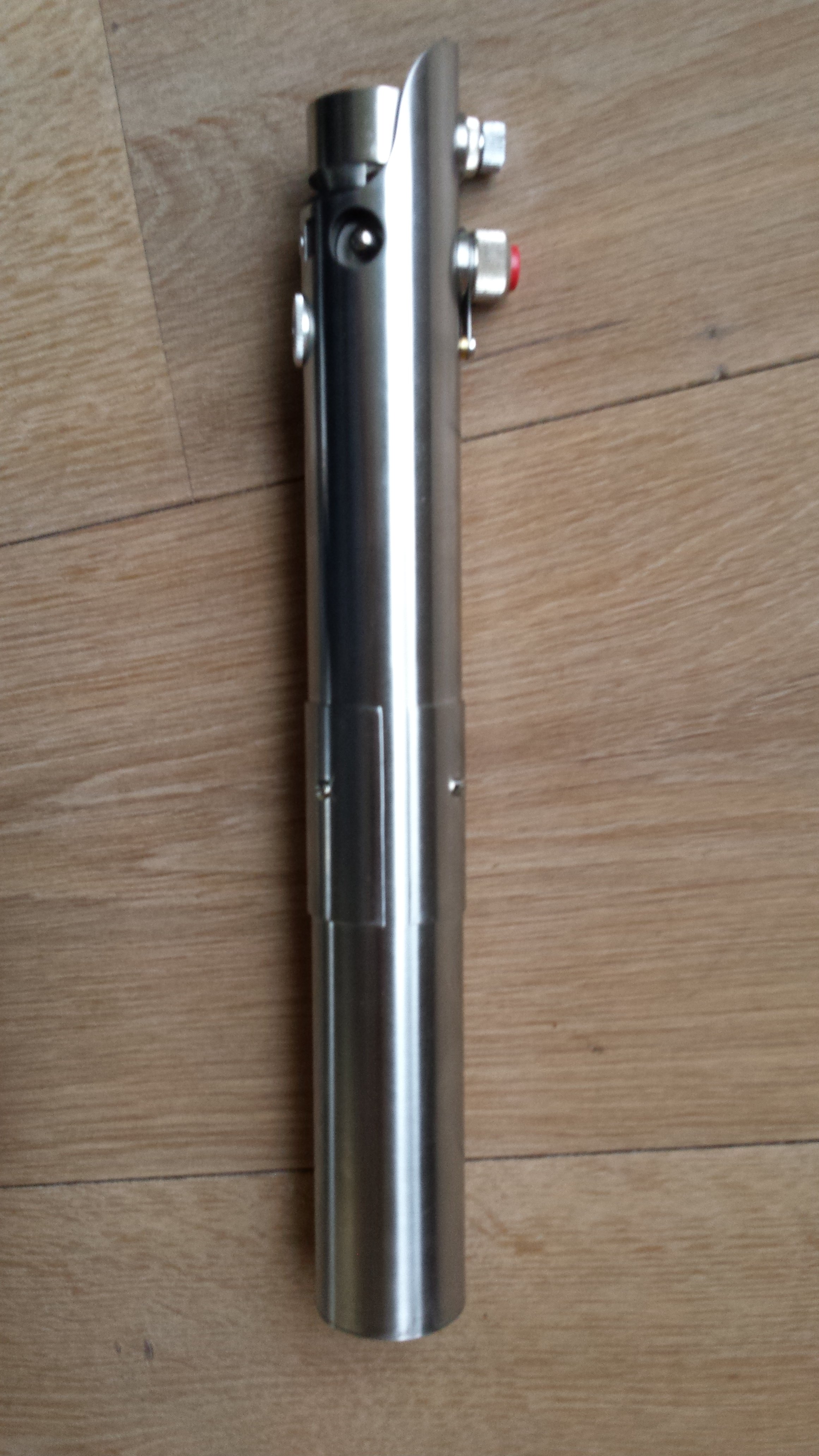

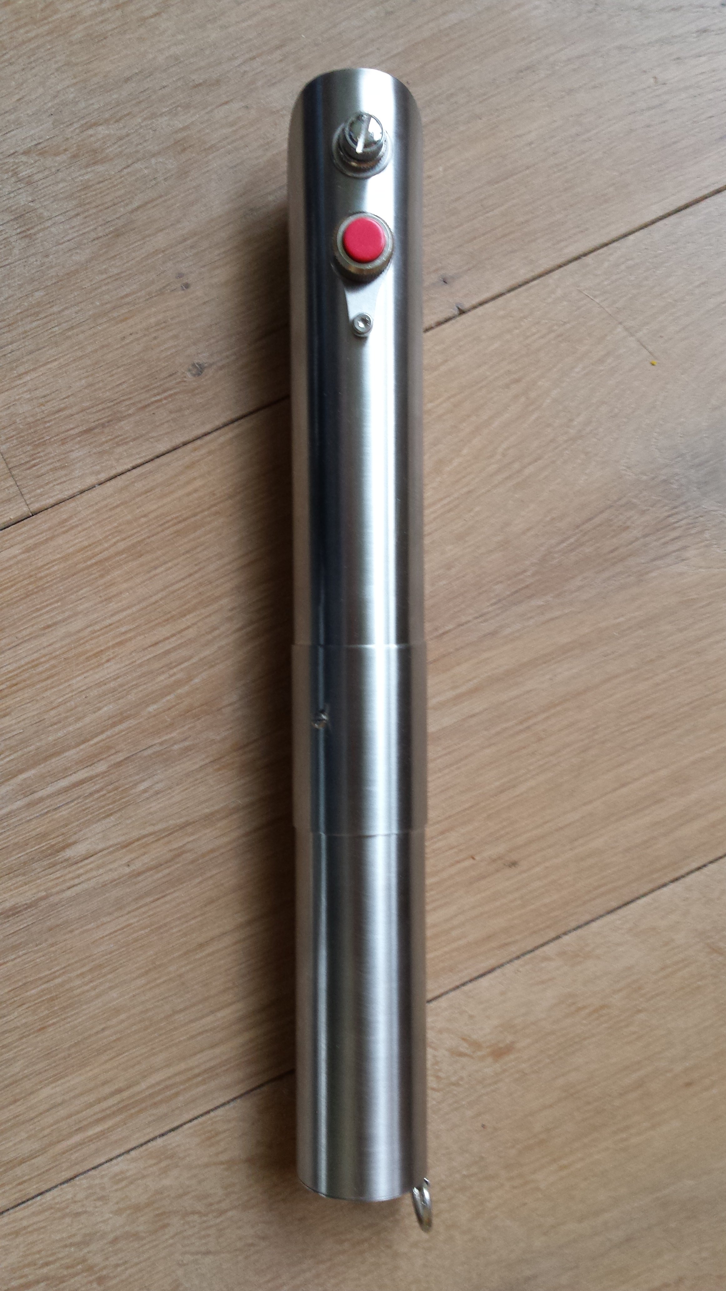

    I originally shared some crappy pics of my custom sabers a long time ago but Im playing around with a new photobox so I thought It was time for some revamped pics.

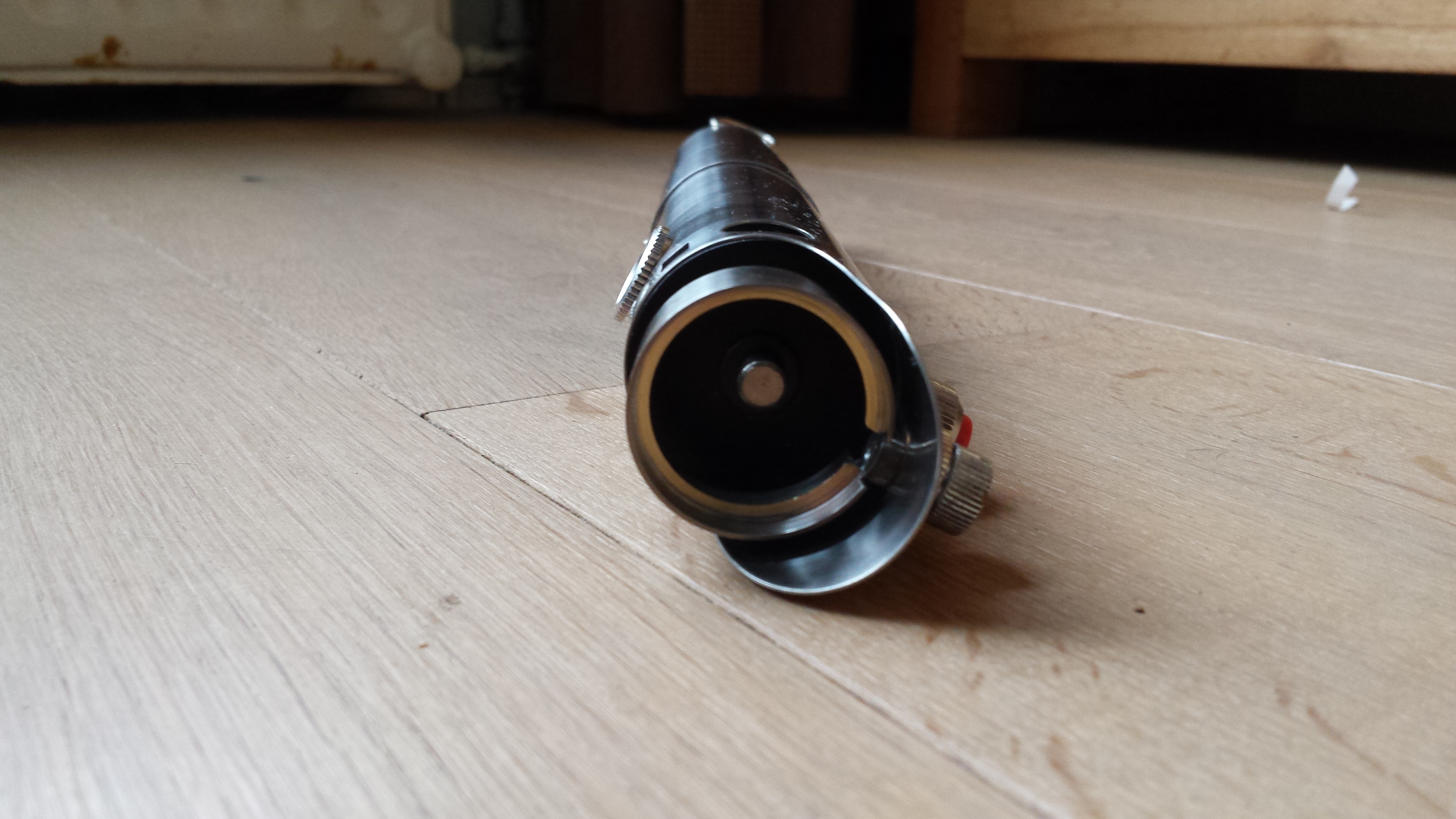

    So while I'm waiting for funds for my speaker, Nano Biscotte sound card and LED to complete my internal chassis, I've been stripping the guts from a Sekor Mamiya flash. Turns out, the threads on the top and the bottom are the same as a D-cell Maglite tail cap. And since the Custom Saber Shop has pommel adapters for D-cell Maglites, this handle might be the one to test that chassis when it's done.
    Sadly, the Sekor is only a two cell, so it's a pretty small hilt. Too big for a Yoda sized Saber, too small for a standard sized hilt, but for a Shoto Saber, I think it could work. Once I throw a 24" blade on it, I think I might have something.
    The chassis I'm building will eventually go into my Wishlist Saber built from components at TCCS, but I was thinking about getting a Pico Crumble for a second Saber... So methinks the Sekor will get fitted with the Crumble and my dream Saber will get the Biscotte.
    And once my wife figures out how much all this costs, I'll get the doghouse.

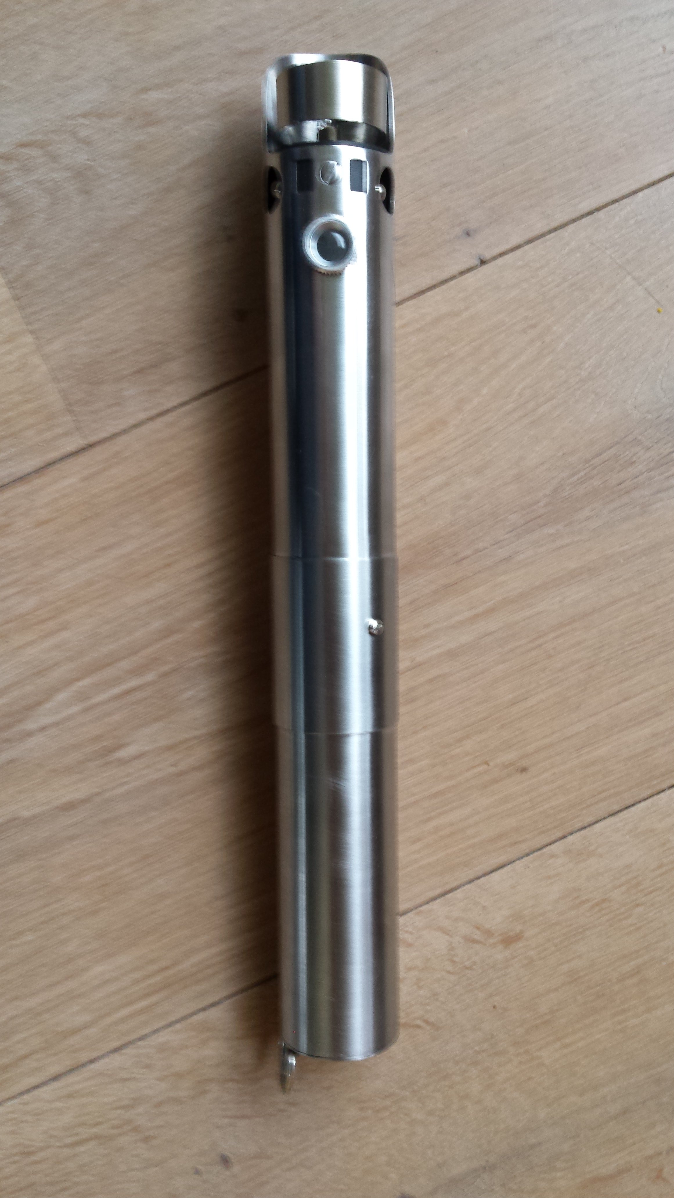

    This is what I have gotten for the 2 cell Sekor. A bit of sanding down to the brass for the Electrum plated look. It has a thread hole in the side, haven't measured the thread pitch but it is smaller than 1/4-20, which looks like it might fit a glass eye from a Graflex.
    I have a wishlist of about $70 for parts from TCCS, and that before a blade or electronics. This is an expensive hobby. 15526614552411109050655.jpg 1552661479015146434254.jpg 15526614941191909573115.jpg
    Project D and BipeFlyer like this.
