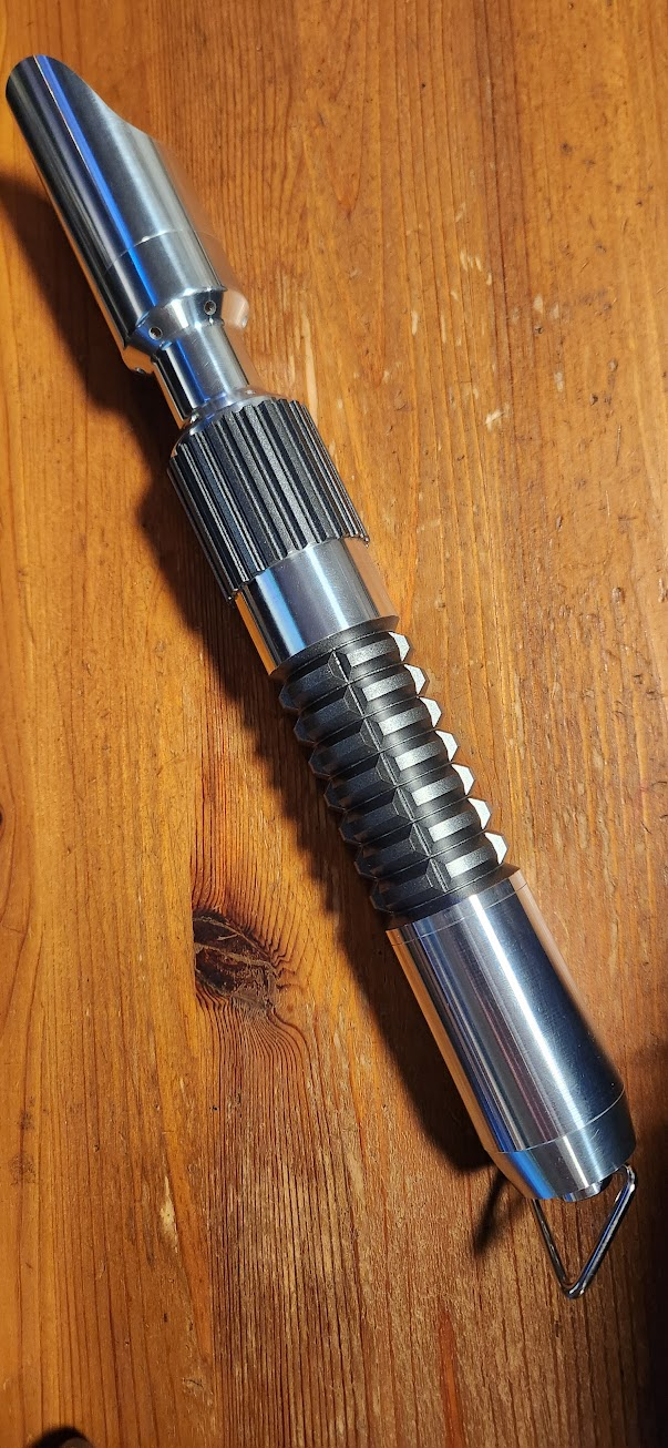

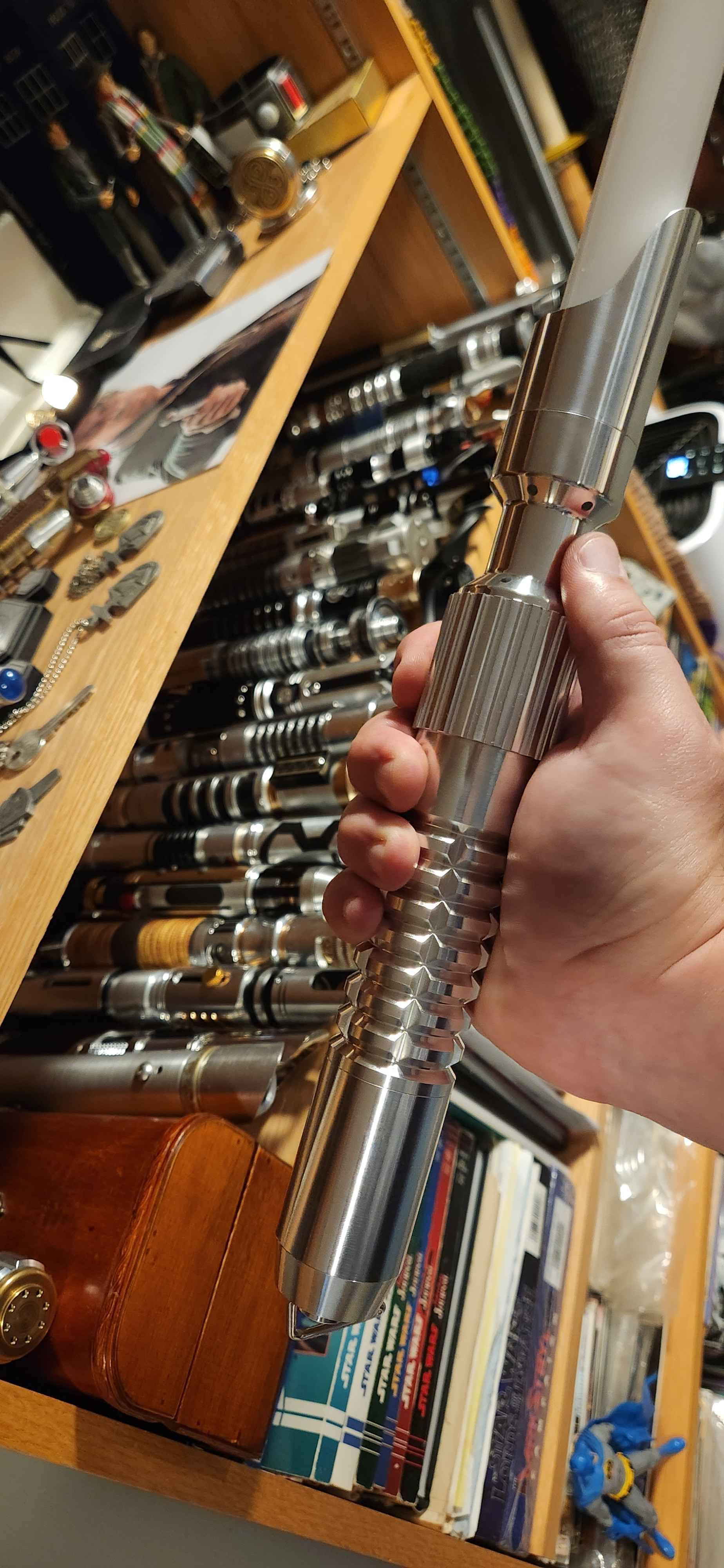

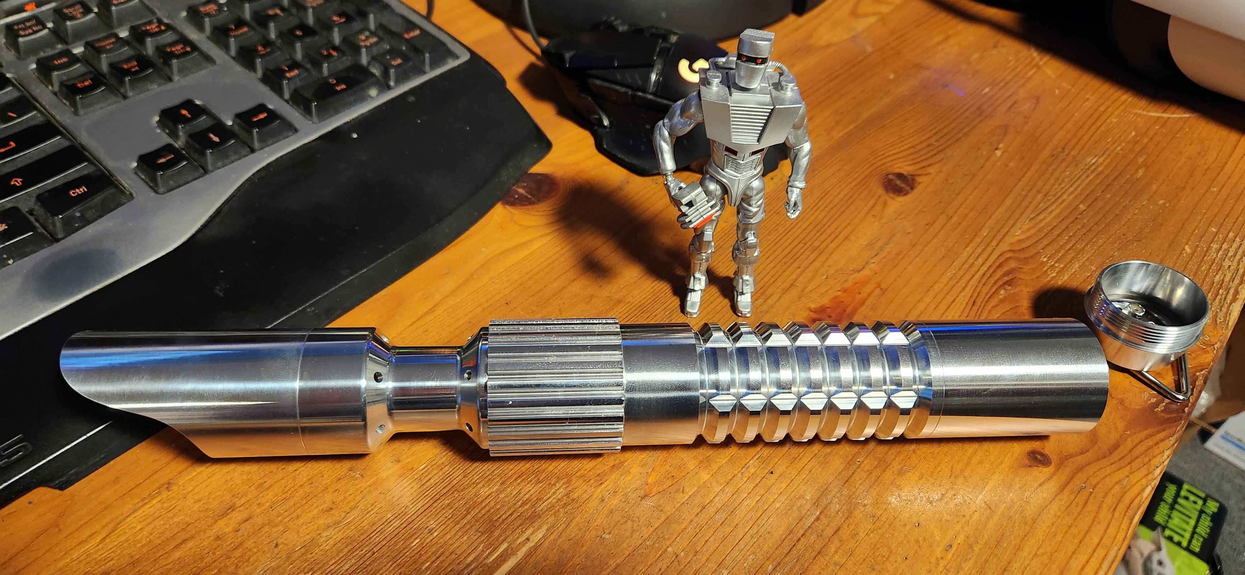

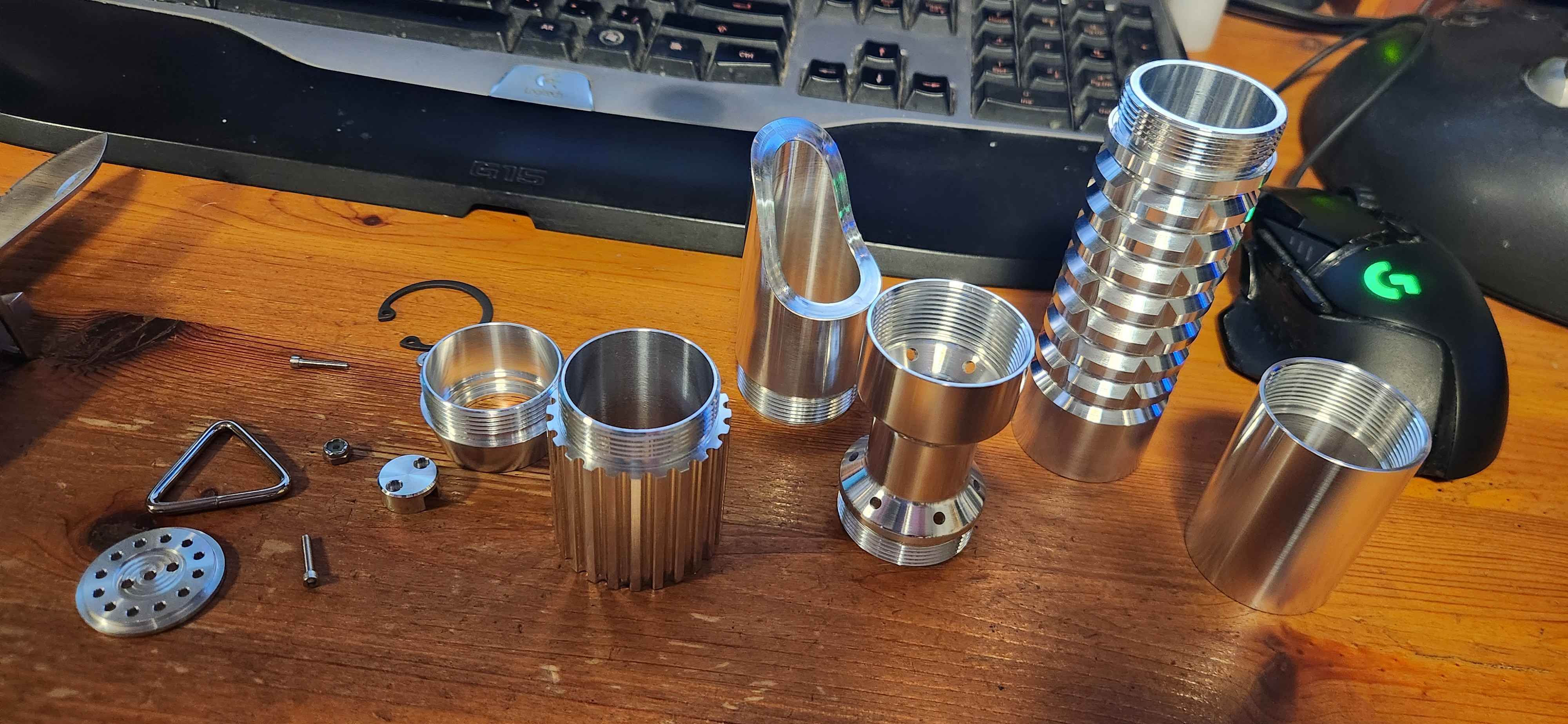

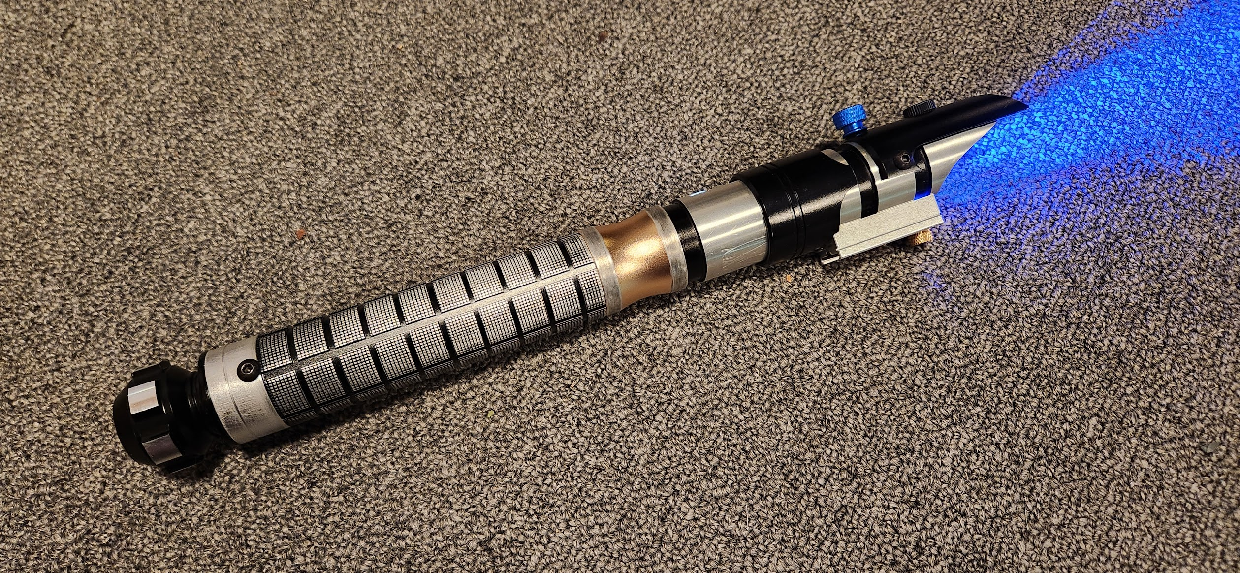

Starting a new TCSS project build. This one is a little different as I was in love with the parts as is when I played around in the virtual builder. Now that I have it in hand I'm getting too many ideas on how I want to go with customizing it and installing it. I've built using TCSS before and been very happy with the results.
Starting a new TCSS project build. This one is a little different as I was in love with the parts as is when I played around in the virtual builder. Now that I have it in hand I'm getting too many ideas on how I want to go with customizing it and installing it. I've built using TCSS before and been very happy with the results. View attachment 1850281
Nice design. I was thinking about something like that too. I really liked the choke with the holes.

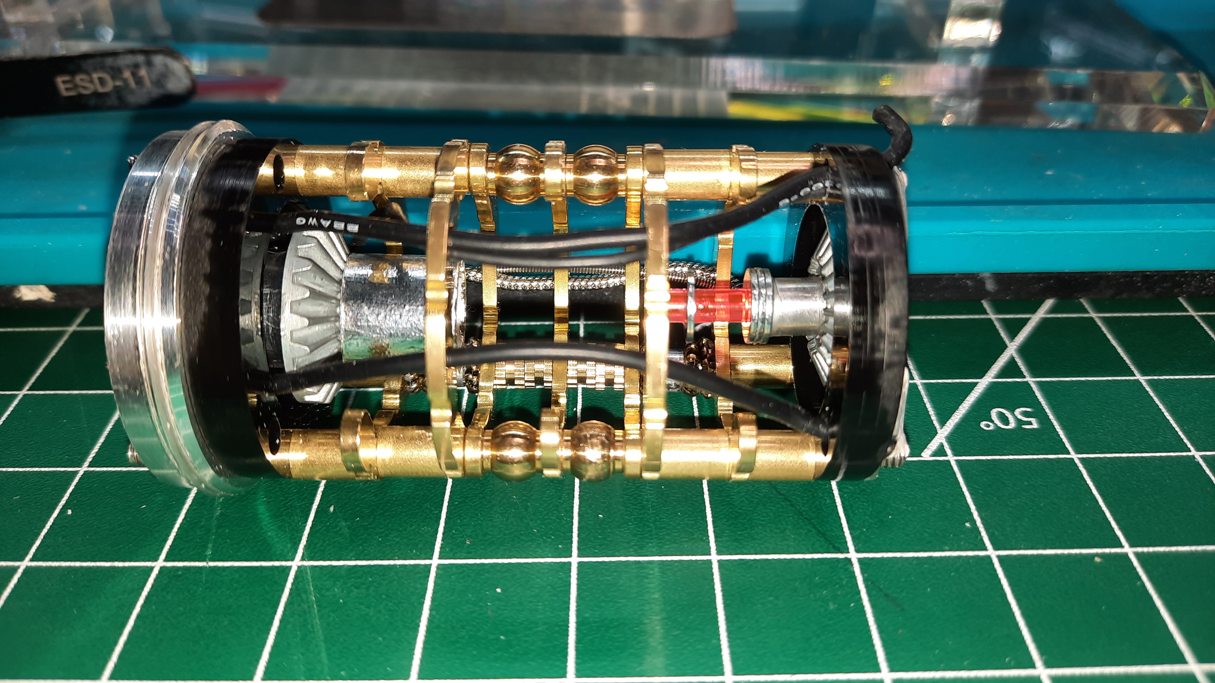

I just tried that, it went badly and ive now wasted $60 on something thats currently useless pieces... If someone else wants to have a go id be curious how it goes but as it stands theres a couple problems:
-Its *chonky*, I think about 7-8cm diameter?. It makes the acolyte sabers look a bit slim. Also quite heavy. I'm 5'2 so it looked ridiculous in my hand, a basketball player might be fine with it haha
-Getting the bits out of the shell was where it all went wrong, I misplaced the limit switch a teeny tiny bit and it disassembled itself on the first test. I'm still not sure I put it back together right.
-It seems a bit inconsistent? Every time i got it working it would work a few times and then start jamming till i disassembled/reassembled the blade. This is what fully killed the project. it may have been my error but im not sure.
My advice would be duct tape the black tube that holds the blade and the motor together right away so the motor cant pull out, maybe see if you can keep the plastic around the limit switch, and if you can find a better battery you can make it much more normal saber sized. It takes 4 AA batteries and thats where most of the bulk comes from, I assume there might be an equivalent lithium something or other. Alternatively go old school and hide a wire to the battery pack in your sleeve or separate into two 2 AA packs disguised as a graflex clamp. It seems like the blade and the worm gear are the most useful parts of this, if I had better modelling skill or a scanner I'd put them up on printables because its certainly not worth the price tag for those parts and the best bet seems to be integrating those into a better overall system. Honestly if anyone has good electrical knowledge and thinks they might be able to salvage the useful bits I'd be happy to send my sad graveyard of parts your way, it would be nice to get anything useful out of this failure.
