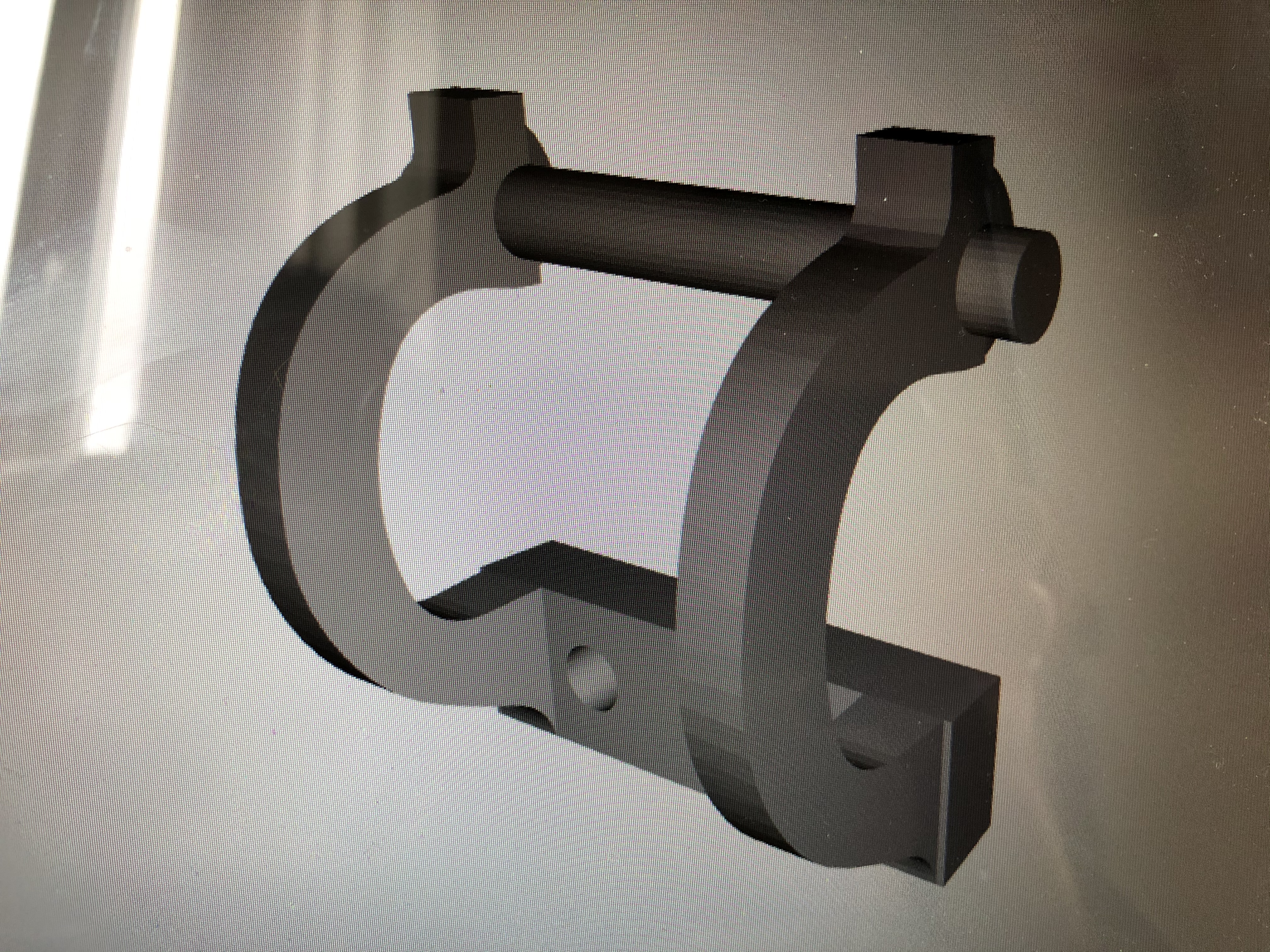

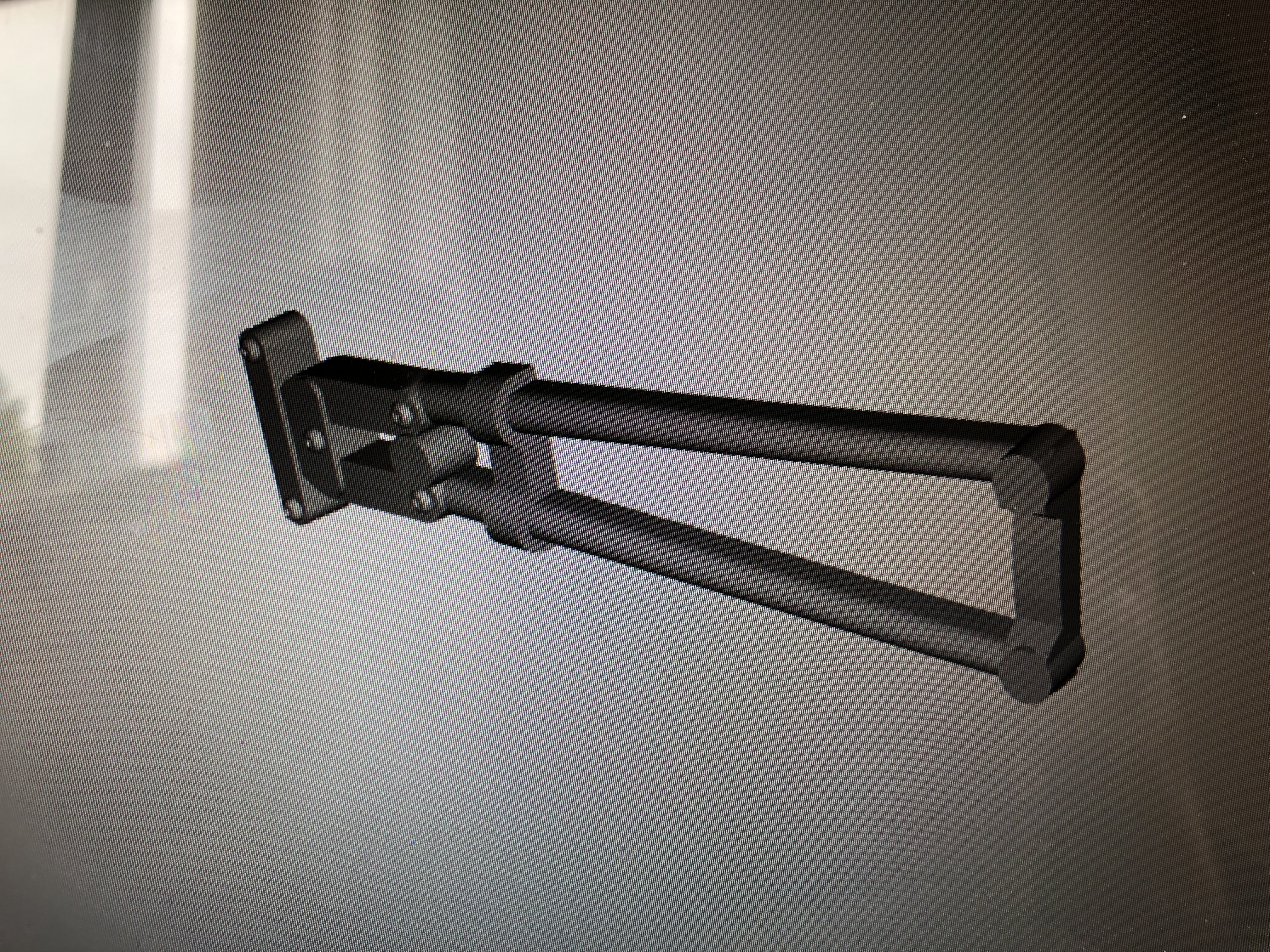

I had a go at replicating a Terrell P34 part that was used on the 32” Falcon ...I’ll be putting parts into the “32inch Parts” folder on my OneDrive....link: Attachments v
John

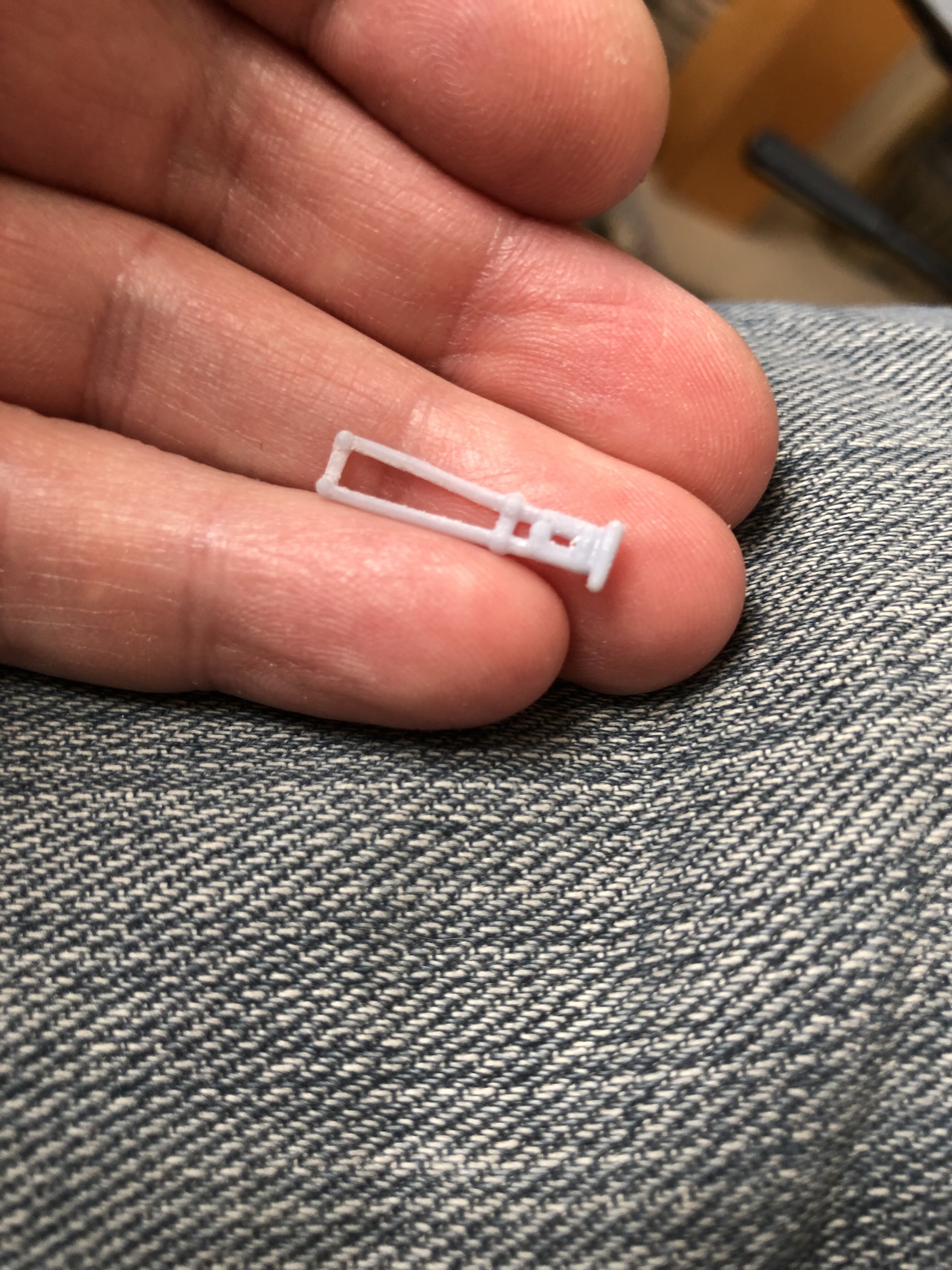

Thanks for making that folder, John. It's going to be invaluable when I make my Hasbro Falcon -- and hopefully I'll be able to contribute some details. What's your experience been printing really tiny greeblies on the Mars? I can't imagine being able to do something as small or delicate as the Tiger I wirecutters from the 5-footer's starboard mandible, for example.

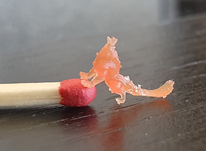

you will be amazed what resin printers can do :)

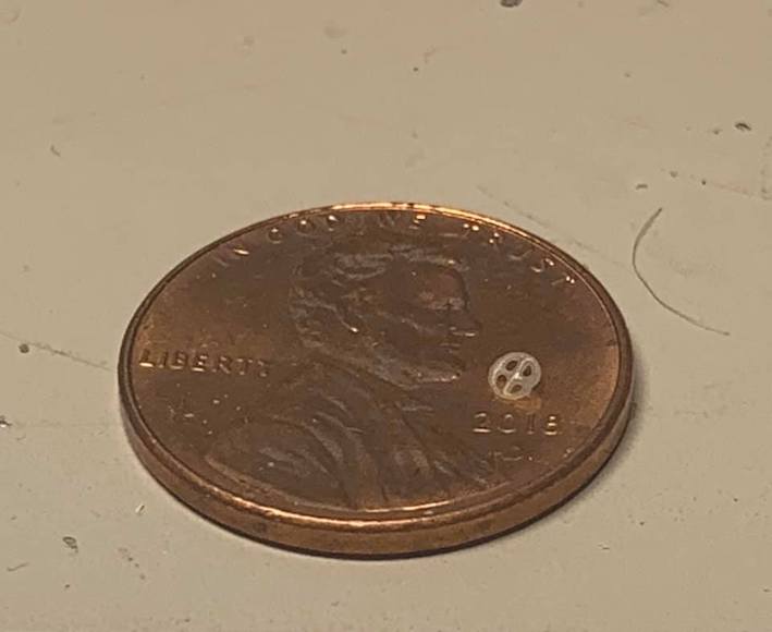

Yes! You've basically got the full pixel resolution of whatever LCD screen is in your machine, plus anti-aliasing, plus whatever your minimum layer height is. Tiny amounts compared to the 0.4mm x 0.2mm (or thereabouts) for FDM printing.

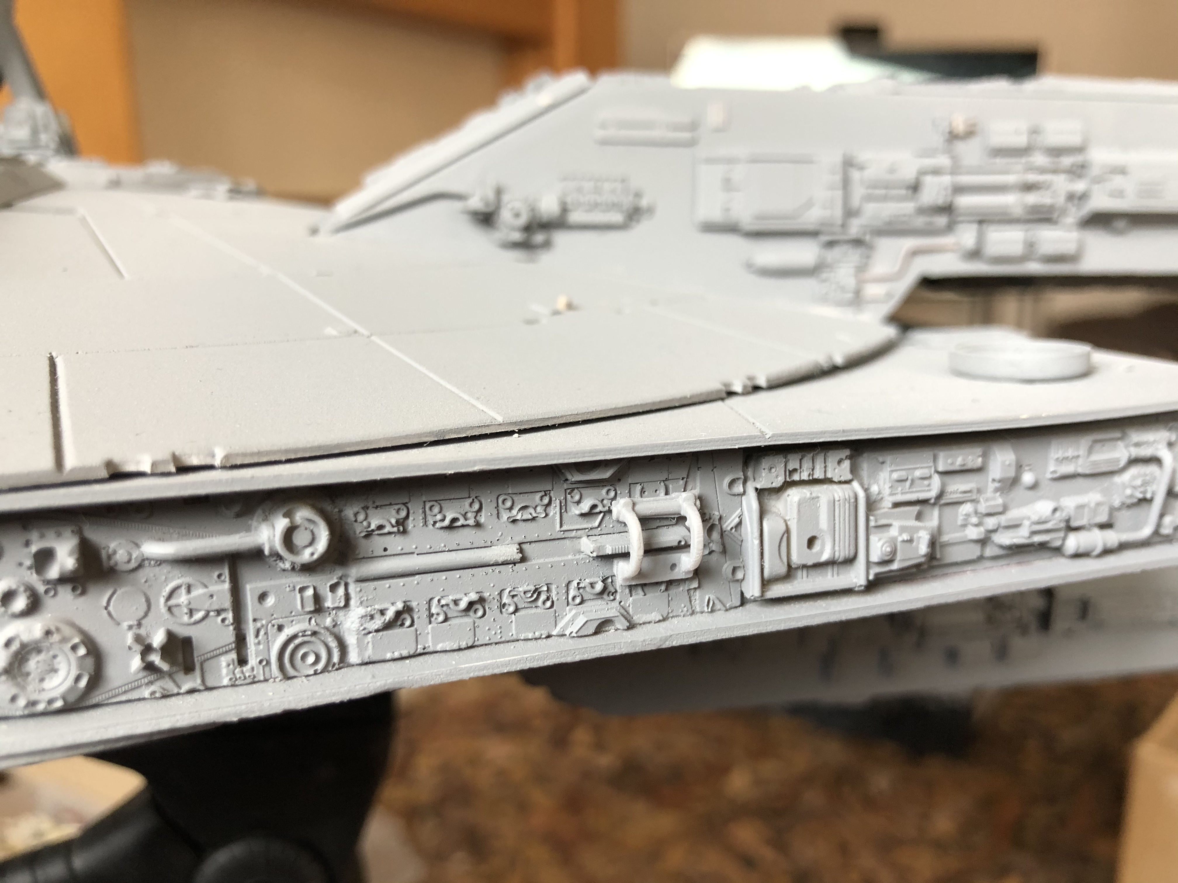

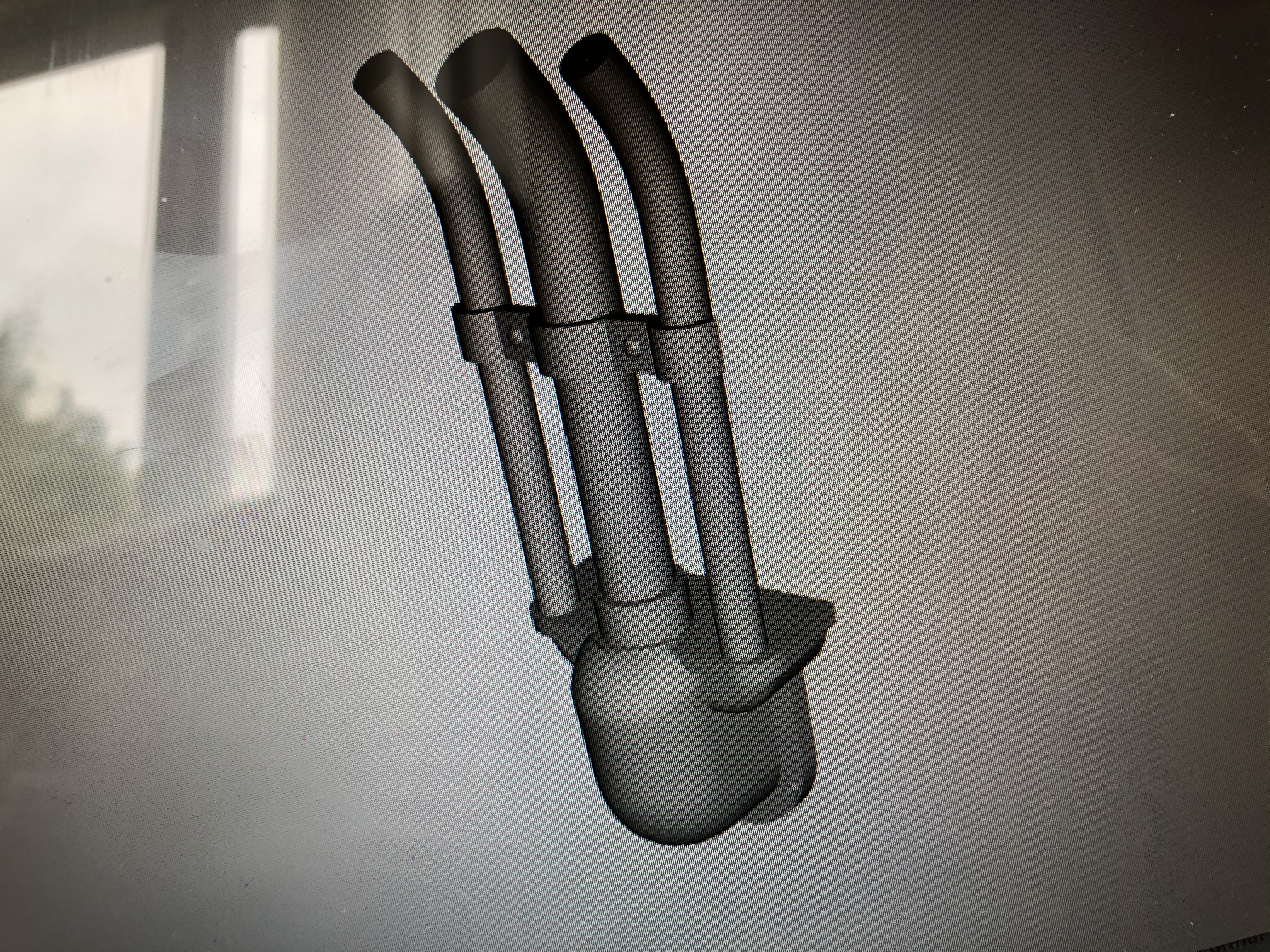

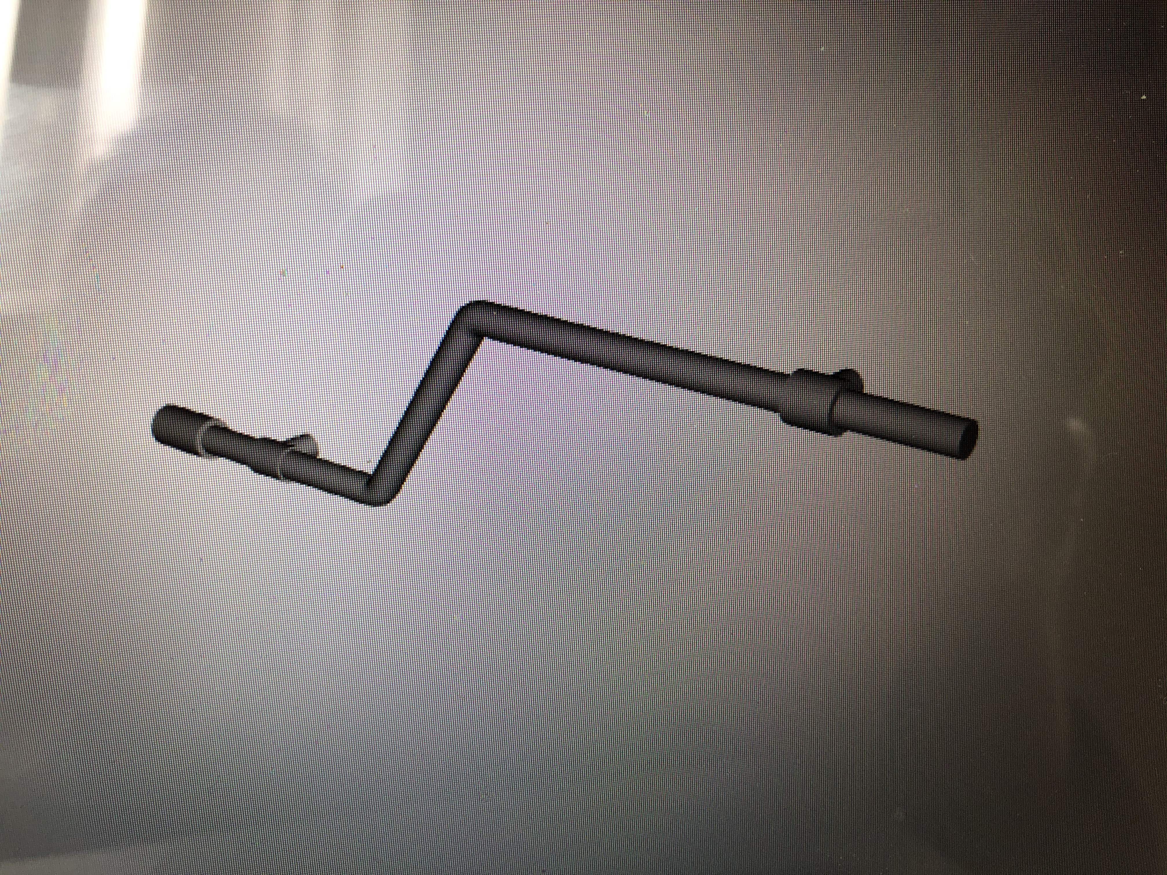

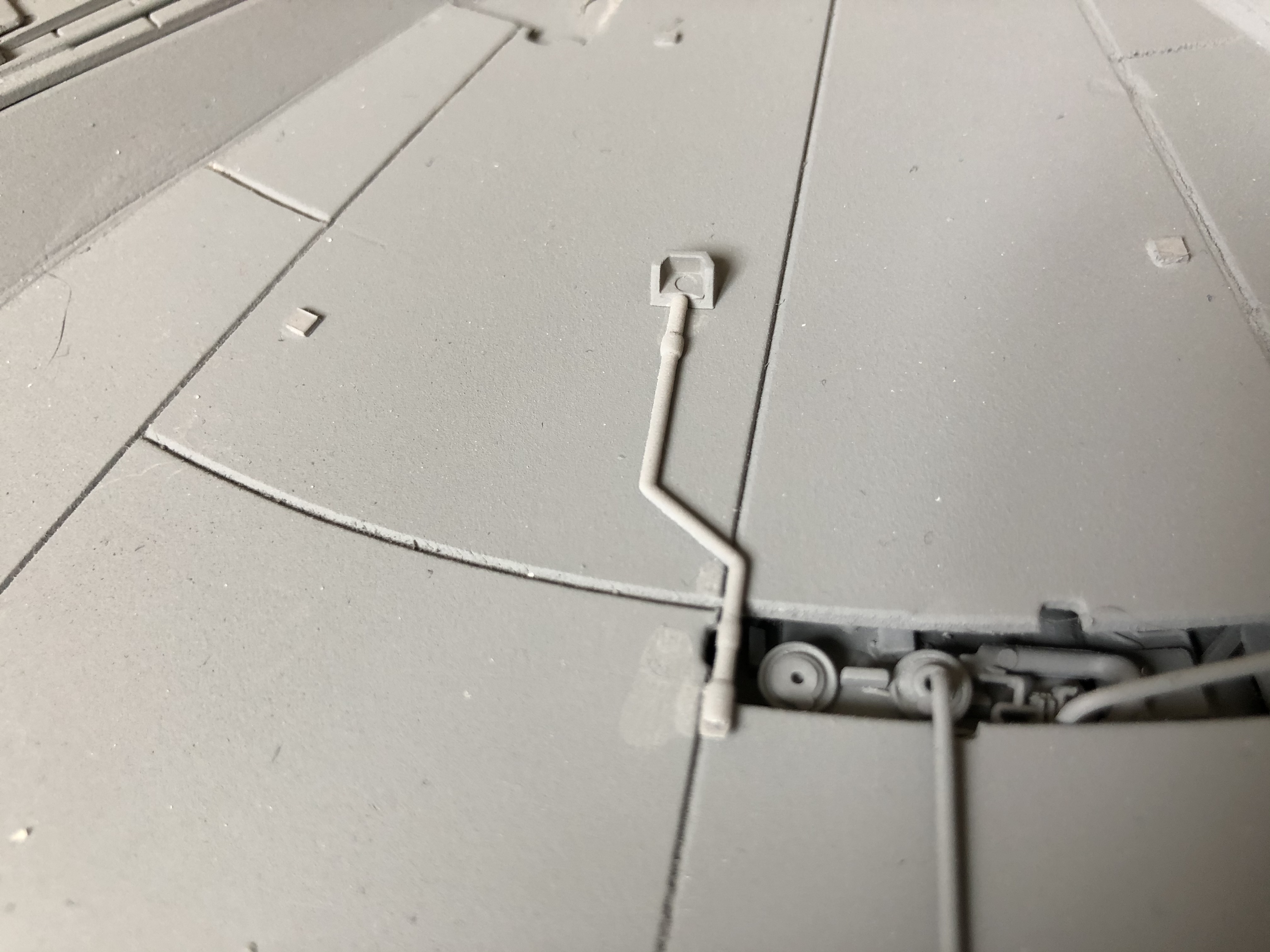

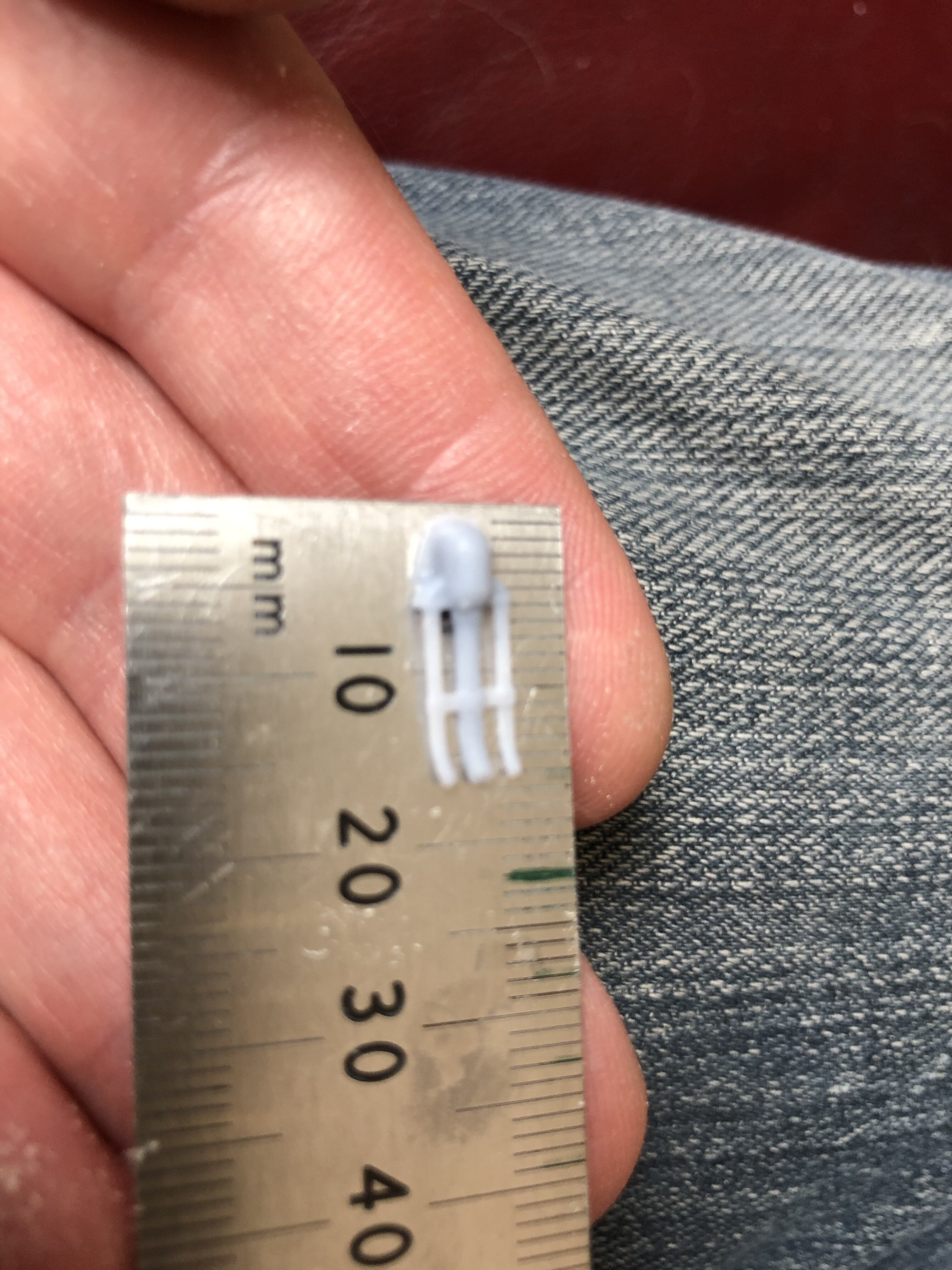

Yes I’m really happy with the printer in regards to printing out really fine small details
Heres some comparisons
View attachment 1298824View attachment 1298825View attachment 1298826View attachment 1298827
View attachment 1298828View attachment 1298831View attachment 1298829View attachment 1298830
John
Sweet baby cheesus! That is amazing! This is such a game changer. The time and money this will save on finding donor kit parts -- and just making multiple copies when needed -- is a revolution.
