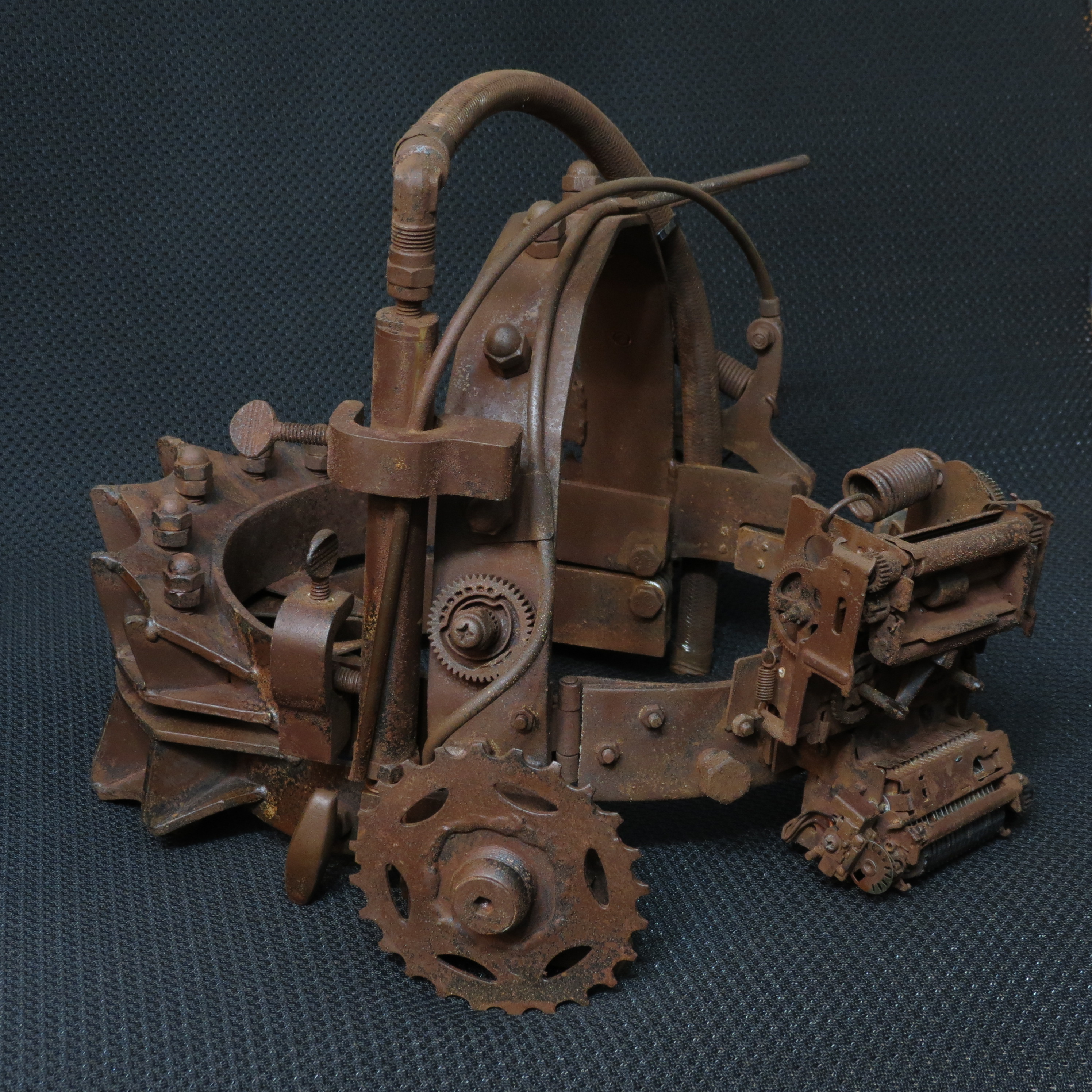

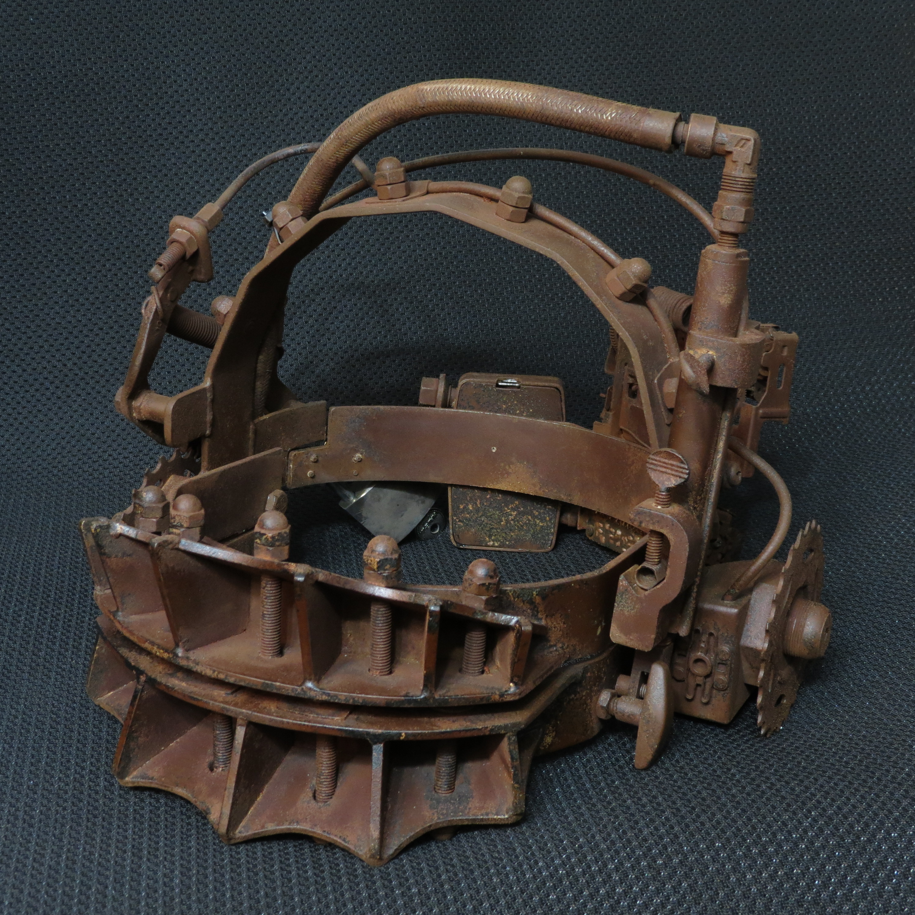

I wanted to try using oxidising paint, so I made this. It's 95% metal, mostly aluminium and is pretty heavy.I was able to source some of the correct detail pieces, the printer head on the rear was the best find as it would have been hard to duplicate. The bits I couldn't find, I made. The rusting paint is good to use but it's a dirty job prepping it before activating it.
I'm quite happy with the result and am thinking about making the MK.2 as a complimentary piece.

What a beauty! I keep saying I want to make one of these for a halloween costume one year. Dont think my neck could deal with a 95% metal one though, teehee. Well done!
Thanks! You would need a strong neck, yes. The good thing with that rusty paint is that you could make it out of any material and once painted it would look fine.

Thanks, many hours of googling found me most of the parts.The printer part actually comes from a mid 1970s' German printing calculator an MBO TRS 1300P or models either side of it. Mine was from an Olympia CA120, same era but with slight differences, a lucky Ebay find. The bicycle brake parts are copies of vintage MX style ones.The sprocket on the left side is from a 1996 vintage Shimano 6 speed freewheel. The other side is not as accurate, I couldn't find the right type(went through lots of freewheel sets to try) The things on the piston are retort stand clamps. All the other smaller detail parts and the stopwatch box I had to make. There are other easily available bits on it, like the braided hose on top and the pnuematic fittings. Hope this helps.

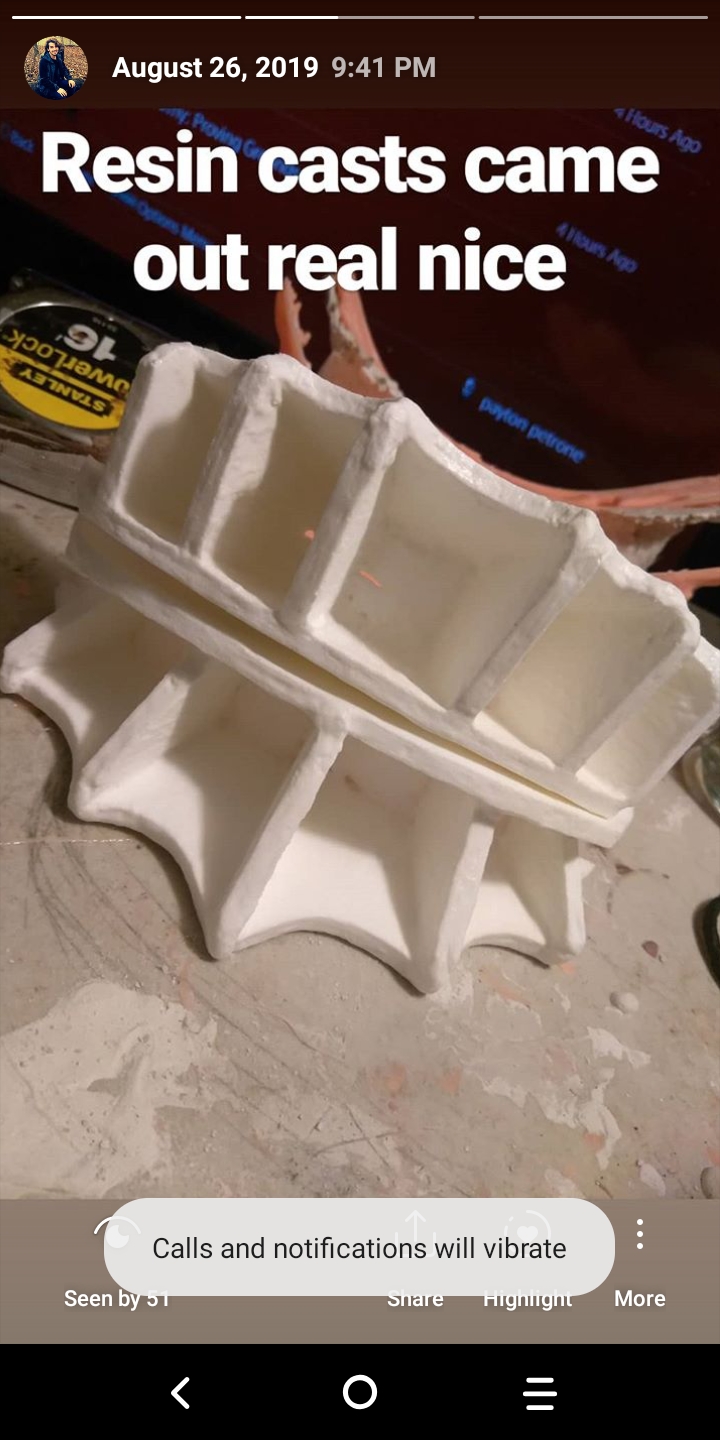

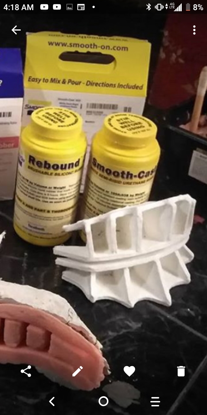

Whew! You have no clue how much this has helped me out,I found the MX bicycle breaks on my own,but this is spectacular!!! The printer pieces drove me crazy for months,I was thinking it was part of a cassette player lol!! I hope mine looks half as good as yours!. I'm doing mine in aluminum(some brazed on pieces) and doing certain parts in resin,but I'm trying to locate as many source parts as possible and this is a tremendous help! Again, amazing work!
