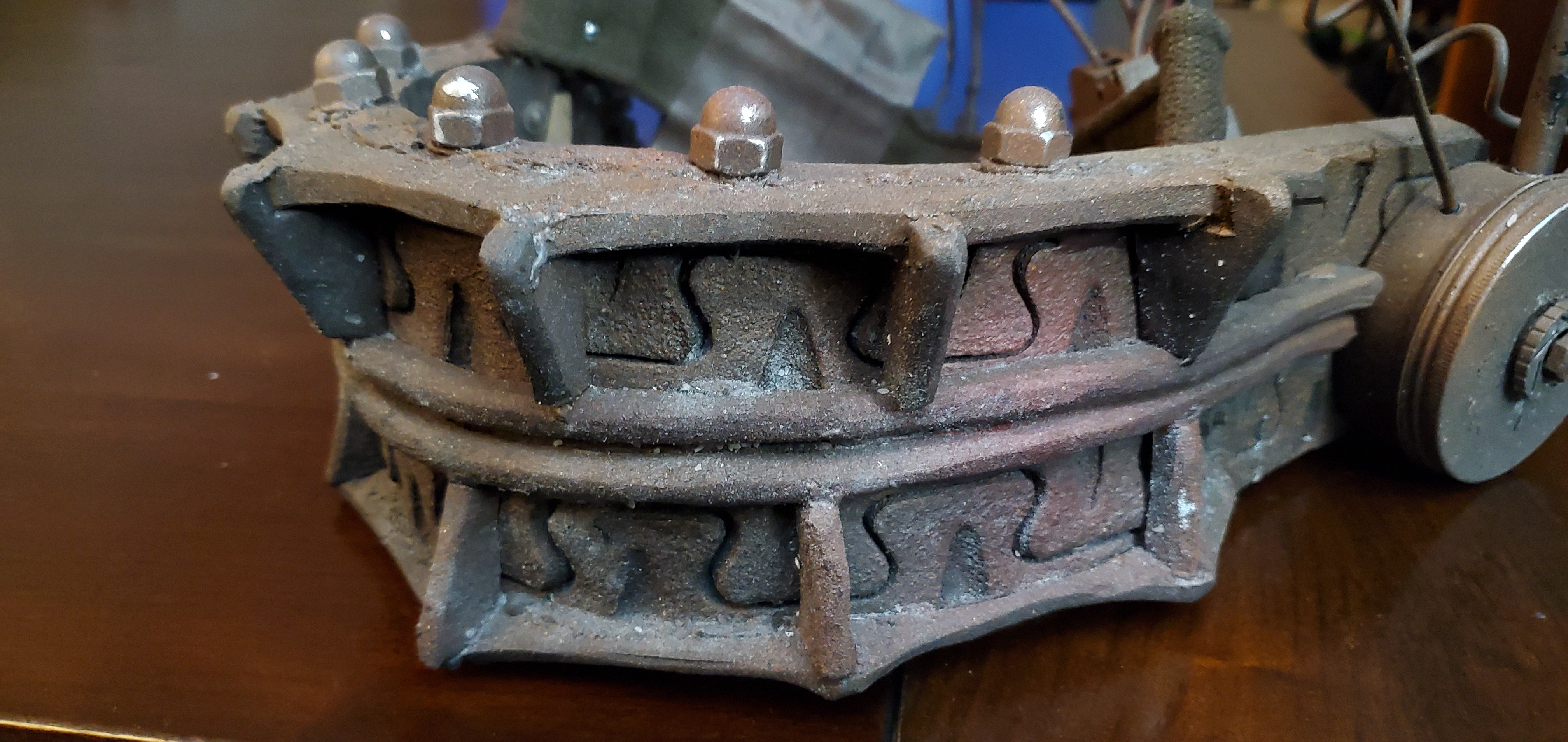

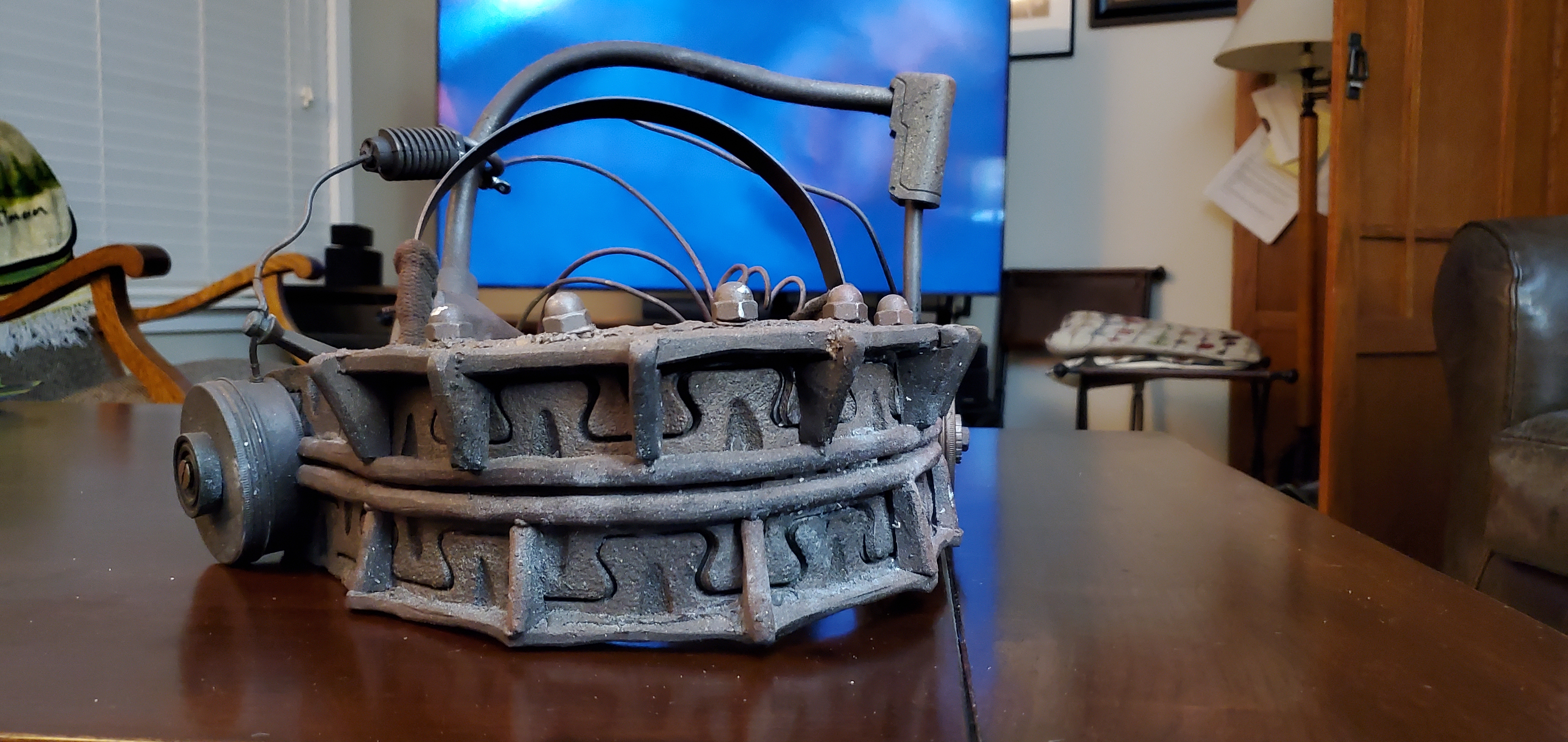

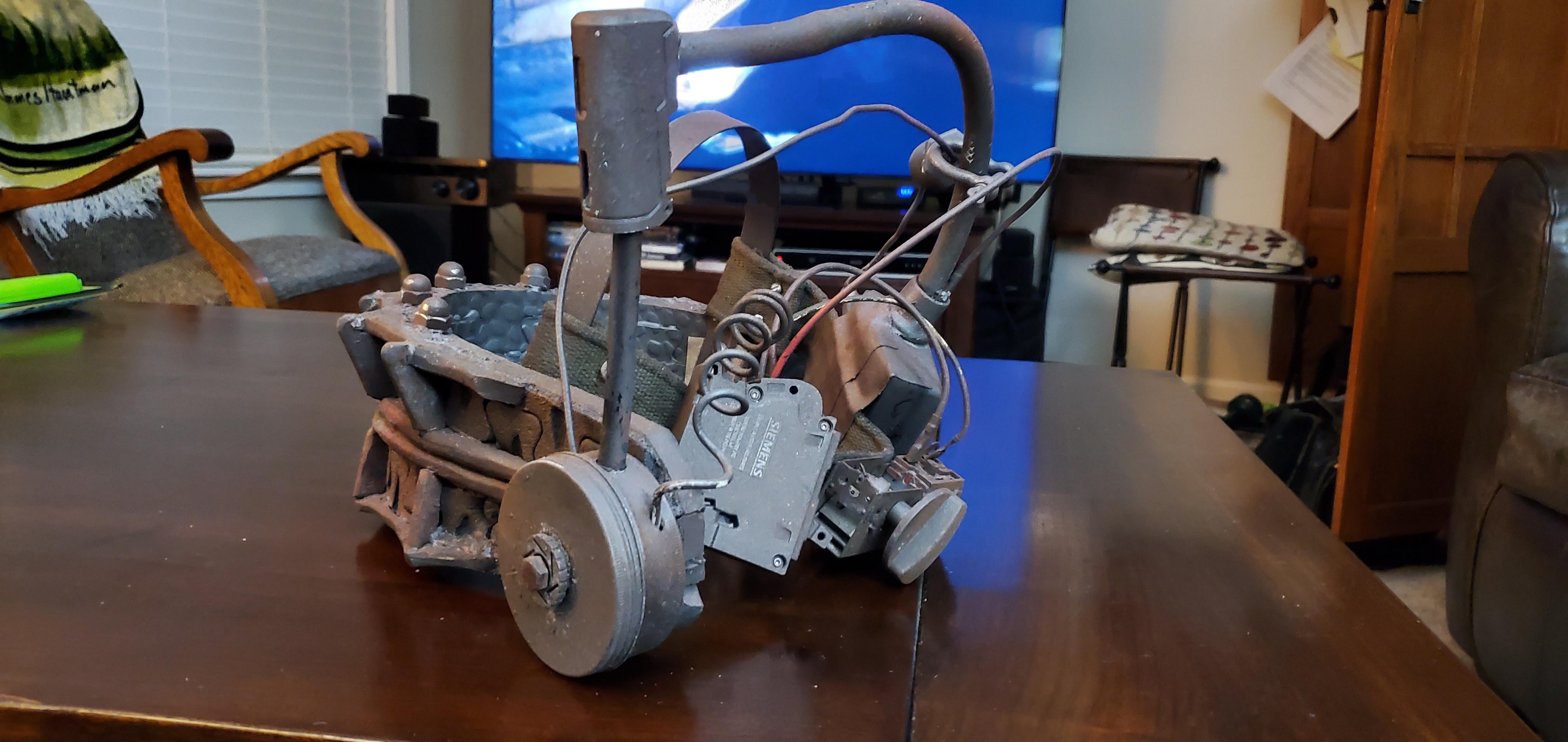

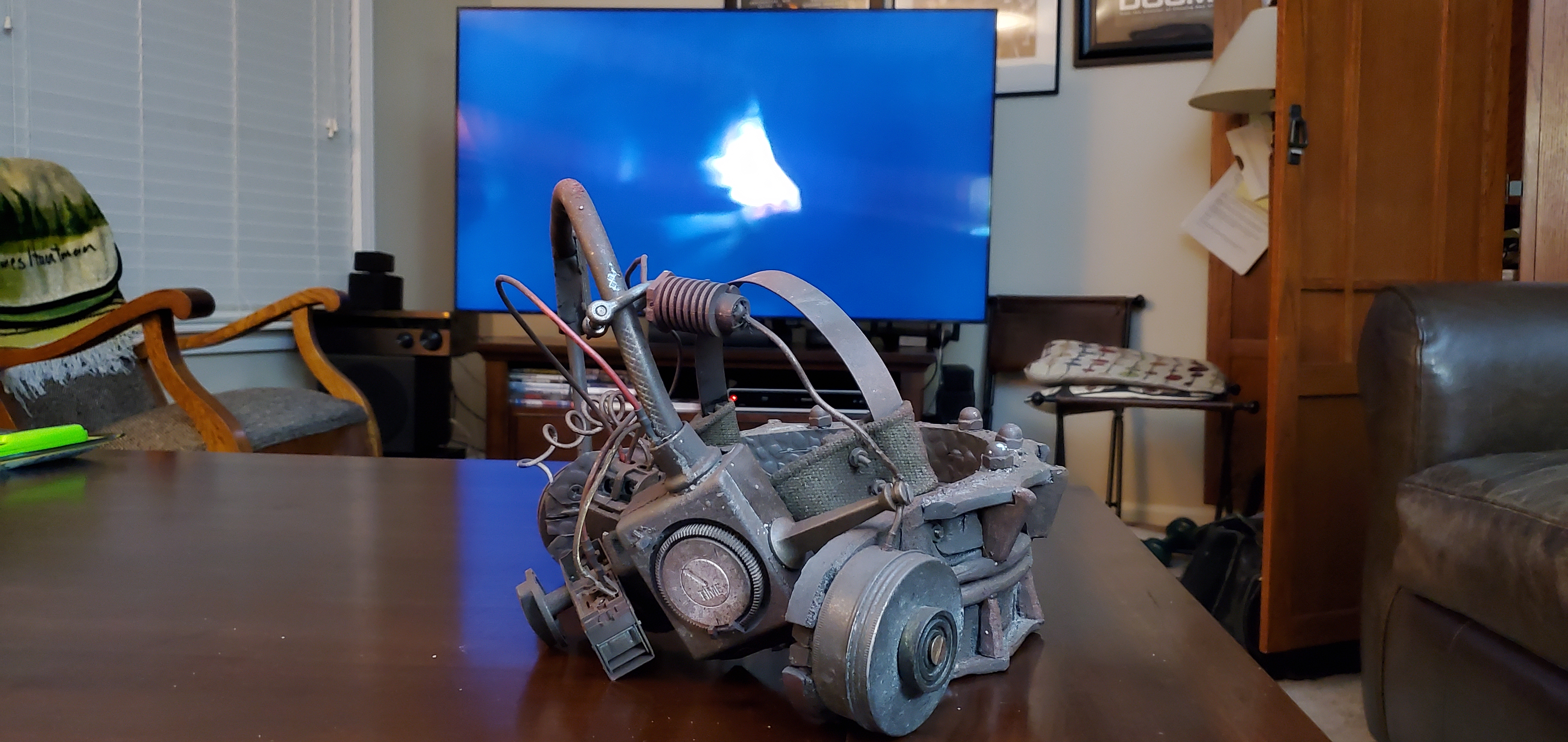

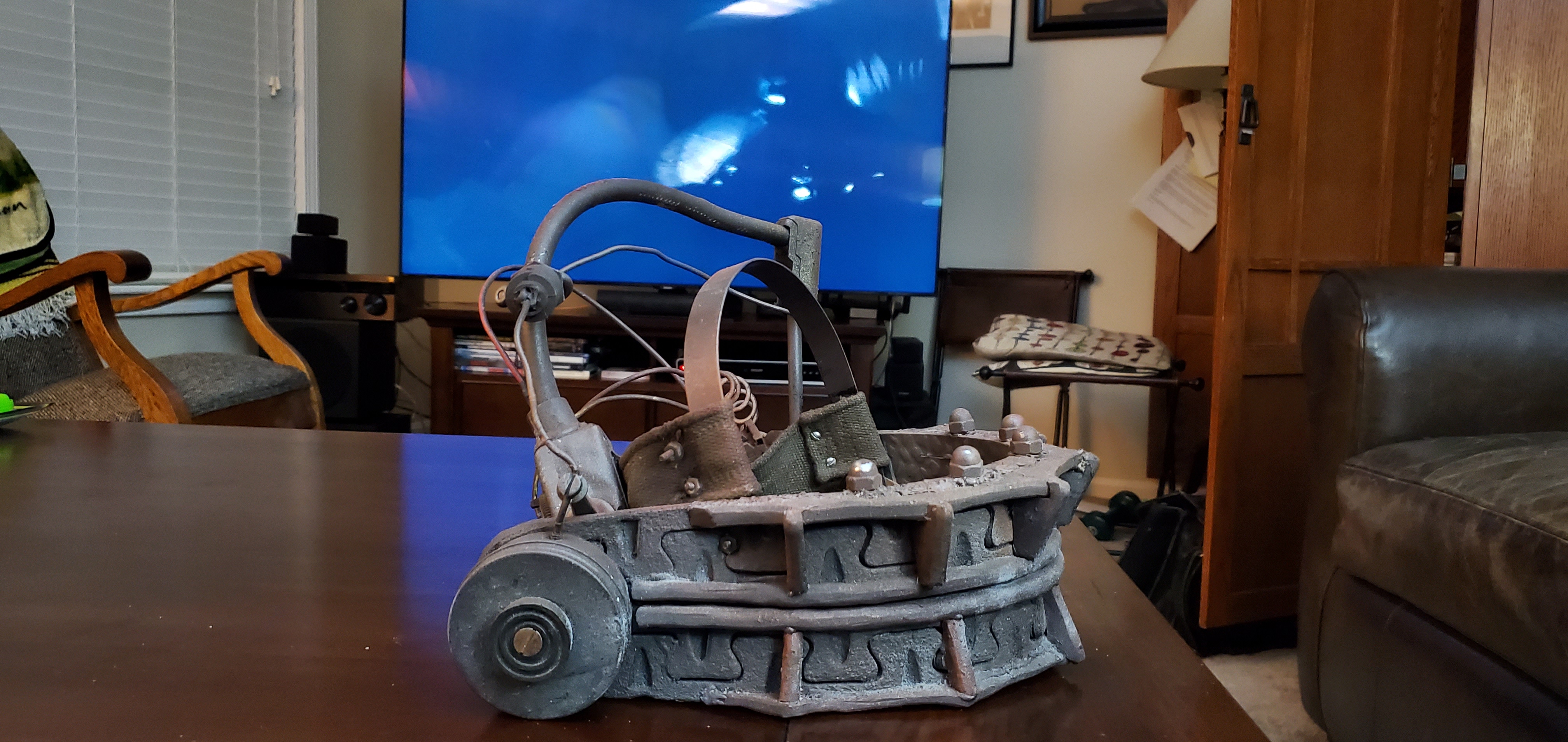

I wanted to try using oxidising paint, so I made this. It's 95% metal, mostly aluminium and is pretty heavy.I was able to source some of the correct detail pieces, the printer head on the rear was the best find as it would have been hard to duplicate. The bits I couldn't find, I made. The rusting paint is good to use but it's a dirty job prepping it before activating it.
I'm quite happy with the result and am thinking about making the MK.2 as a complimentary piece.

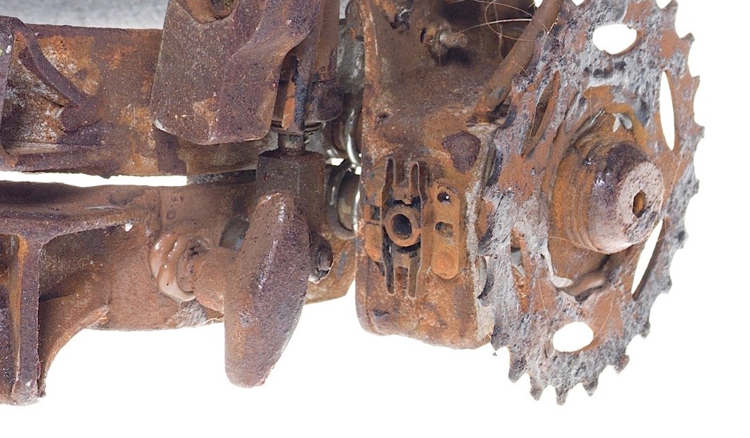

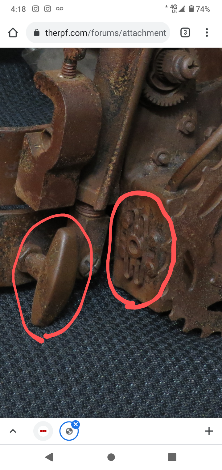

We're these circled pieces found parts or custom made? I've about got all the parts together,but these pieces are stumping me! Thanks again for sharing so much info! You're too cool and amazing job again on this,it's spot on!

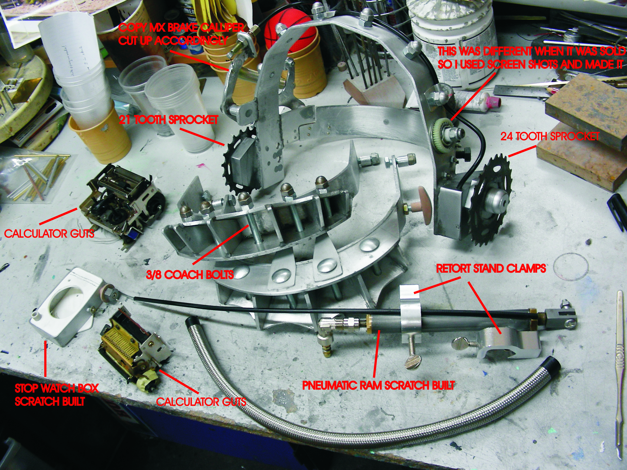

Thanks, I don't have a parts list per se, but I have this image that I did to name some of the parts, hope it helps. Some parts I made, the calculator parts were the hardest to find, I've added pics of the type needed. Hope it helps.
Thanks, the T handle thing I made as I could not find one the right size, it's got a threaded end and screws into place. The other piece again I made, I believe it's from the end bell of an electric motor but as before I couldn't pin it down to a real world item. Here's a close up of the real one, maybe you'll have more luck.

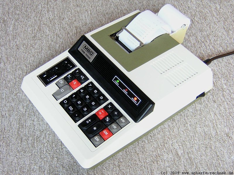

Thanks so much! can't wait to finally get on building mine. Still trying to find someone to ship me an MBO TRS1300p (thats the correct model right?) calculator from the foreign ebays lol such a pain, but i should be able to start after i receive that.
View attachment 1463676View attachment 1463677View attachment 1463678
Thank you for the reply. These images would definitely help. Not sure my skill set will allow me to do this, but might try. The main metal parts, is that all thick aluminum? How did you connect everything? Dumb question, but can that be welded?
I think you could use other models, the 1000 or the 1400. I actually used an Olympia CA120 but had to fabricate one piece to make it more accurate, other Olympia models may work like on the MBO ones, a look inside would be helpful before buying though.
Mine is all aluminium, this can be welded yes, but that's a skill I don't possess, so I pinned and screwed mine together and used JB Weld to simulate the welded areas.

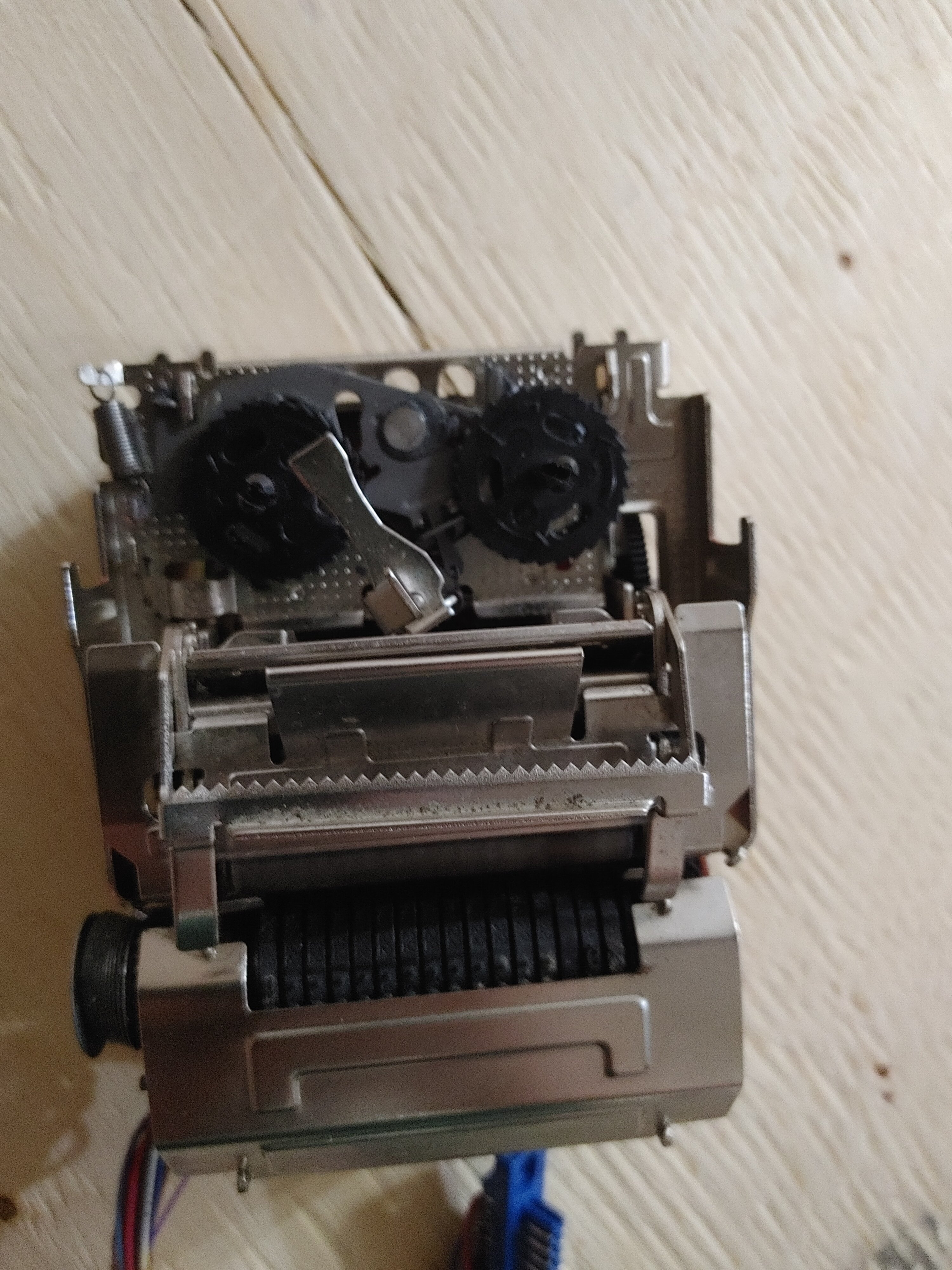

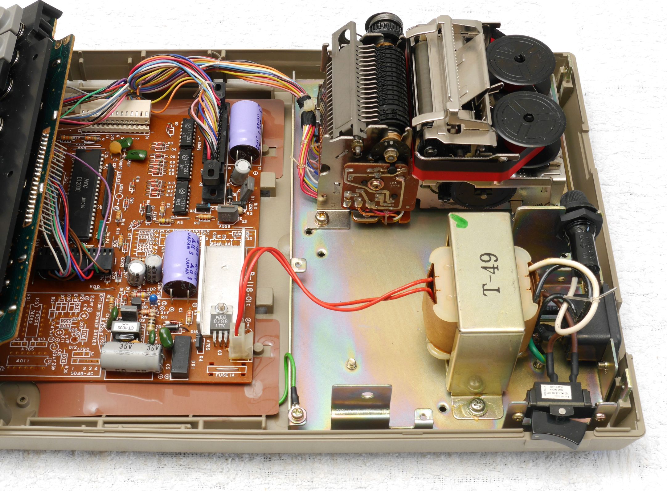

The calculators of the type required come up on ebay every now and then, but it really helps to see the insides first to confirm the correct inner workings. Good luck.
