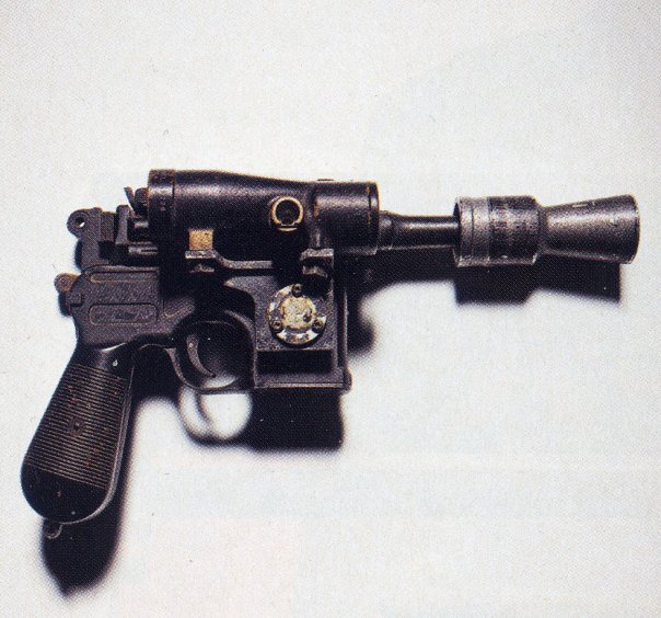

guys i received boba's email about the final scope machining pricing. i had a few final questions
1. which scope bolts does han's bespin blaster have? standard or thick?
2. is han's bespin blasters light ring notched? or a full circle?
im going to go through this thread once again and try and find it, but i figured if i asked someone who knew off the top of their head could probably answer faster then me reading through the whole run.
thanks in advance!
judging by this picture in bobas greeblie thread
http://www.therpf.com/attachment.php?attachmentid=413118&d=1418005774
it looks as though hans bespin live fire has a full ring on the light socket, im still not sure about the scope bolts? in this picture are those bolts standard or thick?
To me the front piece of hardware looks like a Philips screw that had a heavy coat of paint.
The back piece of hardware has always intrigued me, its round but seems to have a flat top.
I think we should go with an idealized version and go with the counter bored pocket and use the same screws that are in the center of the pistons.
That way you can use techniques to achieve the desired look, such as filling in the back screw to make it look flat and laying a thick coat of paint on the front screw to make it appear almost filled in.

Good questions !
I don't know the specific details that well either but I am eager to replicate them correctly.
Is this right ?
Luke Bespin: Larger front bolt. Scope Notch.
Han Bespin: Normal Bolts. No Scope Notch.
Hoth (version): Larger front bolt. Scope Notch
Please correct me if im wrong.
Thanks

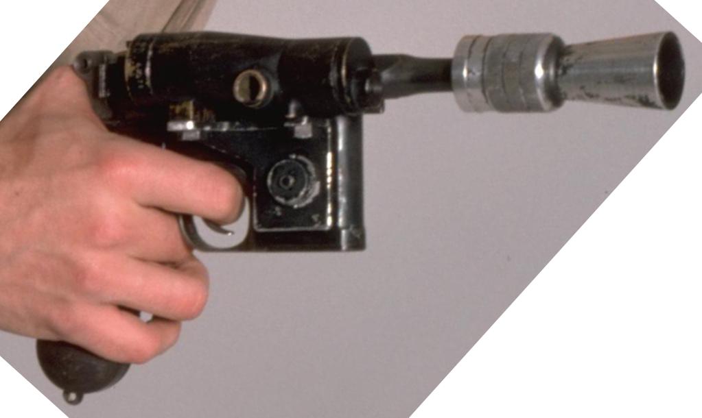

I think that Luke Bespin and Han Hoth have larger front bolts.
Han Hoth
Luke Bespin
