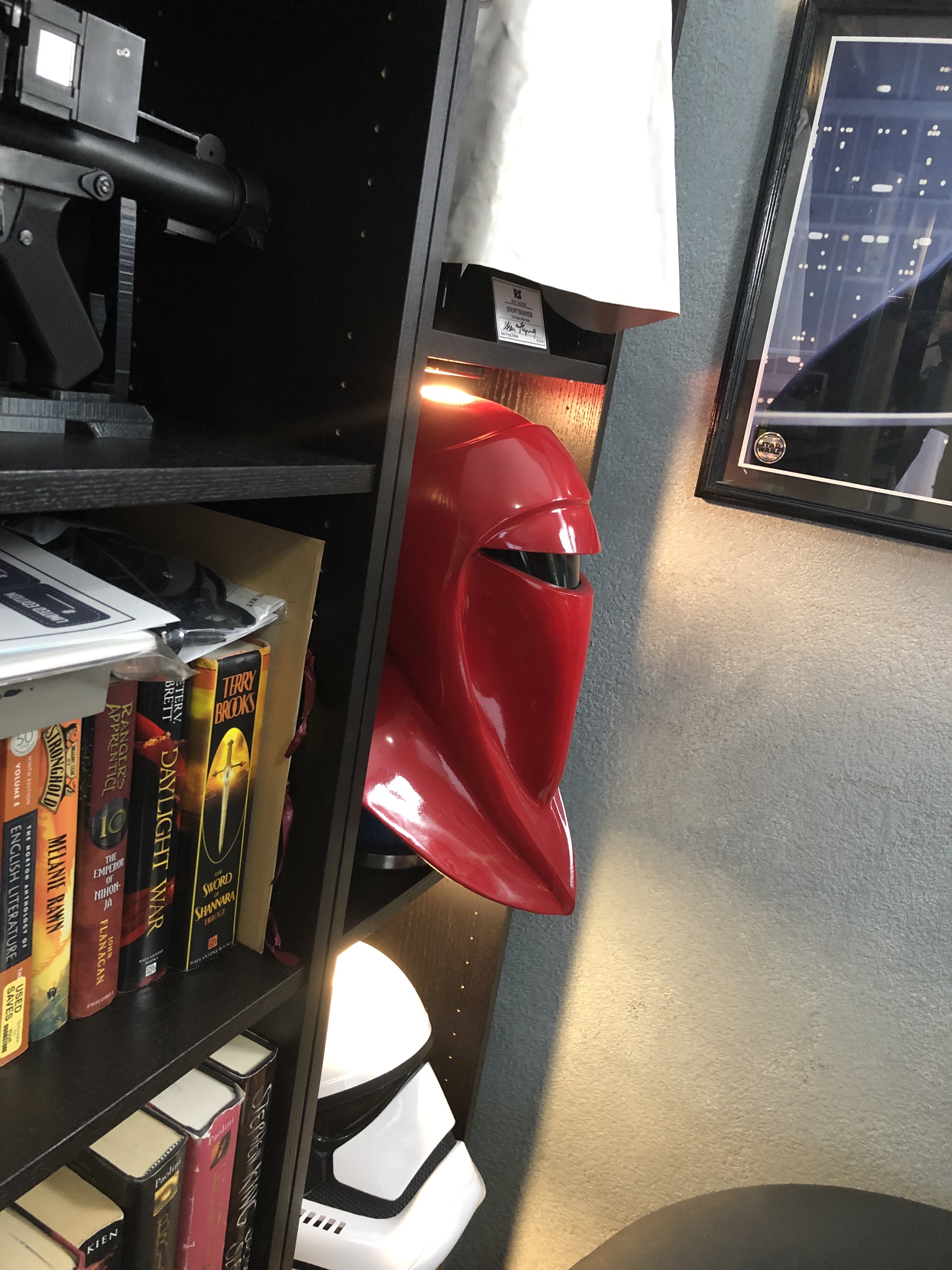

I absolutely LOVE my Rubies RG. I agree, everything else they ever made is crap, but this one piece is quite nice. Sturdy fiberglass, excellent paint job. It is a bit thick in the visor area and I've seen people mod that part to make it more accurate but mine is display only so I never messed with it. It is deeper than the DP. But again, for me that's not an issue as it sits in a display shelf.
