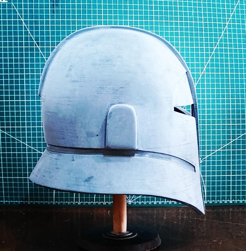

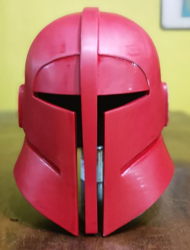

So I downloaded it and fired up my trusty workhorse, the Anycubic Mega X. I split the model vertically right at the centre so I can print it in two halves (to cut down on printing time) and printed them without centre support.

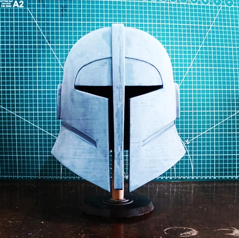

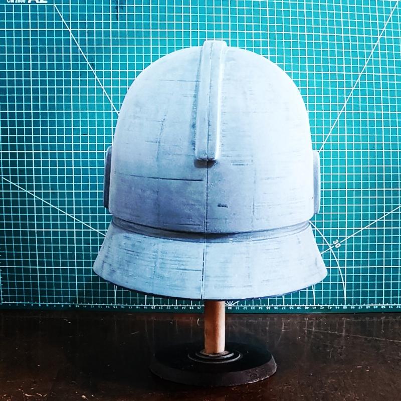

Once printed, I glued the two halves together. This was taken after I sanded the layer lines down with an orbital sander.
After a few rounds of filling, sanding and priming, it was ready for the base coat.

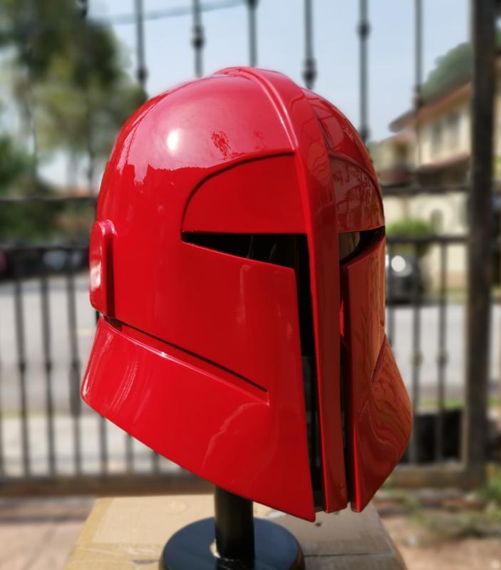

I used a color called Monza Red but it ended up looking a tad dull for my liking.
So I sanded it down and reprimed.

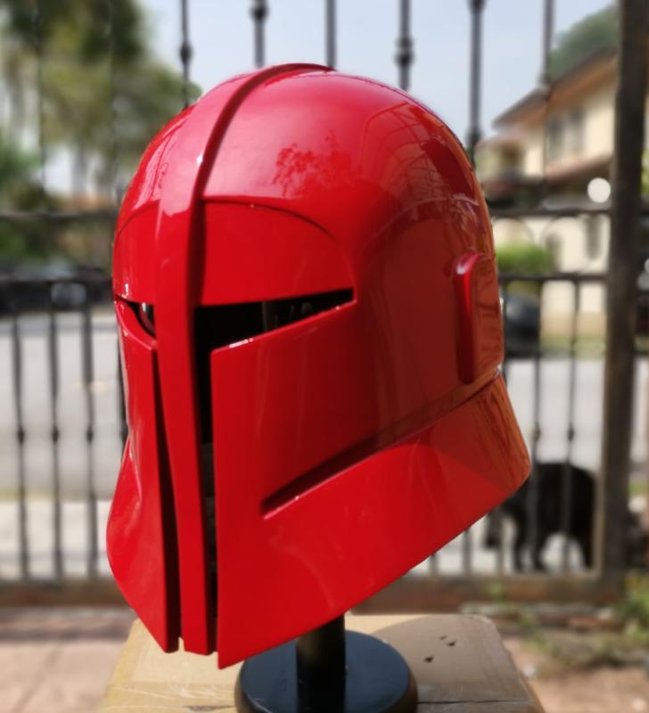

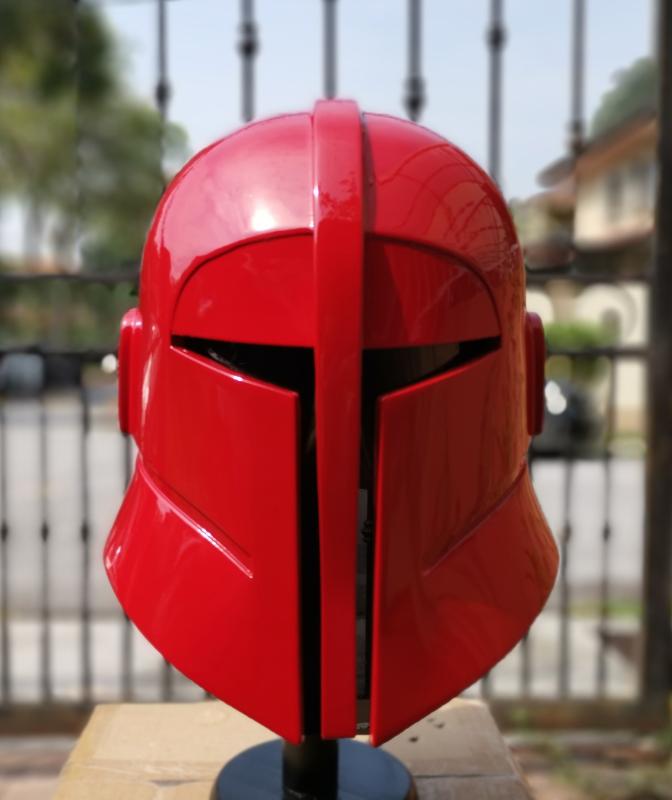

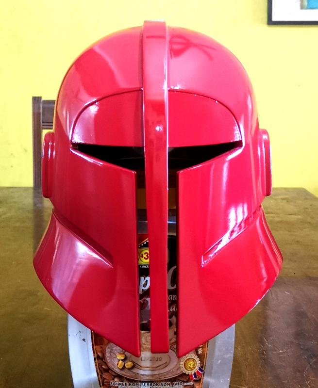

I used another shade called Signal Red and I thought it looked way better. A 1K gloss clear coat made it super shiny. I added a visor made from a thin plastic sheet with 5% auto tint. Here's the completed helmet.
There are more accurate paid files out now (Great Ape just released one) but for now I'm happy to add this to my collection of helmets.

Nice finish! Which 1K clear are you using? I had a can of (I think) Duplicolor that I tried once that wouldn't fully cure.
Probably moving to spray guns this year, but still exploring every avenue...
I used a popular brand here in Southeast Asia called Samurai, but I doubt you'll be able to get it Stateside. I had initially wanted to use 2k clear but because I only had ONE helmet to clearcoat, it would be a waste since the can is only usable for about 36 hours. But I like the 1k as it gives off almost the same wet gloss look as 2k... I'll probably use it for my future helmets.
