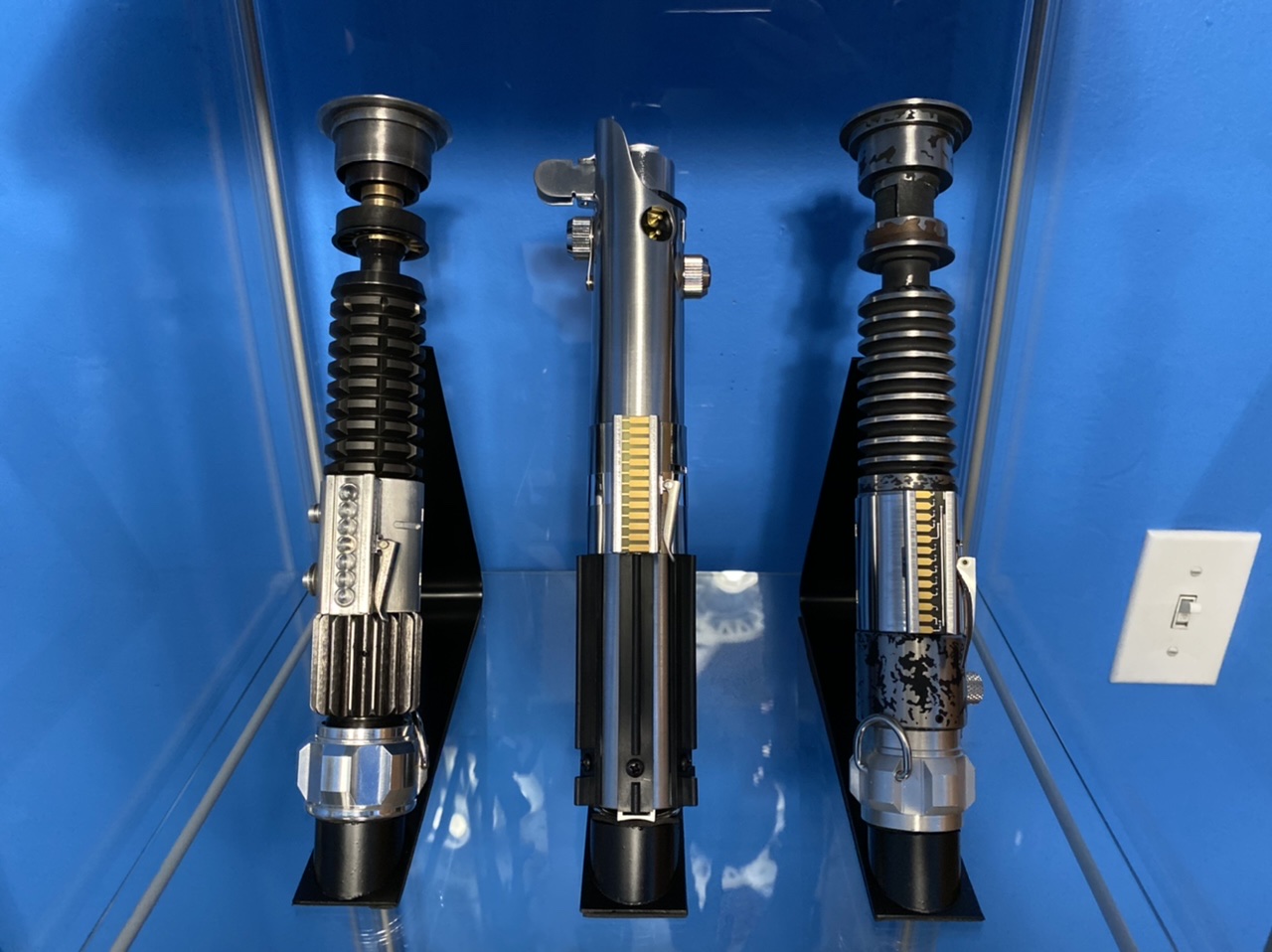

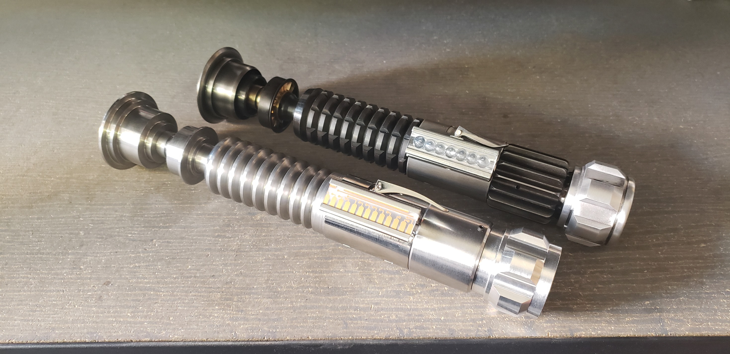

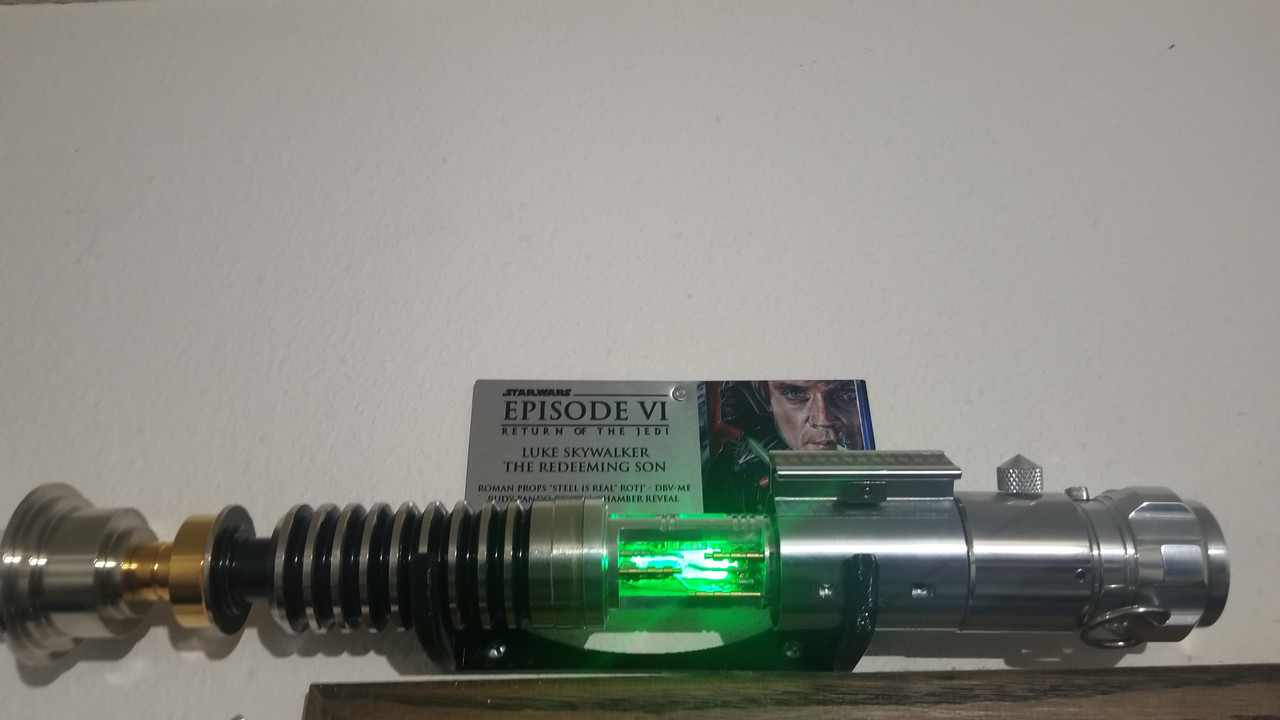

Thanks to a fellow RPF member I added Roman’s V2 to the collection today. It’s a thing of beauty. Here it is alongside my other Roman Props lightsabers.

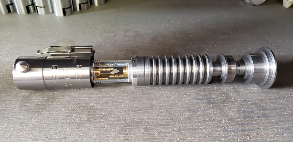

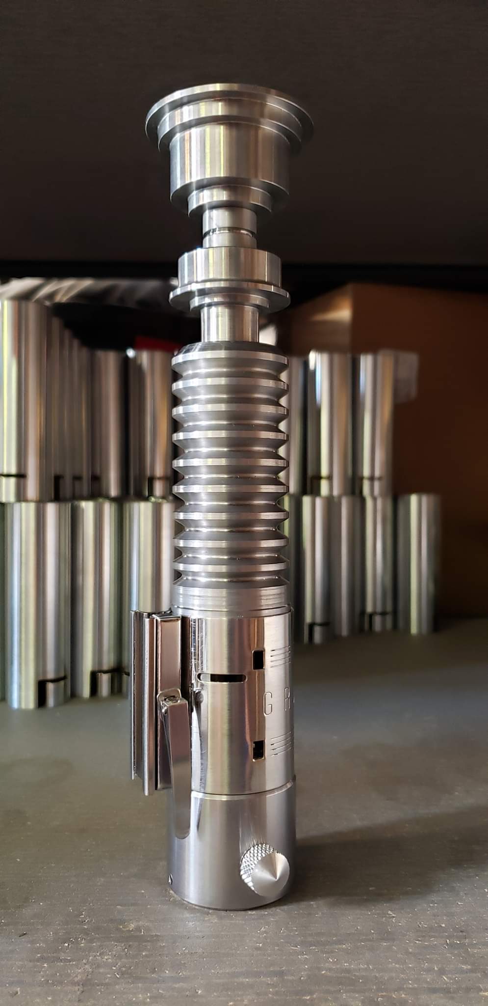

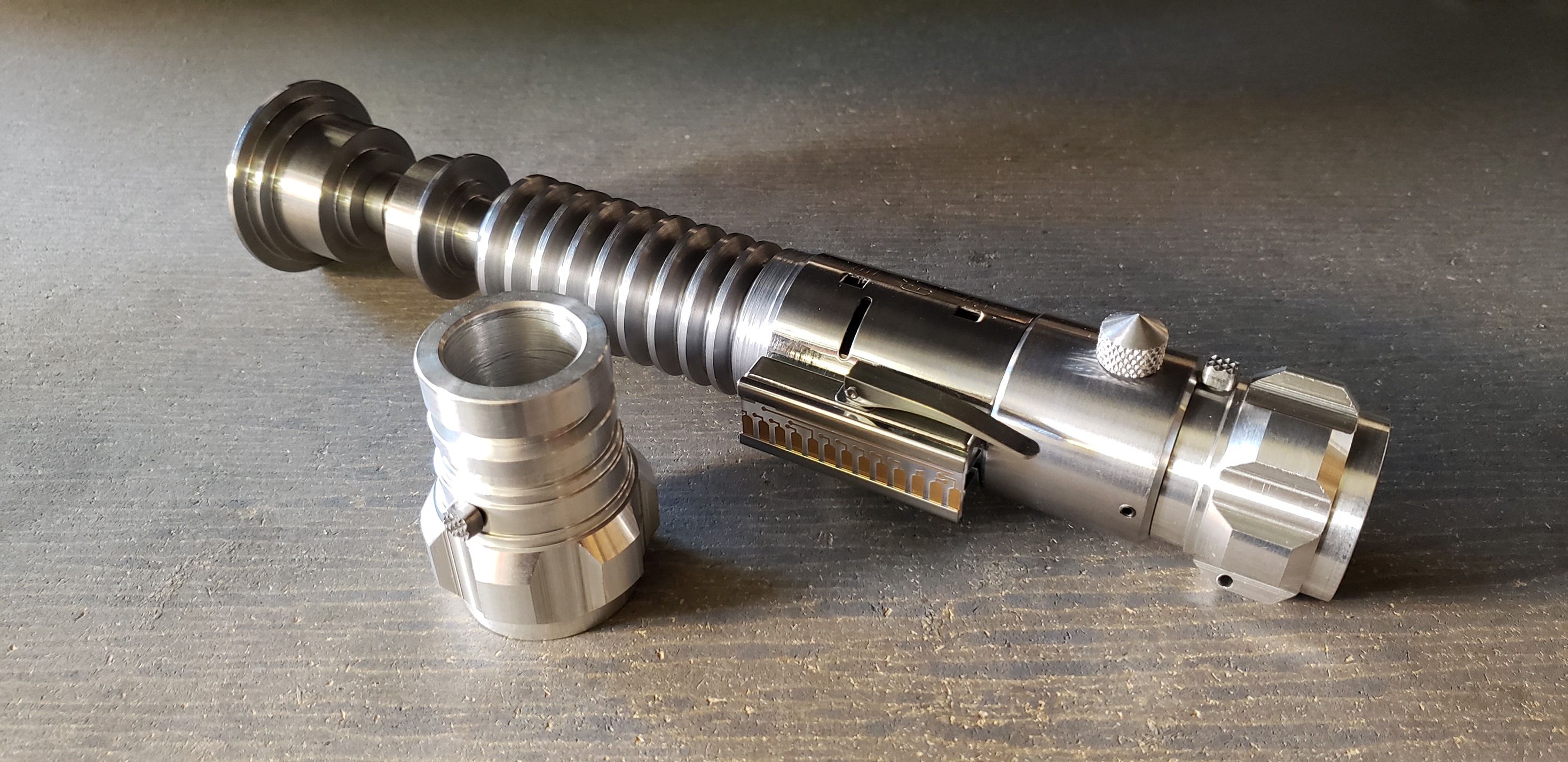

Hey Gang, so Roman has announced his Steel V2. Since its Steel and not aluminum i don't want anyone confused on weathering tips and tricks in my other threads, so Im starting this STEEL IS REAL thread now. here are some photos from facebook, and Rudys run thread.

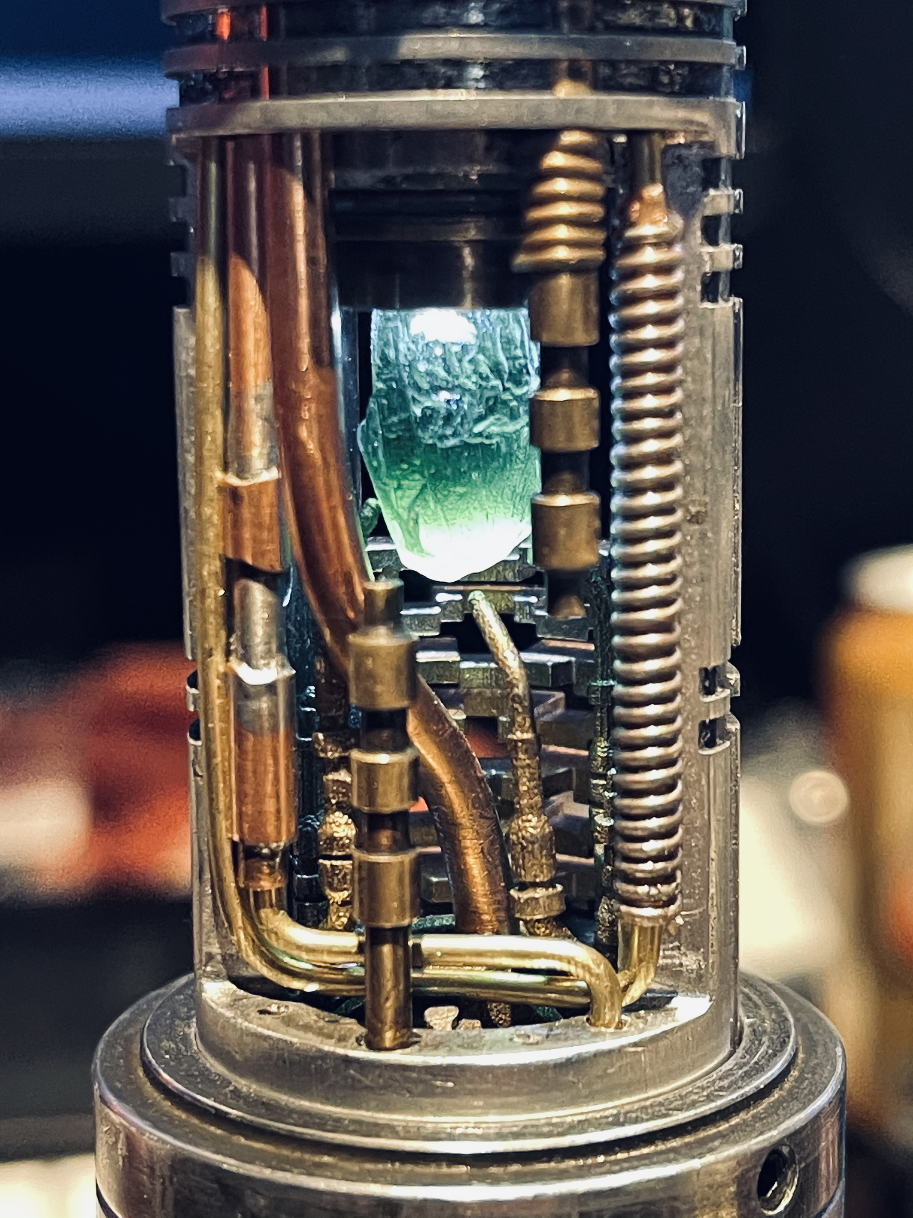

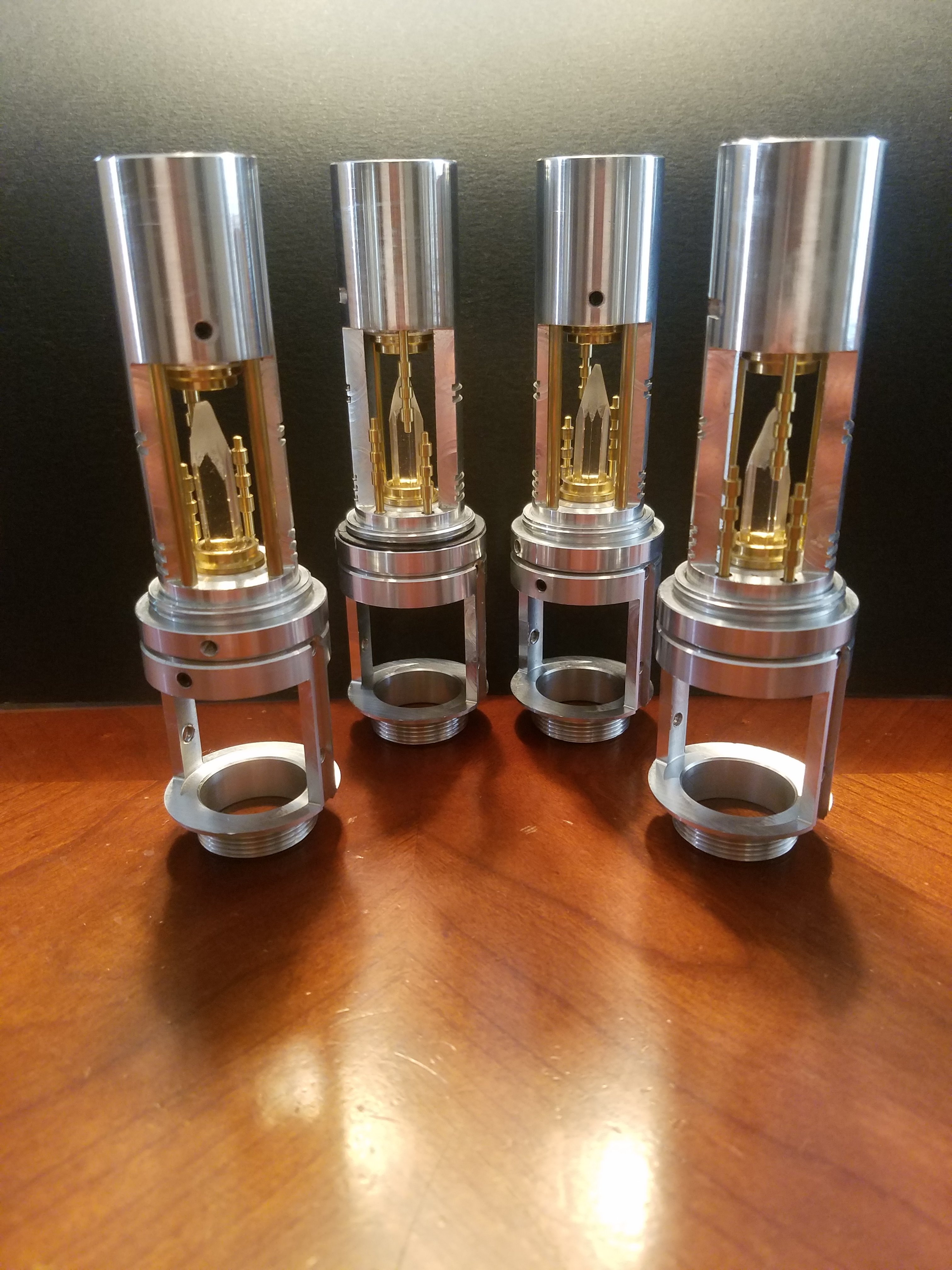

Don't have much info as of yet, but He posted a few pictures. Rudy is also doing one of his amazing crystal chambers for it! and has the run up live now!
I will eventually convert these first 3 pages into a aging tutorial, but for now we can discuss anything about it now in here

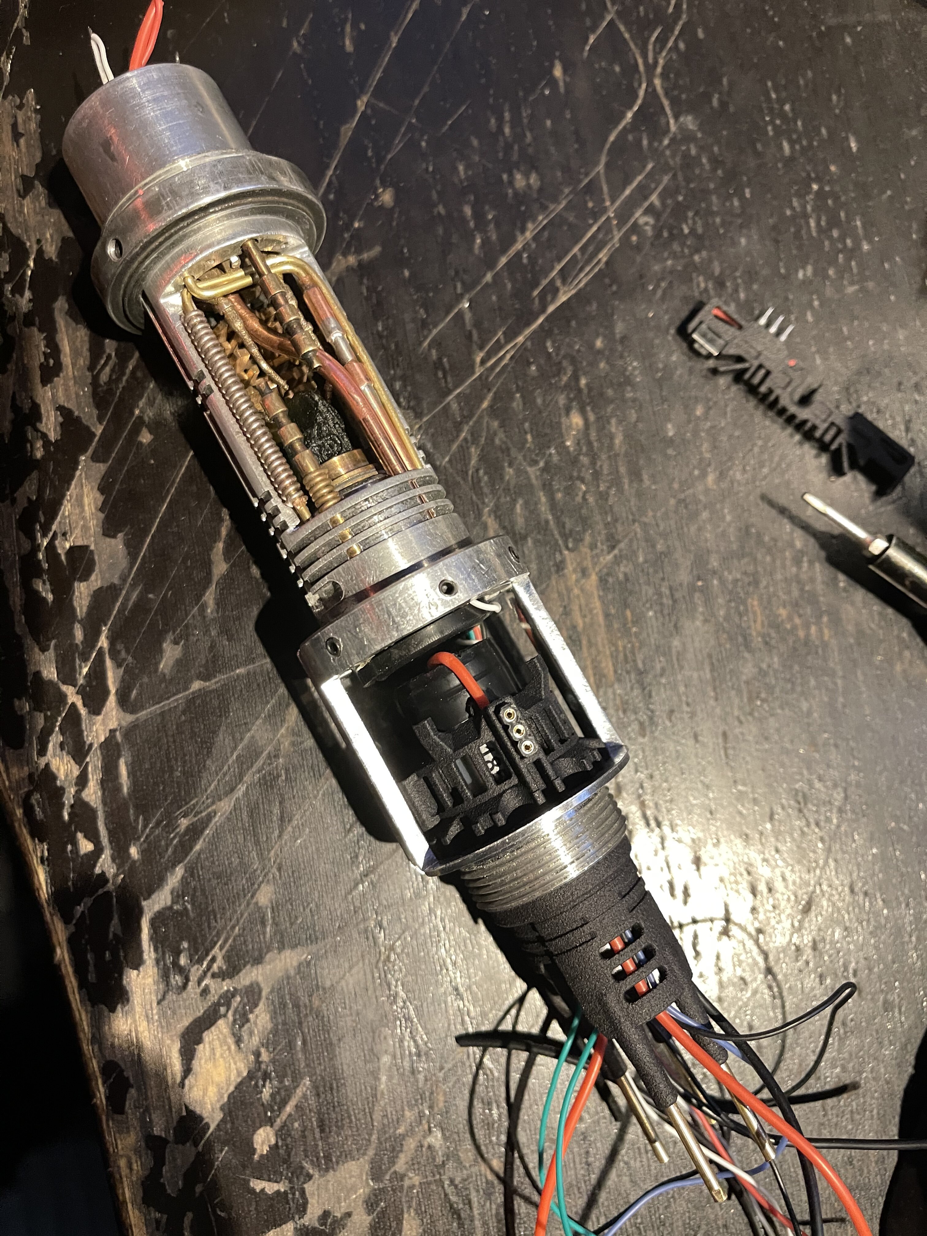

Wanted to check this thread to see if anyone has installed one of these yet? Still can’t seem to find a chassis anywhere. I’ve seen some use a Goth chassis designed for MK1, but it’s slight too long for the V2 (pommel has to be pulled out a bit). Recently got a beautiful Rudy Pando crystal chamber and itching to install it. Thanks in advance for any info.

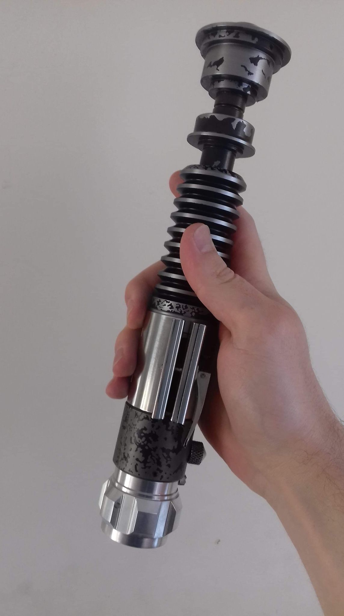

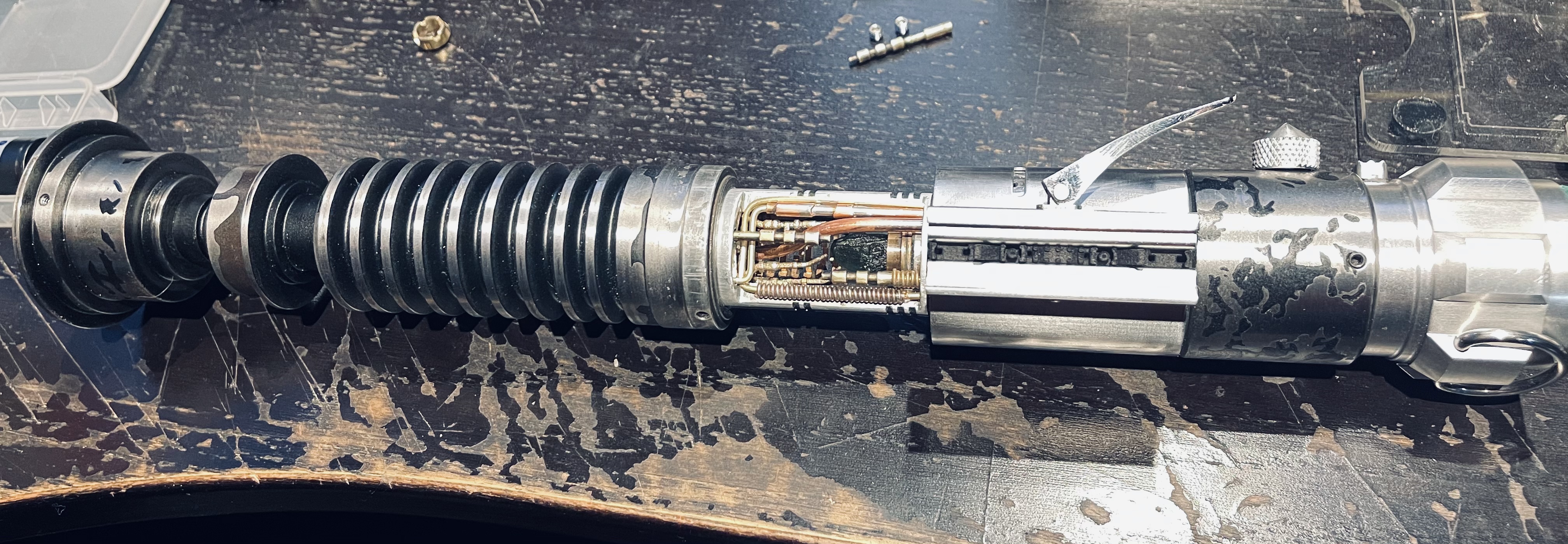

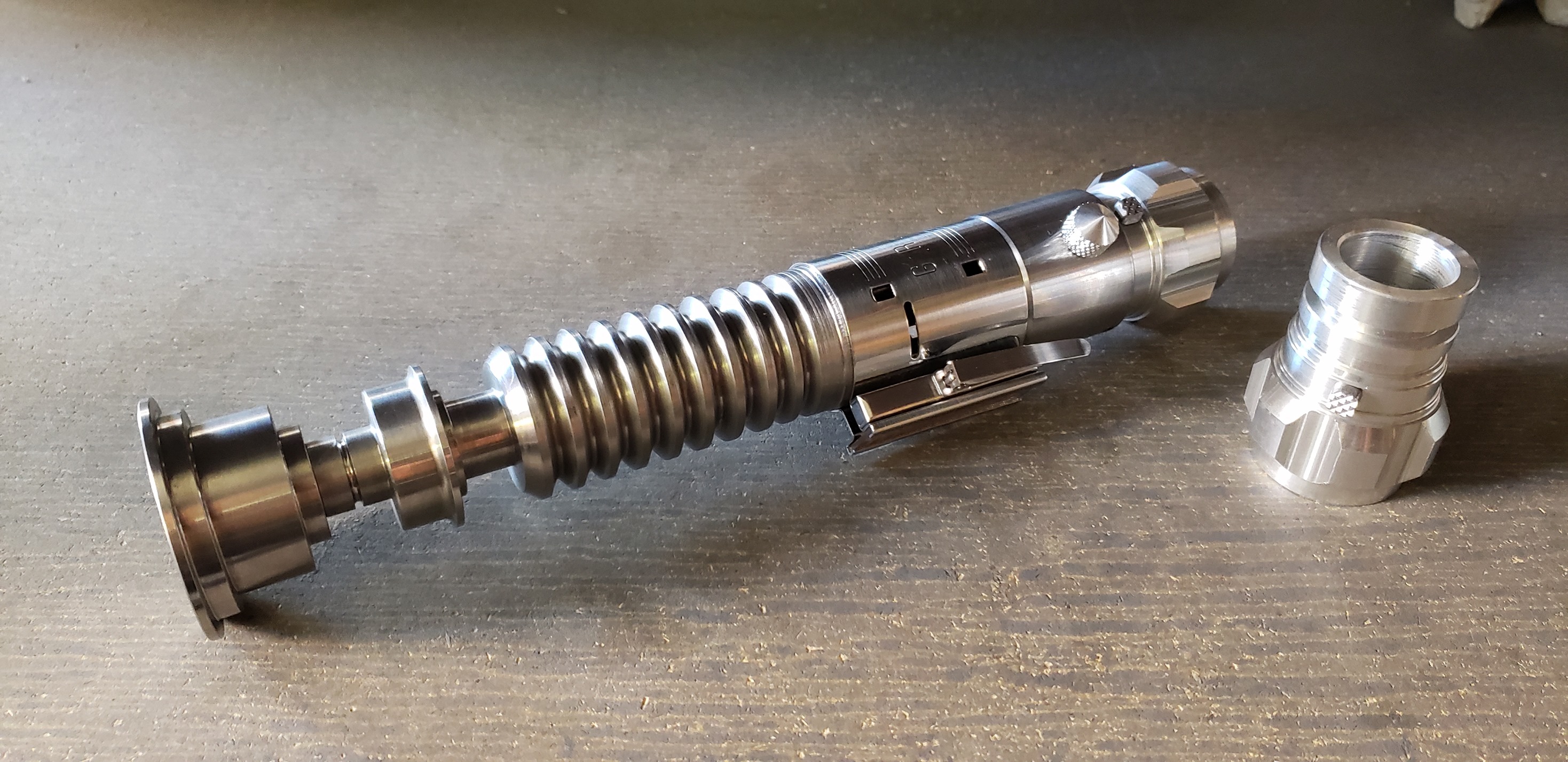

A Roman V2 I was working on for a customer. Pre Pommel cube aging, tape etc :)
The thing was completely covered in rust, all that salty air from the trip across the atlantic I assume. Cleaned up nicely with vinegar and scotchbrite. The booster darkened with malt vinegar and water and came out really lovely. The top had the same treatment but to a lesser solution.
Paintes were self etching primer, matt black (the enamel first didn't take so this stuffs on there for good). Then Matt black enamel over the top.... then browns on the neck.... though that's hard to see in this light. I then hit it with some satin clear coat.
