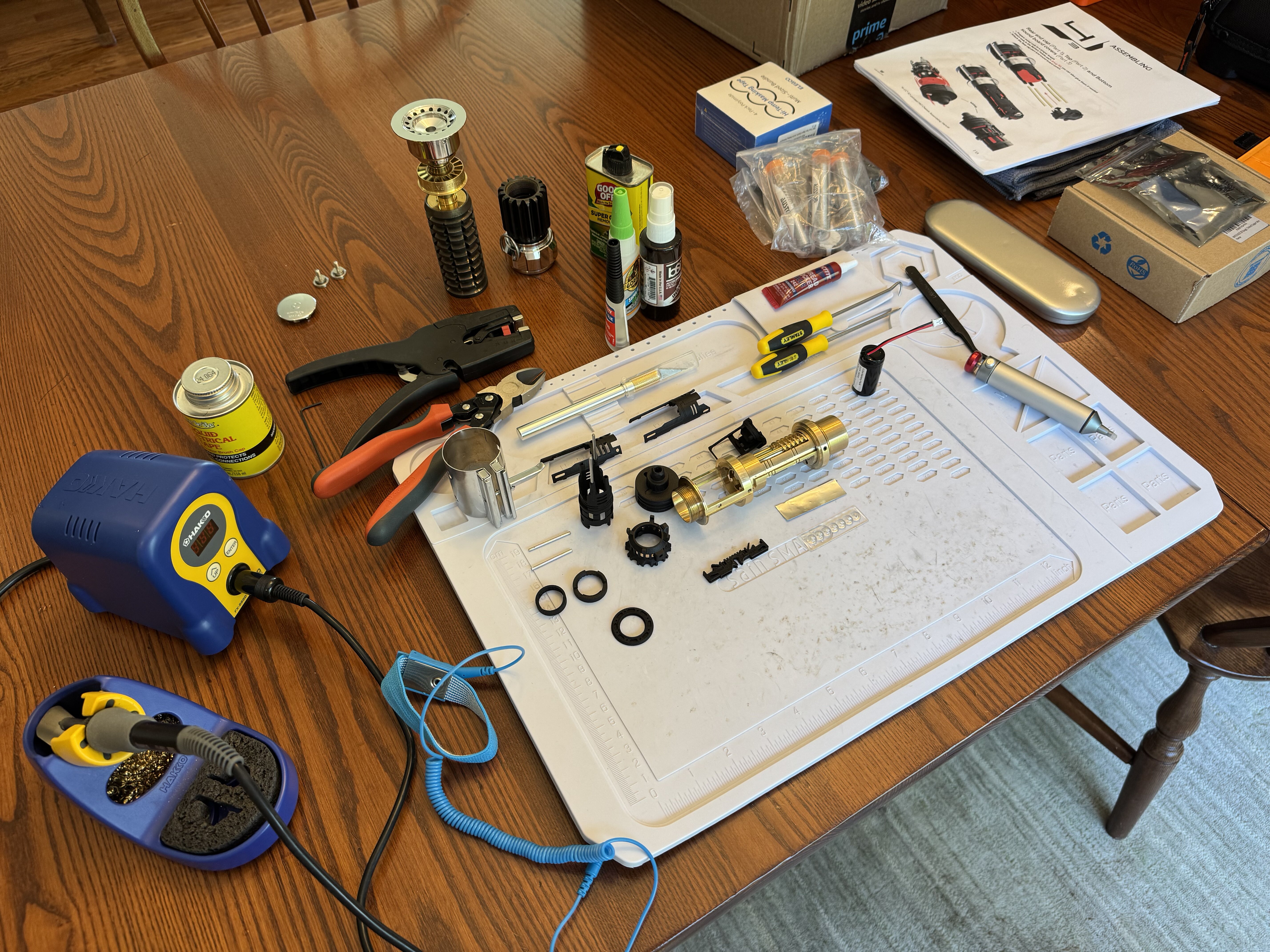

I know my chamber is not as intricate as some of the builds I’ve seen, but I want to keep it simple. This is my first Mk1 build, and I just want something that will work. I can always add complexity later.
I’m still waiting for the rest of the chassis to ship, but I have everything else gathered and ready.

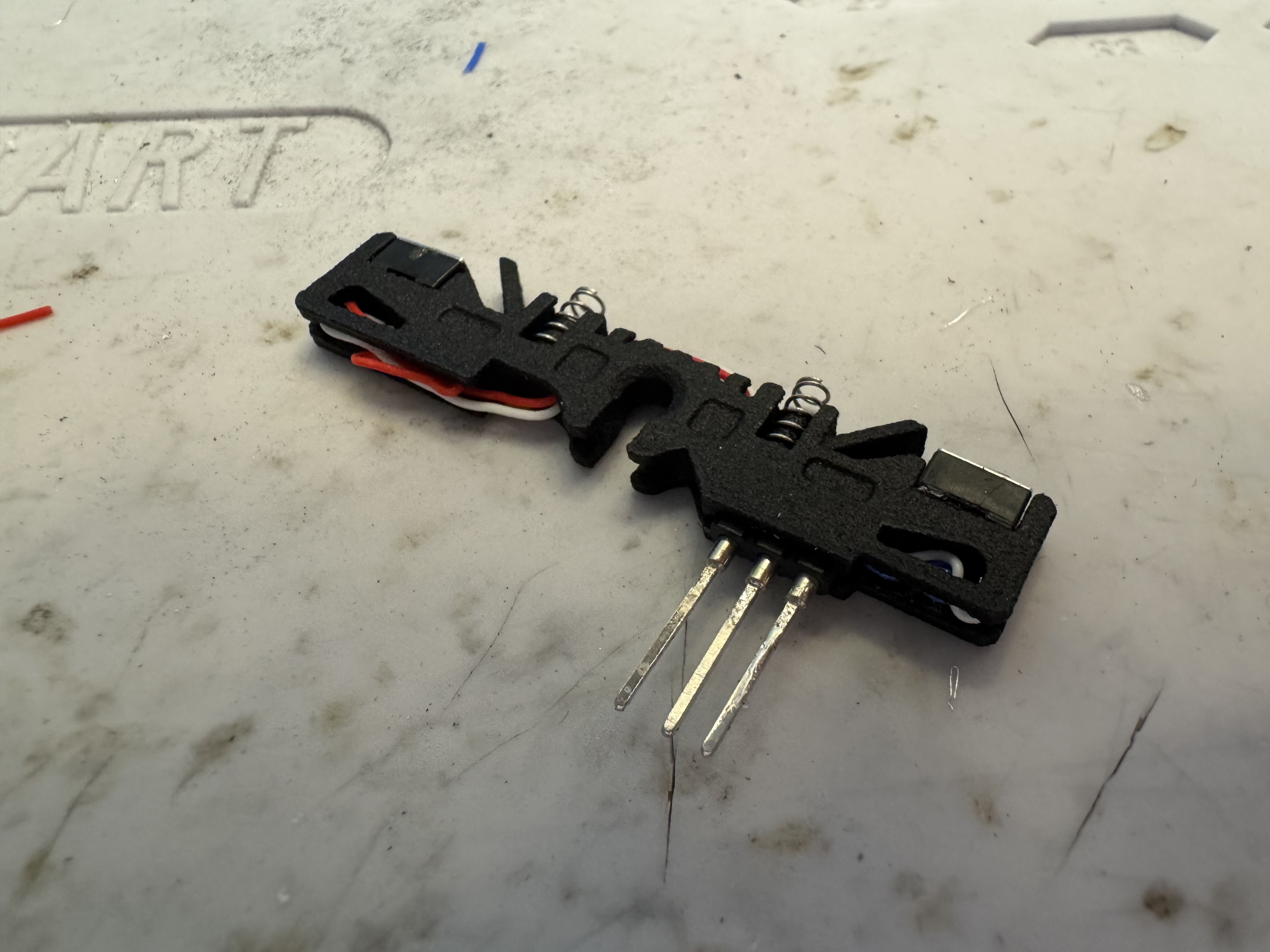

How exactly is the battery wired into the chassis? There aren’t any battery contacts listed on the parts list of the Shtok assembly guide, and I don’t see where any would go. The batteries in the guide are regular protected button top cells, so there should be contacts.

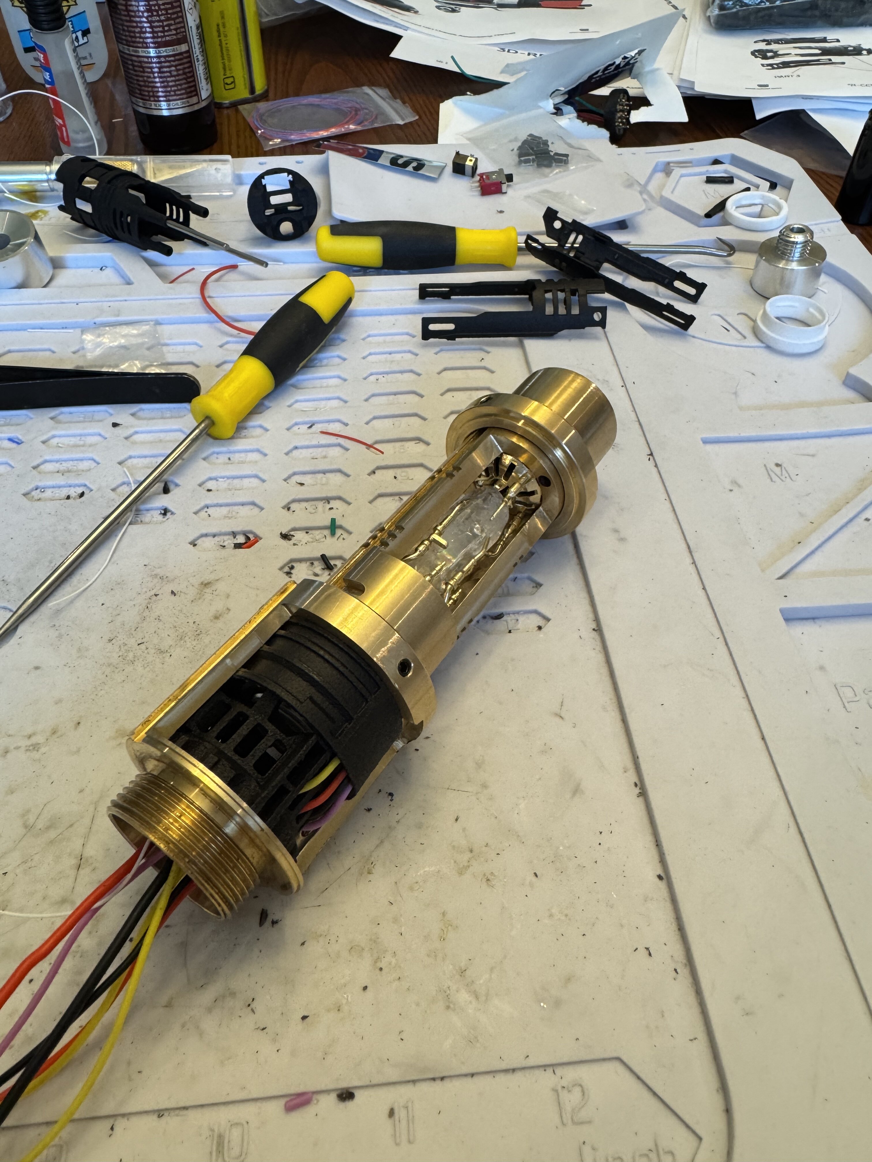

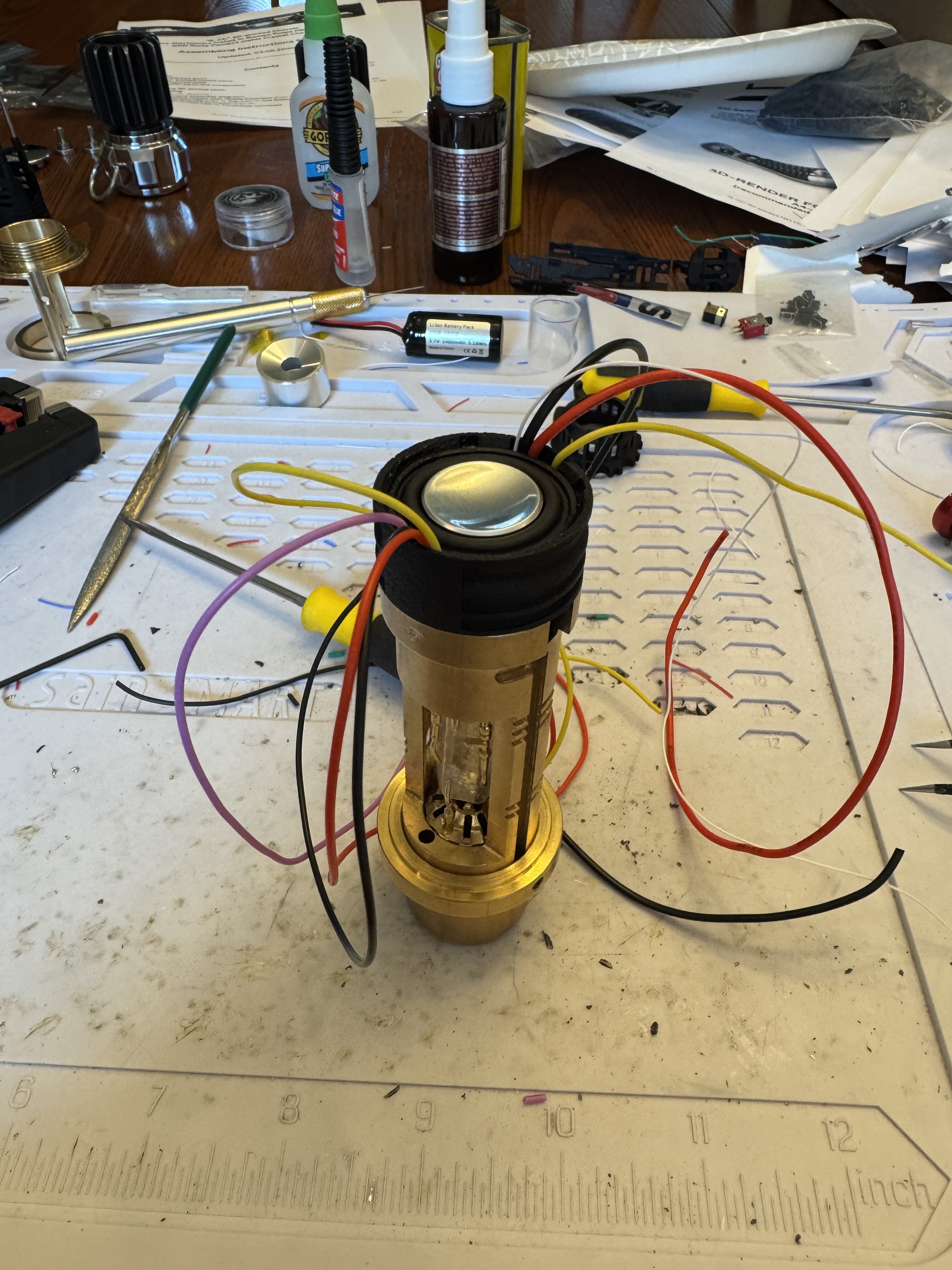

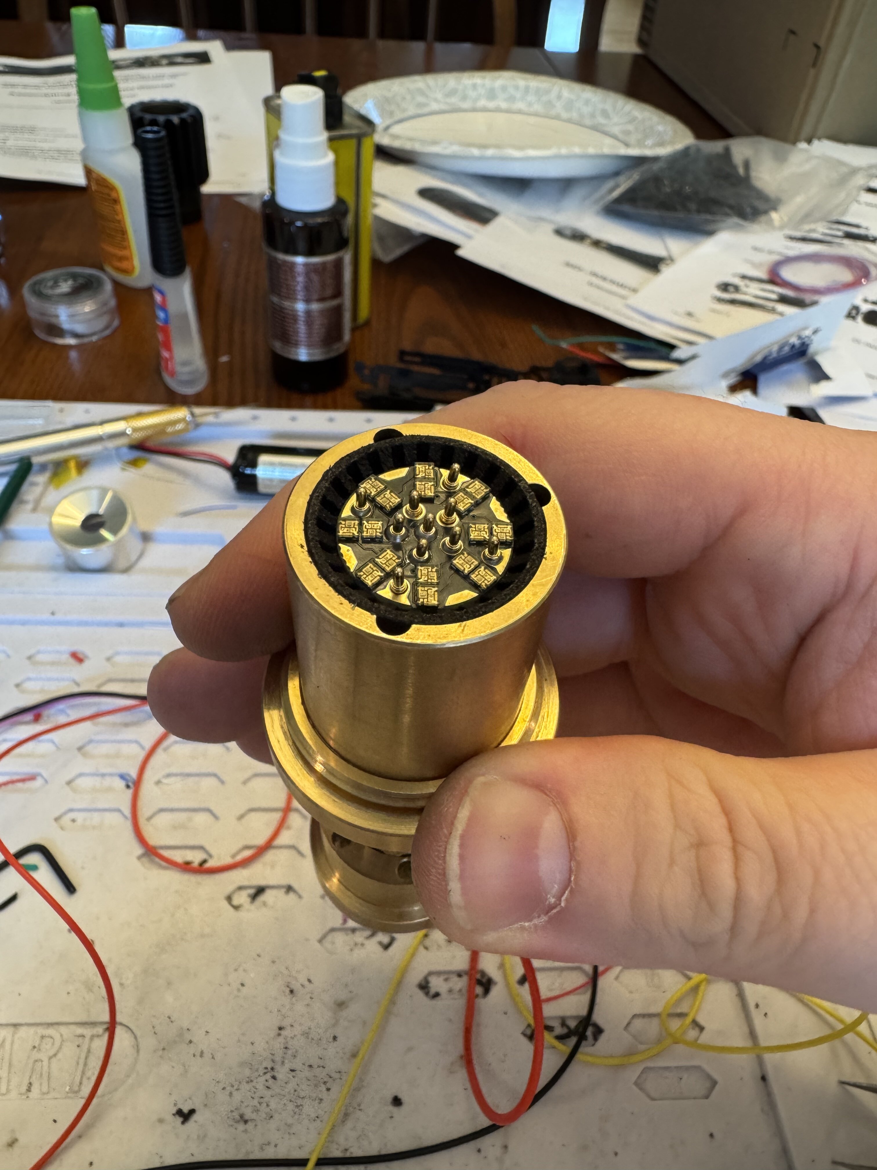

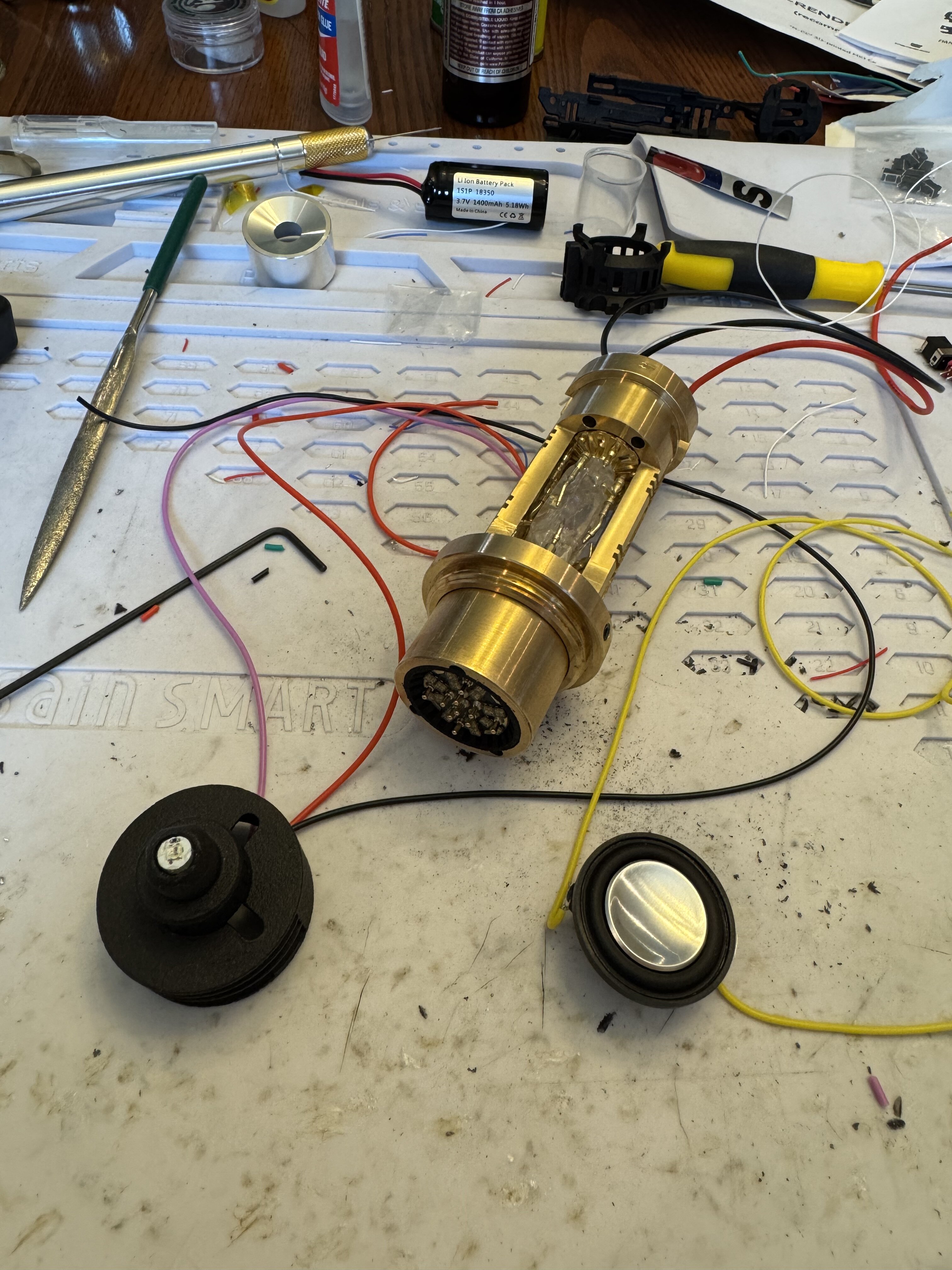

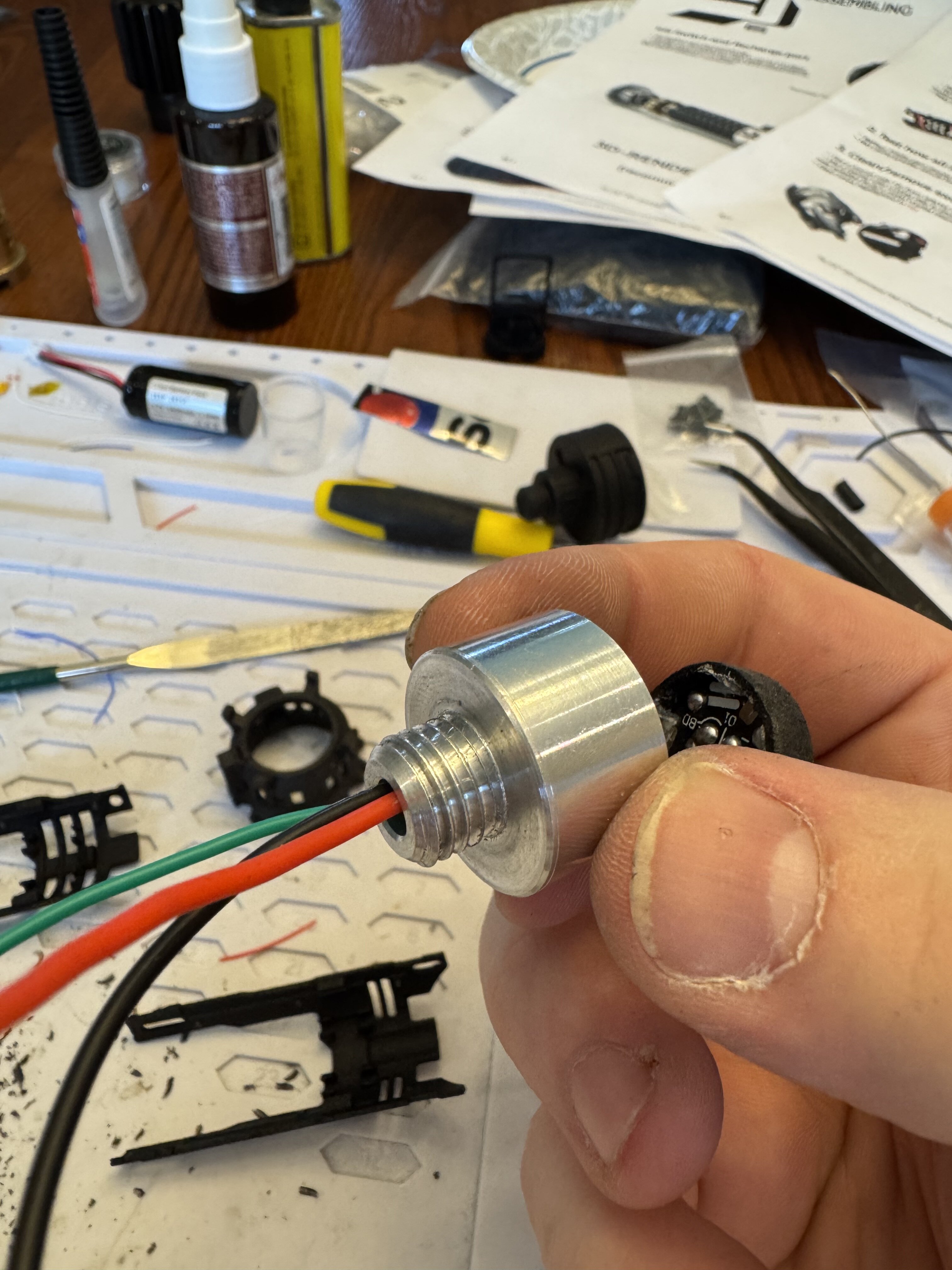

And now I’m stuck. I used 22AWG for the power and 28AWG for most of the other wires. Unfortunately, the combined thickness of all the wires is too much to pass beside the battery in the battery holder part. This is before I even add the three button wires. I’ll most likely have to disassemble everything, which will probable break a few of the chassis components.:mad:
I had to step away from the MK1 for a few days. I was dreading taking everything apart.
Today I carefully removed piece after piece. I’m happy to say that I only broke the speaker holder. I could probably still use it since it will never be seen. But I would know it was in there and not how it should be. I plan to order just the speaker holder from Shtok.
