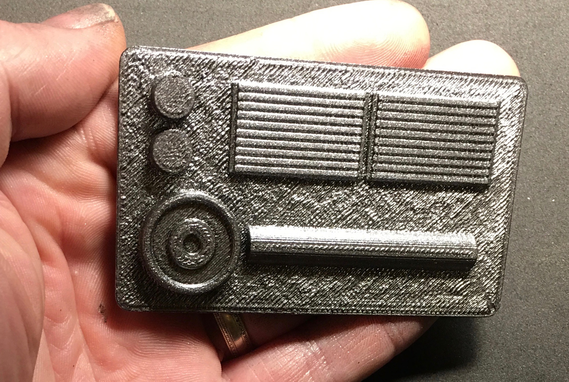

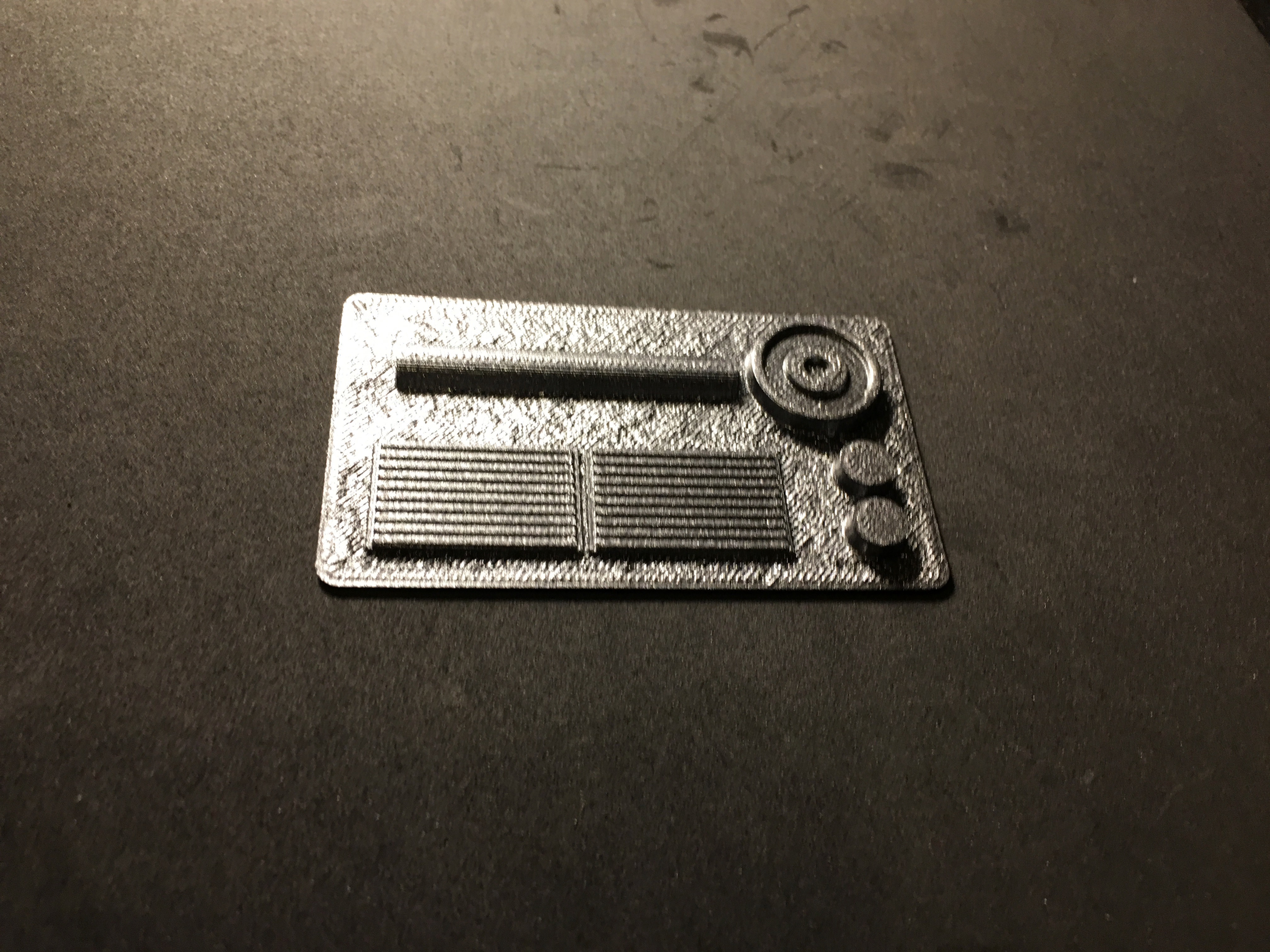

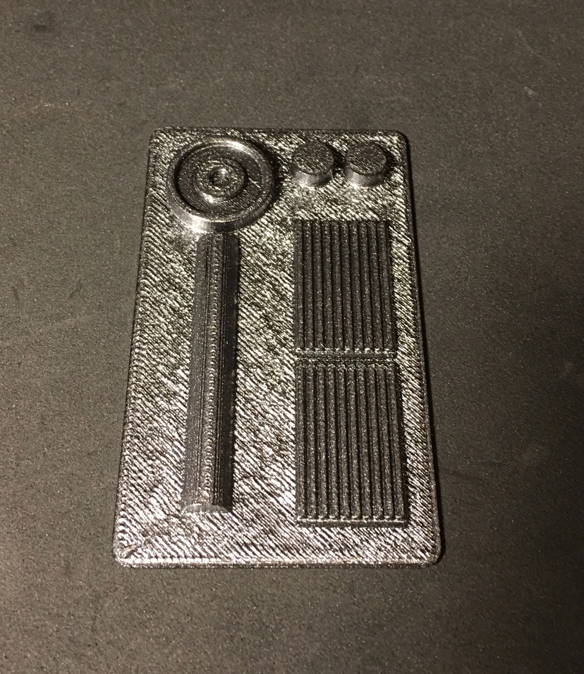

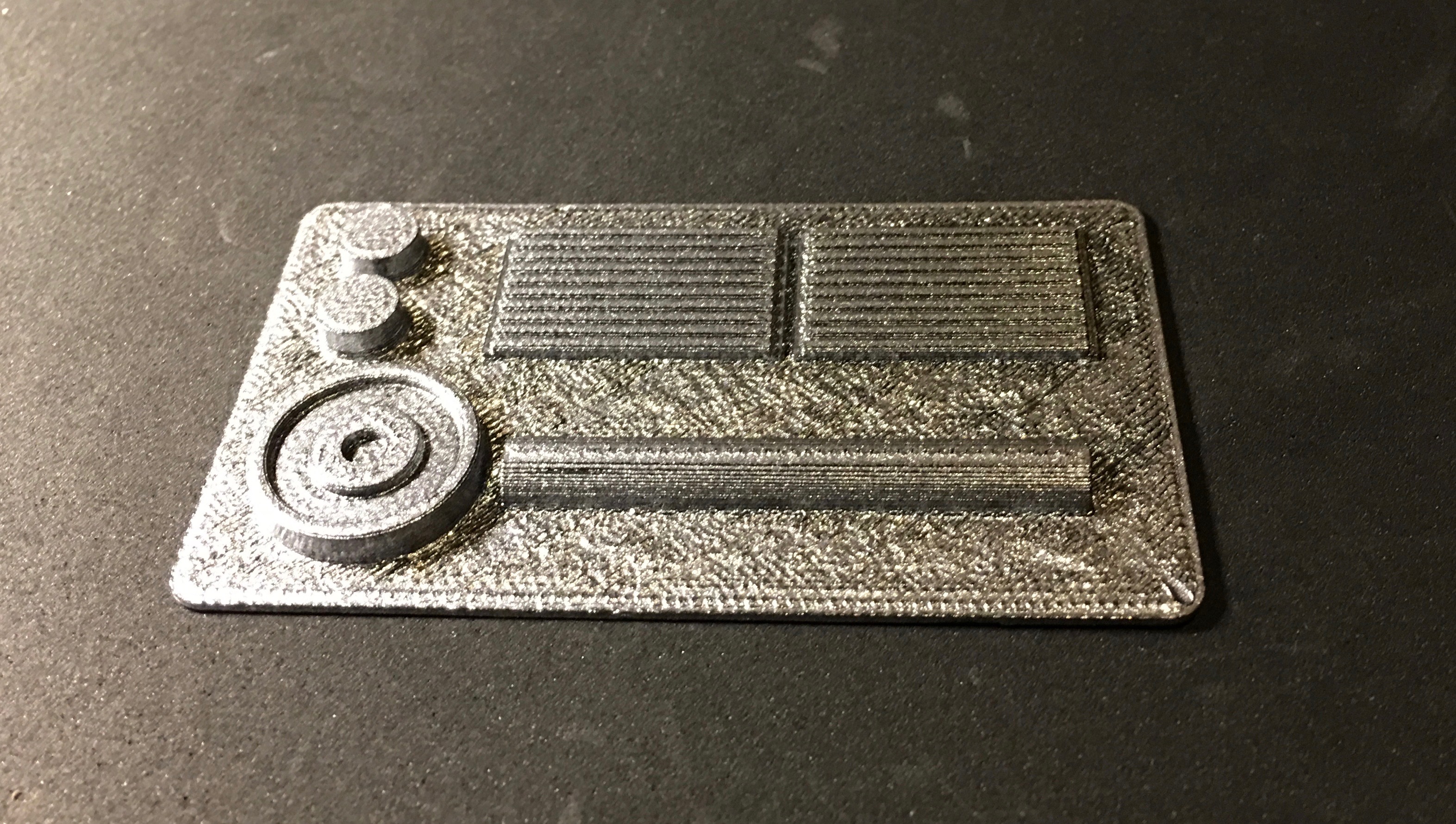

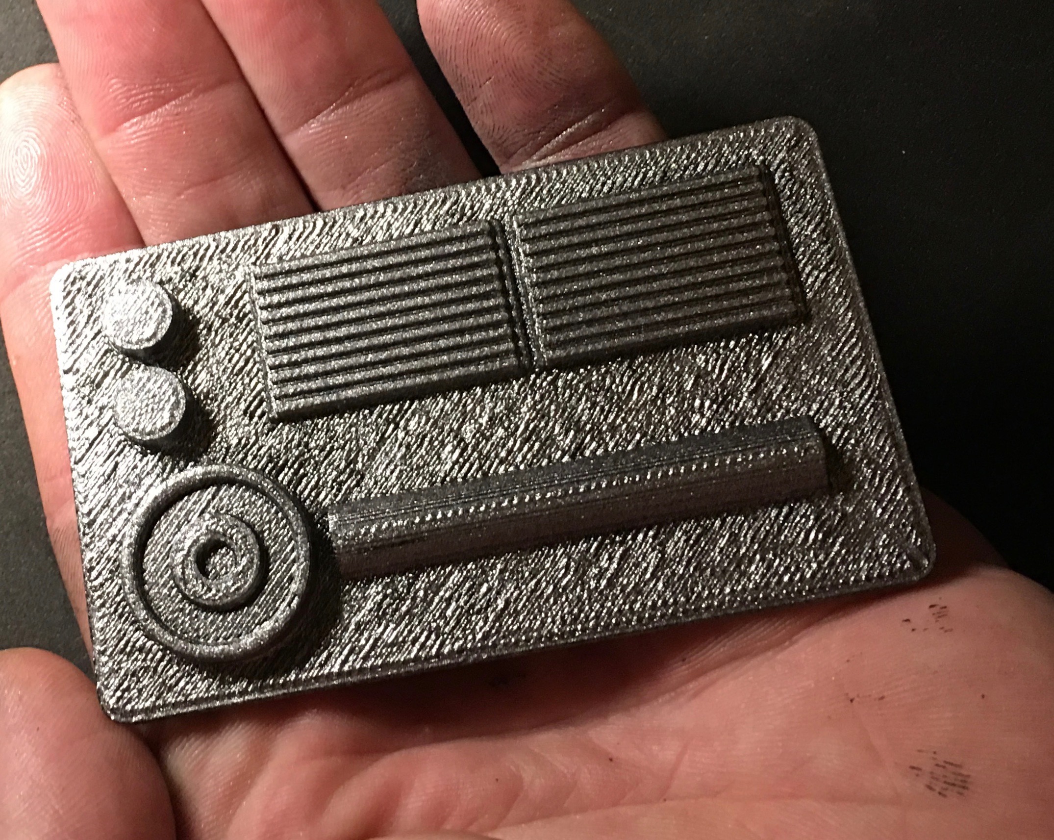

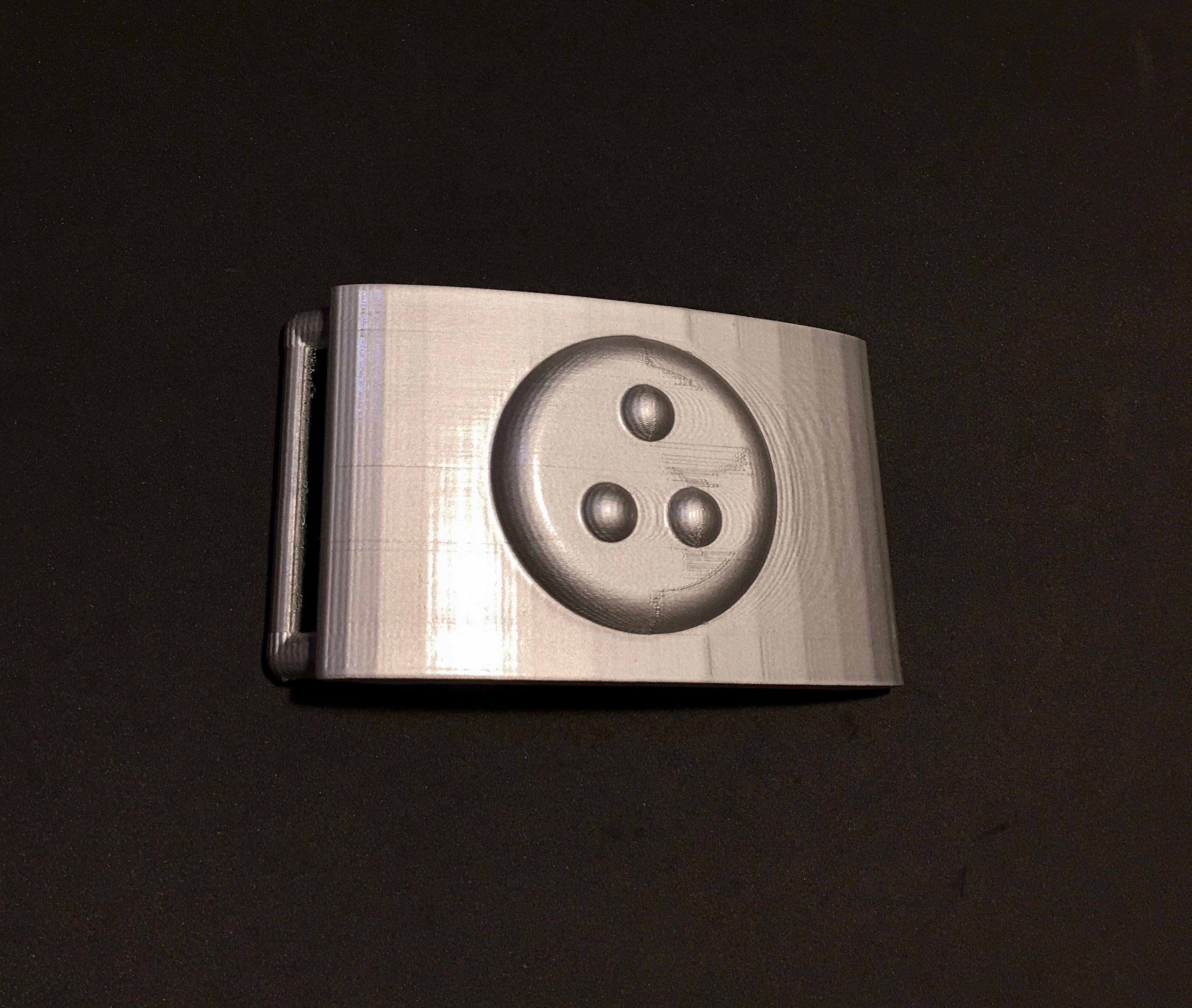

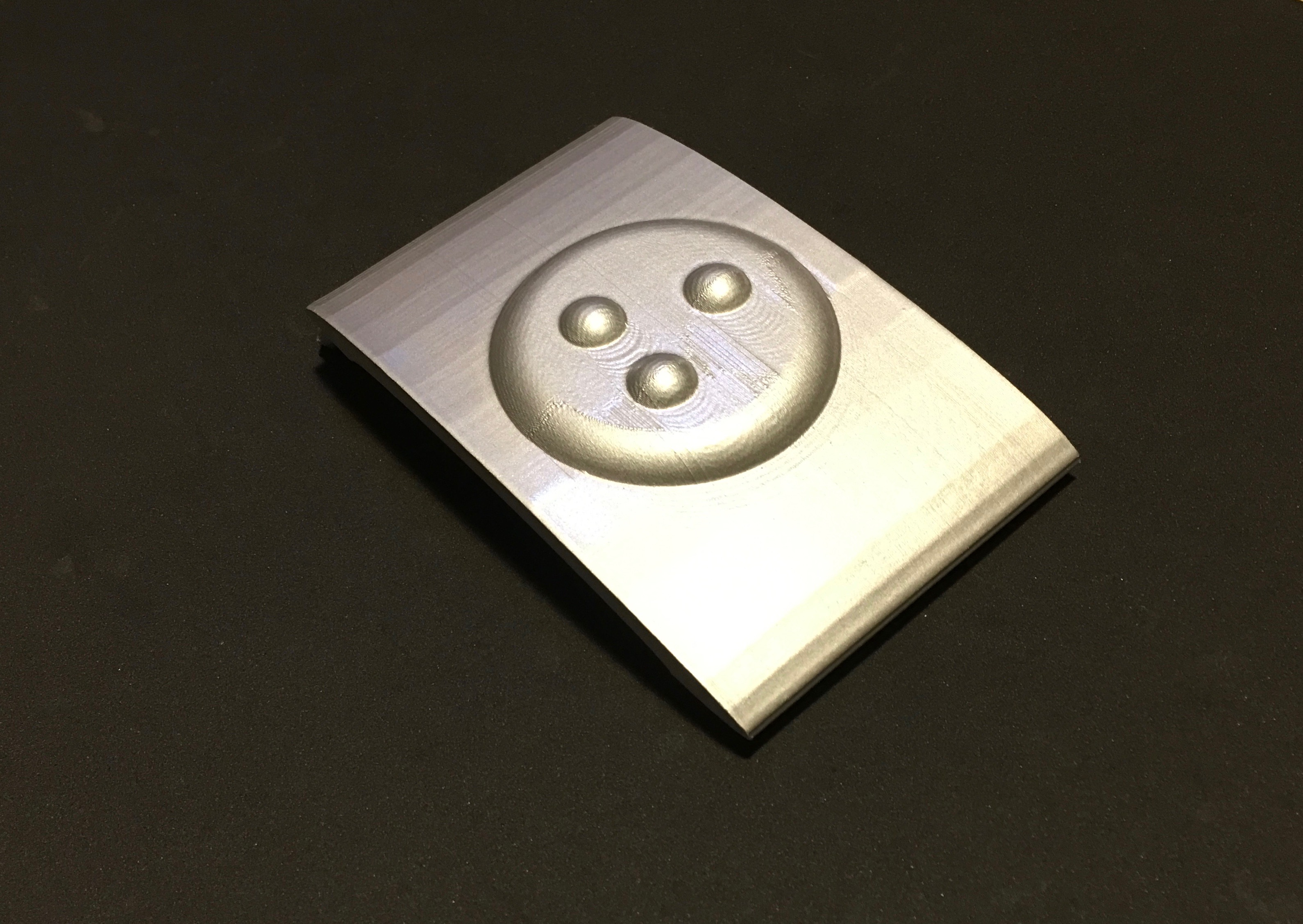

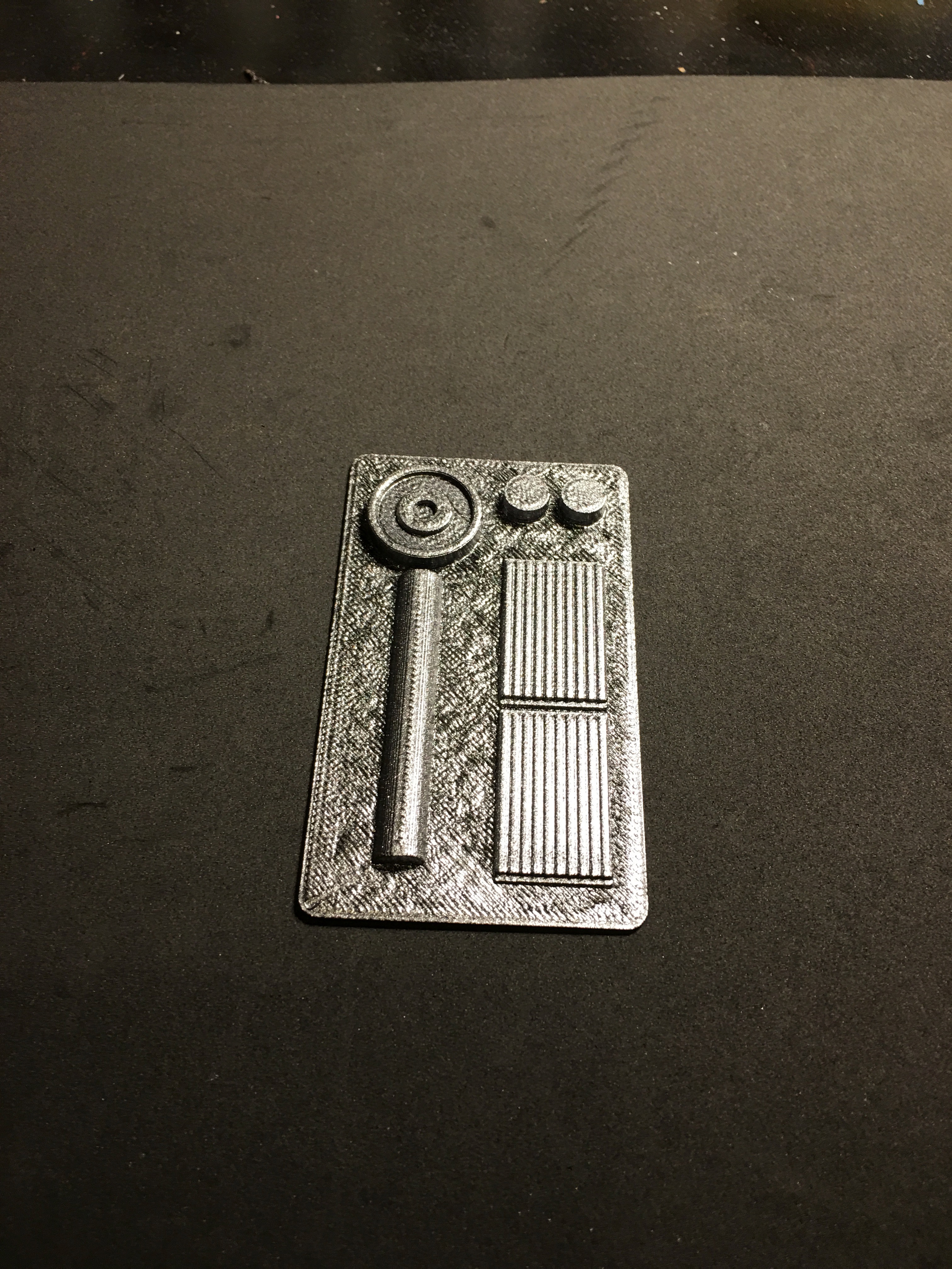

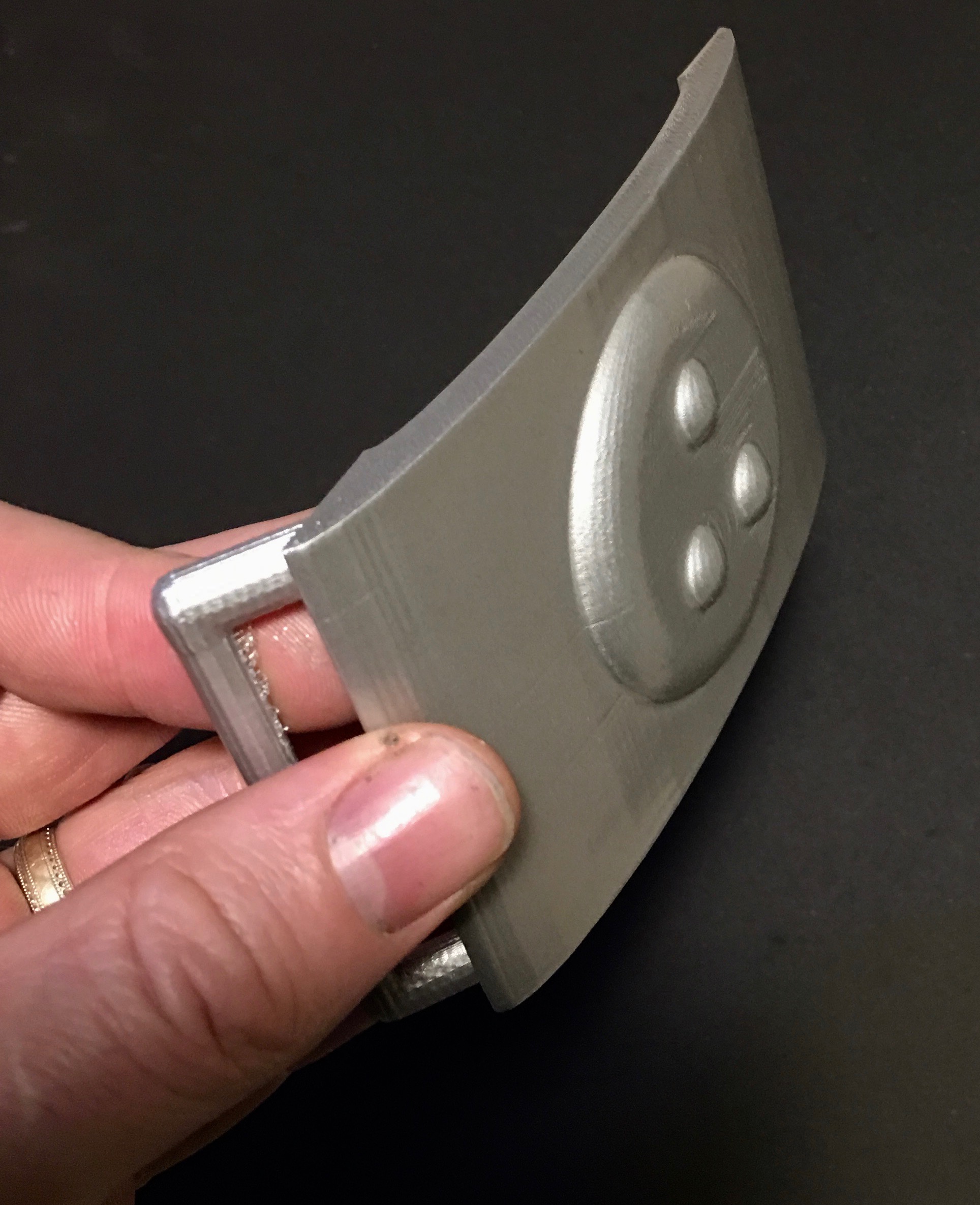

Hi I just made the buckle, seems to have come out ok...

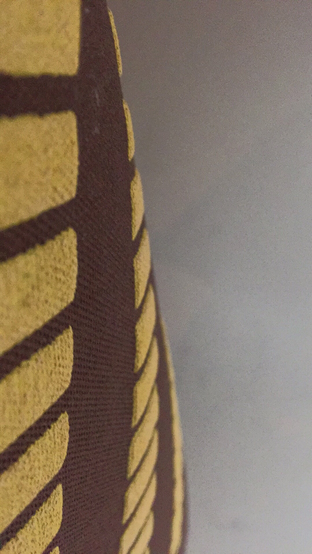

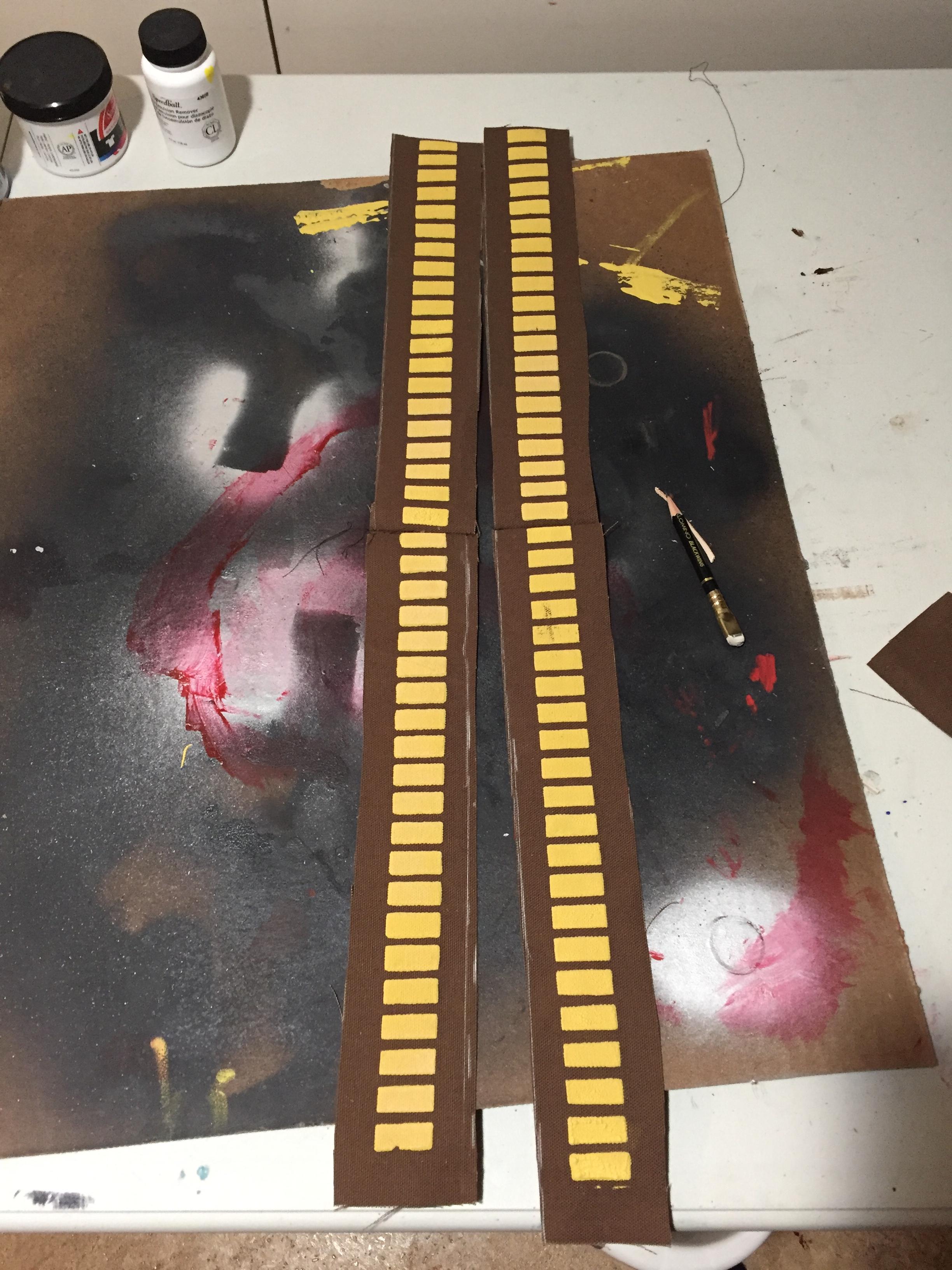

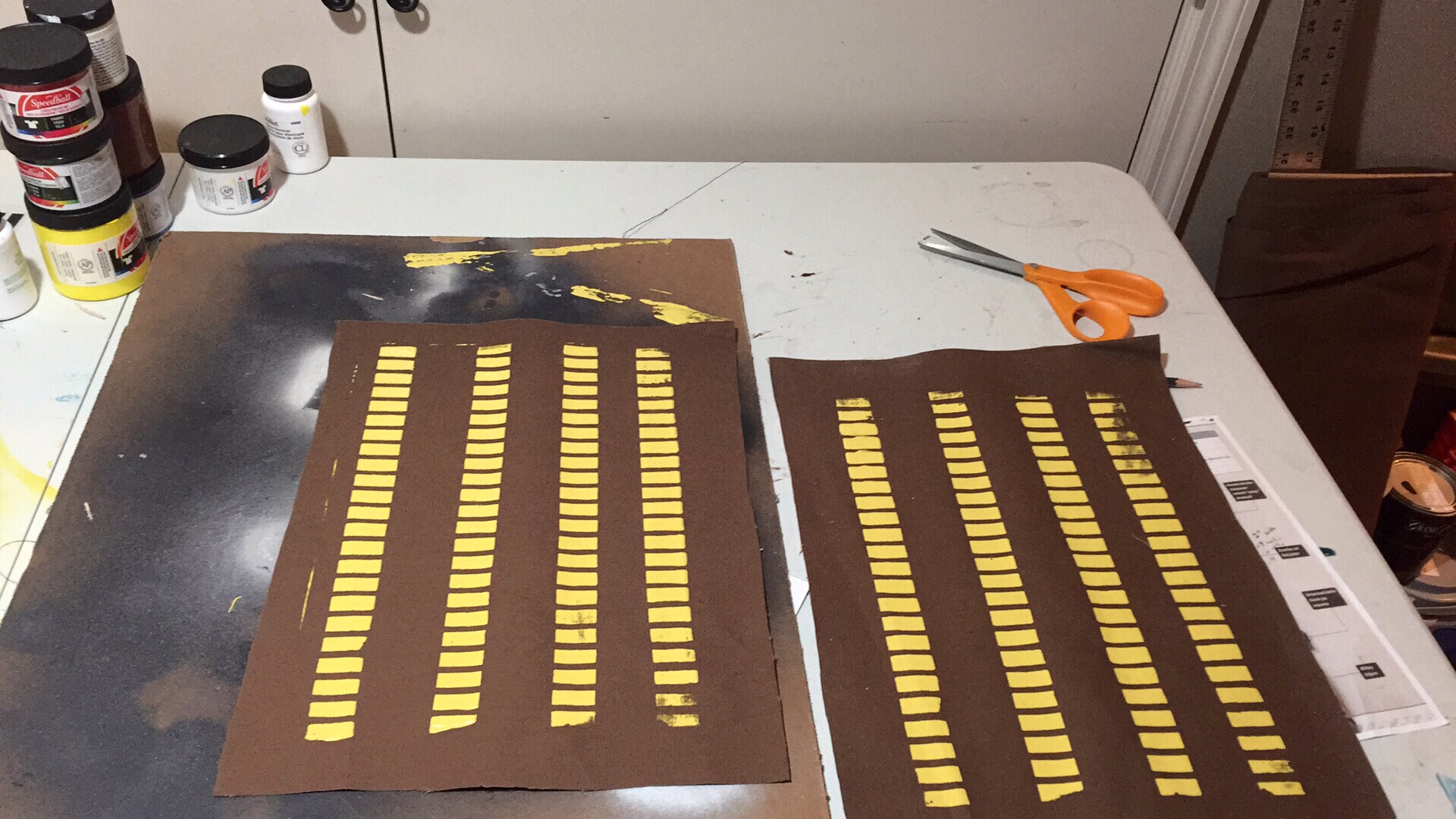

What dimensions are you using for the rectangles and how much space between each. The ratio seems to be about 1:5/16" but I think they'd be larger than an inch wide. I am looking at making a stencil with a vinyl cutter and using the puff paint as well.
For the sleeve stripes, I agree with the measurements of @division 6. When I was analyzing Jyn Erso jacket I originally came up and posted my findings of 47 Stripes, each 11 x 26 mm with 46 gaps, each 2 mm high. These dimensions provided a match of the number of stripes to the length of Jyn's sleeves. In practice I ended up with a screen template of 10 x 26 mm stripes with a 3 mm gap. This is very close to the 3/8" x 1" with 1/8" gap. I have not yet successfully executed the puff paint but I believe that will narrow the gaps back close to my original 2 mm estimate. Obviously Cassian's (and others) will have a different number of stripes and gaps consistent with the increased sleeve lengths.
If you look at the different jackets in the movie and on display at various events you will notice a different number of stripes even for the same character.
In Jyn's I found a 46 / 48 difference between jackets and 52 /53 on Cassians.
Jyn's Airport display jacket was missing the front pleats and had a green zipper instead of black.
I used speedball fabric printing ink in yellow, white, and brown, mixed 6:3:2 respectively. I mixed in Jacquard Puff Additive at roughly 15% by weight. I used a heat gun to set the ink and create the puff effect. It turned out really nicely.[/h]
