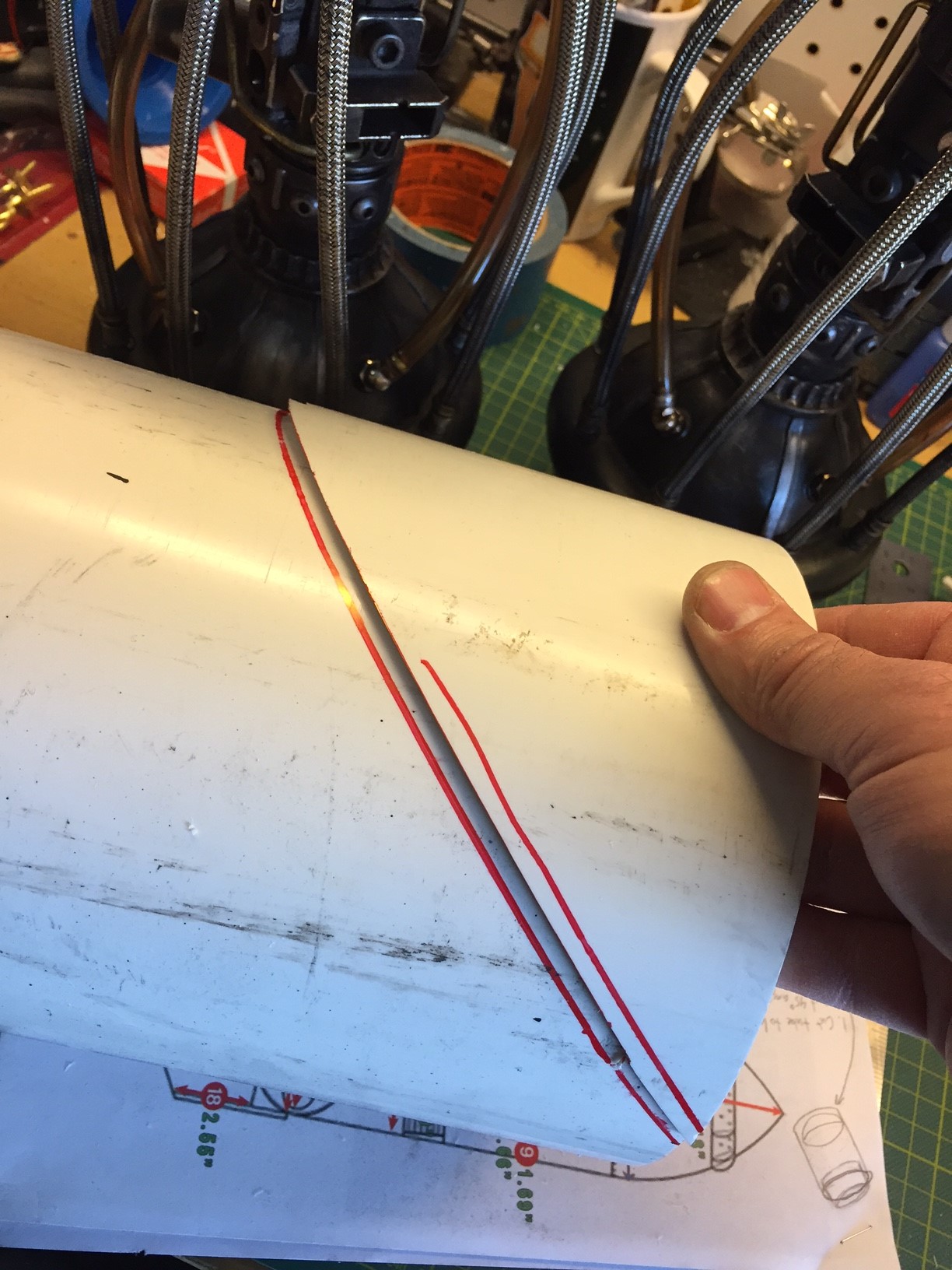

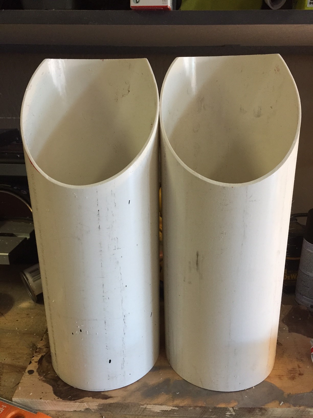

I did a test fit in one of the tubes. I'm using thin walled PVC tubing for the engine shrouds. I was very nervous cutting the 45 degree angle because if I messed up I would need to order more but the first one worked out ok and I'll use it as a template for the second.
QCWolf
Clean looking cut!
Thanks. I used a miter saw but I took about 100 measurements before I cut and taped it down so it wouldn't move as I made the cut.
I never thought to use PVC piping. Well off to Lowe's.

After I cut the first tube, I used the piece that was cut as a template for the next one. It worked out nicely and I didn't have to take as many measurements.

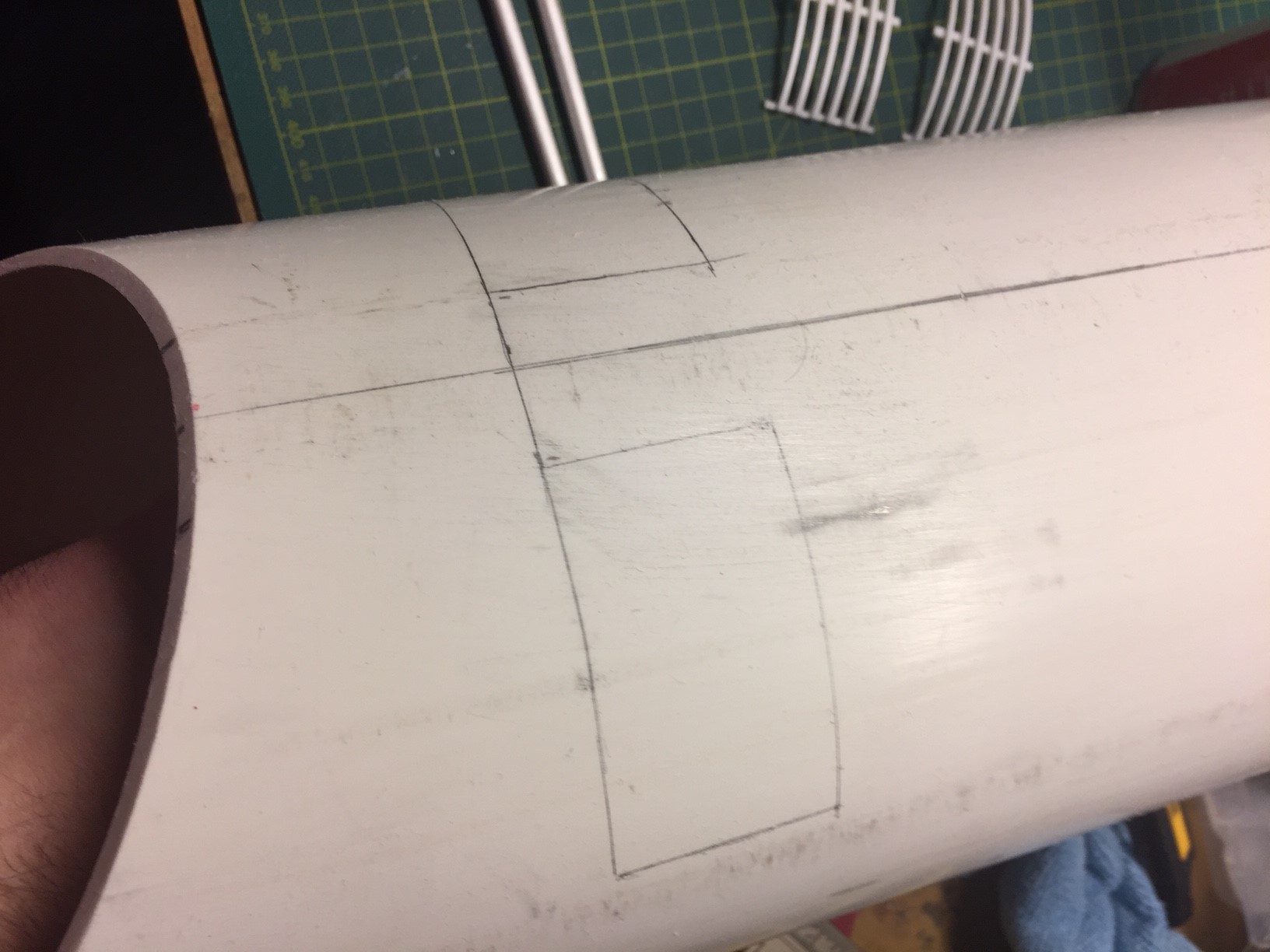

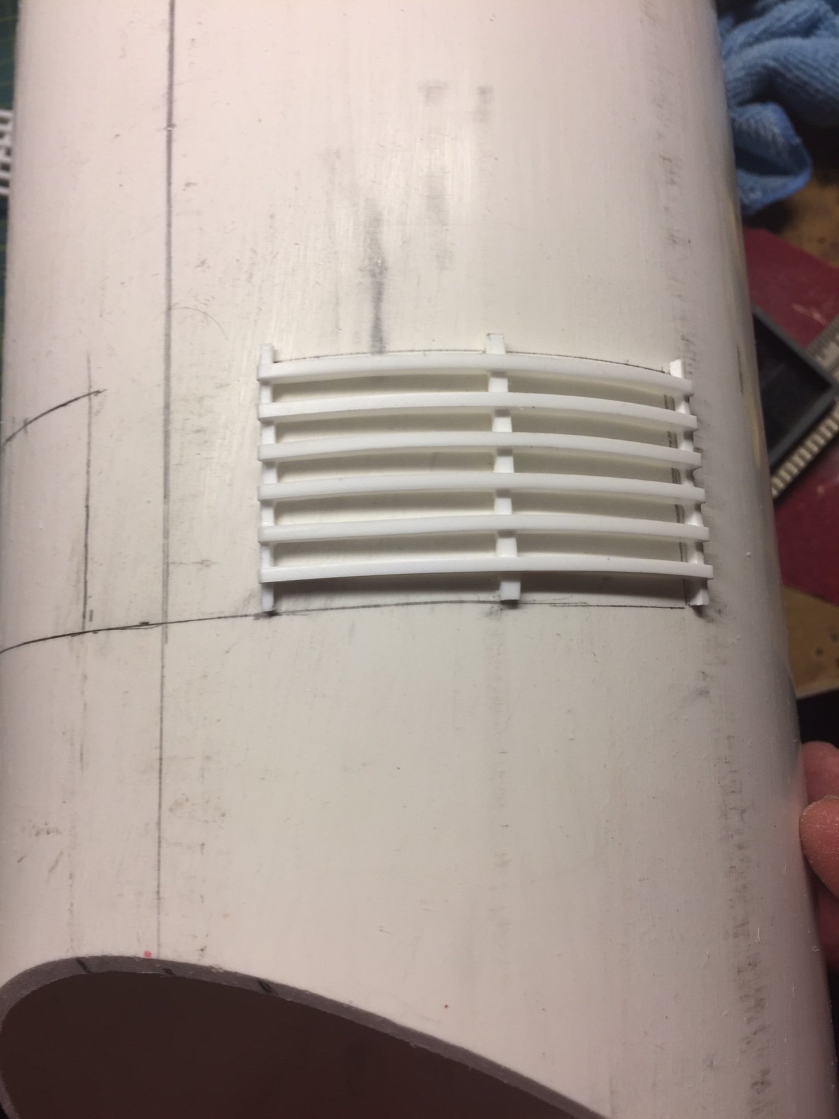

I got a little more done last night. I threaded the control rods, prepped the vents and measured where I'm going to make the vent cut-outs. I realize the vents are supposed to be slightly off from perpendicular, but I'm going with the squared up look. It doesn't bother me that this pack isn't 100% screen accurate because it's mine and I like what I like.

Yup, those vents I sent you are squared off. I too decided to square them up for simplicity. When I started to try to plan out the angled ones my head started spinning :)

Bingo! I briefly played with the idea of attempting the angled version but the angles and curves were too much for my basic geometry skills.
