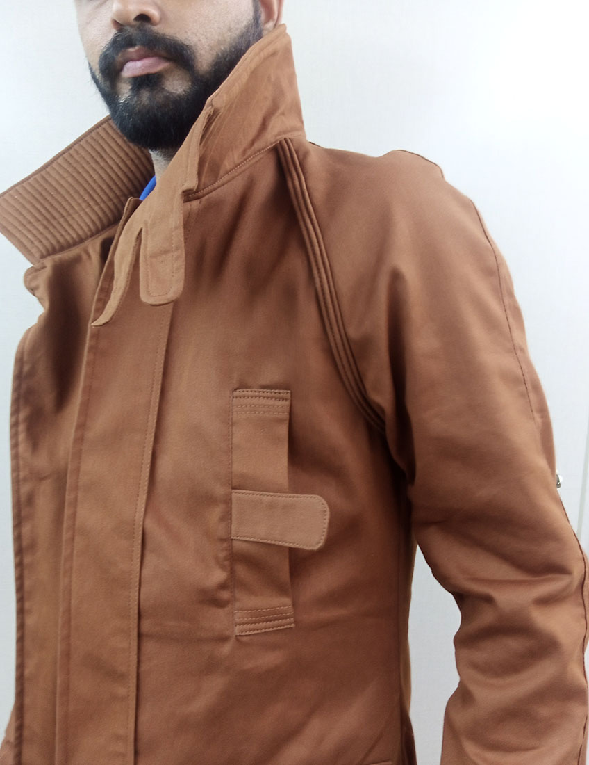

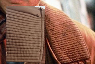

The line density could stand to be adjusted here, but I think the biggest issue is the fabric chosen. The color isn't right, but that aside, those wrinkles you're seeing on the original film collar are because of the cotton chosen. With wool, the entire coat is going to retain too clean a finish. As it wears, it should look worn in.

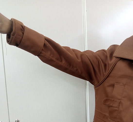

The raglan lines along the shoulders also look like they're...floating? I'm not sure what the correct term is here. They seem to be more flush with the surface on the film coat and on the mangoli. I don't know whether that's because of the fabric chosen, or how they attach. Again, I'm not an expert on this coat--I'm just stating what my eyes see in these photos based on the fabric used.
That may be true, but the concern here is accuracy. Without the coat being cotton, it won't crumple and wear properly. Early versions of the abbyshot used wool, and they later corrected this in their v2. Same with magnoli. It would seem silly to me to go through all this effort for accuracy, only to end up with fabric in the incorrect weight. Same for the color. Just my opinion.

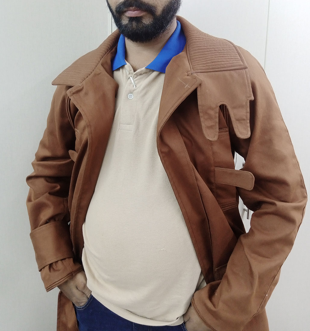

I still think the collar border needs to be adjusted in the final version. Additionally, can we see some photos of someone wearing the mockup, preferably collar up and down and with a blazer underneath?
I'll take a new images with model by tomorrow.
Please explain about collar border, I couldn't understand your point.

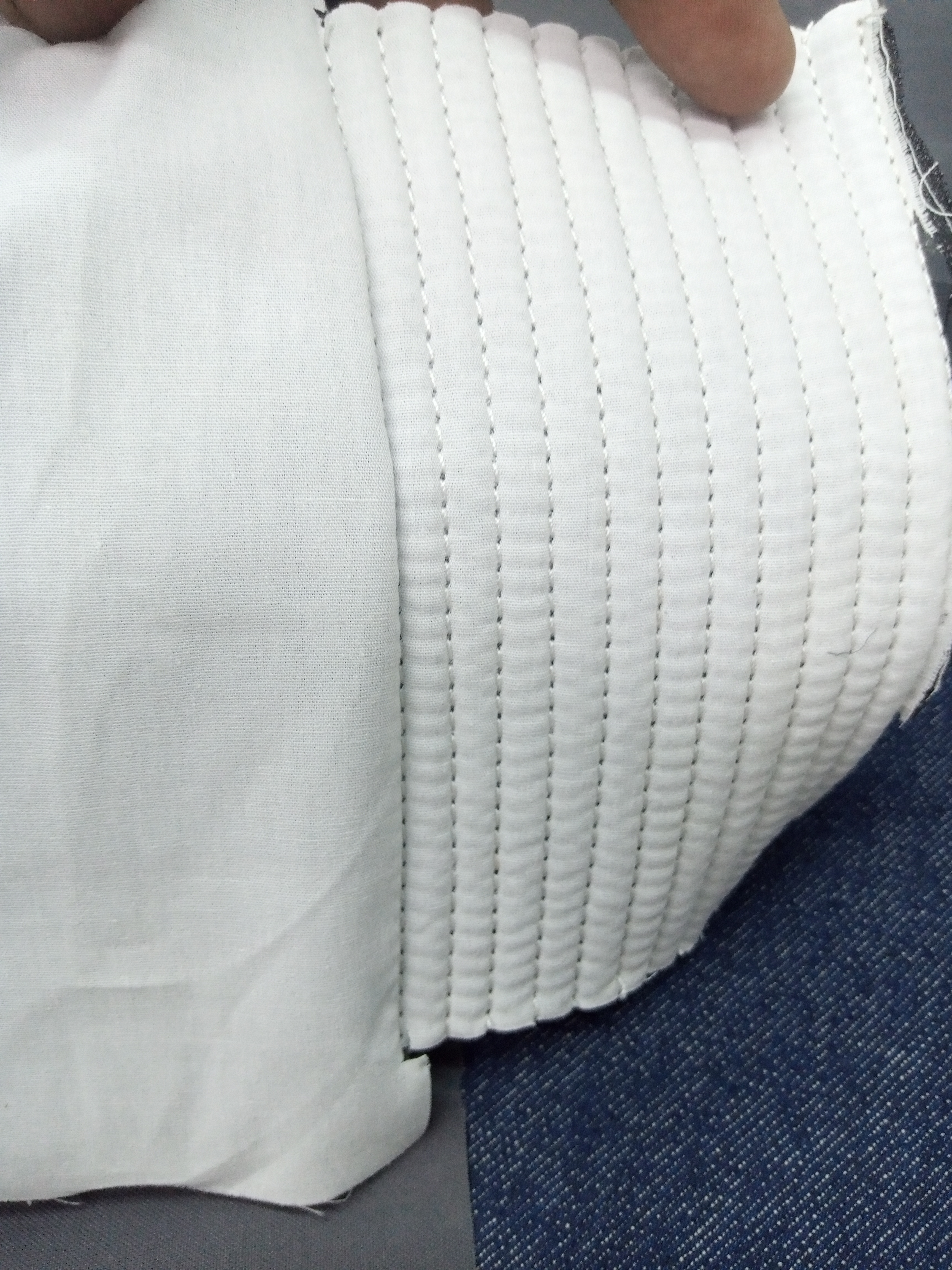

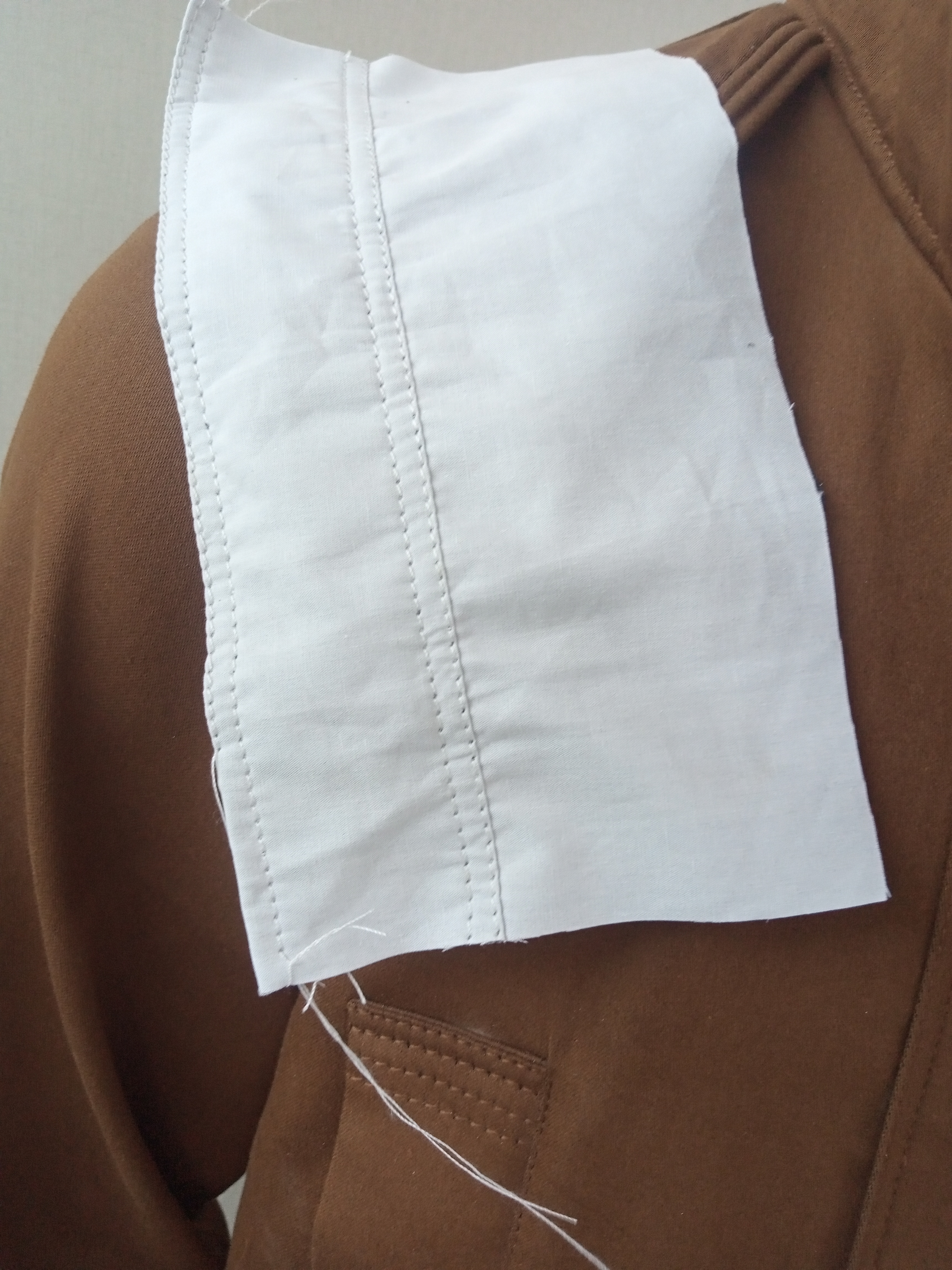

It looks to me like your collar border is roughly the same width as each individual "rib" on the collar; based on the screenshots, I think the border should be roughly half as wide as the ribs.
I agreed, sleeves feel floating, its due to sleeve doesn't fit well on mannequin.
I was comparing wool blended fabric with original and I didn't recognized wool fabric color is right, it was just for fabric reference.
I also agree, movie coat have many wrinkles that proof of cotton fabric.
Oh, I got you point now.

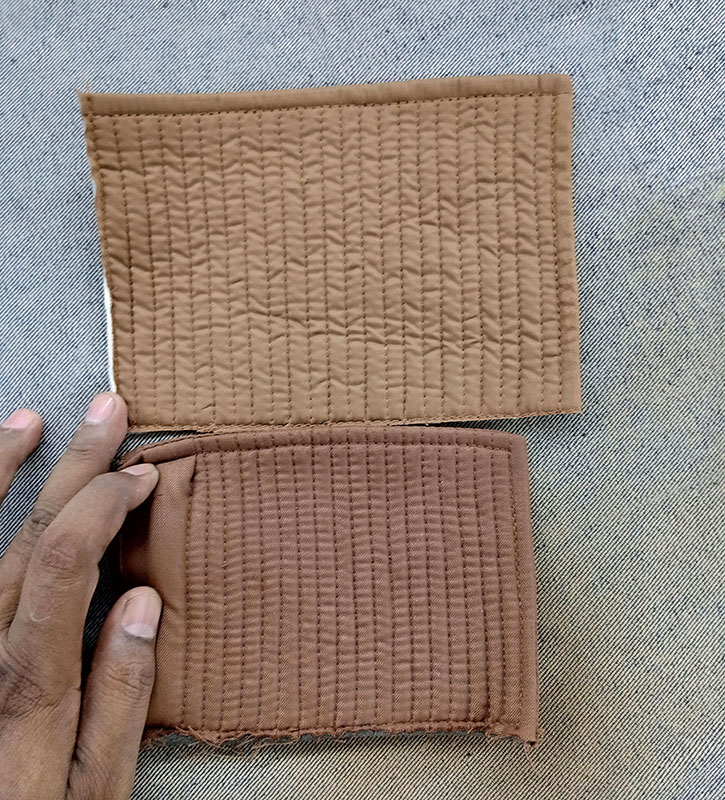

The ribs/ decoration stitching width is 9-10mm, and collar top/ border stitching as standard 6-7mm, but due to thick foam both looks same.
I hope this collar reference will help.

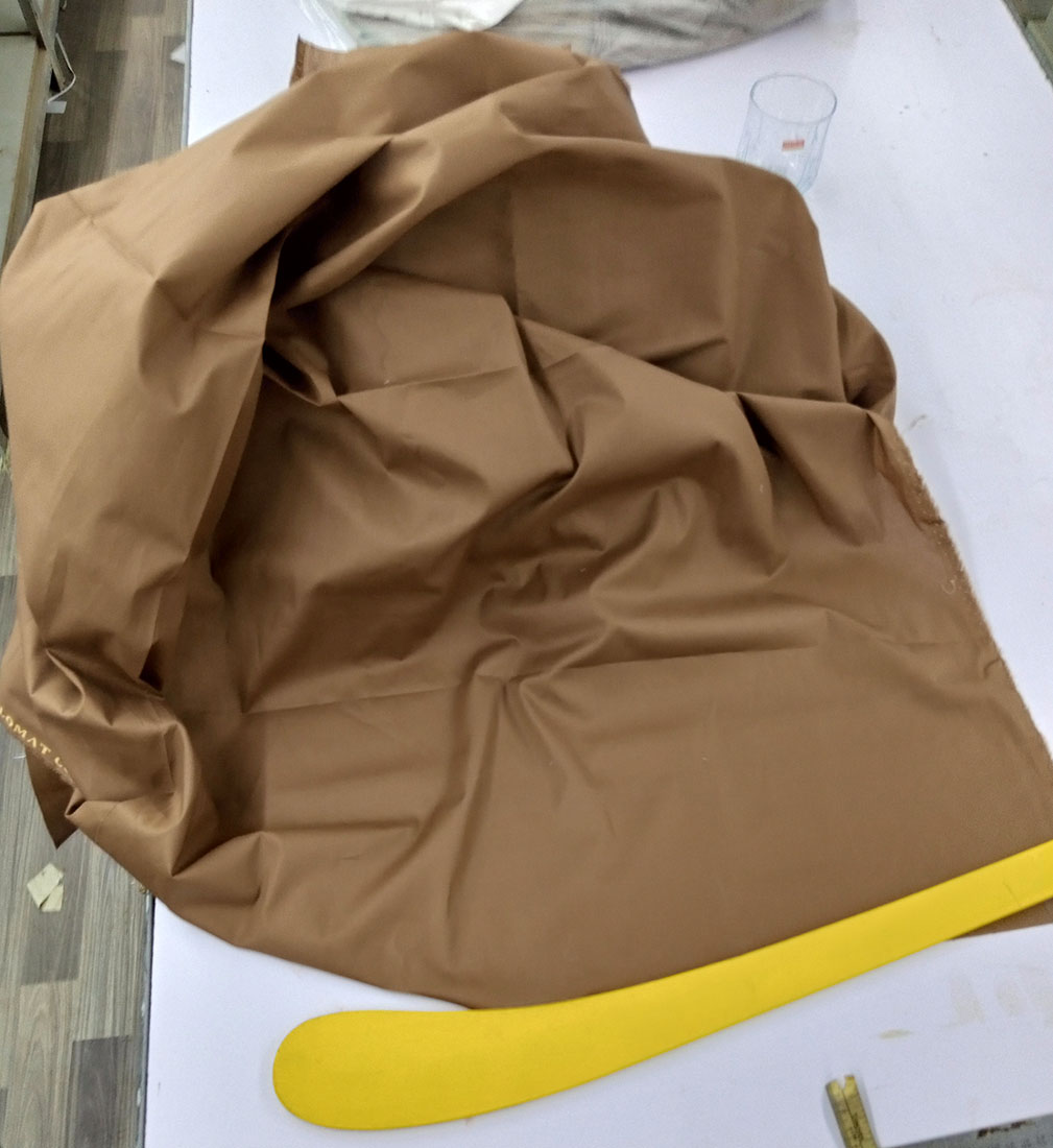

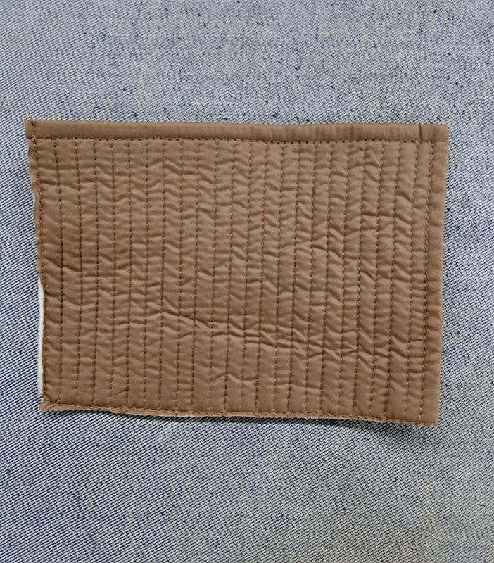

This is Oxford weave cotton fabric, it would be slightly more thick after dying.
Now we have Cotton Oxford, cotton twill, and wool blended options.

Any chance we can see a photo of the coat with a blazer underneath? The sleeves still look a tad narrow to me to layer anything under them.

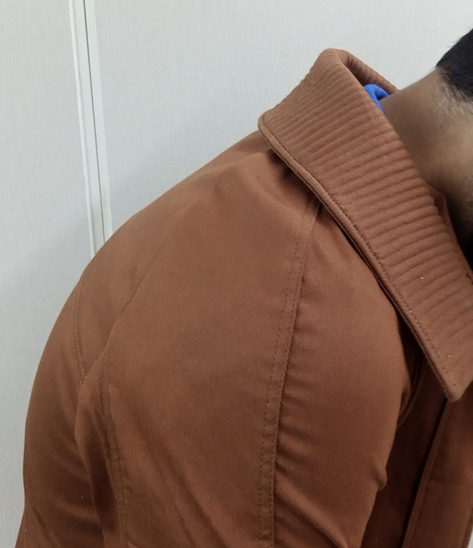

As for the collar, the pattern looks good but it seems like the collar might be sitting too high? I'm not sure I'm explaining well, but at least in images I'm seeing (see attached) it seems like it starts lower. When it's up, it should extend to about the lower jawline when closed (yours looks like it goes almost halfway up your jaw, by comparison). I think the collar height is right, I just think it needs to start lower down, but maybe other people disagree?

Cotton twill fabric weight is equal to my current coat fabric, so you can imagine how would come out twill coat.
The plain weave cotton and Egyptian cotton would be light weight for trench coats, but it's doable.
Wool blend fabric is medium weight that would be good for coats, it's traditional fabric for trench coats too.
You are right, collar needs down more, perhaps 1 inch or 2.
I think sleeve is wide for "M" size coat.

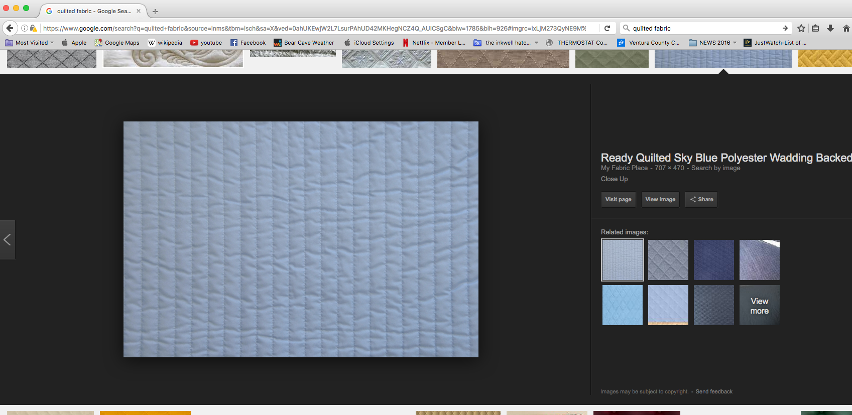

The adjustment to the sleeve cuffs looks great! As does all the work going into the collar. Still, to me, the padding seems just a bit too thick.
I found this note and wondered what you and others thought. I guess the "polyester wadding" vs. whatever foam padding you are currently using. Too late to suggest?
I'm just nit picking at this point. Absolutely loving the development.

You guys can see wrinkles on blend fabric same original coat look where i didn't use thick foam.
