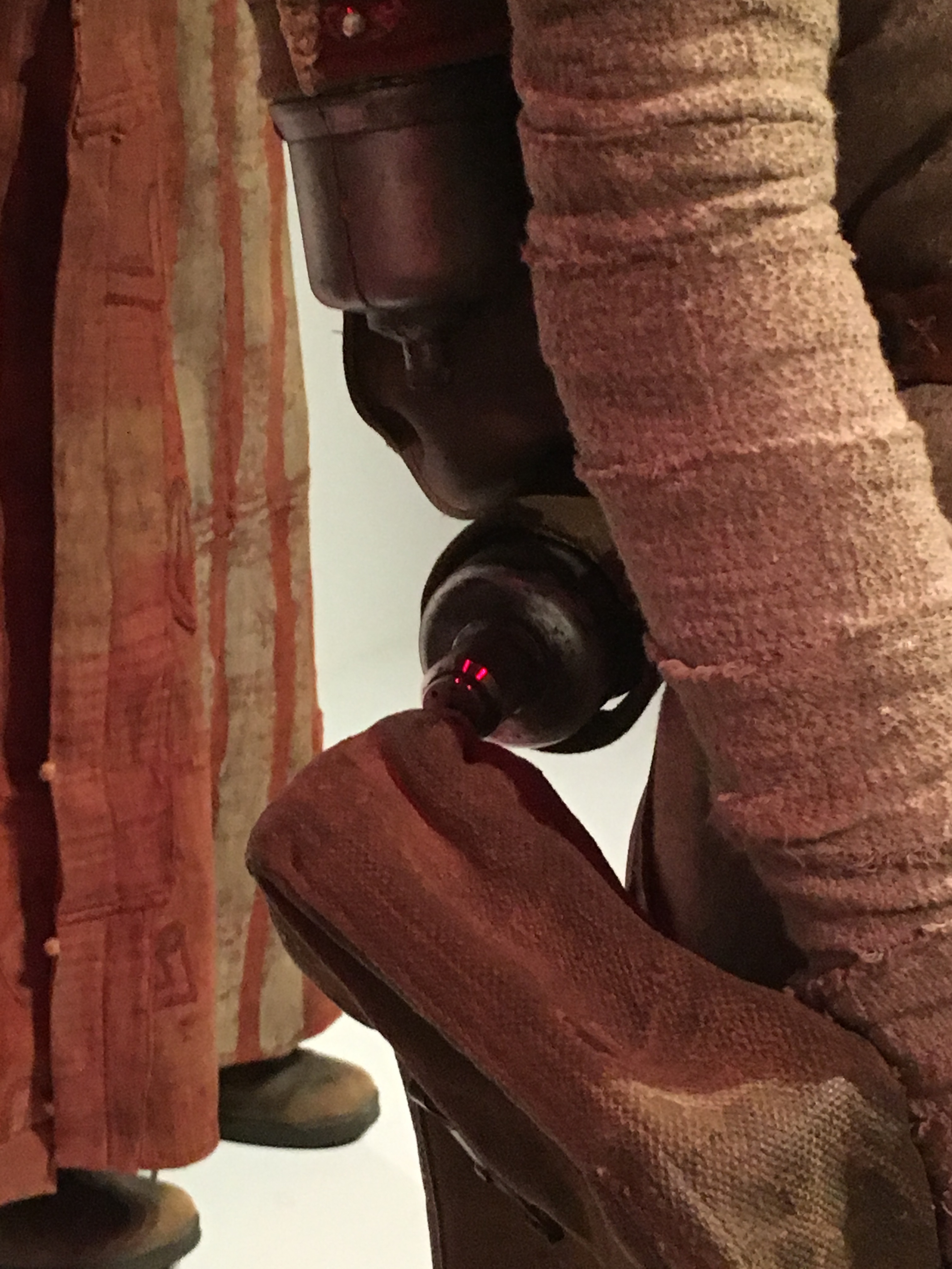

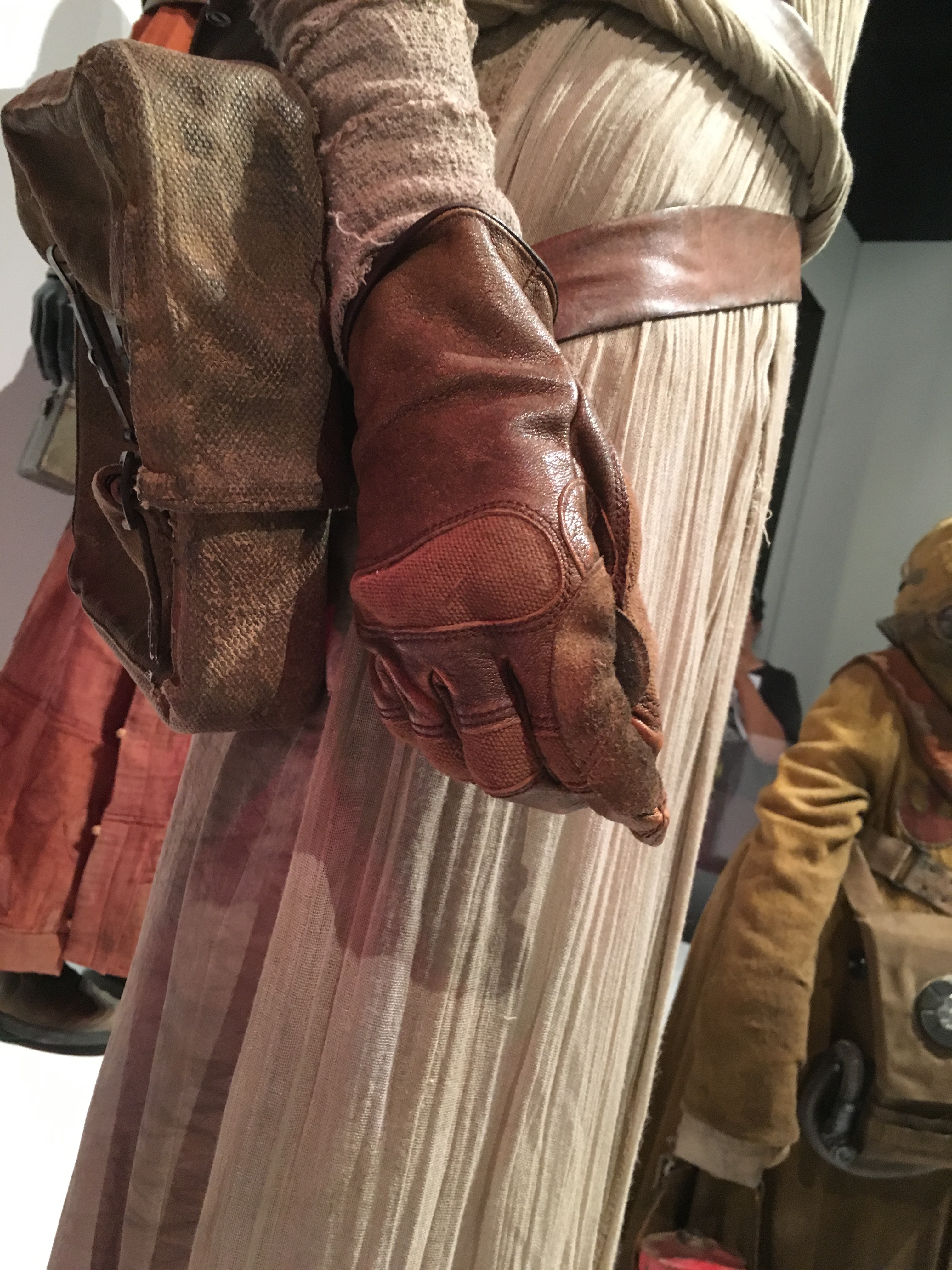

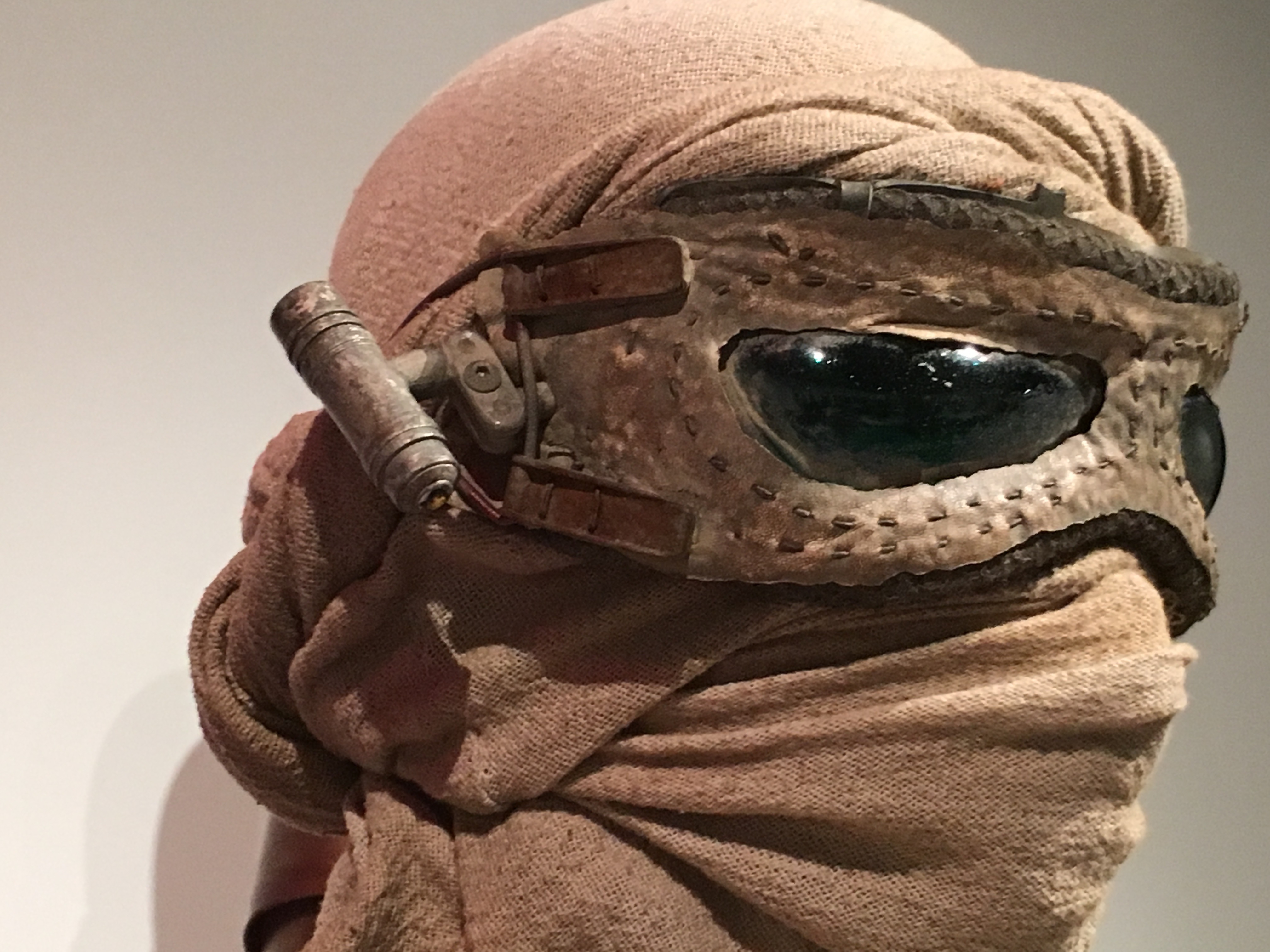

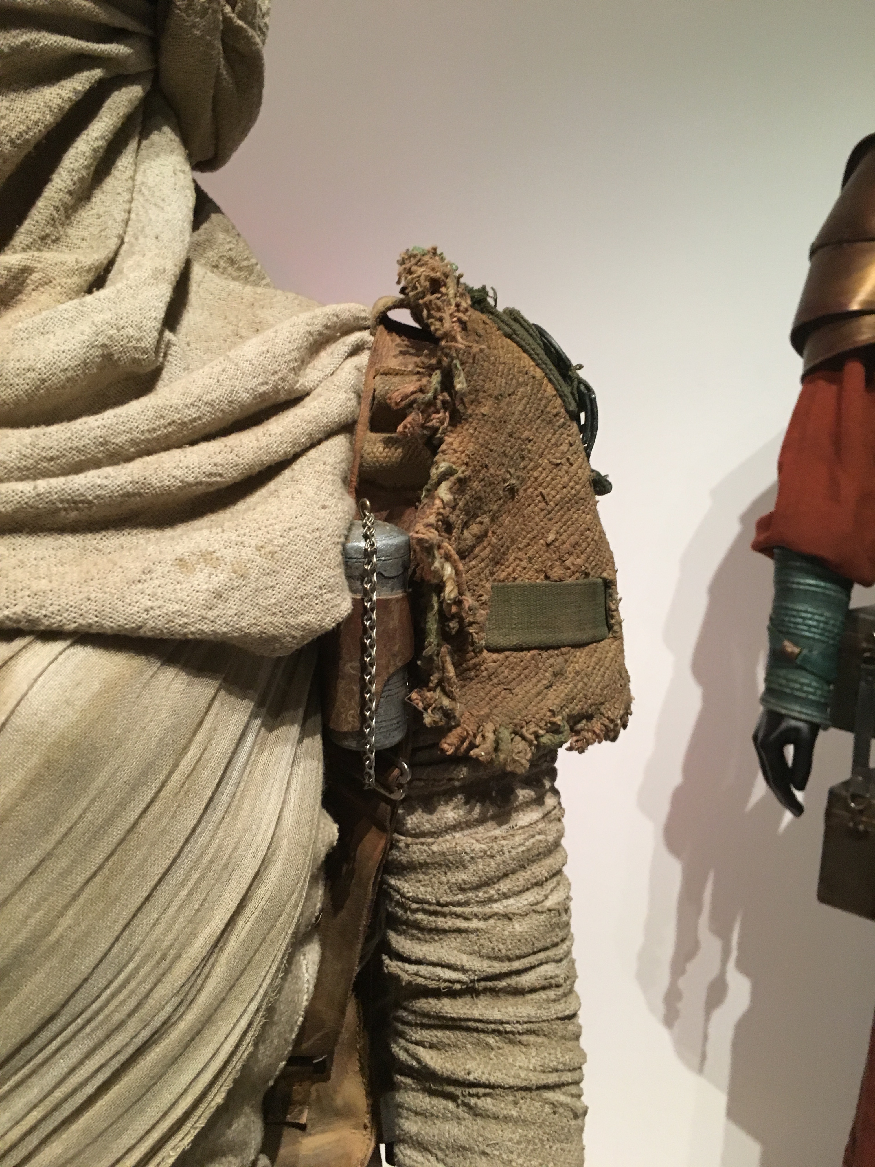

I had a chance one the weekend to go to LA's FIDM museum where they had a few costumes from TFA. So here's some pictures!
View attachment 594678View attachment 594679View attachment 594677View attachment 594675View attachment 594676
This display marks the return of the "sports mesh" on the goggles. It can be clearly seen in the photo of the goggles. I still can't say 100% that it was on the hero pair, but why would they use it for all of these other displays if it wasn't on the hero pair?

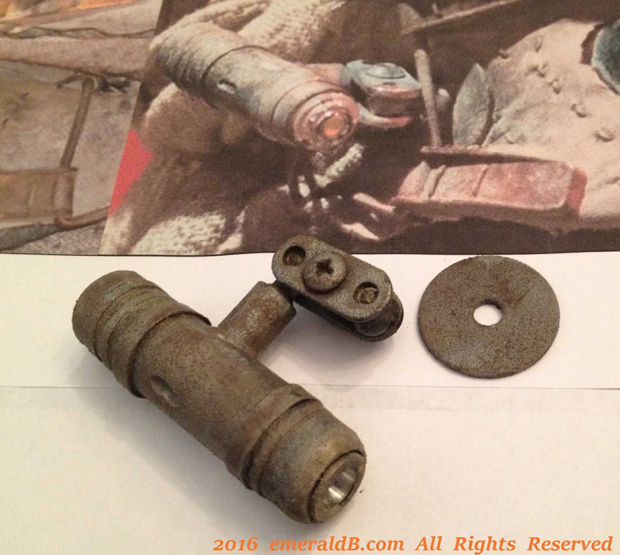

don't know what to think about these display costumes. I do see the mesh and am also starting to believe it's there on the movie version. But these are missing the fender washer between the clips for the light bracket that can clearly be seen on the goggles used in the movie.
Do not trust the displays. They are reproductions of the actual production-used costumes. They were never intended to be 100% screen accurate, just "close enough" and easy enough to be widely produced for promotions and marketing.
If you are going for screen accuracy, the ones on display at Celebration and D23, and versions you actually see on screen in the film, are your best bets.
I think that's because the hero goggles had a working light, and the washer was to keep it sitting straight, whereas this is a cast stunt light, and doesn't need it.

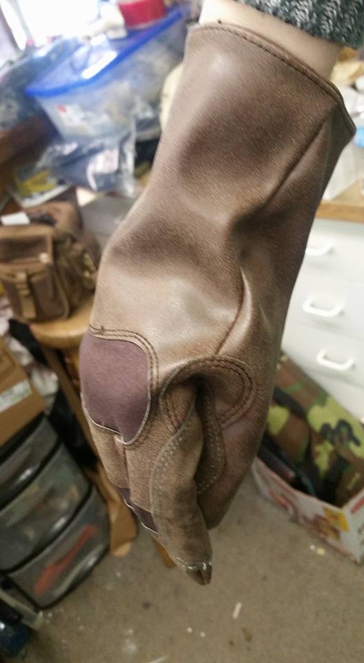

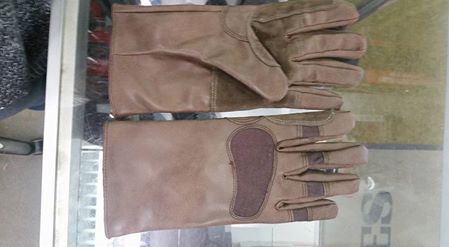

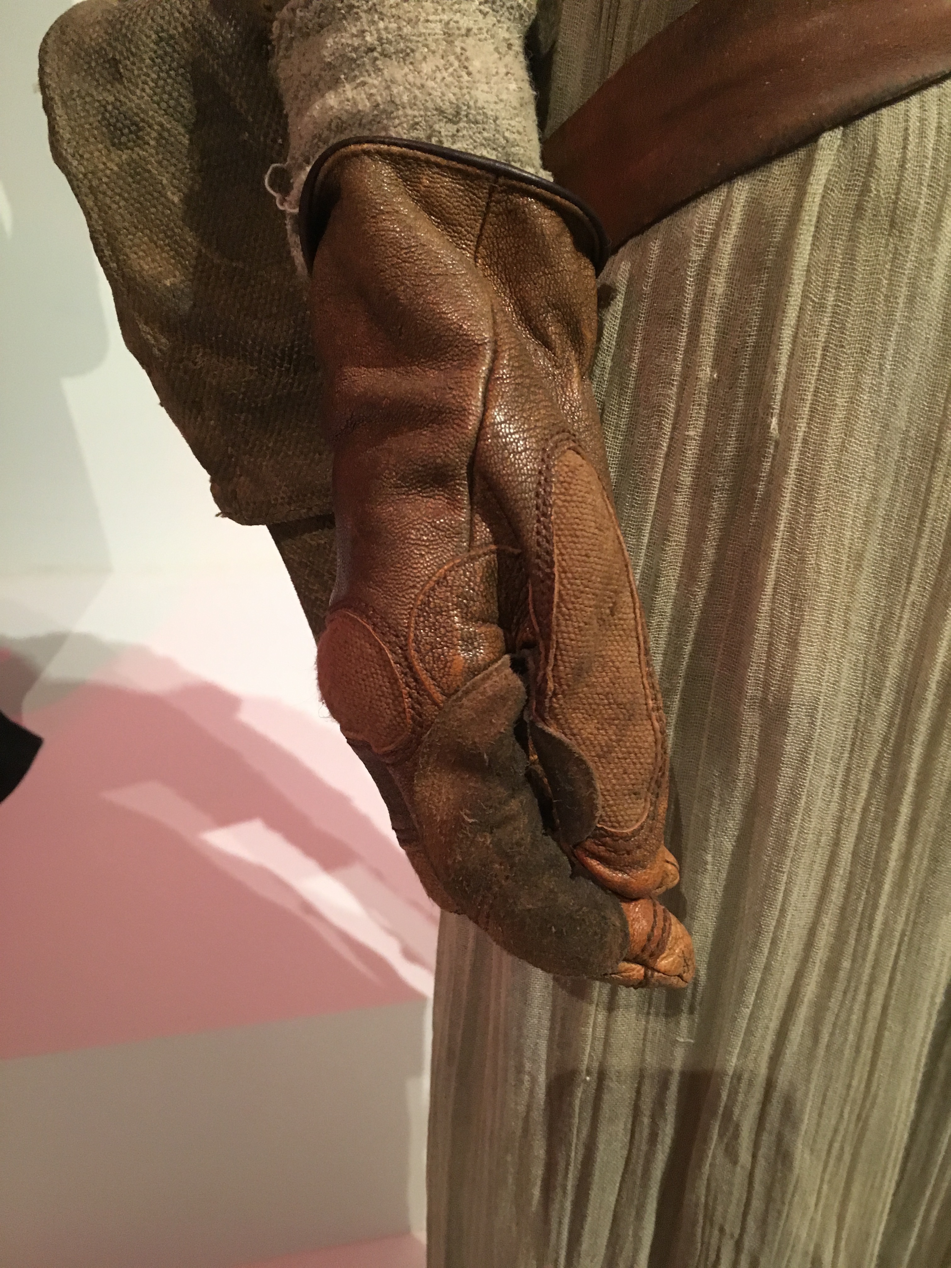

I went for the eBay Rey gloves from Singapore:
overall, they aren't bad for $20.00. They are too dark, but a spot of paint will remedy that. The only details missing that I can see is that there should be a dark brown or black piping along the opening (which i could add) and they seem to be missing the fabric patch on the thumb fronts. (I can add that too).
the main benefit to these is that they are longer (like the D23 gloves) and aren't as bulky as the Petzls (someone can have my pair if they want them).

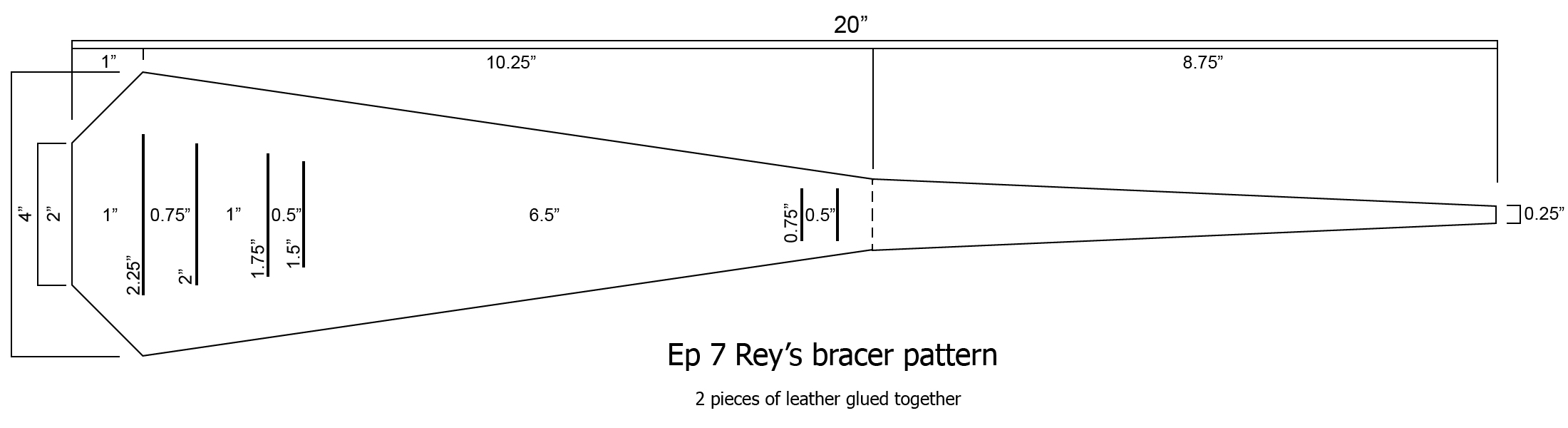

Will this do?
2 pieces of leather glued back to back so it has a smooth surface and 2 different textures.
Sorry, being a little thick there. Where do you glue these together? Are you just overlapping the two pieces and gluing the rough sides together? I'm also not clear about the exact looping on this. I saw a picture later in this thread and I don't see how we're getting from this diagram to there.

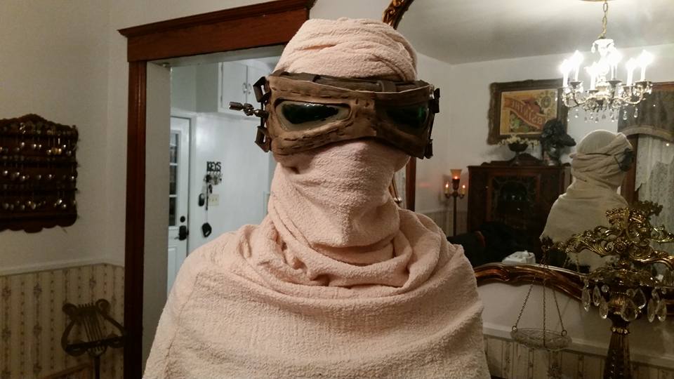

For reference, here are a couple of pics of my progress:
NOTE: The Head Wrap fabric in this pic had been dyed a colour I didn't like. I have since overdyed it with RIT Taupe
I should also note that the wrap dress shown is NOT the Crinkle Viscose i linked to above. That fabric has yet to arrive. The wrap dress pictured is made of crepe cotton. Not bad... but not right. :-/
Thanks!
mark
I think I posted another diagram in the thread somewhere.
Take 2 pieces the same size.
On the back side (rough unfinished side) add contact cement (on both pieces)
Once set lay one piece on top of the other back to back.
Press and let cure (use heavy books or something on top)
Once cured trace pattern on leather then cut.
For wrapping around wrist.
Wrap around the wrist, taking the narrow end go into the first slot and out the second on the big end.
Reverse direction and go around backwards weaving through the remaining slots.
It's actually really easy.
Do the gloves run true to the sizes they have listed?
Anyone else nervously waiting for the Po-Zu boots to be available again?
They do run a lil big. I ordered the Medium but it was a bit big on me. I was going to take it in but that means I would have to re-sew the entire thing. I just ordered the small and it should fit fine. Loving the fact that they are only $20. If you feel the medium would fit you then you can have mine.
