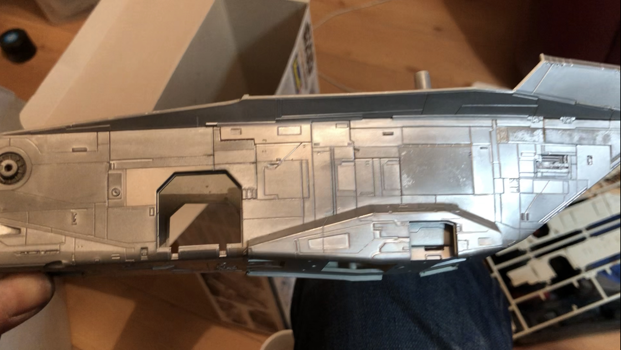

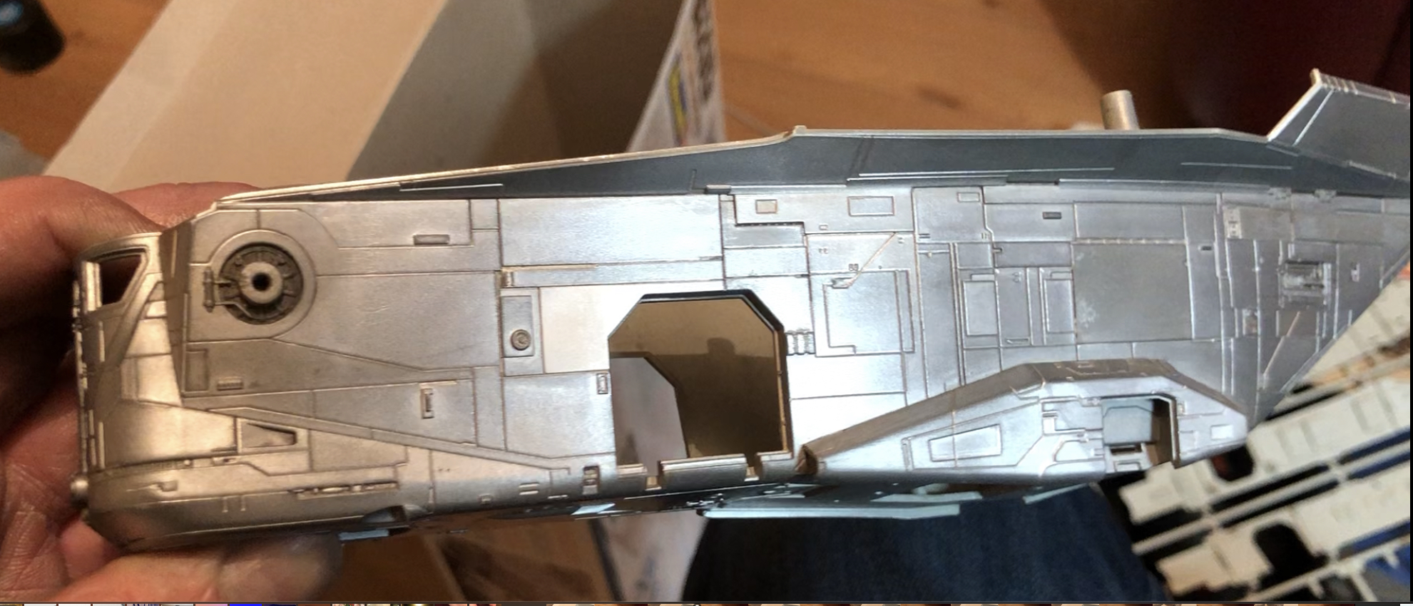

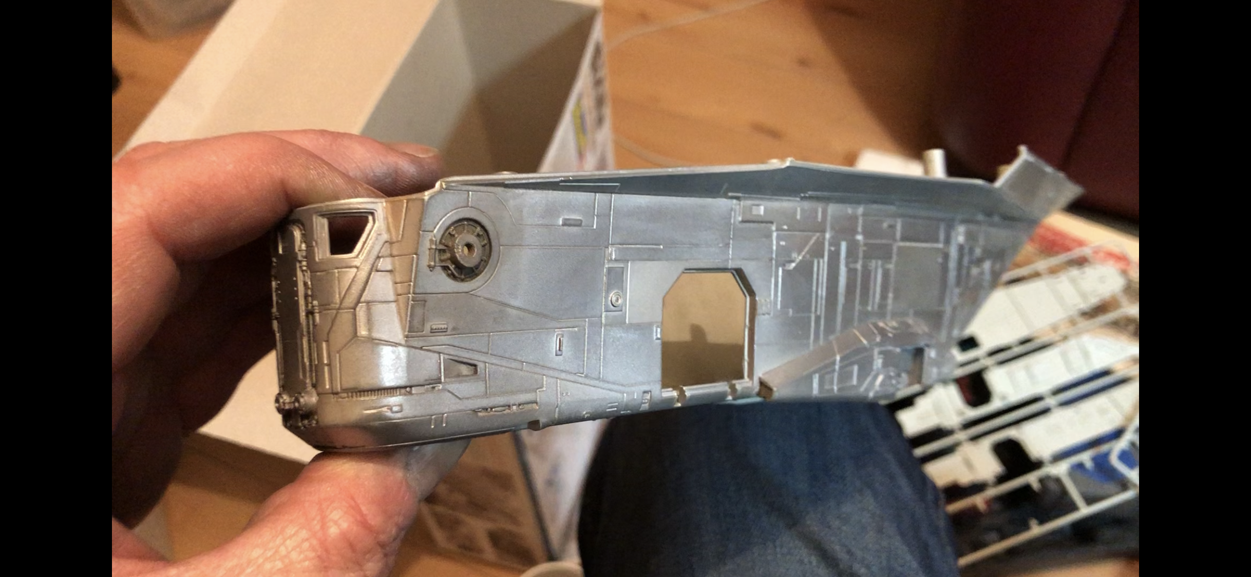

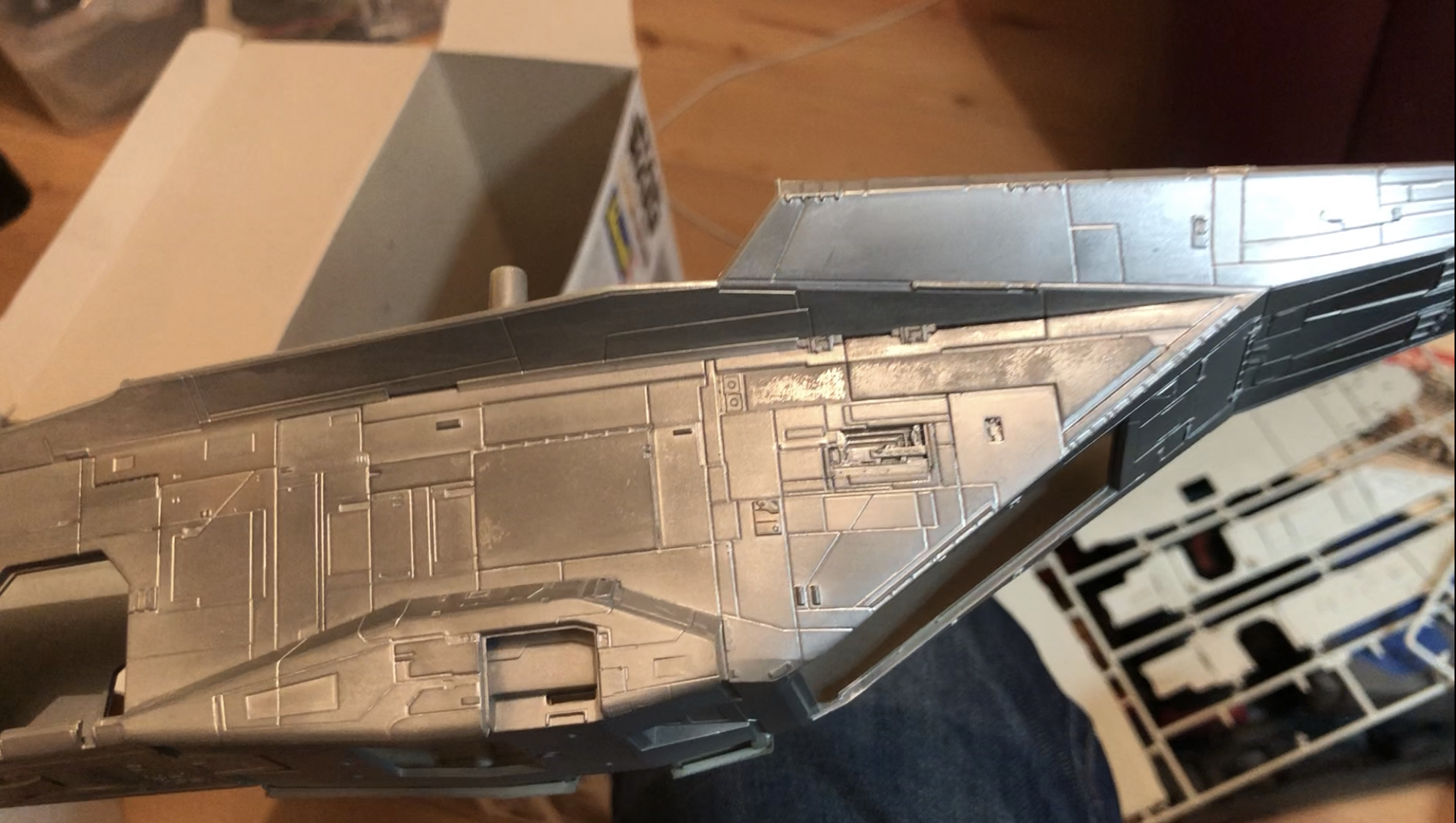

Not sure if I can upload iPhone video, but this is the Revell airbrushed in Mr Color chrome, different panels are Mr Color Aluminium, some Archive X lark dark also
This is me experimenting, not really used to doing metallics

Vid not working on my phone, but that doesn't necessarily mean it won't work on others.
Looks good. Did the pebbled texture cause you any problems?

No, absolutely not, had to fill in a couple of sink marks though…one right in the middle of its ‘face’ above where the two red lights are, one on each side above the guns, & two on the upper top piece near the front of the wings,….you’d never notice them on a dull SW model, but on a metallic ship, it catches your eye

I've never used Mr. Color chrome. Did you do any buffing on the finish, John, or is that the sheen straight out of the bottle? Glad to hear the texture wasn't an issue for you.

The Mr Color sprays out quite matt I just left it for 10 minutes or so & buffed it up with a paper towel, then I sprayed other panels with the aluminium shade which is a wee bit darker & buffed that up
I also used Archive X dark lark misted on, then put tape over it & pulled it off removing some of the paint, giving it an oxidised look….if it doesn’t look that great, just buff it with the paper towel again & the AX will fade away

Interesting stuff. Based on some of the reference photos of the ILM ship, the texture actually may help give the hull that pitted metal look. I'm glad to see all you pioneers testing out these various paints and methods for the rest of us to steal!

John mentioned it was an issue, though he wasn't as troubled by it as me. And indeed his metal paint shows it is an issue.
