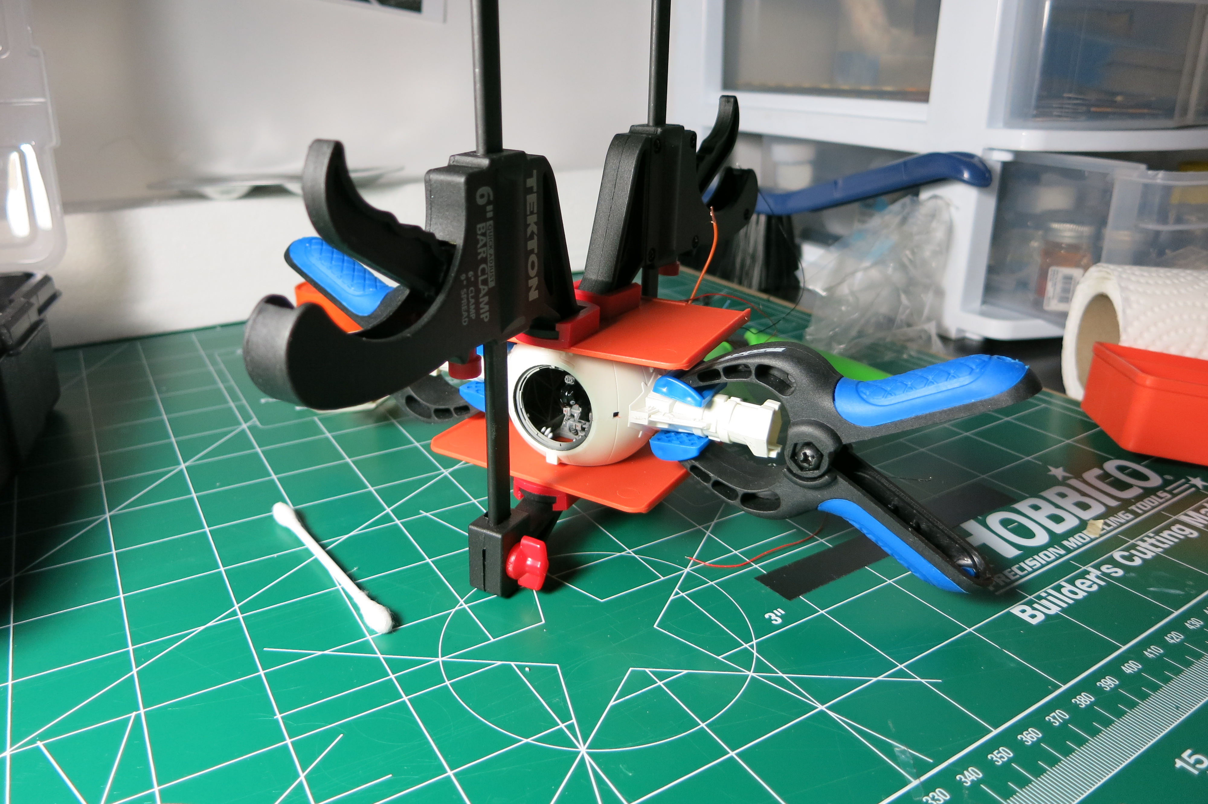

Gluing two halves together, since i made a lot of extra work inside i needed these clamps to keep everything together meanwhile glue does his work, you can see all the wires coming out from the bottom, i´m going to put all resistors and doing the soldering in the space allocated in the lower hull
You can see aso the fiberoptics how they go to the smd under the pilot´s chair, i made some mistakes with this, i´ll explain later. in total there are 9 smd leds and 5 resistors,
readi to close the lower hull
I made a couple of connectors in the back part, one for the positive and one for the negative, sorry i forgot to take pics of how they are made from inside, but are those kind of small female male pins that are used inside computer connections.
And here is the hull glued and closed

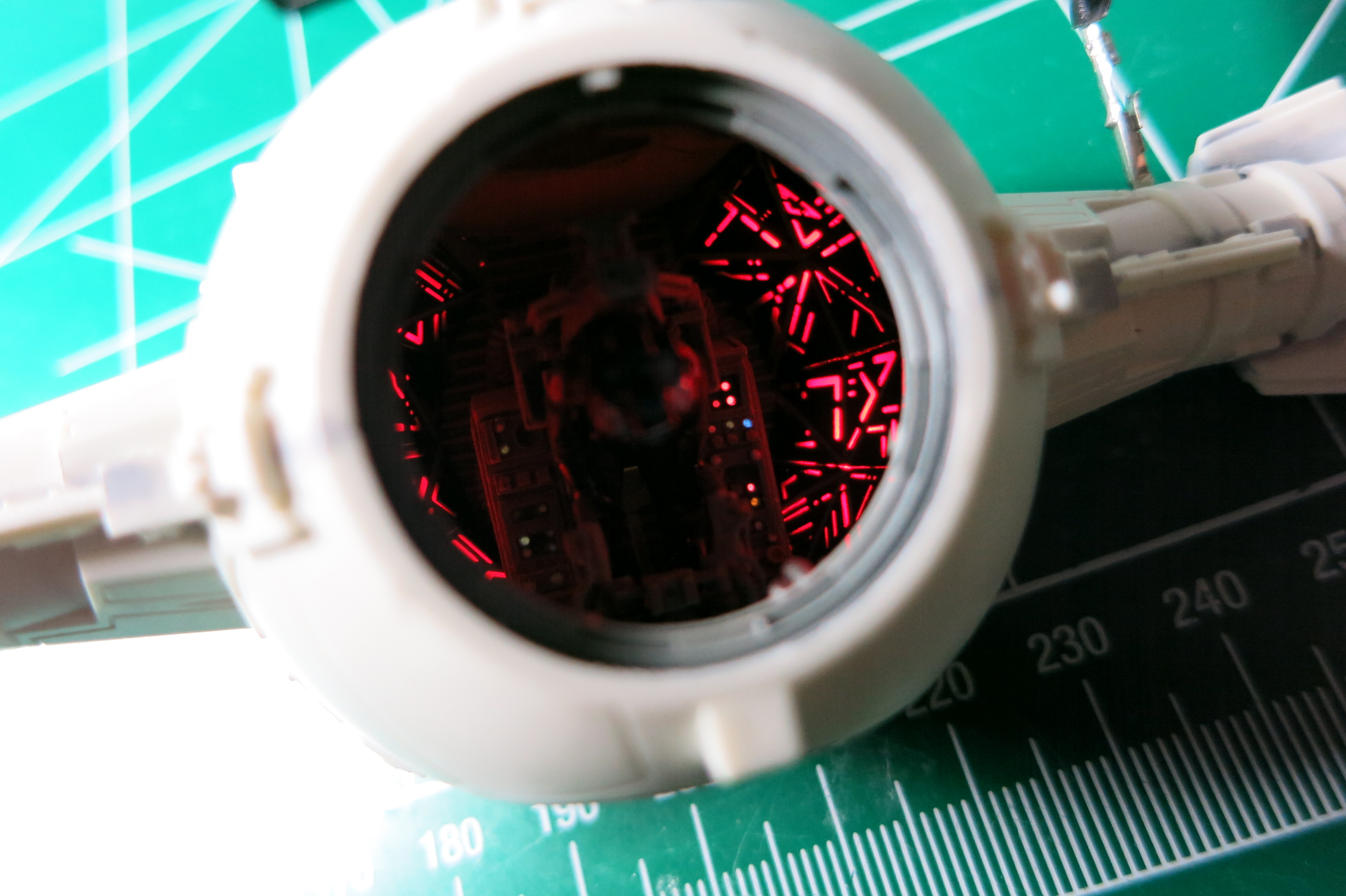

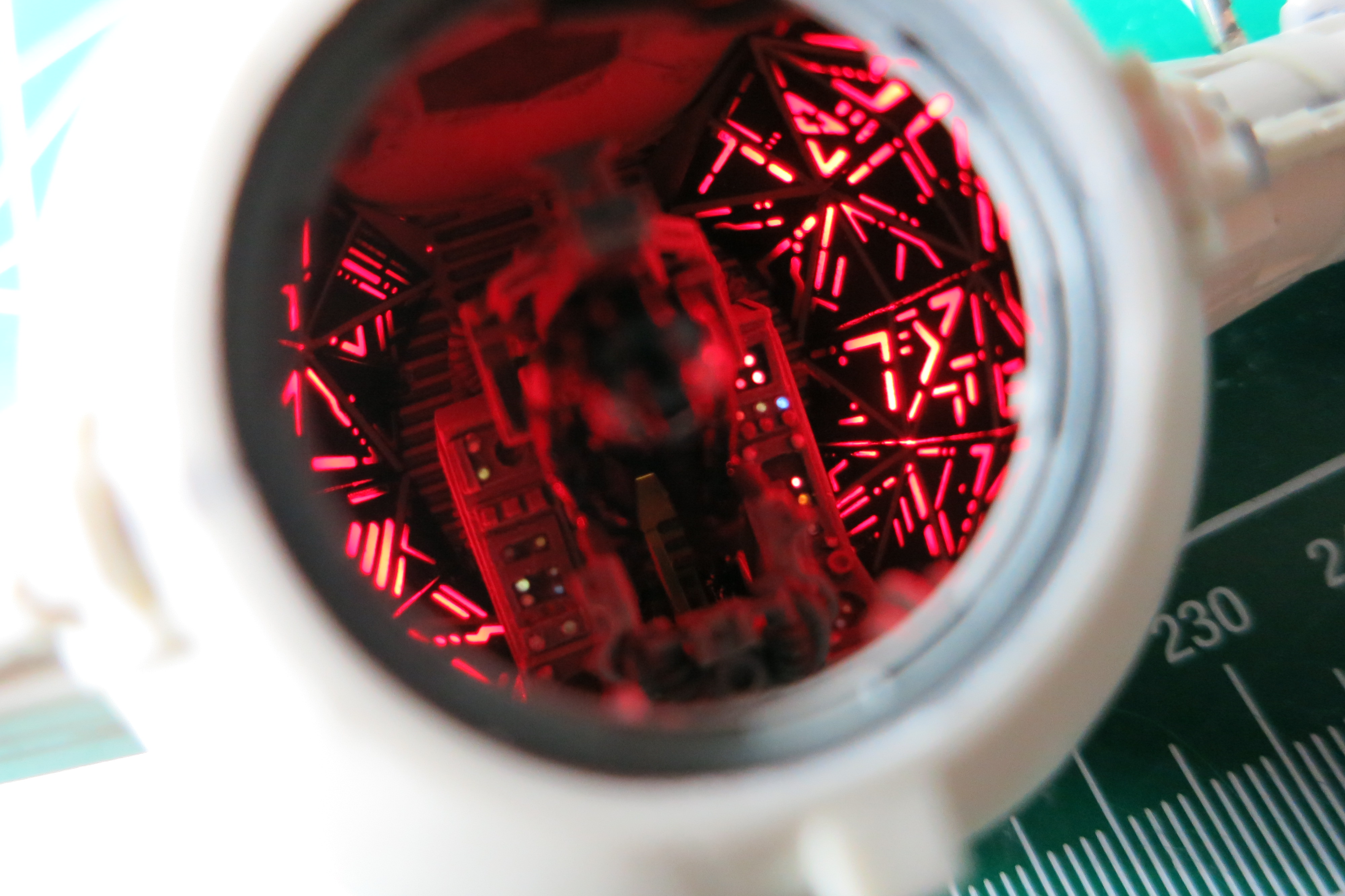

And here you can see it LGHTED UP :eek
Sorry if the photo is not so nitid, i don´t have a professional equipment.
Now, you can see the fiber optics don´t bright as much as i would like, that´s because i force too much the angle of the fibers form the console to the lower smd, if i knew it i just would have put some smds inside the console and avoid the fibers, is a small model and there is no too much room to make complicated things. I learned a lesson here.
There are also a couple of fibers that go to the engines behind, but forgot to make a proper photo
Anyway there are some color dots here and there and i think the main red lighting works nice.

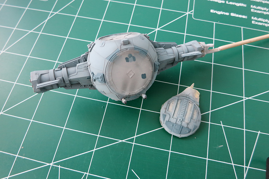

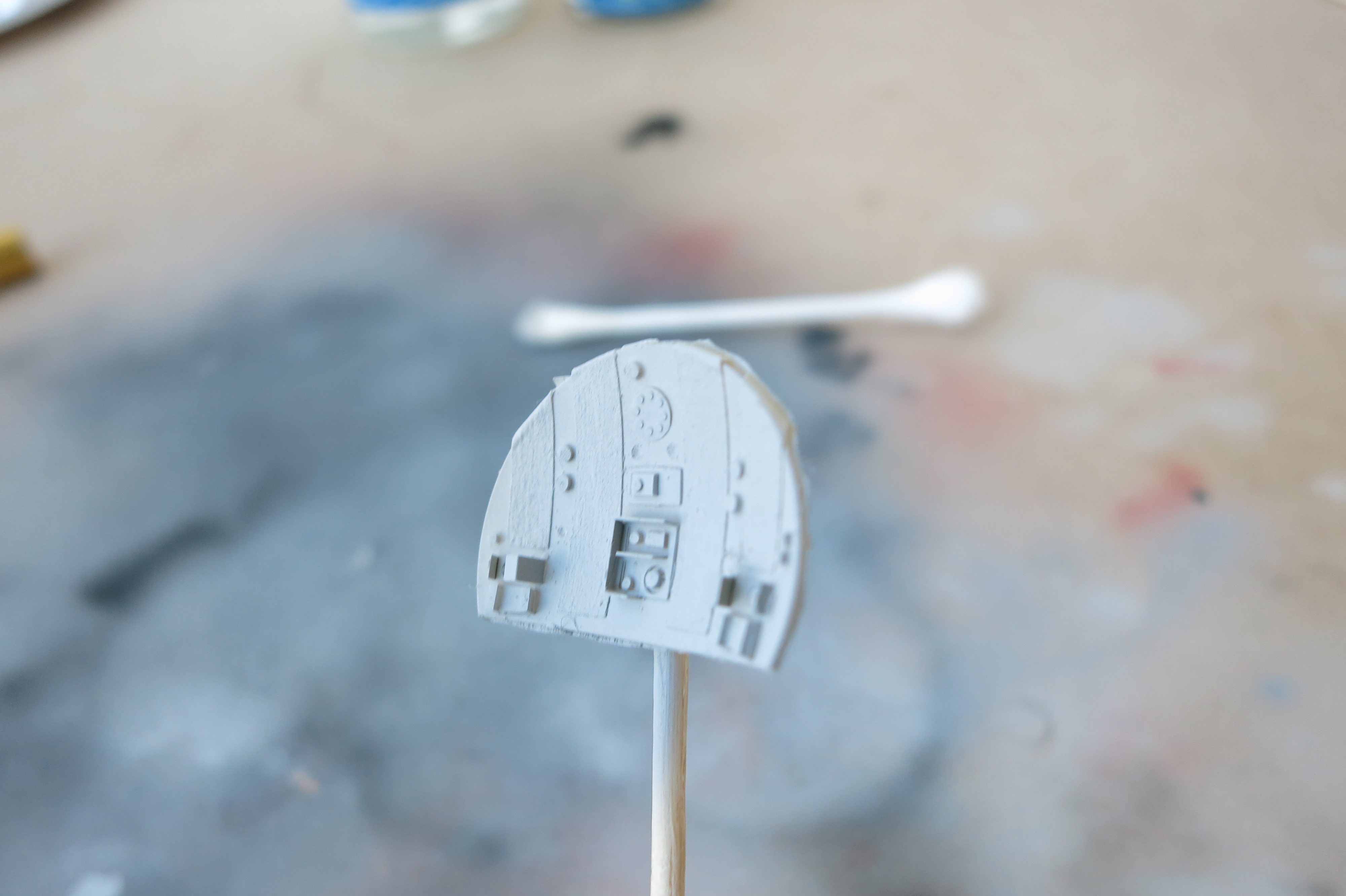

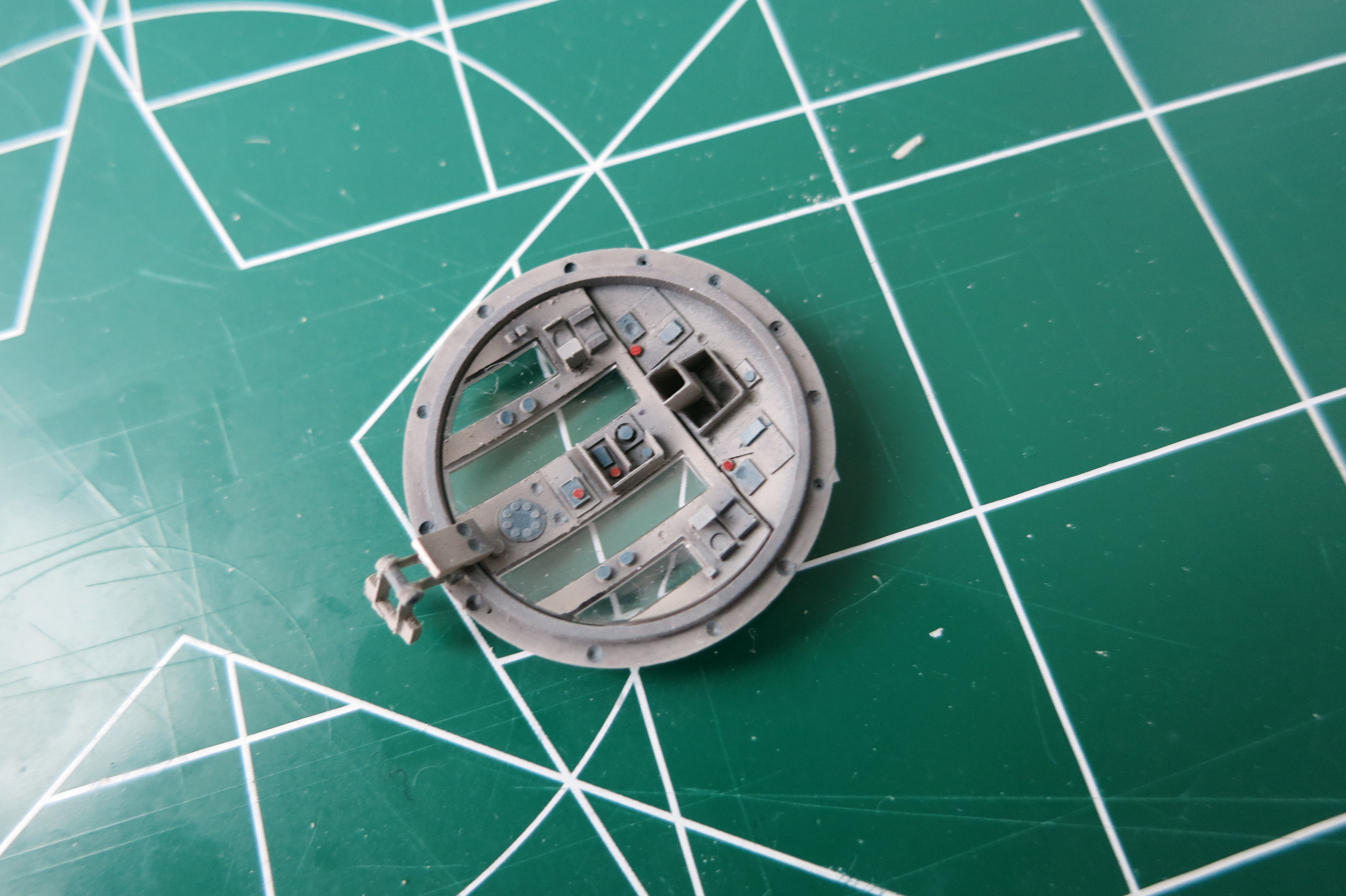

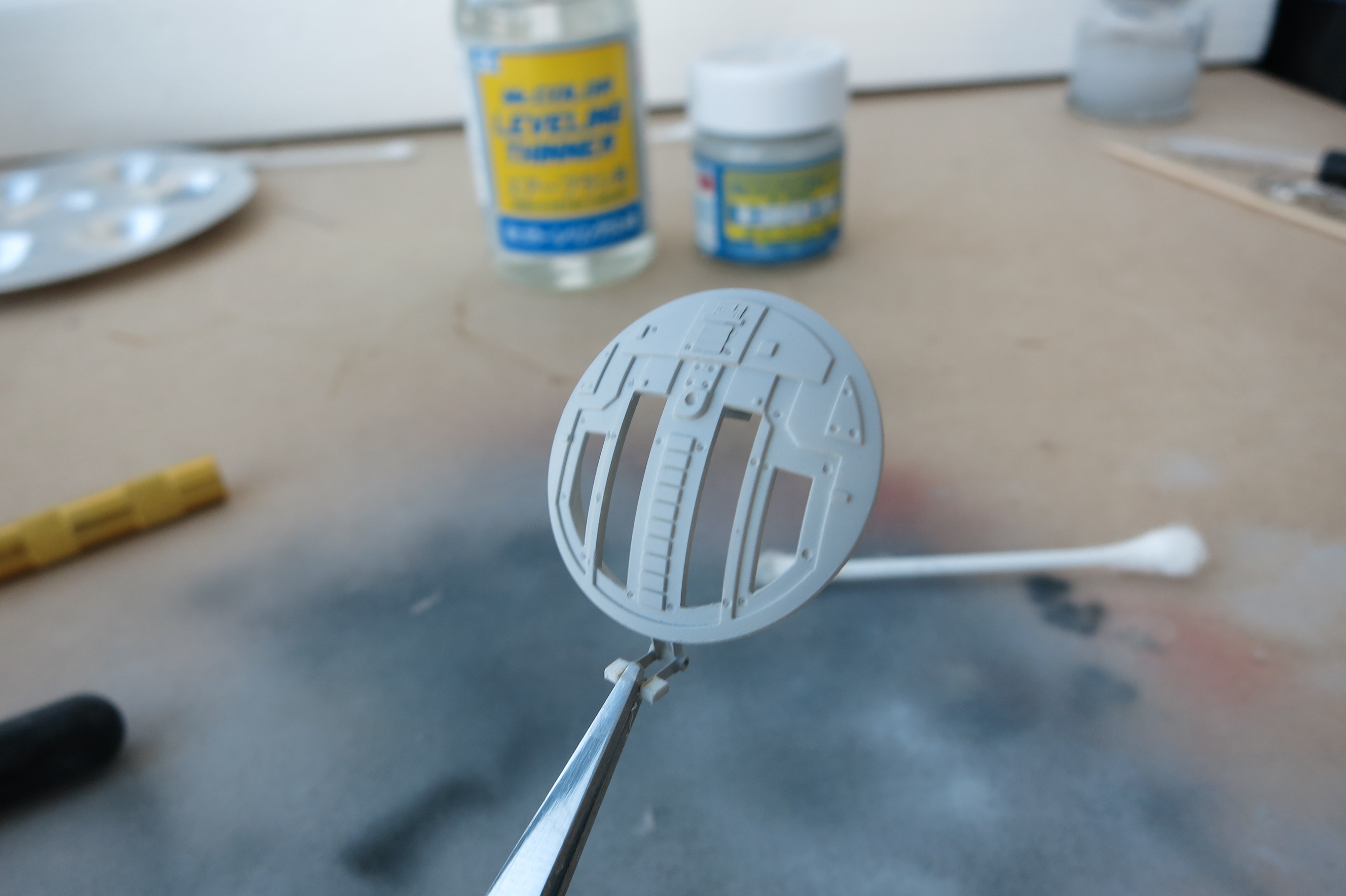

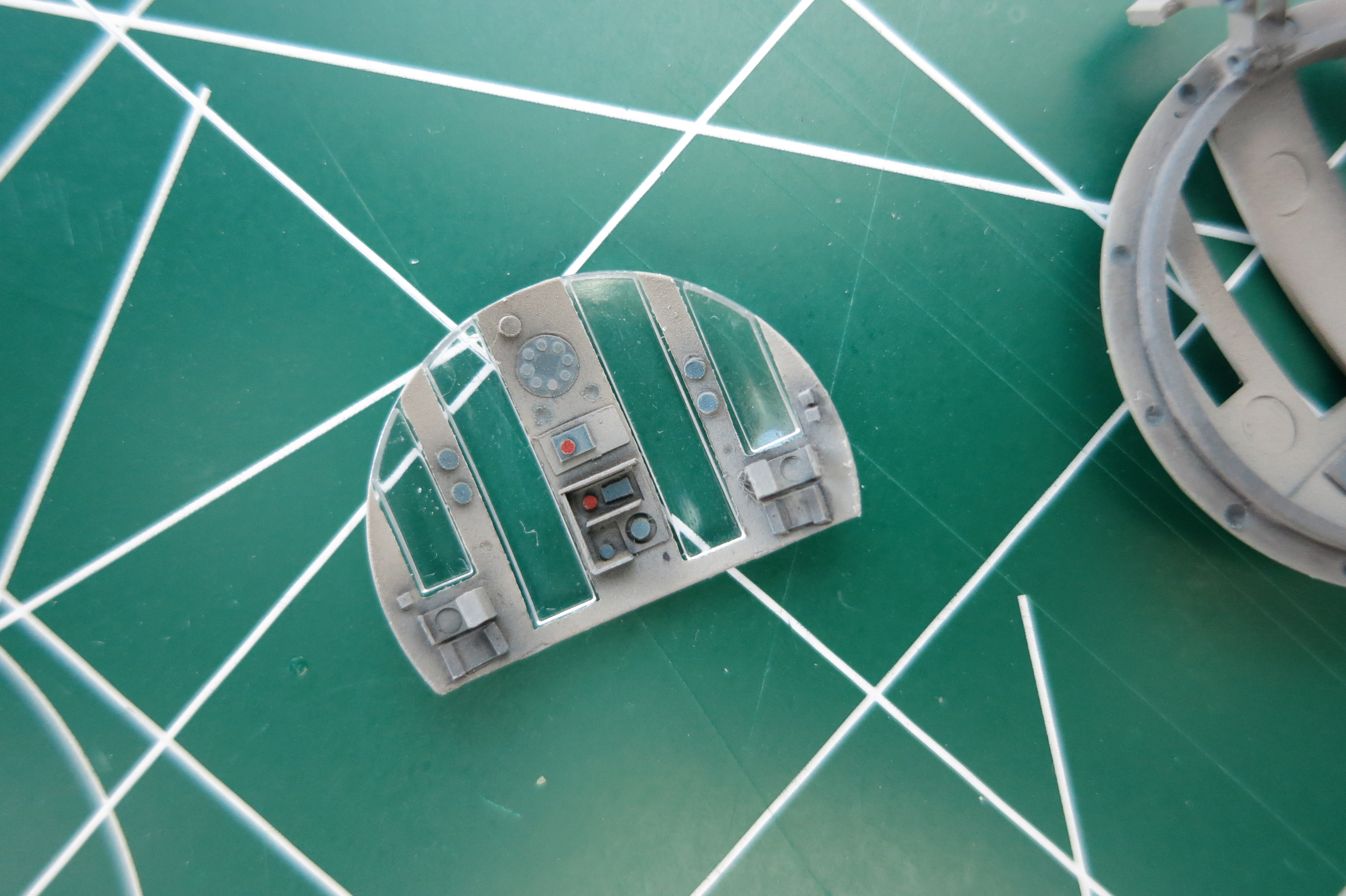

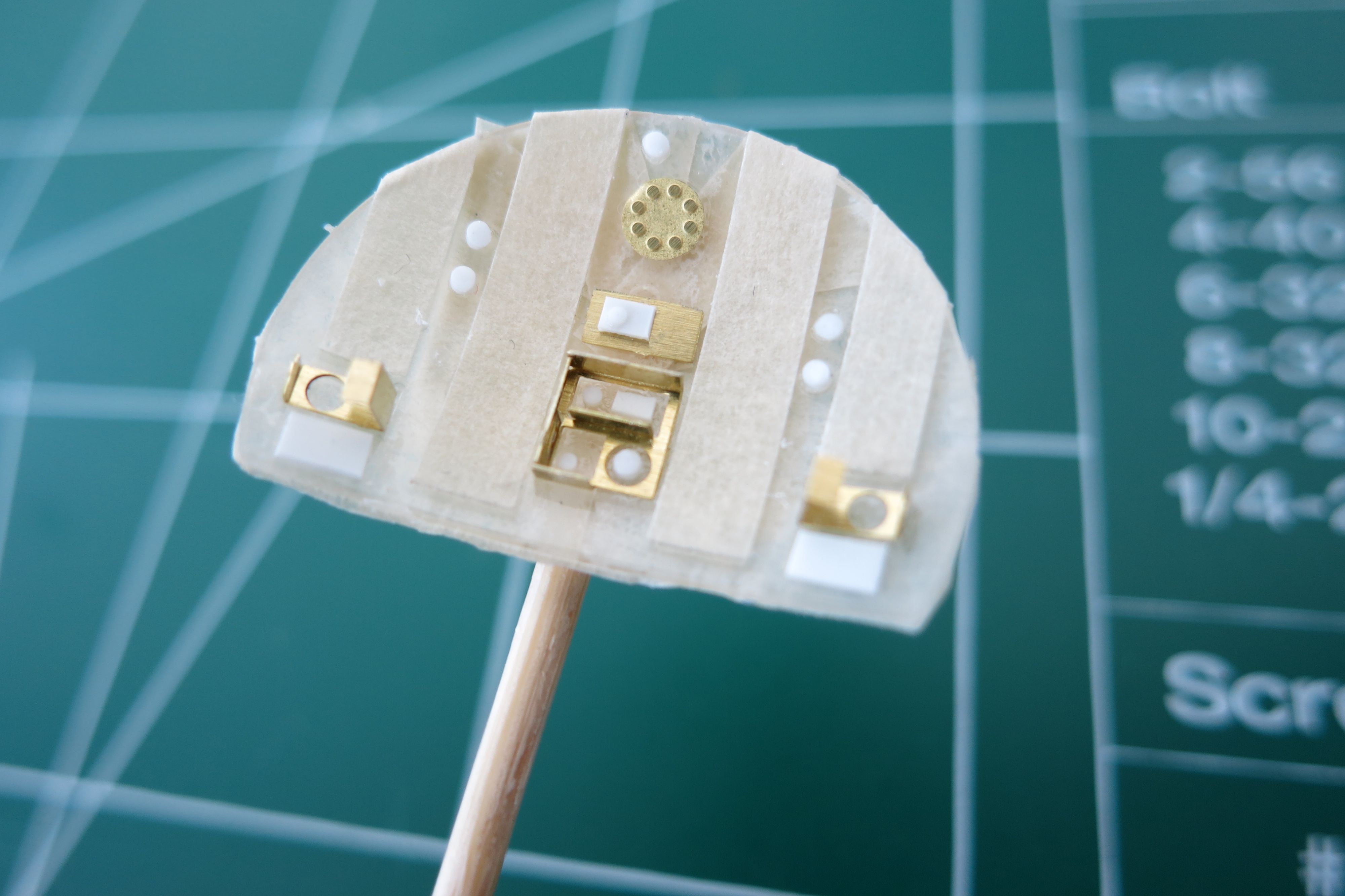

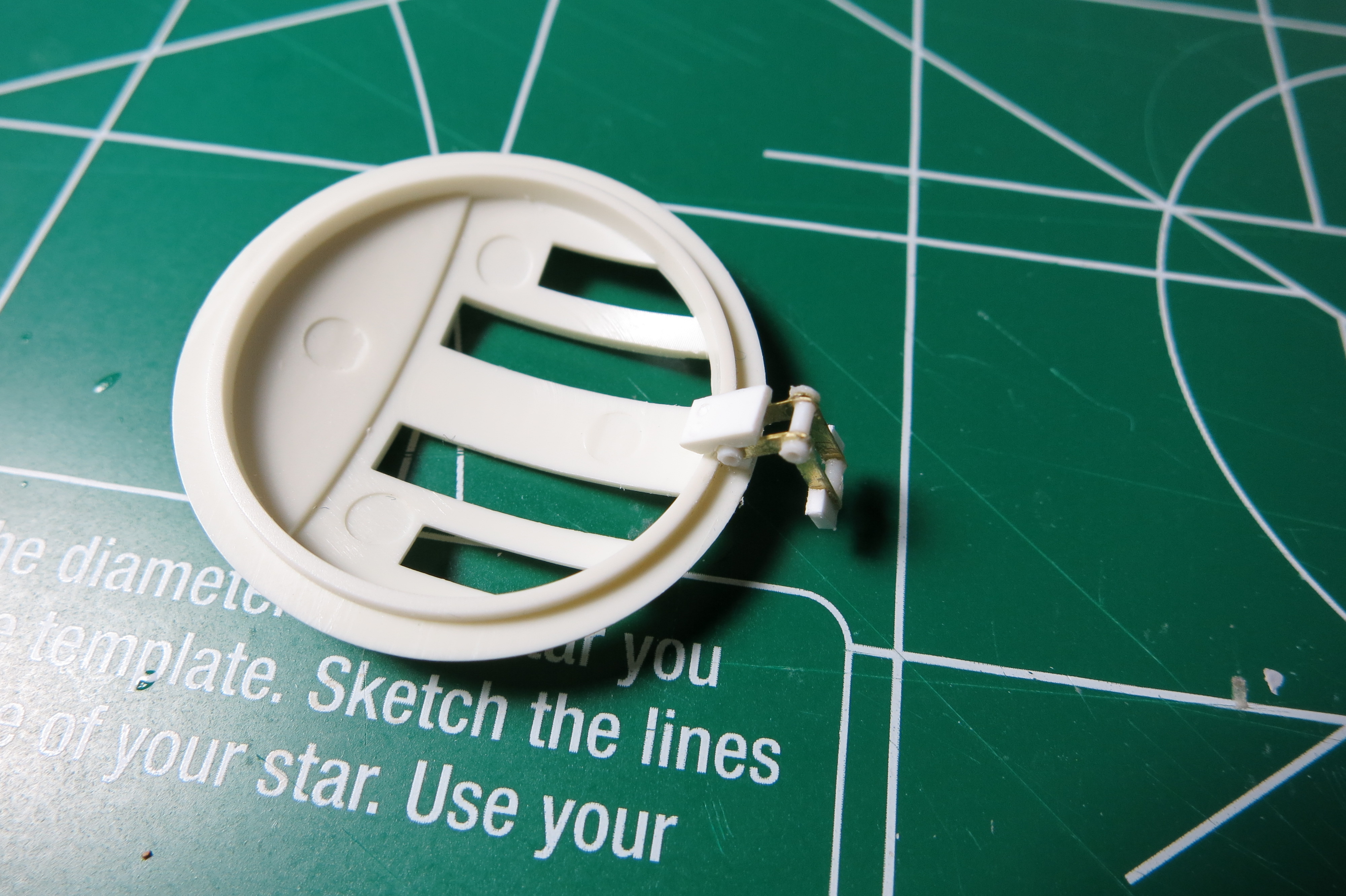

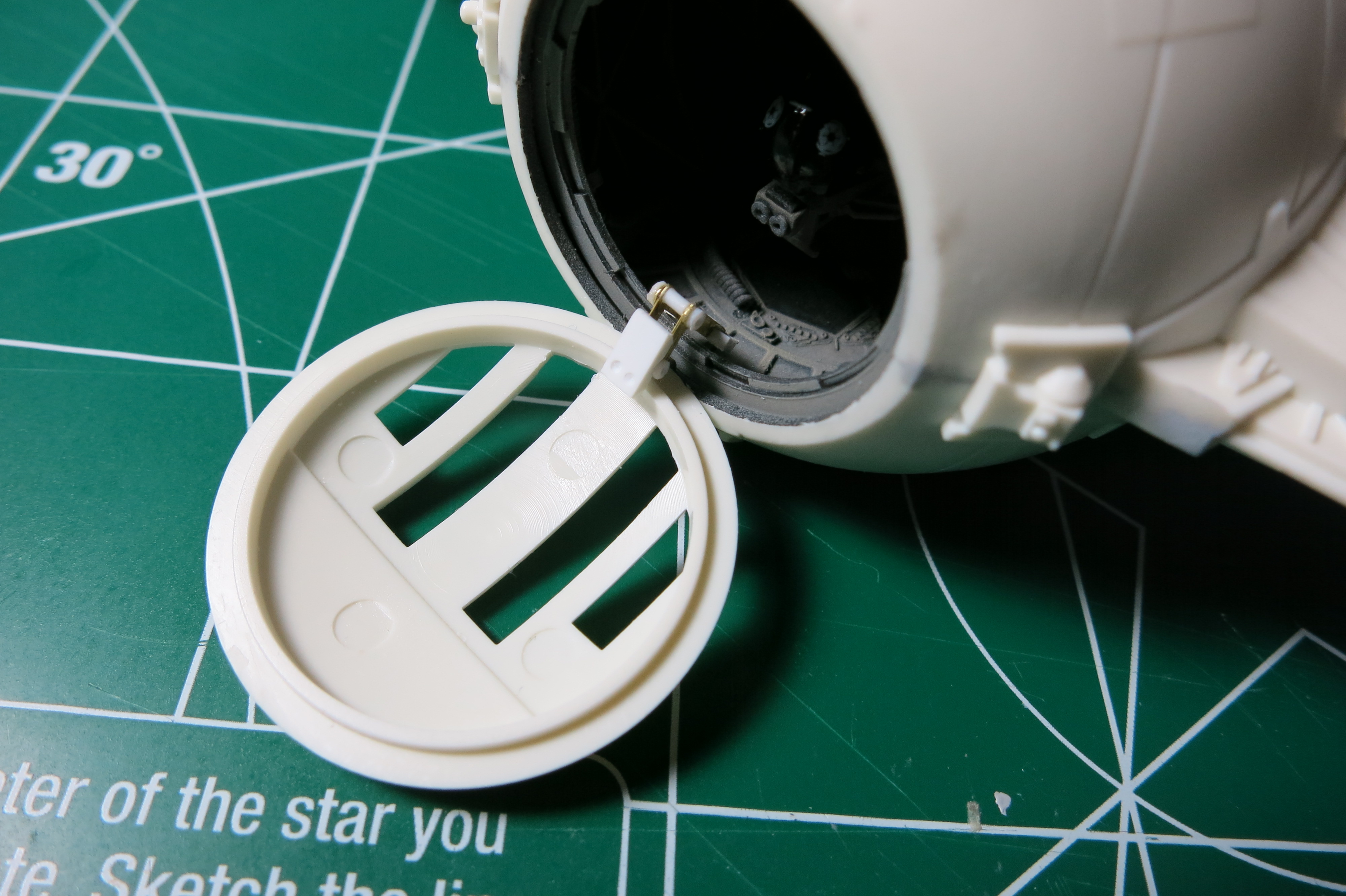

Time to work on the upper door... since i´m going to leave it open i had to build some hinge (not sure if this is the word) to keep it in position and make it believable.
And also i will add some detail, i making some kind of interpretation here and not going to use all the photoetch structures, did some test and i didn´t like the result... it makes the inside part of the door too busy.
Would make sense to use them all if i left the hatch closed to match this production poto,

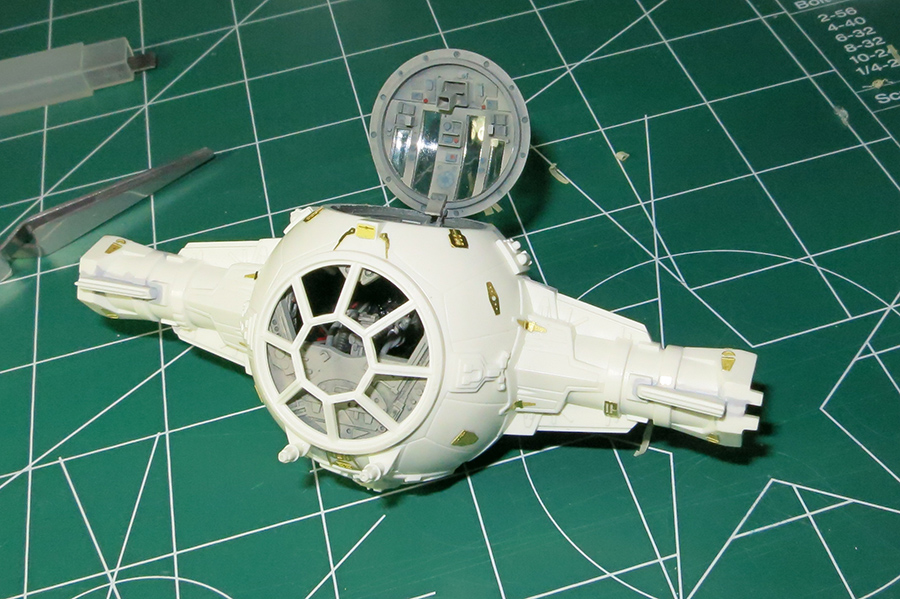

but because i already made some modifications on the inside they would never fit if i Hypothetically close the door, i even thing the paragrafix pieces are not in scale, they are sightly bigger.
This is my interpretation, i´m using the clear piece that comes with the model.
Since clear plastic is too sensitive to cyanocrilate, had to use another kind of glue to stick the brass pieces to the plastic, is that kind of modeling glue used for clear pieces, is not so strong as ciano but if i´m carefull handling the piece i think i will be ok.
This is how it looks after priming.
and this how it looks after removing the mask tape and applying some color and matt coat.

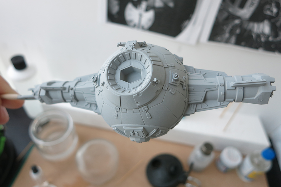

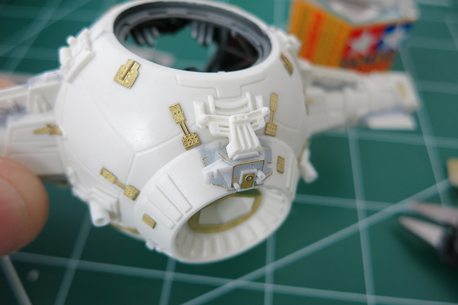

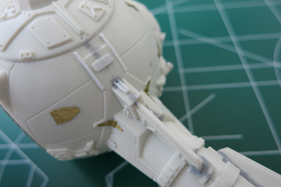

Have been detailing the hull with the paragrafix set and some extra modifications i made following some photos from the studio model: enlarged the engines exhaust, one hole here other there , changed some plain greeble for something more accurated... and not much else,
Working with brass pieces is a pain in the.... i really hate to work with cyanocrylate not too much time to make adjustments, and it can mess everything in a moment if you are not careful enough.
I decided to make all the work with the photoetch parts once i had the hull completely glued and sealed, before i started this project i watched some video in YouTube about a guy working in the same model and he made that advice, that way you avoid problems with these delicate parts until it´s completely necessary to put them on the model... , and i´m glad i did it, if not with all the stress i applied and the clamps i used when sealing the hull.. probably i would have had more than one accident.
By the way, i discovered this tool in Facebook some days ago, and before i could think twice i was making an order to Amazon... i guess many of you already know it, but in the case someone doesn´t .. it´s highly recommended,, it makes really easy the process of cutting plastic and greebling.
And after priming,...sanding some imperfections and priming again this is how it looks.. this is one of my favourite parts when making a model, when i can see everything as a piece.
This Mr surfacer stuff i think is the best i have used for priming, Vallejo is easy since it´s Acrylic but you can´t sand once applied, it tends to chip off, And the Tamiya cans, they are good but pretty expensive and hard to control in a small room.
Have to assemble / prime the Wings and frontal frame.. and i´m ready to paint.

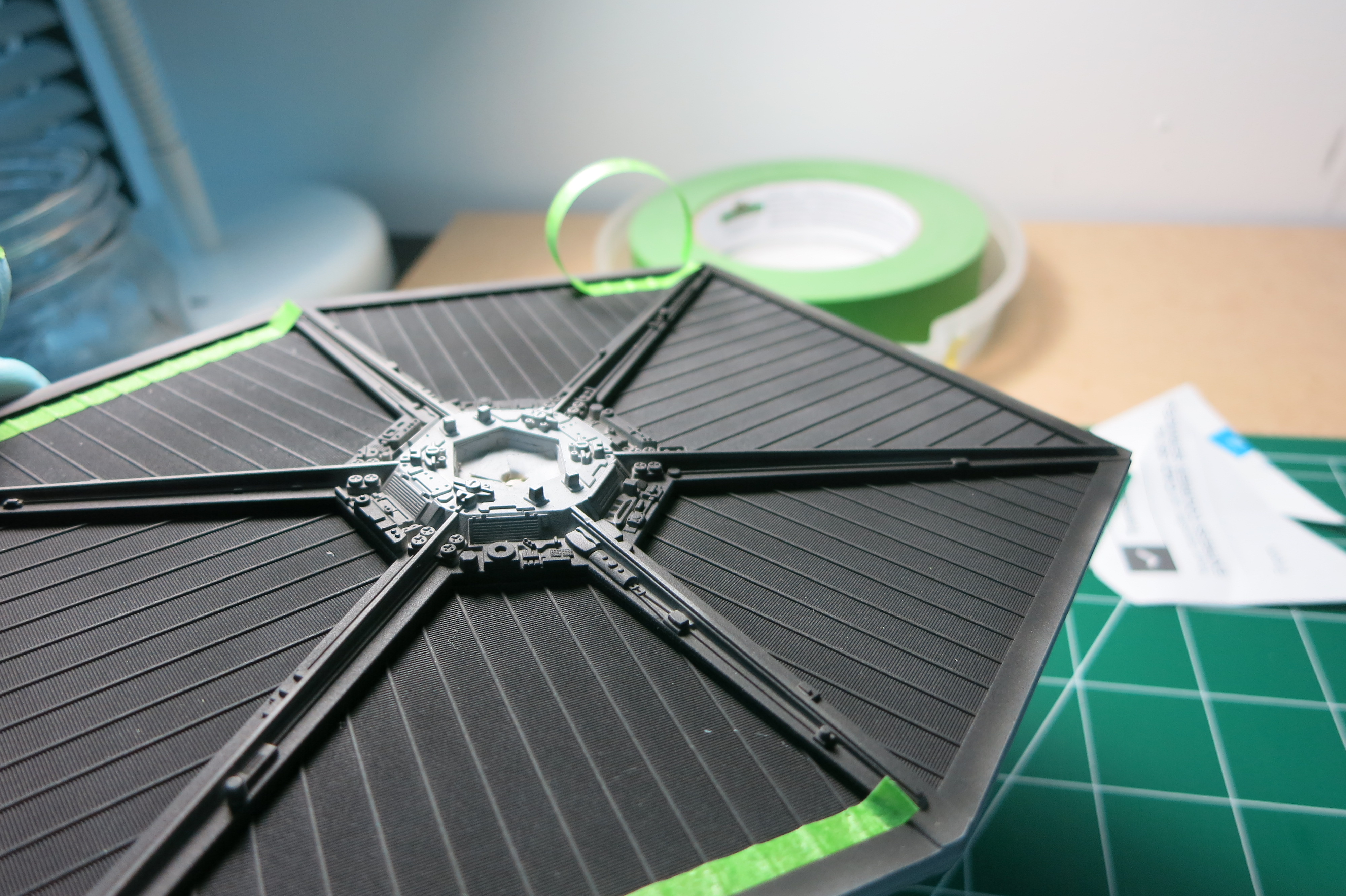

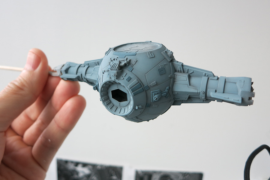

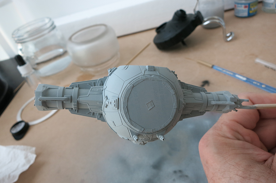

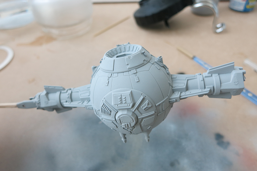

So i have been working on this for awhile... priming everything painting and detailing, some progress below

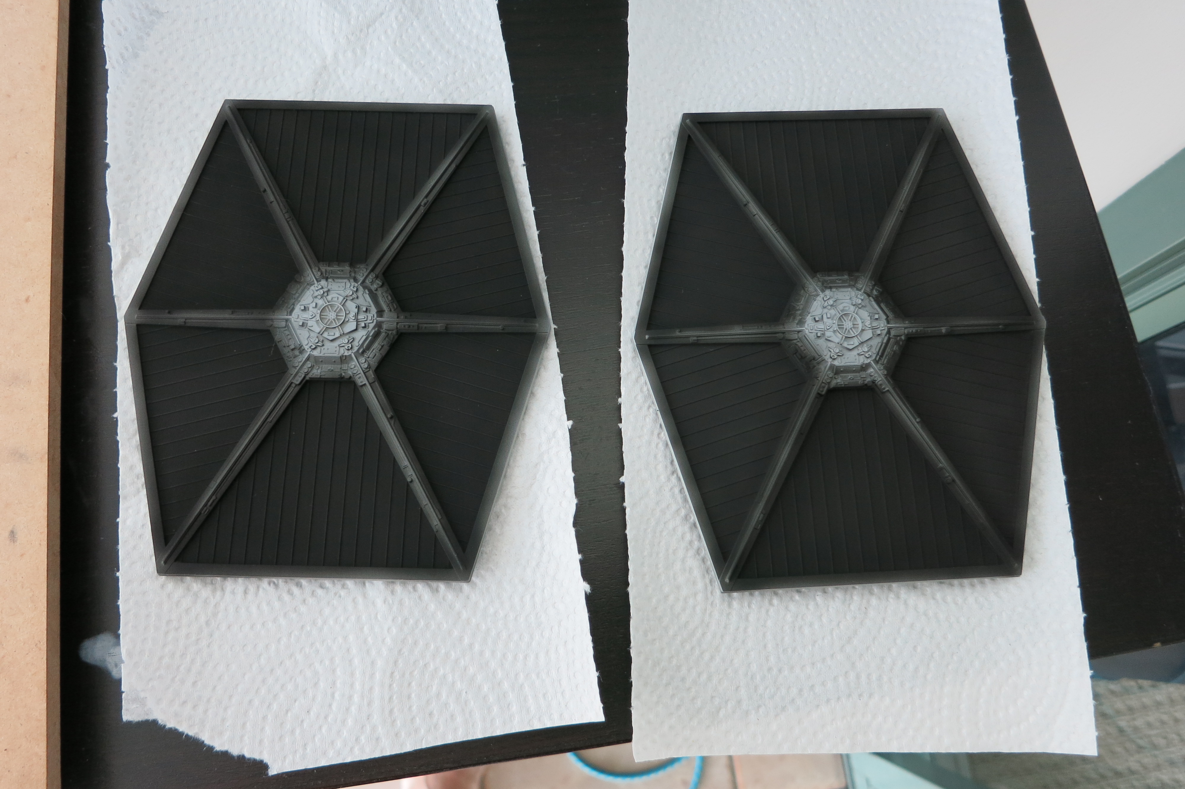

After thinking and thinking and thinking and double thinking i decide to full assemble the wings before painting, i knew it was going to be a pain to mask the black panels but i really hate to play with glue after painting a model, many things can go wrong, and masking is just a matter of patience for me, that external frame of the wings is really thin so i had to use very liquid cyano and glue it through Capillarity, it would have been a mess if those pieces where painted already.
But definitely the paint part is more easy to do if you paint the three pieces of each wing before gluing them.. i'm just saying all this for your consideration in the case you wanna build this model.
I painted the inside panels in mat black, and then made a coat of gloss varnish, the polyuretane one from Vallejo,, i made coats coats and coats but i couldn't achieve the gloss effect i wanted, i should have painted directly in gloss black i f i knew this, another lesson learned, some people mix black with some metallic color but i really don't want to do that, will go this way and after painting the grey part and unmasking if i'm not happy will mask the grey frame and paint the inside in gloss black again.

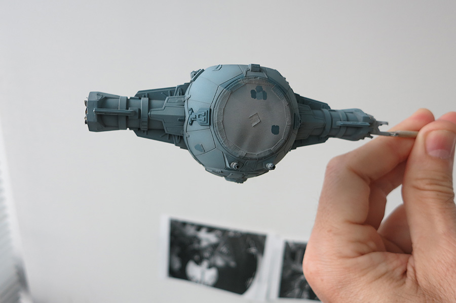

For the grey i went with a mix of medium blue XF-18 / sky gray / XF-19 and white, i resist to paint everything in plain color, i insist i'm not making a replica, and my philosophy is everything has some kind of wheatering, even if you have a shiny car just out of the washing machine, as soon as you take a ride with it for some KM, it will have weathering... more when we talk about war machines like this
But i don't want to exceed to much that weathering, ties are not so dirty like the rebel machines, so i will go with some preshading, and then tone it down until is barely visible, no panel lining, no washing... that's it
I forgot to take photos of the main hull preshading but after painting, masking and everything this is how it looks, took photo with white background and over the cutting mat... this tones are pretty tricky to show in photo, my thought is in person, it's a less bluish than this, for now i'm pretty happy with the color.
The result is depending on the angle and distance you can see some weathering and texture, but it you inspect it closer,it's almost a plain color, that way i think i went away of the extreme "plainess" of the studio model without make a too much dirty tie, well that's why i think at least, critics are welcome.
